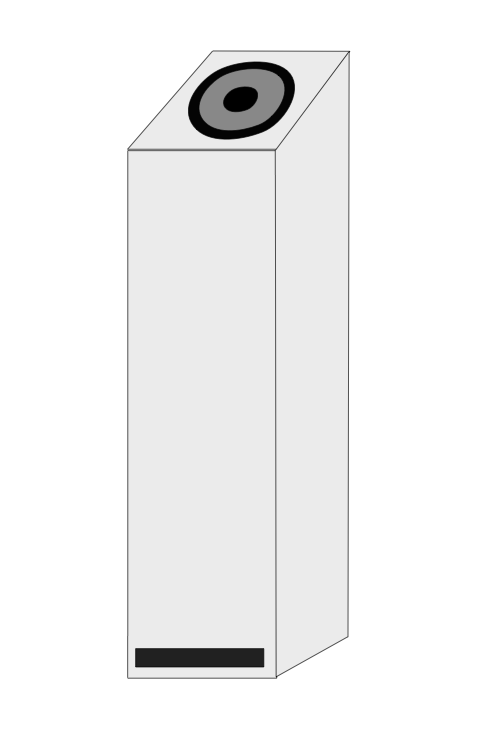

I see most MLTL put the driver a bit lower than the top of the line.
How would I approach this if I wanted to make MLTL but with the driver on a slanted top?
Looking to do a surround / ambient / atmos style speaker but with the personality of the TABAQ.
Something like this, which is easily concealed around a room, using wall / ceiling reflections, instead of speakers hanging from the ceiling.

If you fold it and make it "dumpy" or fat, it's not a problem. Just fold the line around the middle divider. Then figure out if slot port is possible or if it needs plastic pipe.
That's not quite the elegant tower though. as it's about 400x200x150mm.
Something similar to Cyburg's Needle might work.
A Cyburg's Needle with the driver on an angled top? That might work.
Thanks X,
That's what I was hoping to read. Since this is for ambient / surround duty, not having a ruler flat response will not be so critical.
I'll make one at first, just to see how it goes.
Should I stay with the TABAQ dimensions and just put the driver was on top, or should it be shorter?

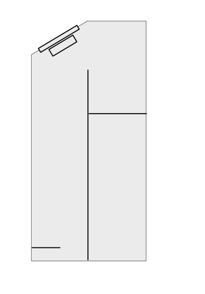

End loaded require more stuffing for a given amount of 'ripple' Vs an offset driver, so odds are you might not be able to match the TABAQ's 'personality'.
The closest would be to fold the TABAQ to get the desired driver offset, slope angle.
GM
GM
Thanks GM,
So, maybe something like this?

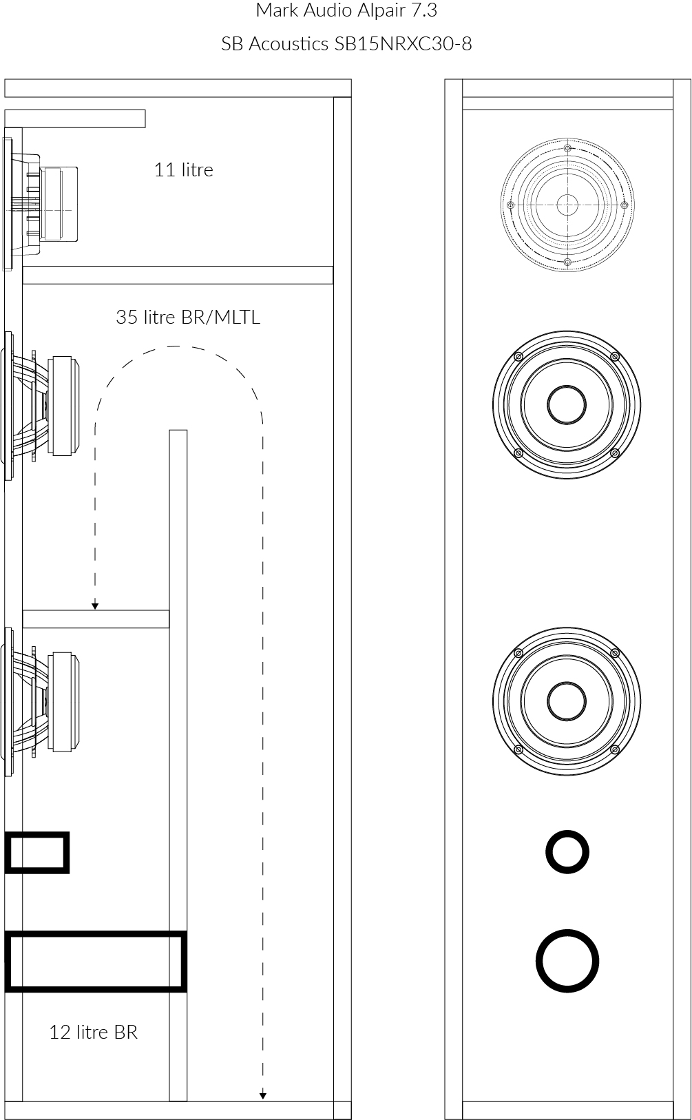

This idea has really got me and I'm learning (I think) every day. From looking at some established designs it seems to me that when viewed without the MLTL effect the general idea is for a br box substantially larger than the recommended, and tuned below the resonant frequency of the drier, and one is then aiming to get the MLTL effect to help straighten things out - would that be correct?
I looked for example at the MLTL38 design for the Jordan Eikona 2, which supposedly goes down to 27Hz - when I put the numbers into a vented box calculator the optimum box is around 7 litres, but the MLTL38 is around 32 litres. Purely as a BR the predicted response at that volume slopes down by about 4db to the (much lower) cut off. Is that the kind of slope one ought to look for in doing regular BR modelling, with the hope that once the MLTL effects come into play the slope gets lifted back up?
The Eikona 2 has a lowish Qts, and this does not work as well in an accidental MLTL assumption. It has a Vas rated at 11liters. I would say 38liters for a MLTL is very oversized in order to get 27Hz tuning. IMO, that's too low and efficiency will suffer plus it may sound boomy. I would go no larger tha 2x the Vas normally or 22liter box.
The Eikona 2 would actually be a good candidate for an XKi, and there, you can make it same as Vas and it will reach fs of 47Hz (-3dB) in a 11liter box.
That's great. I'm not actually panning one doing anything with the Eikona - it just happened to be a published design I had seen which I compared to what a normal br tuning looked like, just to try and learn intuitively what to aim for.
The driver I do have in mind is a 5" with a total Q of .33 and a VAS of 20.7 litres. With my design I have a volume of about 35 litres, so by your rule of thumb that's in the right area?
Another thing that is interesting is knowing how big to make the port. I can do a regular br sim with an online calculator and see what the response looks like with the dimensions I have in mind, but from reading here it by no means certain that the same port will be best for MLTL.
I must add a huge thank you for the sharing of this, which has been giving me tons to think about for quite some while, and hopefully will yield some nice new speakers for me when I can put all my ideas together.
What I have in mind is two 5" drivers just for bass (crossover no higher than 400) in separate parts of a floorstander. One with a conventional tune, either br or even sealed, and one in a MLTL for maximum extension (plus a full range in the top part of the cabinet). By using an active crossover and two inexpensive stereo amps for bass I hope to end up with an arrangement that can be fine-tuned for bass - maximum extension when wanted, a tighter sound sometimes etc. I hope it will be possible to match the speaker to room gain, plus have on-hand some rumble for HT or a gentler sound for late at night.

Why would the full range need to be ported on top if crossing around 400Hz?
Partly because there is no reason for it not to be.
I haven't finished that part of the design, but what I want is some sort of labyrinth or aperiodic arrangement that removes the rear waves to as full an extent as possible without actual tuning. I have ideas, still brewing!
Oh, and also the top enclosure if big enough to change the full range at a later date.
