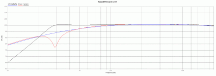

I've been doing some playing around with Leonard software's Transmission Line program for a while now. I've just been working my way through the 1st post while modelling a Dayton ND105-8 in WinISD and TL.
In the TL software, if you place the port in the exact centre of the line, then the WinISD calculated port length seems about right. However, as you move the port further to the right, towards the end of the line, the tuning of the box drops quite markedly. To obtain the same tuning frequency near the end of the line requires a much shorter port. I guess because it's also starting to behave as a reduced X-section TL in addition to the port resonance.

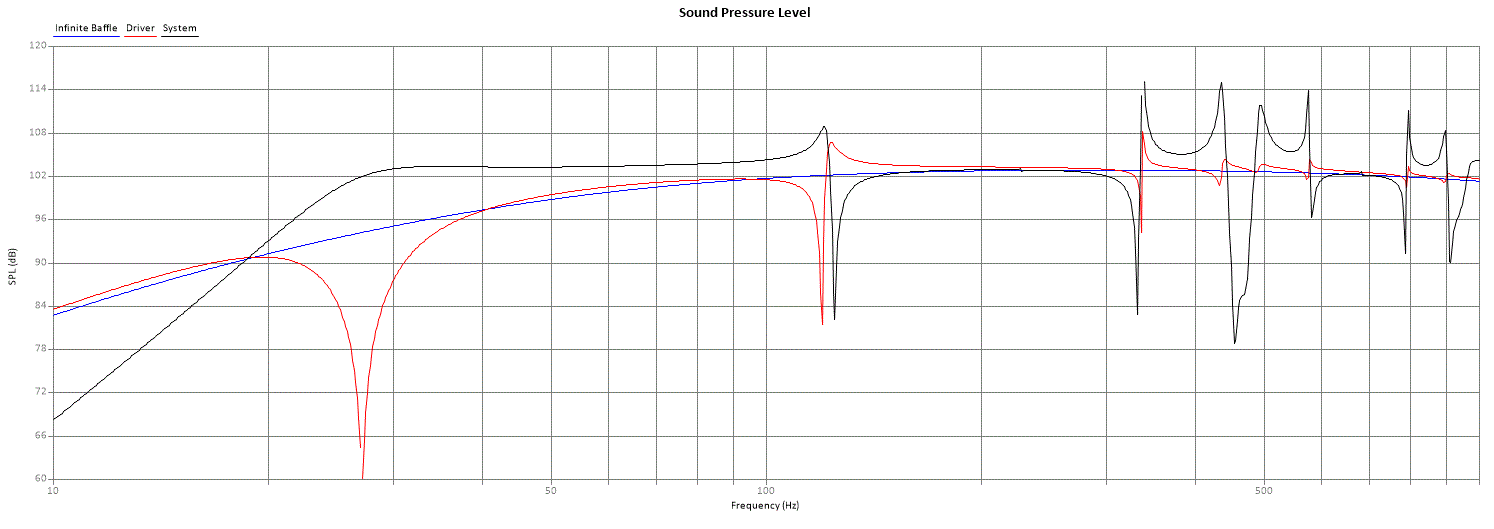

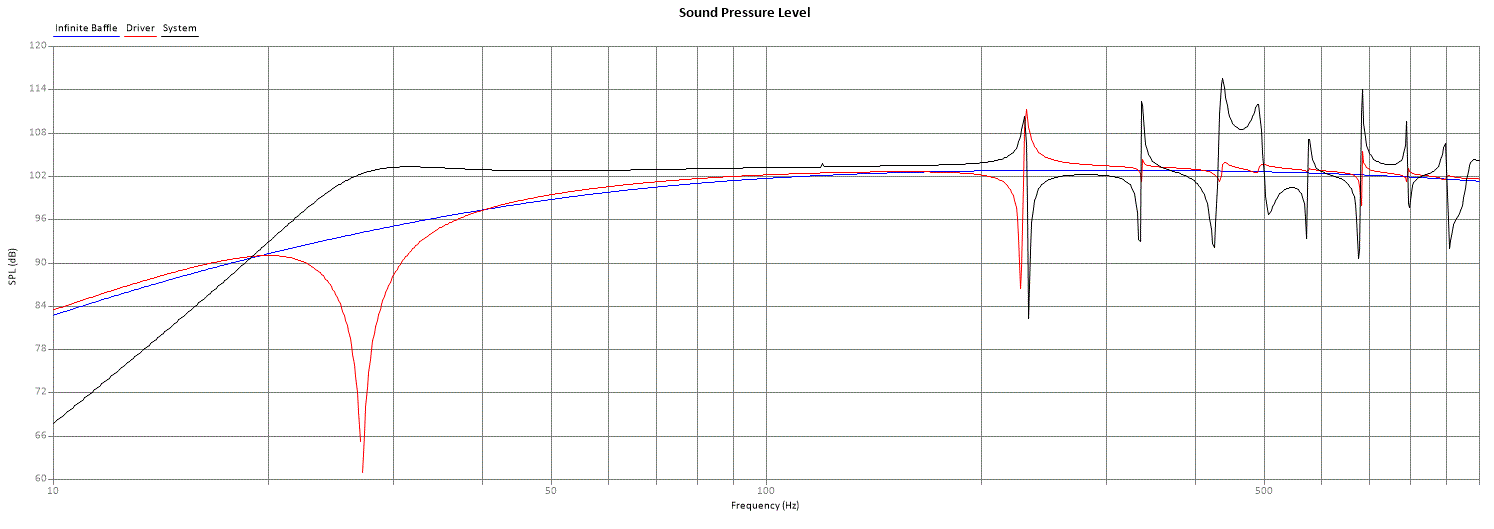

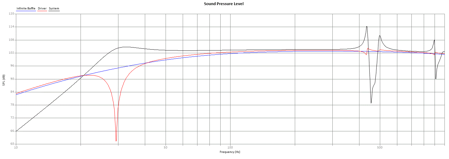

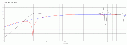

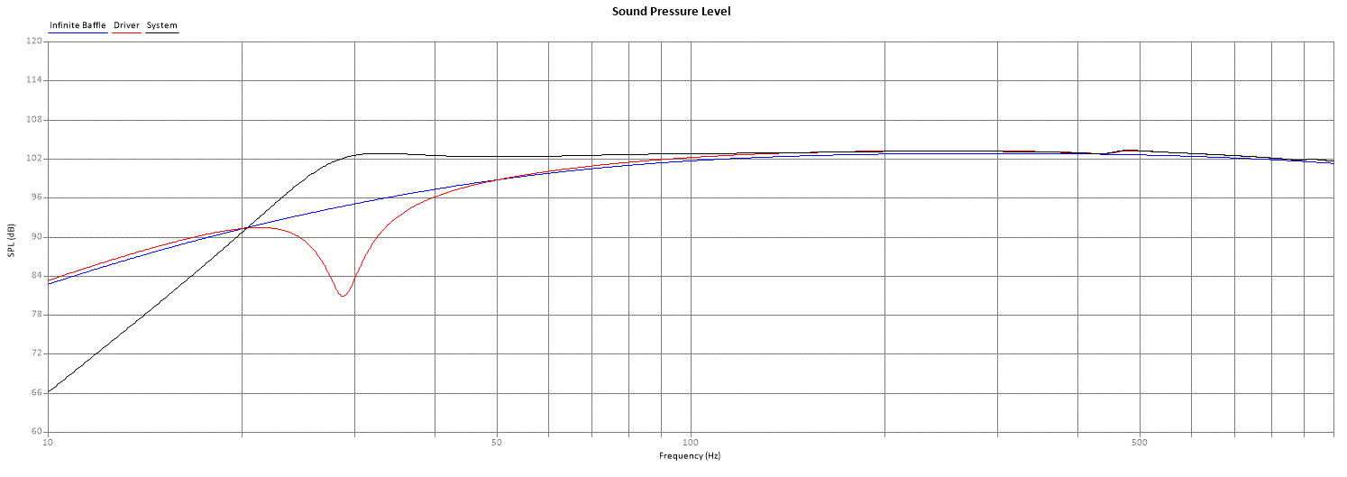

I've been considering a build for quite a while now, but am still not entirely sure how its going to unfold. Inspired by this build by xrk971, but with a TC9FD, and possibly a tweeter. However, instead of going sealed and LT, I'm thinking floorstanding TL, but still undecided...
Modelling this (in Leonard Audio's Transmission Line software) makes it relatively easy to mess around with the parameters and see what happens - and what I've noticed is that when I start with WinISD suggested sizes for a bass reflex and model it as a MLTL, it seems to have the smoothest response when the woofer is mounted in the middle of the chamber, with the tradeoff of a deeper notch.
Making the box longer (half the cross section, double the length) brings the resonances lower - but does offer better extension. Stuffing the box (low density) AND the port (high density) flattens these resonances out almost completely. Was surprised about the center position of the woofer though, I thought positioning at a third was best. Also good to see the effect of the resonances for the same size enclosure but different internal construction...
