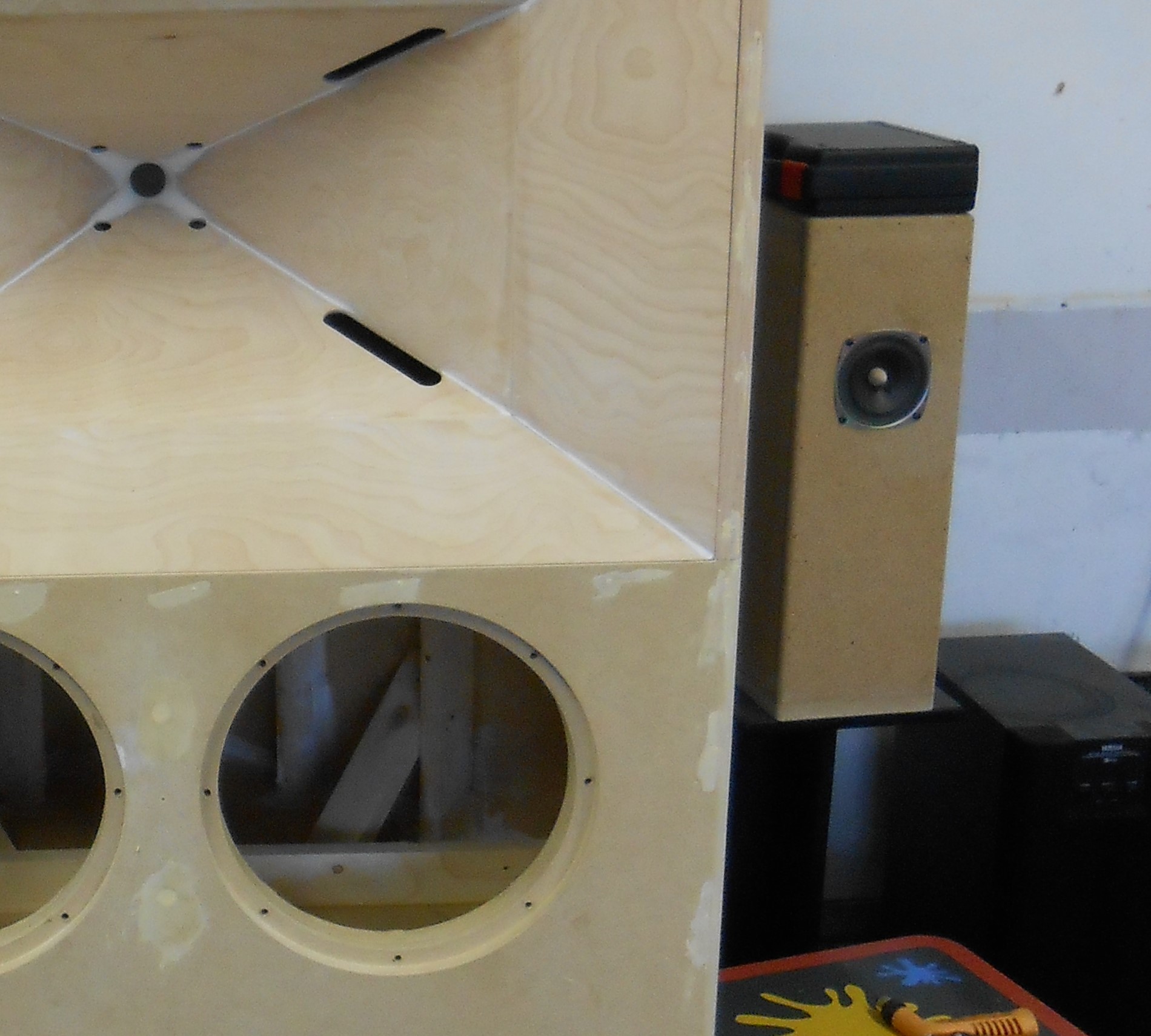

This wouldn't happen to be your "garage" speaker is it? (on the right in th background with a cool wooden phase plug, so not the synergy - which, by the way is one of the best implementations I have seen).

Yeah, whats left of it after I chopped it. Dayton USB mic case sitting on top, coincidentally almost the exact size.
Why did you chop it?
Mostly for experimentation, I also wanted to make them easier to move around, I already smashed my hand on the door jam carrying them in and out from the patio. They also work well on the stands I built for some other speakers I tore apart.
