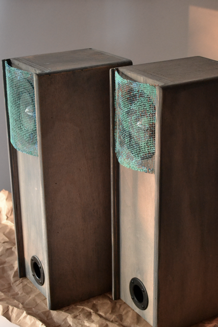

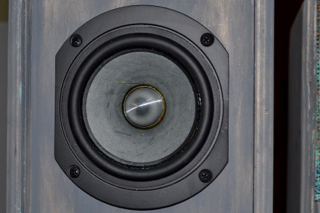

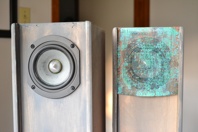

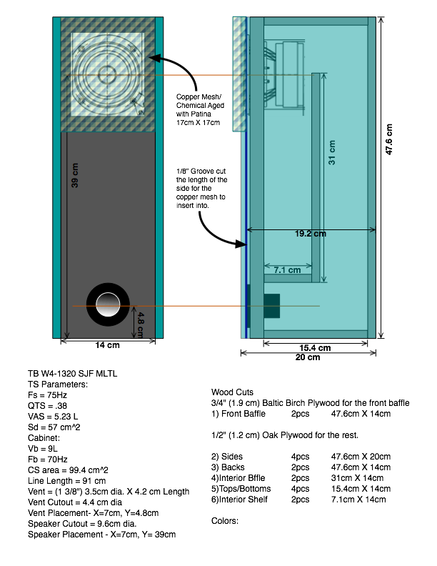

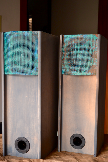

Industrial MLTL Using Accidental Technique
I really like these. Sound great, and the building is an ease. Used the "Accidental" method and am very pleased wit the sound. Thanks to XRK for making the design process available to a newbie like me. I realize that I may get crucified for the design choices. I'm just sick of black and silver as the only choices available in the general market. Speakers can also match the aesthetics of a room just like all of the other pieces. These are aimed at the industrial decor folks.
Finish is a washed gray chalk paint. Speaker grills are copper mesh with a vinegar/salt patina process.
Plans are complete if you like them. I always give back gratefully to this forum because of all of the help I have received.
