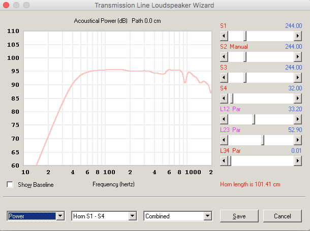

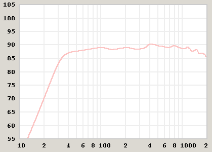

I put that driver into HornResp, and I got these specs:
- Line length: 139.5cm
- CSA= 480cm
- Vent CSA = 48cm
- Vent length = 9cm
- driver at around 40-45cm from the top
Filling of 75% of the line, between 70g to 100g, to taste

Hi Perceval,
Thank you so much for the sim.
Nice extension, but the enclosure is too large for me 😱
I was hoping around 25 -30L with f3 40- 45Hz

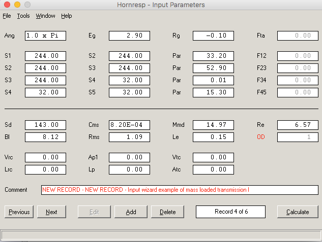

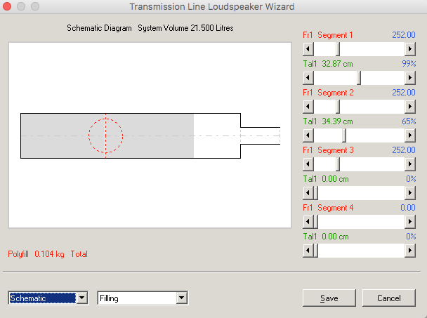

Can you kindly show screenshots of the data you enter in Hornresp. Maybe, I can try some tinkering of my own. I really don't know where and how to start in Hornresp. Hope someone made a youtube tutorial 🙂
Ok, followed post 440 numbers, and you get this:
Key into the first window of HornResp:
attachment.php
Then under Tool - Loudspeaker Wizard for filling and output:
attachment.php
attachment.php

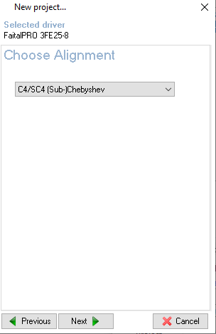

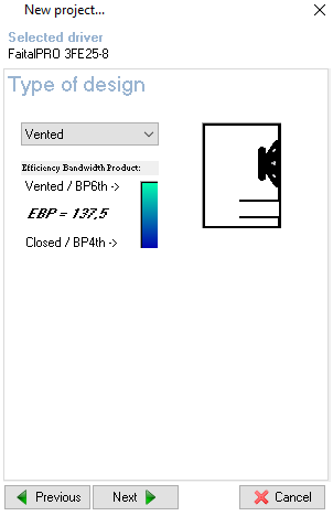

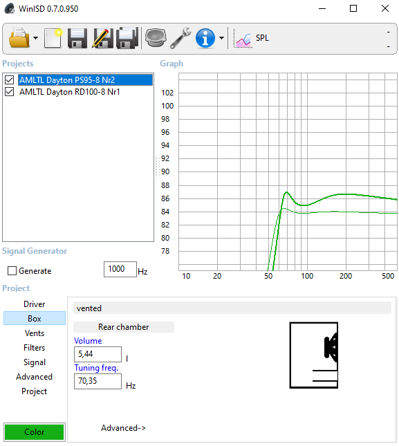

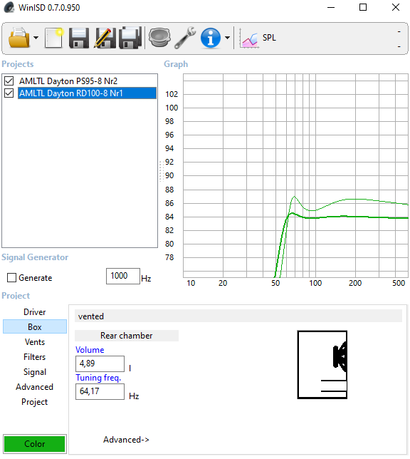

Stumbled on this thread when designing TABAQ-like enclosure. Want to check my measurements with AMLTL technique.
Done exactly as described in the very first post, but... All I get are the boxes which are ~1/2 of TABAQ volume. Done with 3 drivers, but there seem to be a trend:
-Dayton PS95-8 - 5,44 Liters
-Dayton RS100-8 - 4,89 Liters
-FaitalPRO 3FE25-8 - also ~5 Liters
I think, that there are some bugs/bad settings in my WinISD (the last available version) or the interpretation of data is wrong, because when I input manually sensitivity of 3FE25 from calculated ~85 to 91 dB as manufacturer states - I get 19,39 Liters
Can someone run sim for those drivers? Or any other 3" that is popular, like Vifa, Visaton and so on. Thank you!
