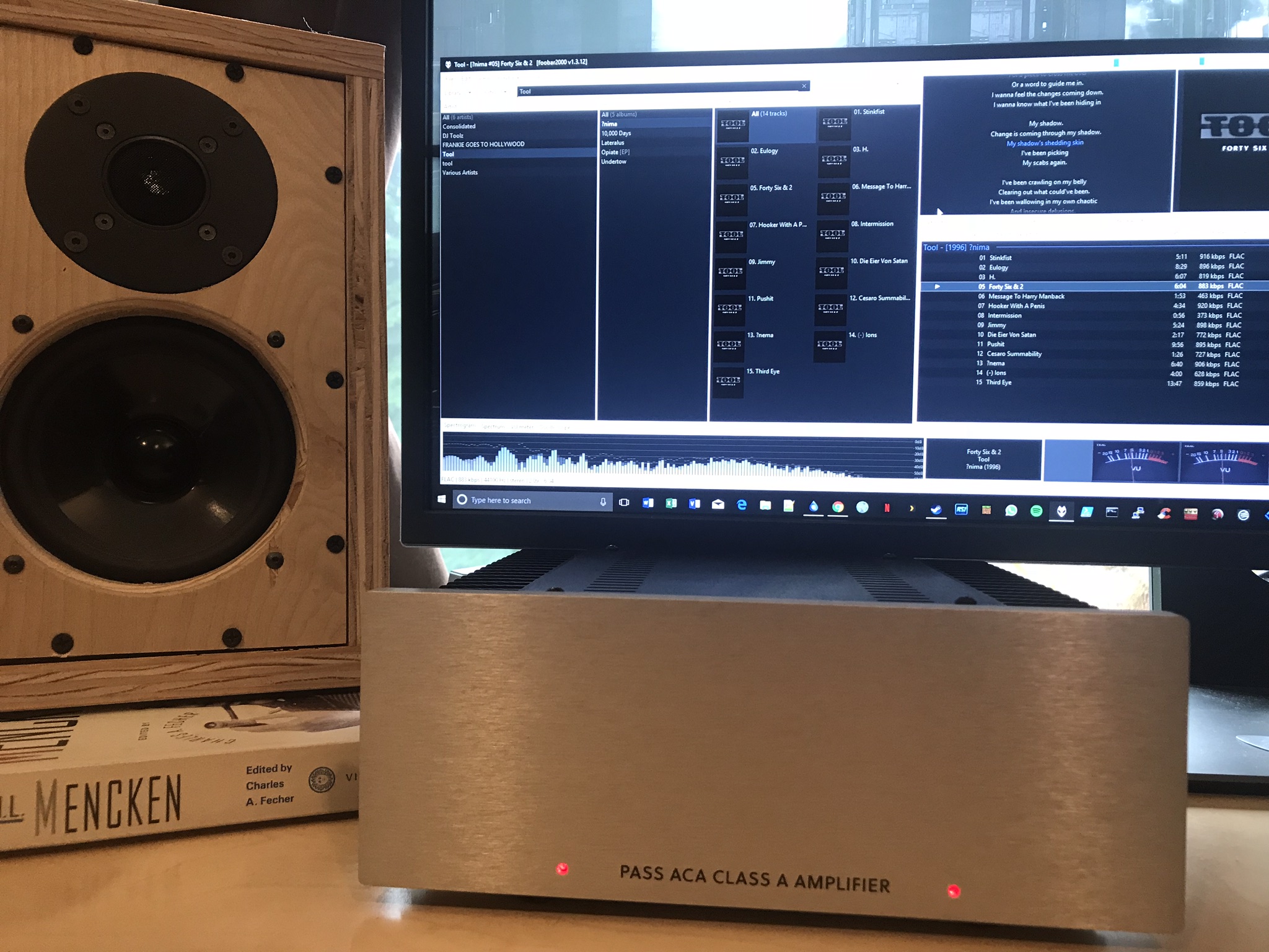

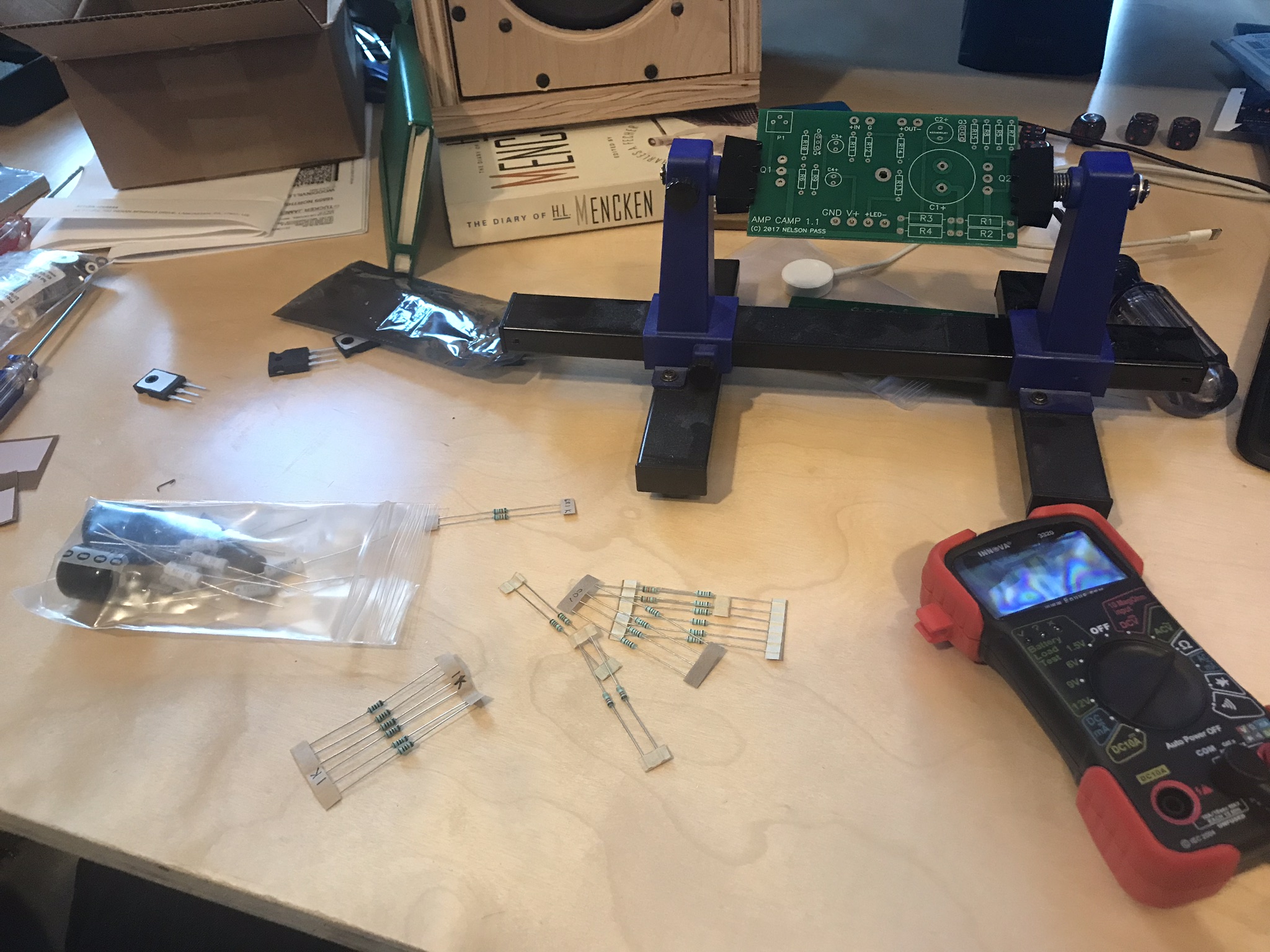

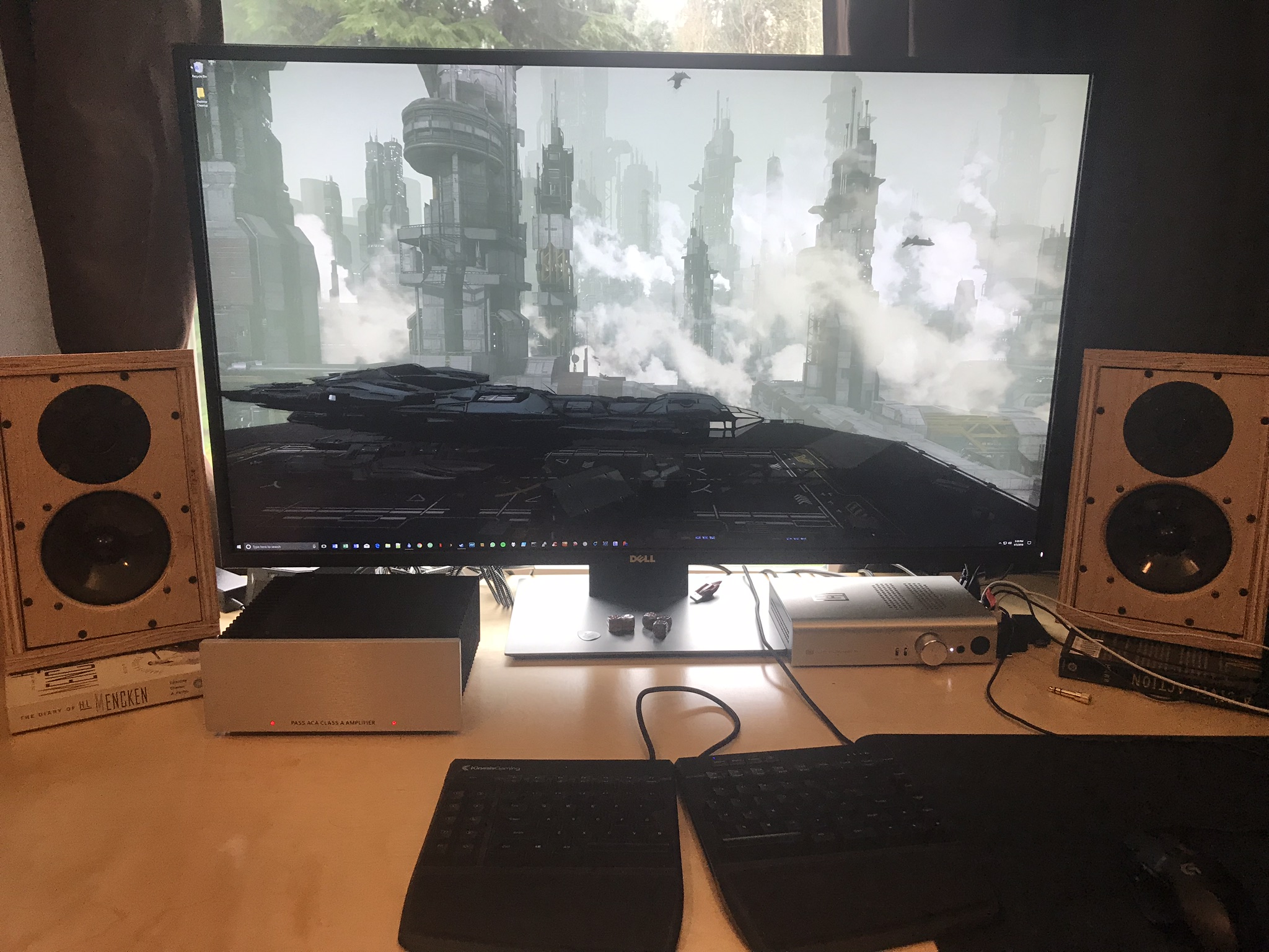

Hello All!
I sent 6L6 a PM saying thank you for the great photo walk through. Because of those photos I was able to put together my first DIY Amp in about 3 hours with minimal fuss. The only real problem I had was when I soldered the wrong resistor int one of the boards. It took a little while to figure out which was the wrong one then remove it, replace it, and place the resister in the correct spot on the other board.
Here are some photos of how it looked as I went along and then now as it sits on my desk providing sonic goodness and joy to my ears.
In case anyone is interested, what you see in the last photo is the amp (of course), fed from a Schiit Jotunheim (with the dual mono AK4490 dac), the amp then feeds a pair of DIY Continuums ala Jeff Bagby. And yes, it sounds a-freaking-mazing!
Again 6L6, thank you so very very much! Now I need to figure out what my next project will be. Is there a DIY-anonymous...?

That is a very nice set-up! Well done on the amp and speakers!
Knowing the Continuums aren't very efficient, do you have any issues with the low wattage of the ACA or the 10db gain? Curious, since I'm considering this as my first entry into Class-A amp and I will have a very similar set-up as yours.
I have not noticed any problems at all. Since this is all near field I don't need a ton of volume. The Jotunheim's gain switch goes from 6db to 14db. I have not needed to use it yet. My last amp was a carver tfm-25. That could push the speakers to greater volumes, but I did not build it so it was not as good as the aca. 😀
So far I've listened to a lot of FLAC files, Spotify, watched some ripped movies, and Netflix. Everything has sounded perfect.
I love the setup, but am, of course, already working on another set of speakers (3 ways this time because I grew up in the 70s/80s and I must). I'm also considering upgrading the jotunheim to the multibit dac. But that is due to upgrade-itis, not disappointment.

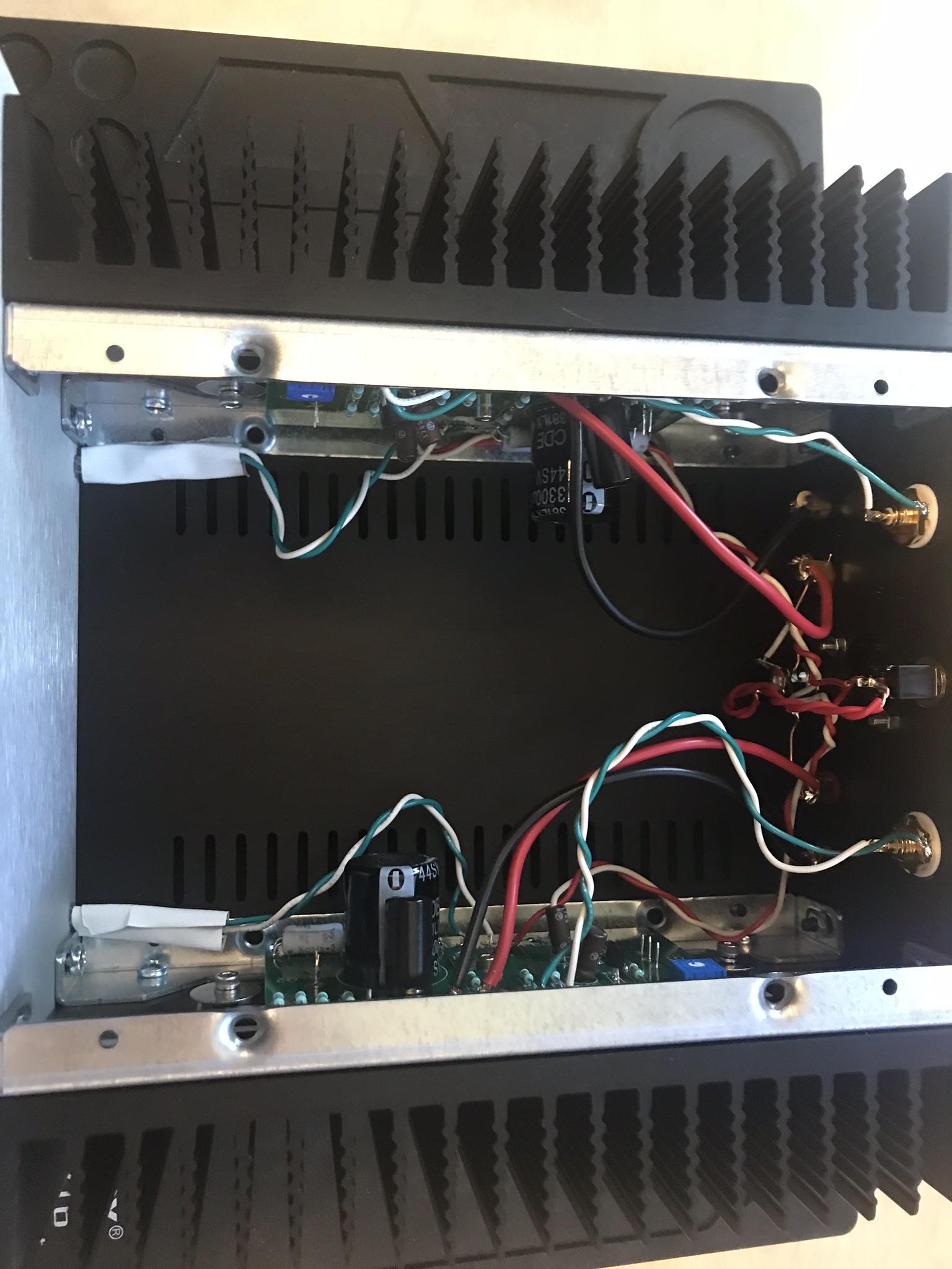

6l6, I took some pictures of the rig but unfortunately they aren't very clear, the lighting didn't help either. Honestly it looks like I live in a dungeon but I assure you it's just my camera!
After looking at the photos quite honestly I'm embarassed at my soldering work, particularly at the xlr-4 jack... 🙁
Anyway, here are the pictures...
This is the right channel
This is the left channel
This is the back panel (featuring some some of the worst lighting ever)
This is xlr-4 jack
I hope this helps with diagnosing an issue, I'm starting to think that the issue was simply my soldering job

You are shorting one channel of the output to the chassis at the XLR.
There is a white wire connected to the XLR's ground tab. The wires from the speaker jacks to the XLR should only be connected to the XLR's pins
The top white wire should connect to the pin that currently doesn't have a wire in it. (I think... check your pinout diagram for the 4-pin XLR) Nothing should be connected to that tab.
