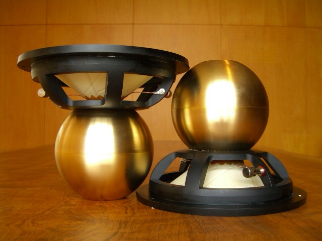

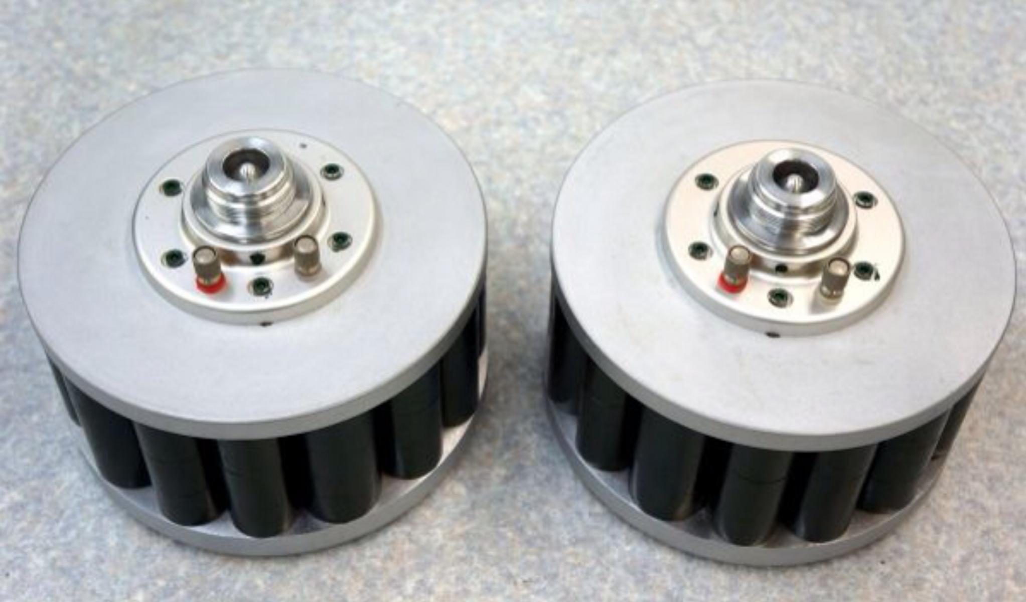

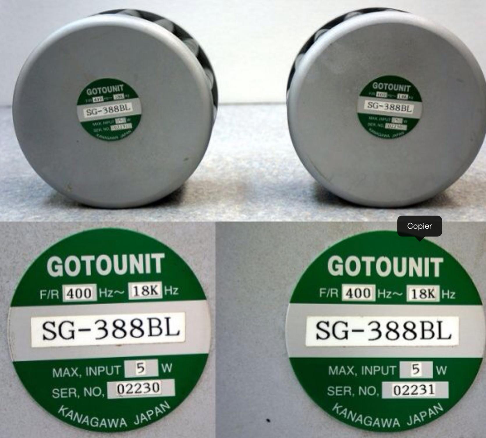

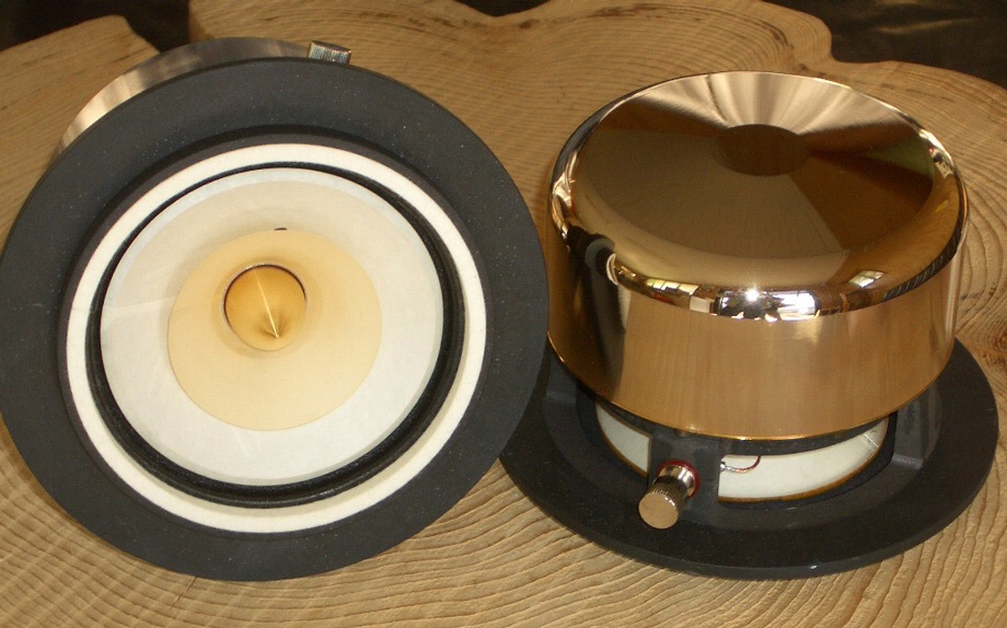

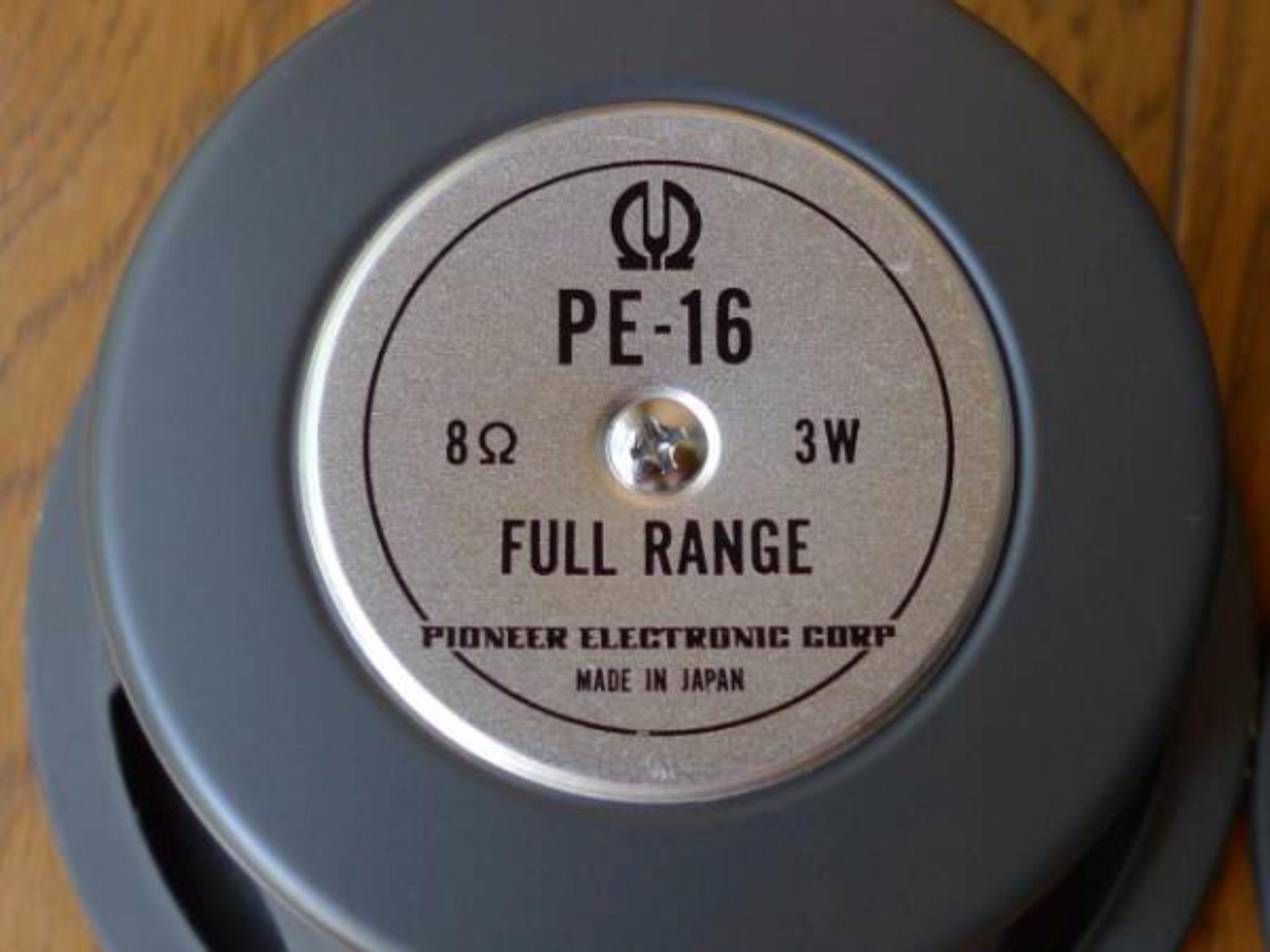

Scott - I'm thinking several concurrent conversations / queries on that subject just might pique the interest of "management" to the possible market demand for such a little gadget.
SE class A amp with 5 or 10 watts max it's perfect for not gadget drivers 😉
Make sense in small room or moderate volume needs if less sensible , efficient speakers.
Find good match to Your audio pleasure

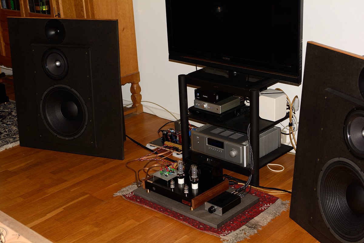

The reason I will build the ACA is that I want to compare with my SE direct coupled 7-8 watt 300B amp which has been modified with better PSUs etc. to get low noise/hum.....< 0.1 mV at the speaker terminals with shorted input. I was surprised how good such an amp sounds compared to a big PP Solid State amp (in this case a NAD M3). By accident I clicked at PassLab forum and realized that SE SS amps exists. JFETs and MOSFETs are still called Solid State?
It was not my plan to switch from tubes......but now I will try it out to hear the difference. It will be nice to play with 24VDC instead of 540 VDC.
My OB speakers has ok sensitivity (93-94 dB) and impedance around 6 ohm and never drops lower than 4 Ohm. It works perfect using the 8 ohm output. I tried using bi-amp using the big Nad M3 for the bass but this was not good......integration much better using the 300B alone. It also feels like it is playing lower tones......why I don't know. I have not tried clipping sounds level yet. My ears goes bad before that.
My OB speakers are these which I spent a lot of hours building:
OBL-15
Picture attached of my setup. I can listen for hours.....before that I got tired after 1/2 - 1 hour of listening. Hope I will get similar experience with the ACA.......
OBL-15
make M2 and you're done with search for better amp
after that , every next one will be for joy of build , not necessity
ACA is too sissy for your speakers
Is the ACA "more sissy" than a SE 300B amp?

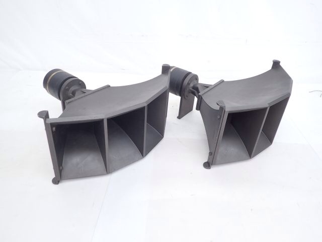

Maybe I will just build the G.I.P. Laboratory 9700A speakers:
GIP 9700 system
I read other place that they have 116 dB sensitivity......then the ACA is not sissy anymore? ......at least not in a 30 m2 room.......
Never understood why we don't see electromagnets in more speakers units.....then we only need 1W amps.......or 0.1W amp would probably do it.....
I can try the M2 next time......but it is a push pull? ....and no PCB's at the DIY shop?
GIP 9700 system
