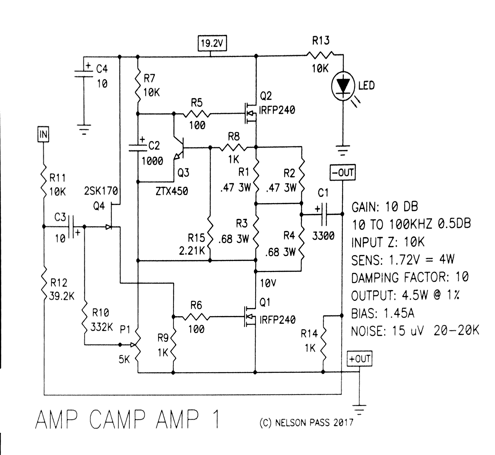

It’s marked 1.1 on the schematic and the PCB, so I went with that. I was thinking about calling it Amp Camp Amp (2018) or something like that, however the boards are marked 2017...

Hopefully i am not just being blind, but I am having trouble finding the version 1.1 schematic you mention printing out in post #2. I wish my kit had come with it but it did not. I only have a screenshot from the video at burning amp 2017. Do you have a link?
awesome, thanks! i also made this table, maybe it will also be helpful:
R1 .47 3W
R2 .47 3W
R3 .68 3W
R4 .68 3W

Jim and NP:
I am particularly interested in daisy-chaining two or three ACA pcbs together (a la F5T V3); is that possible (albeit in a different chassis)?

Jim:
Sorry, I could have articulated my idea better. The basic ACA is 5 or 6 watts per channel. I'd like to build something a little bigger.
I was hoping to build a 10 or 12-watt version of the ACA and imagined a parallel configuration. Wouldn't a parallel amp design be better than a bridged design in this instance?
Either way, and assuming this is feasible and the heatsinks are large enough, it might be fun to use 3 pcbs per channel and shoot for a 15 to 18-watt amp. Is that possible? And if so, would it be advisable to match the MOSFETS?
