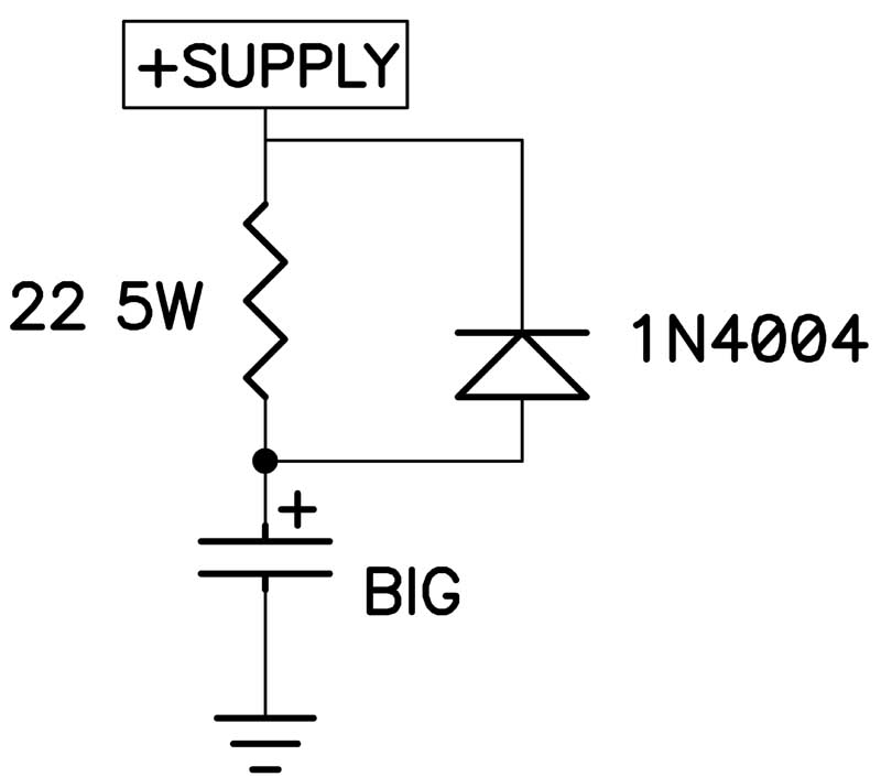

Some switching supplies will not want to charge a large cap. There is
a way where you can charge the cap more slowly but take the charge
out quickly. Try something like this circuit in parallel with the supply.
Use a bigger diode if think you need it. A Schottky will give you less drop
if you want it as a peak current reserve.

Checking my parts, I only have a 15-ohm 5-watt resistor and 1N5818.
Can anyone confirm if this will work?

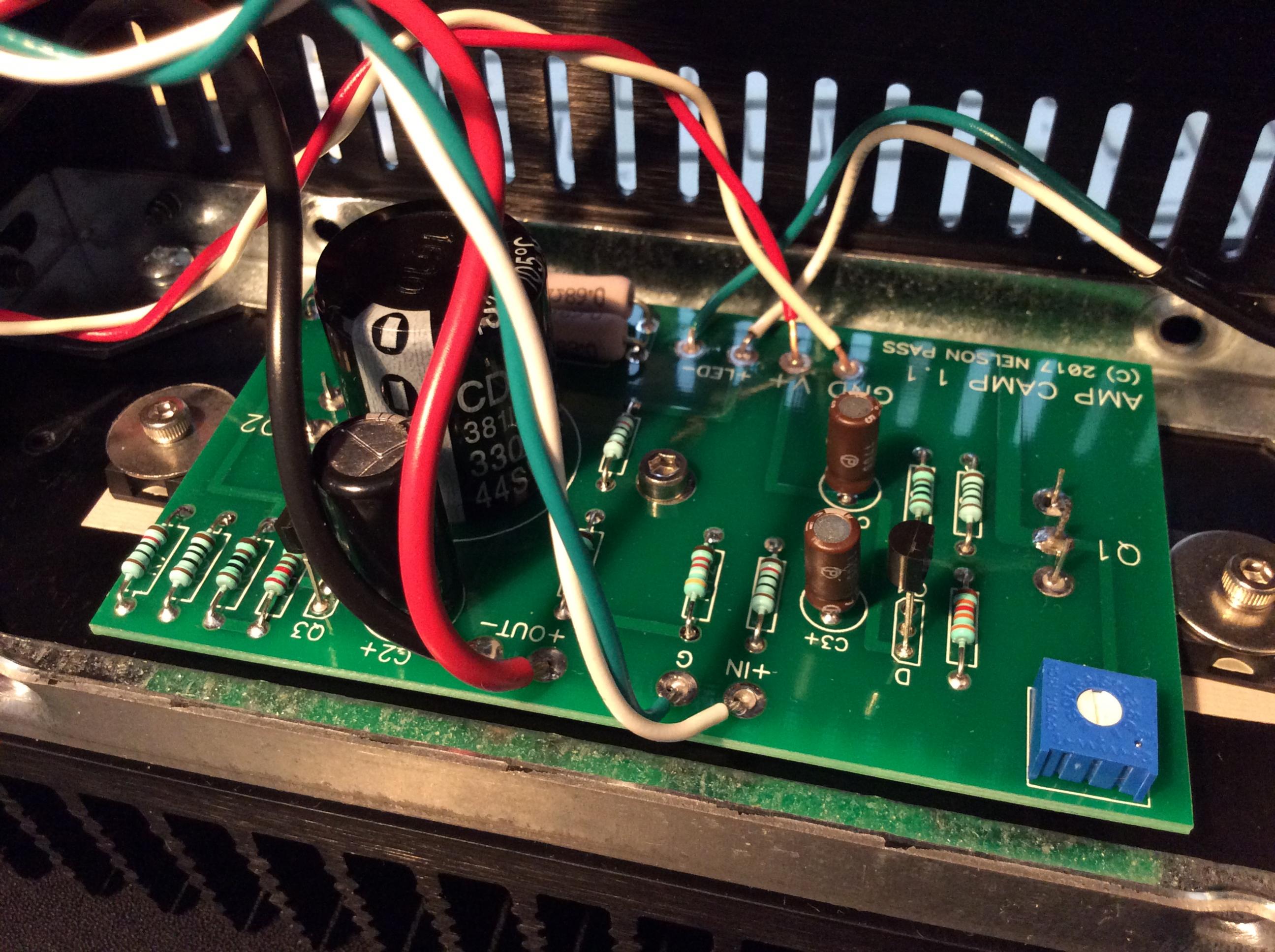

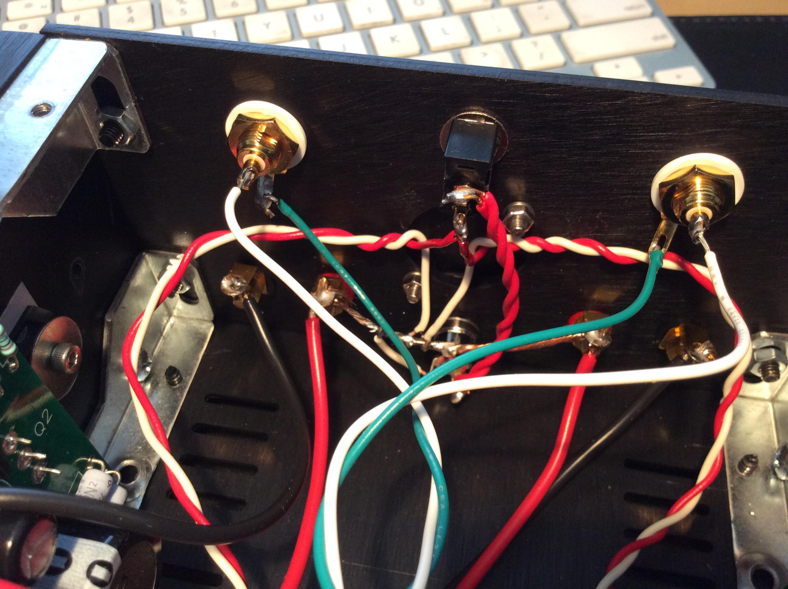

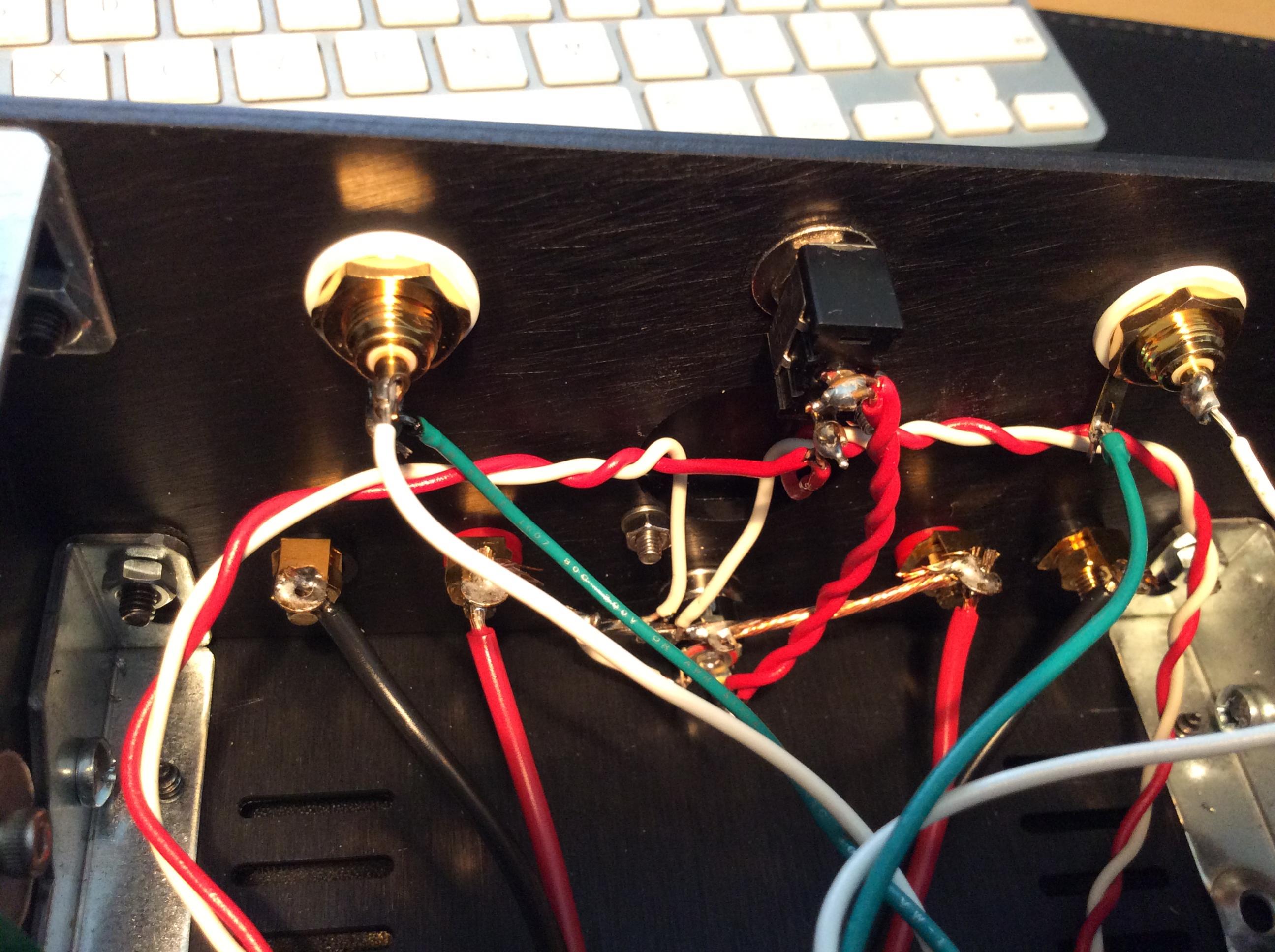

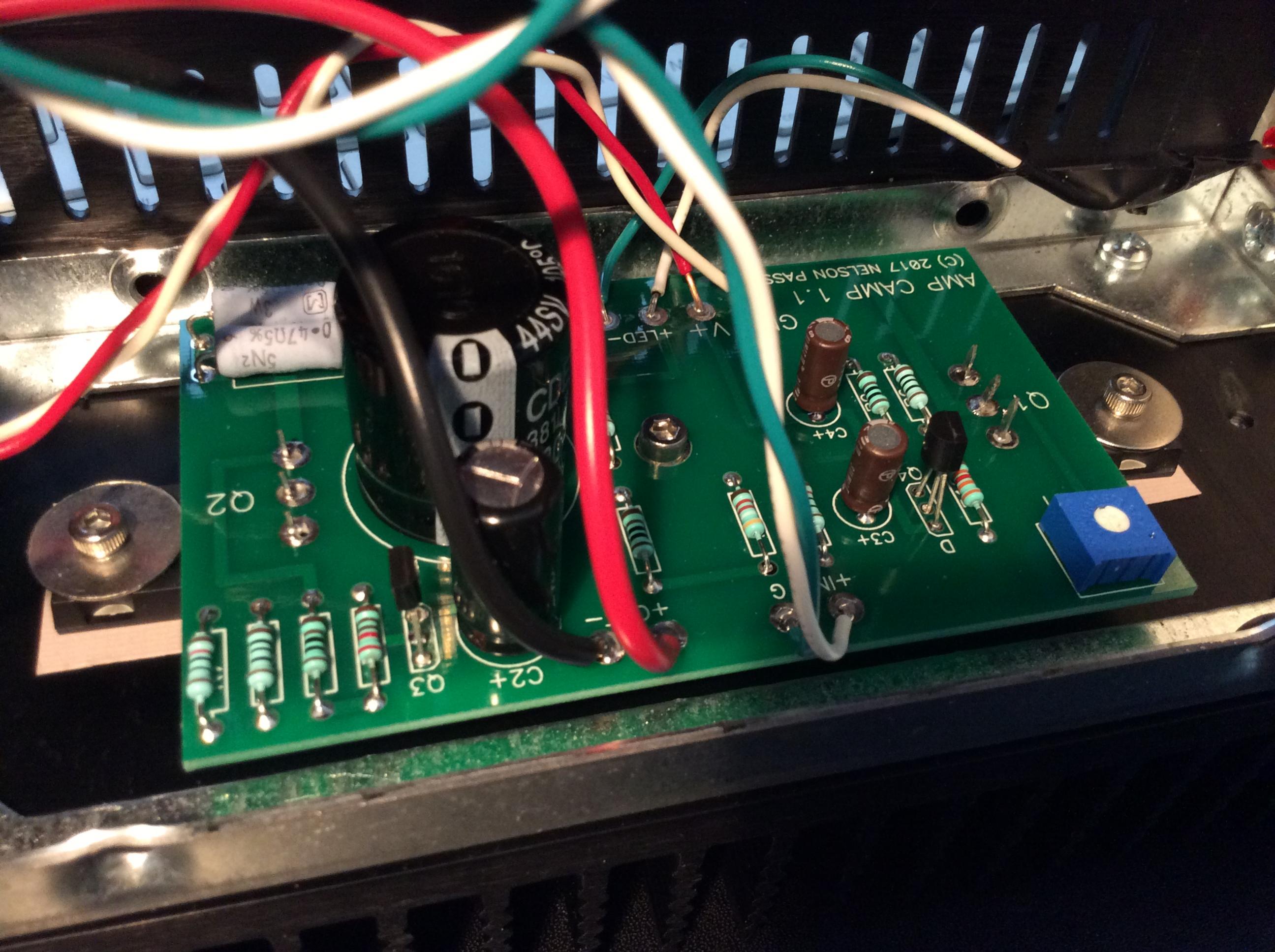

Pictures of My Left Channel - No Sound
Finally had the chance to take some pictures - problem still exists, no sound left channel and a bit of distortion when testing from the right.
