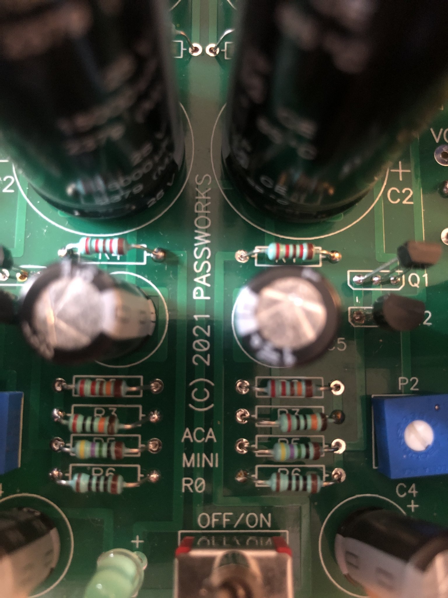

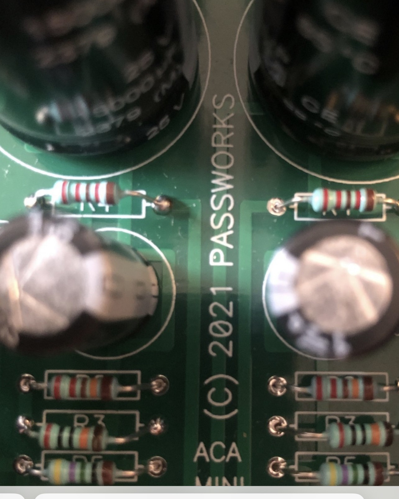

Next is R4.
They should be 6.8 k
Color code is Green Gray Orange
Your picture shoes red red black
So go to work on those and compare the color codes with the remaining resistors as I can only see the board you photographed from one angle.

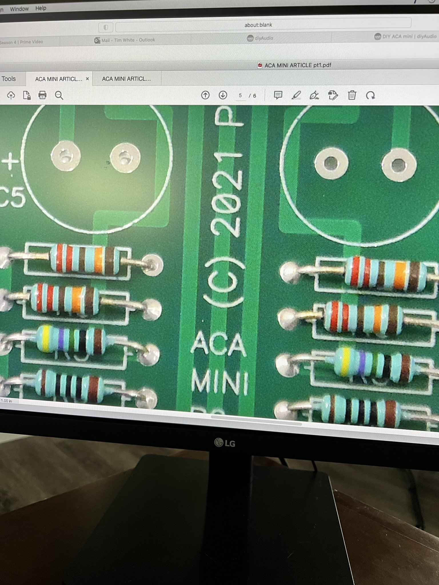

Papa suggested changing R4 to 22k to slow down the charging to help some power supplies:
https://www.diyaudio.com/community/threads/diy-aca-mini.379037/page-61#post-7123575
Edit: It seems R2 and R4 were changed in later completion kits: Please see here: https://www.diyaudio.com/community/threads/diy-aca-mini.379037/page-68#post-7156140
Thanks. Yes, in my kit there was a note that said R2 -200k qty 2. R4 = 22.1K. R0 and R3 remain the same. That explains why the color code on mine looks different. It’s oriented brown on right per instructions.

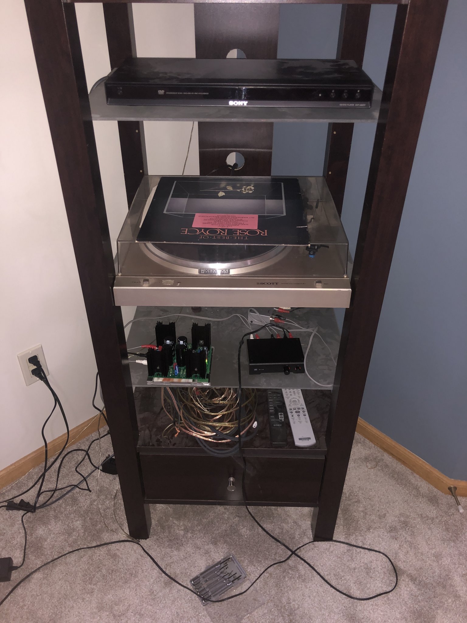

Major update I think. I have my components on a wood rack with glass shelves. The ACA had been on one glass shelf. The cdc player and turntable on other separate glass shelves. I decided to put a cd case under the ACA and move the cd player over on the carpet. Dead quiet and plays as expected.
I want to say big thanks to everyone who helped in this thread. My dad was my go to guy for soldering and unfortunately he never taught me before he died a few years ago. So I’m learning on my own. I appreciate all the patience.
I wonder if the glass conducts some current or interferes somehow. I’ll post a pic of anyone is interested and if someone else has the same issue.
Huh… that’s quite interesting, as that shouldn't make a difference… are any of the component leads on the bottom long and touching the shelf/case?
No, they weren’t. But I moved the ACA down to the wood shelf, and the cd player up on the glass top shelf, and no buzz, no hum. Sounds as I would expect. Before, it started just when turning the cd player on, before even playing a cd.
That bottom shelf in the picture is just unattached spare speaker cables— not hooked up to anything.
