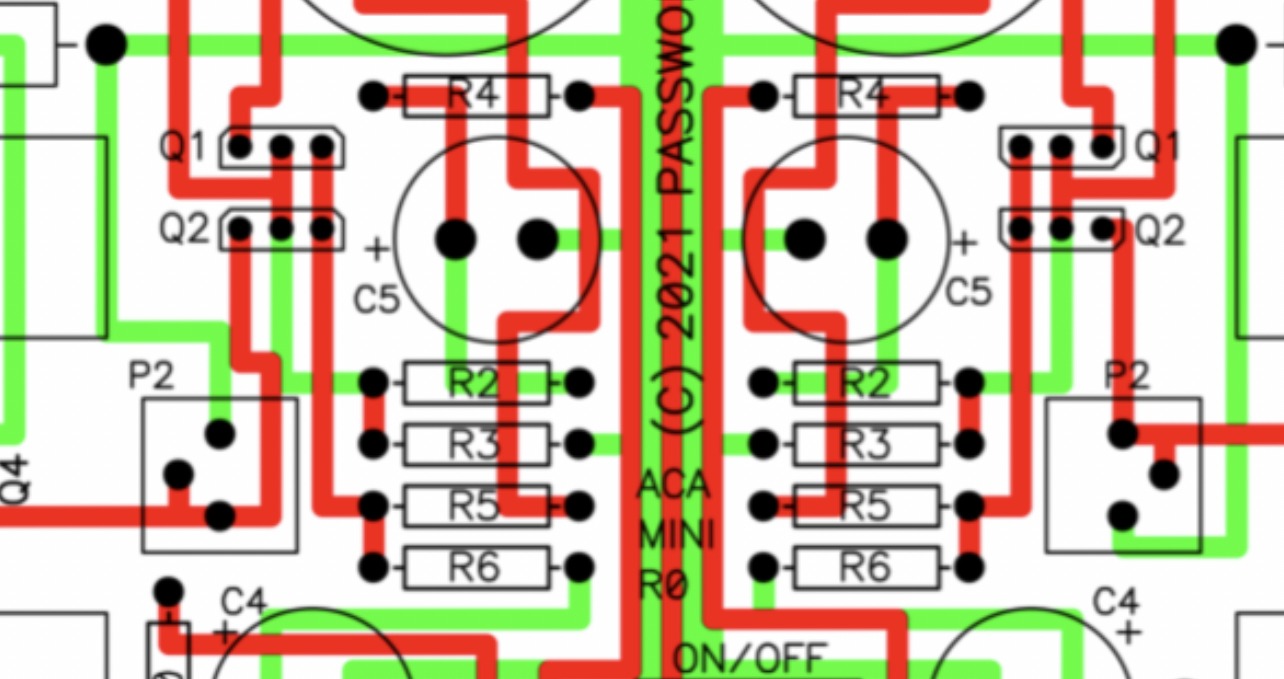

Not here to judge your intelligence. So no need to apologize. We are working through a problem here. Trust me - we all have problems and sometimes they aren’t easy to figure out.Thanks. Not sure I’m doing correctly (please excuse my ignorance), but with the meter set on 200 ohms, it starts around 20 and goes down to 0, then drifts up and down between 0 and 1.
In the picture you sent. Put one lead of your meter in the - screw of the blue screw terminal and the other on the same outer sleeve of the each input Jack.
Does side one go right to zero and the other not?
Green side stays at .9, and red side is a bit higher- maybe 1.2? Thank you for your help and patience.Not here to judge your intelligence. So no need to apologize. We are working through a problem here. Trust me - we all have problems and sometimes they aren’t easy to figure out.

Unplug the cables from whatever you are feeding the amp with. (Preamp I think you said)Sorry. 1.2 on both + inputs. .9 on the negative. So both sides the same
Plug them into the amp.
Put one end of your meter into the - terminal you just used.
Measure each cable at the end that would normally be plugged into the preamp.
Mostly I’m interested in the outer part that covers the silver part of the Jack.

That 1.2 bugs me. Take a piece of wire and strip both ends. Lamp cord, cat 5, a twist tie.. whatever you may have and put one end into the (-) speaker terminal along with your speaker connection.
Plug the cables back into everything. Speakers. Preamp. Like you are getting ready to use it.
Take the other end of the wire you put in the negative end of the speaker connector and have it ready.
Turn the amp on and when you hear the noise - put the wire on the silver outer conductor of the offending channel.

Ok. Did as you said. Turned amp on. No noise until I turn the source on (cd player). Buzz/hum started — sounds like white noise buzz. Used a piece of speaker wire for test. Touched it to the red rca connector (metal), and the noise remained constant (no change).That 1.2 bugs me. Take a piece of wire and strip both ends. Lamp cord, cat 5, a twist tie.. whatever you may have and put one end into the (-) speaker terminal along with your speaker connection.

I’m curious now about the four resistors in the R2 and R3 position.Ok. Did as you said. Turned amp on. No noise until I turn the source on (cd player). Buzz/hum started — sounds like white noise buzz. Used a piece of speaker wire for test. Touched it to the red rca connector (metal), and the noise remained constant (no change).
The color bands should be red red black orange for those four positions.
That isn’t what I see in your picture.
According to the guide —
https://www.firstwatt.com/pdf/art_aca_mini.pdf
The brown colors are all on the right hand sides for R2-R6. I double checked mine against the photos in the guide and they are the same. I’ll post a closer pic if that helps.
