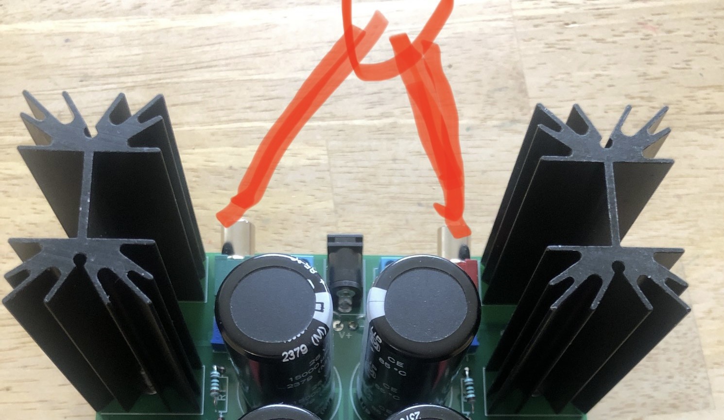

I’d like to know the resistance between the two outer sleeves of the input jacks. With everything unplugged. Thx
Will you please measure the resistance between the two outer conductors on the input jacks with everything unplugged from the amp. Thanks
Thanks. Not sure what you mean by outer sleeves. Can you identify more closely?I’d like to know the resistance between the two outer sleeves of the input jacks. With everything unplugged. Thx
Here’s a pic.
No. Off and unplugged.Was the amp on when you moved it and the speaker lead came out?

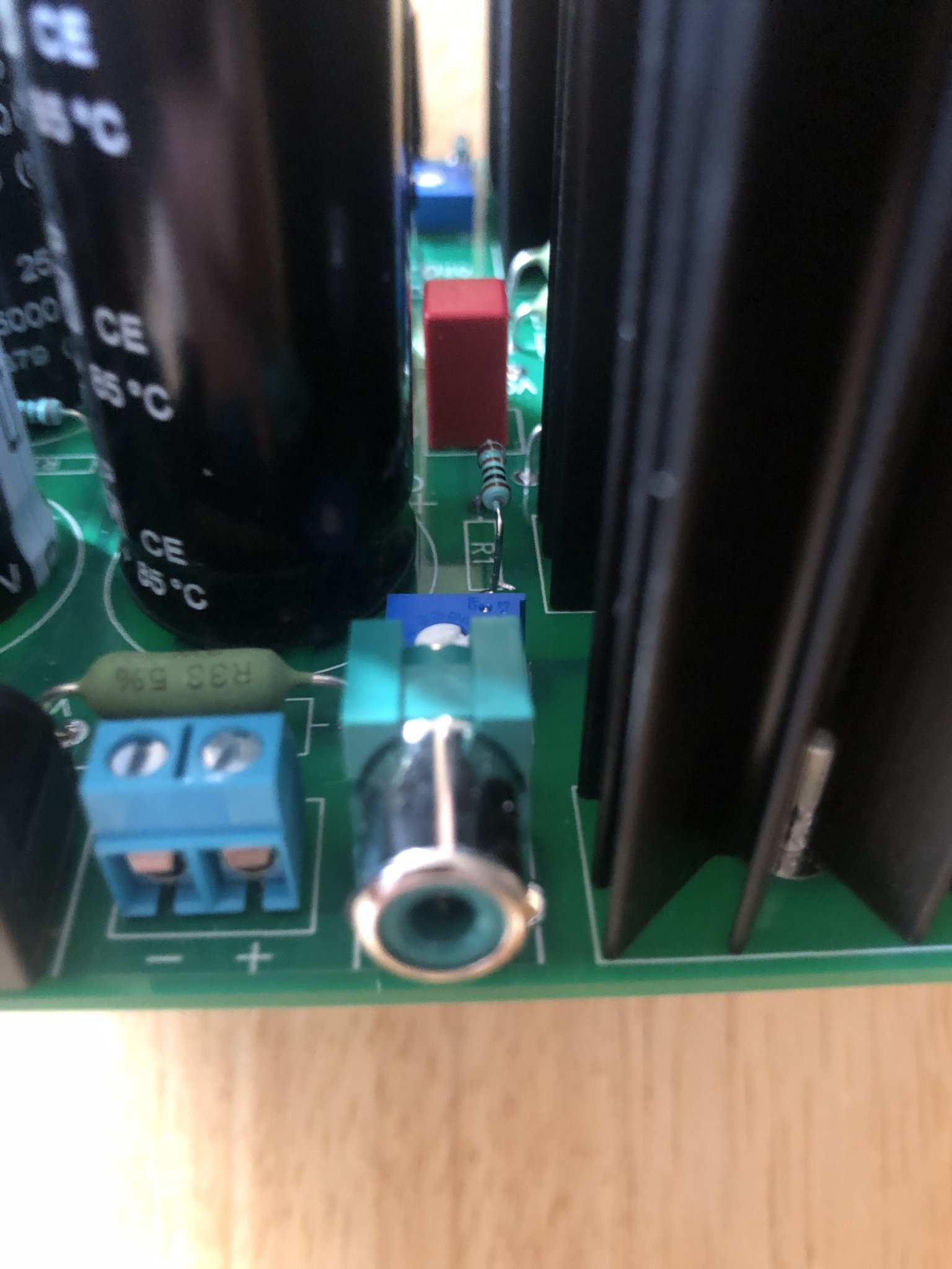

From the silver part of the Jack to the other silver part of the other Jack. I posted another picture. ThanksThanks. Not sure what you mean by outer sleeves. Can you identify more closely?
Here’s a pic.View attachment 1130445
Thanks. Not sure I’m doing correctly (please excuse my ignorance), but with the meter set on 200 ohms, it starts around 20 and goes down to 0, then drifts up and down between 0 and 1.
I have an older non digital multimeter and it measures .9From the silver part of the Jack to the other silver part of the other Jack. I posted another picture. Thanks
