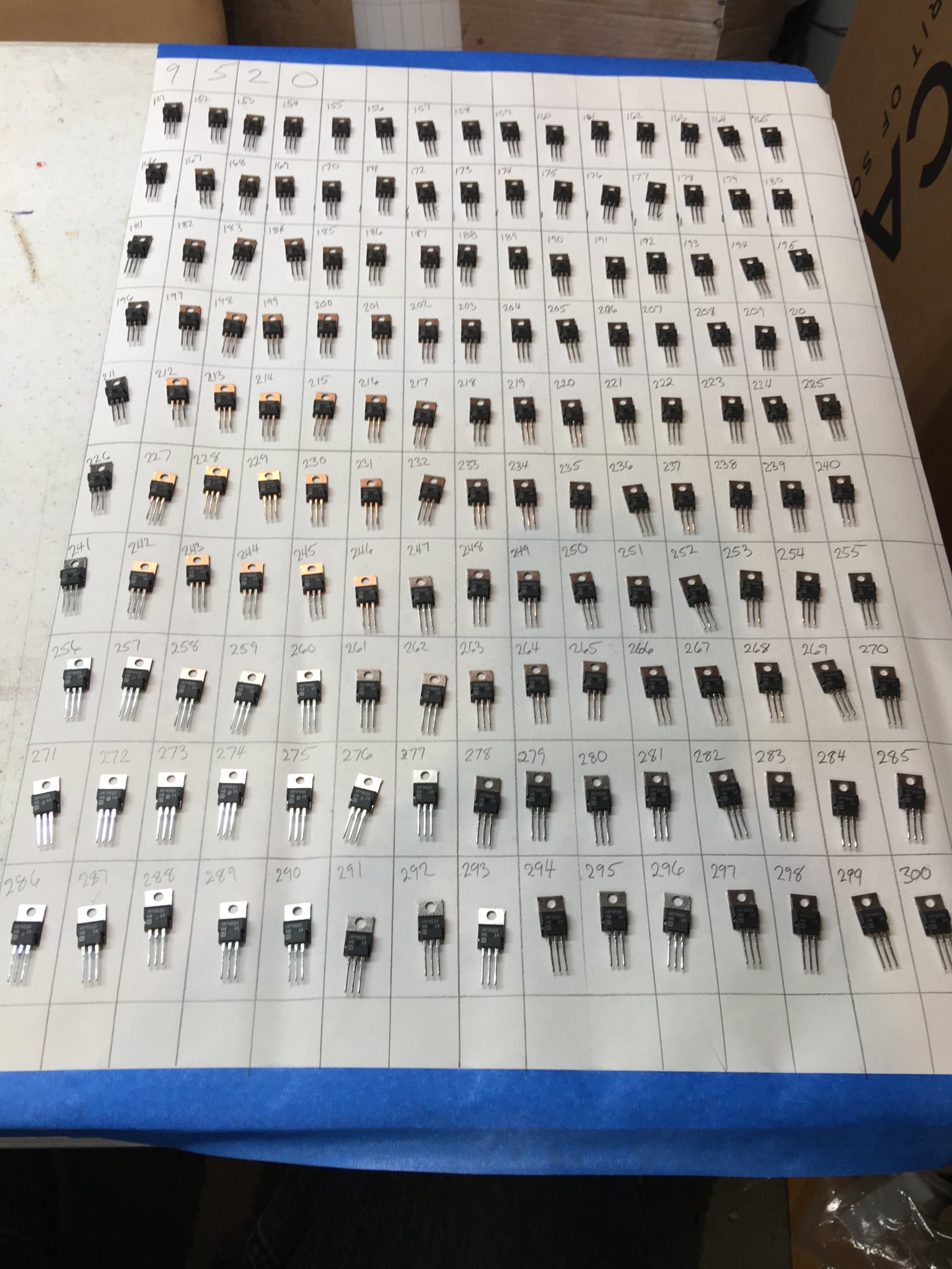

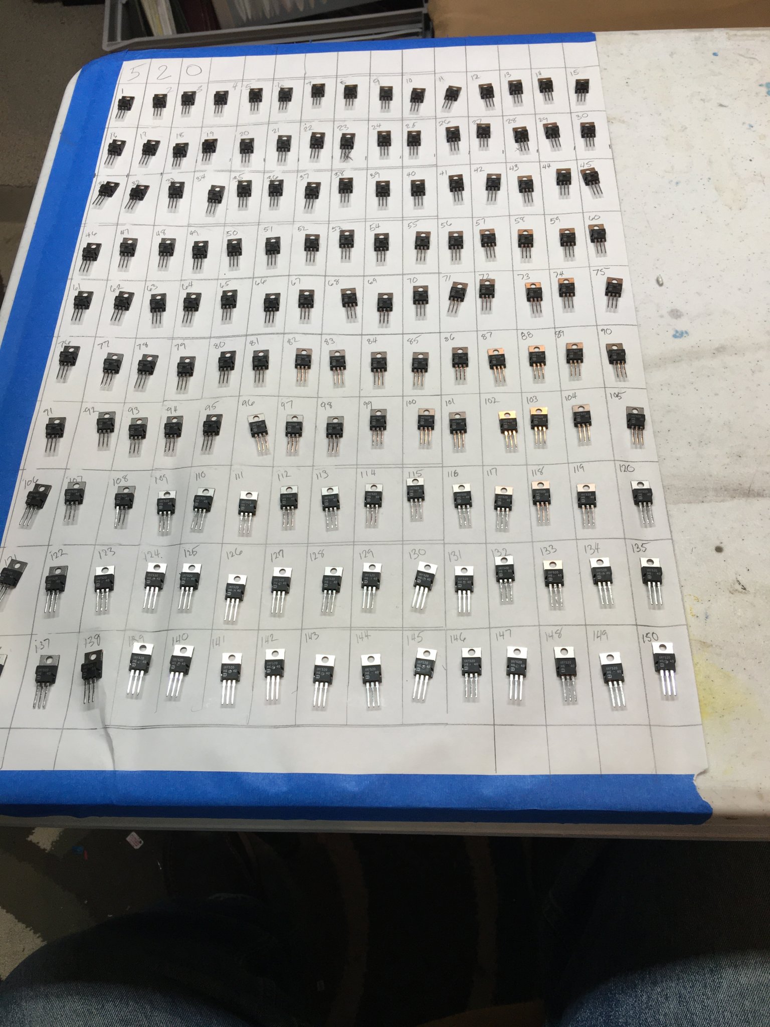

Thanks for that update Kevin, I was wondering what was happening. Have fun matching the pairs out of the 150 of each you show.
Hi Gary,
Just for kicks I measured a dozen of each type. They are so close both within each type and N to P that I'm predicting it will be a breeze to get better than 0.1V matches N to P.
This is my little TEST JIG
That is good news, maybe Nelson might have pre selected the parts. Or maybe the Harris manufacture was much tighter then the IR manufacturing.

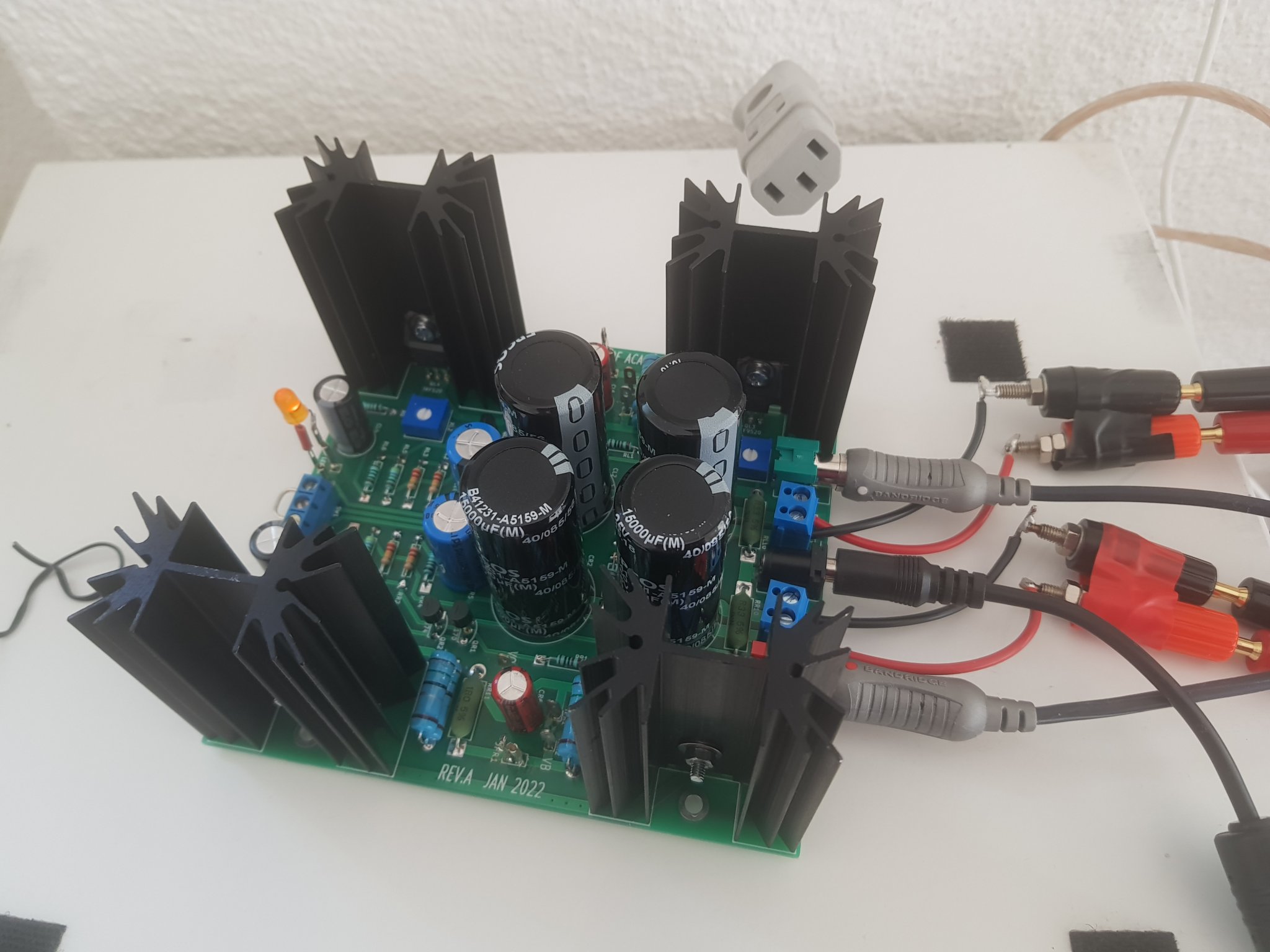

First testrun of my new ACA Mini almost clone. Adjusted to VO 15VDC and VB 0.3VDC. The heathsinks are about 55 degree celsius in my 21 degree apartment.
A great sounding little Class-A amp, I am (not) surprized!
I will build it in an enclosure this weekend and then post another pictures.
Thanks to Nelson and Kevin!!!
