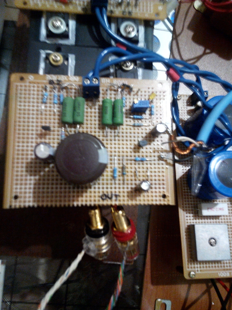

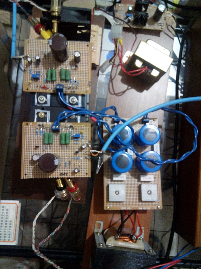

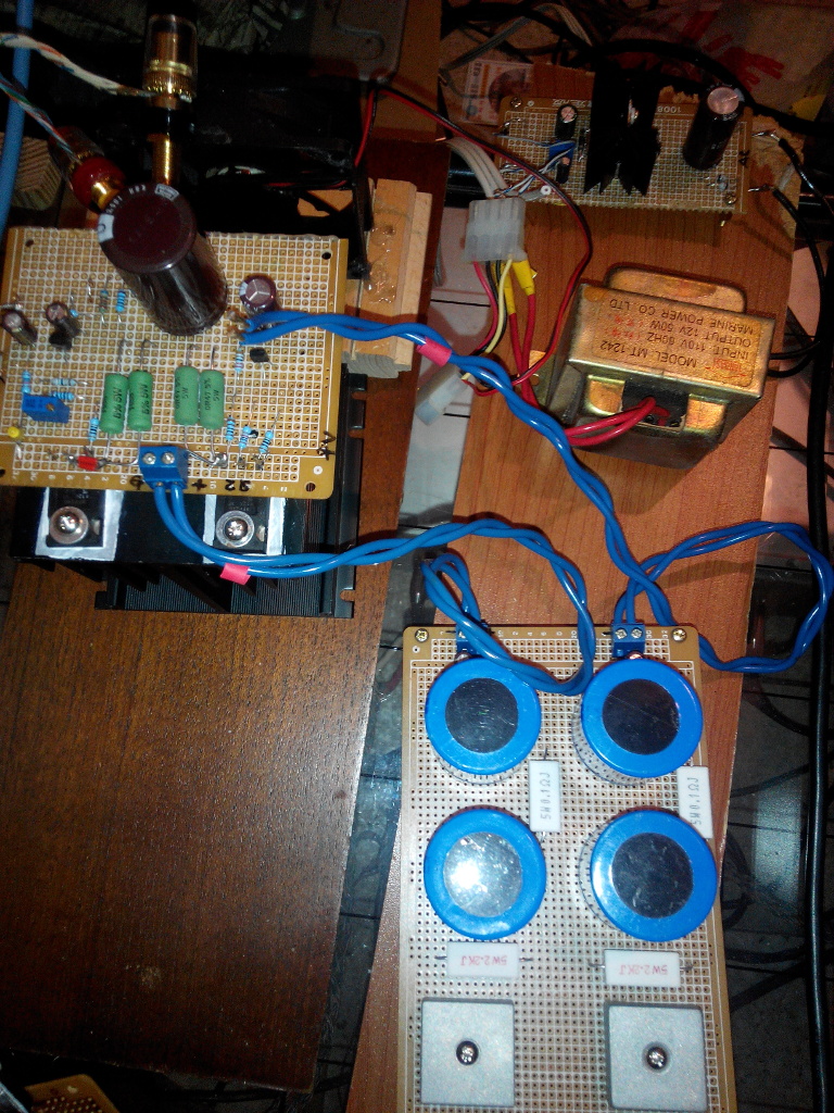

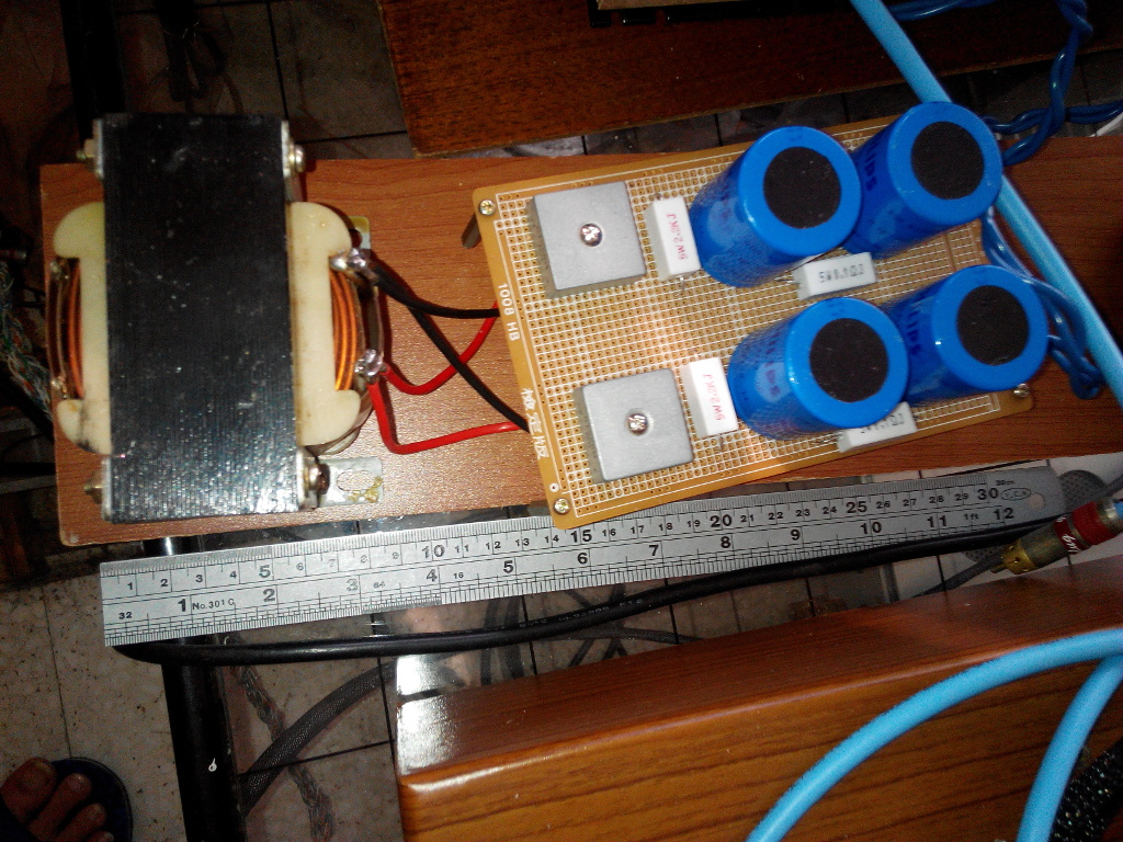

i have finished my ACA, when test single ch, all is fine, but combined 2ch it will produce a little hum.
my setup is
one tx 18-0 6.5A to
2x crc for 2ch (brigde+10000u+0.1r/5w+10000u)
now is naked test.

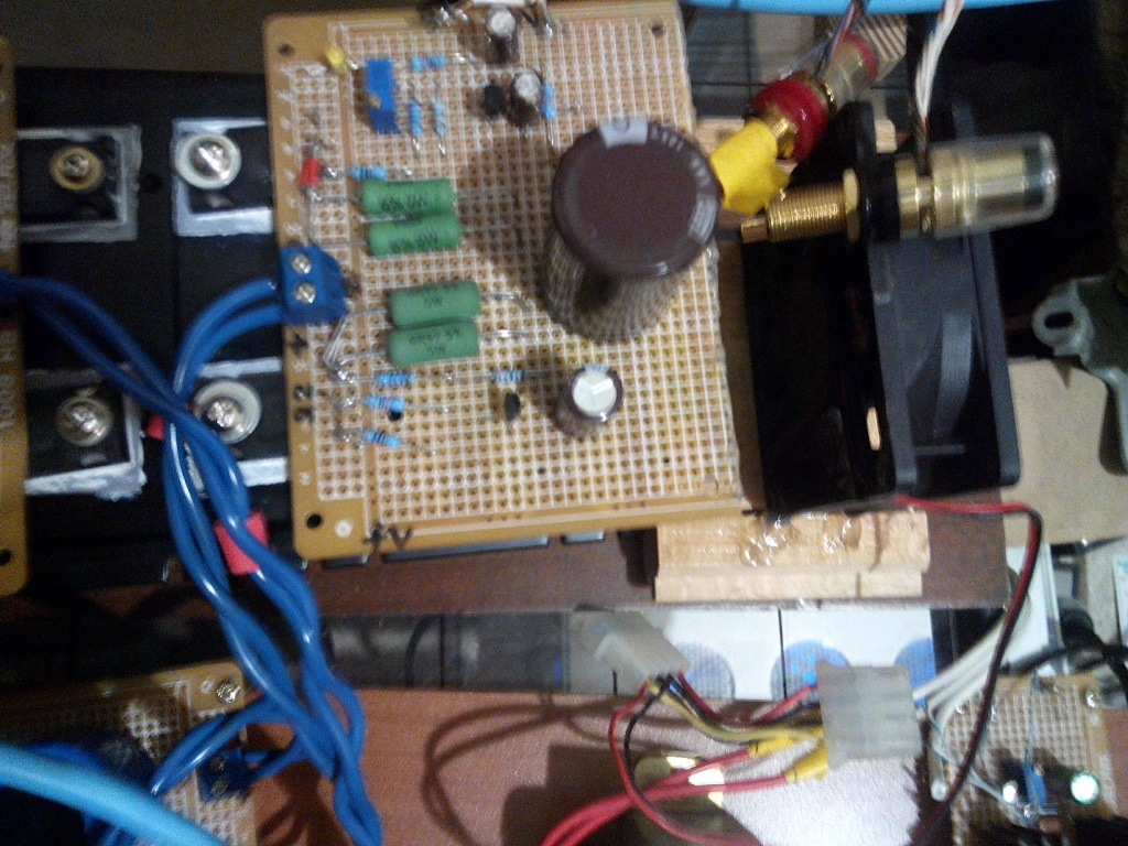

i have added a fan (drived by 7v to help heat sink, due to my heatsink not big enough).
any advice, thanks.

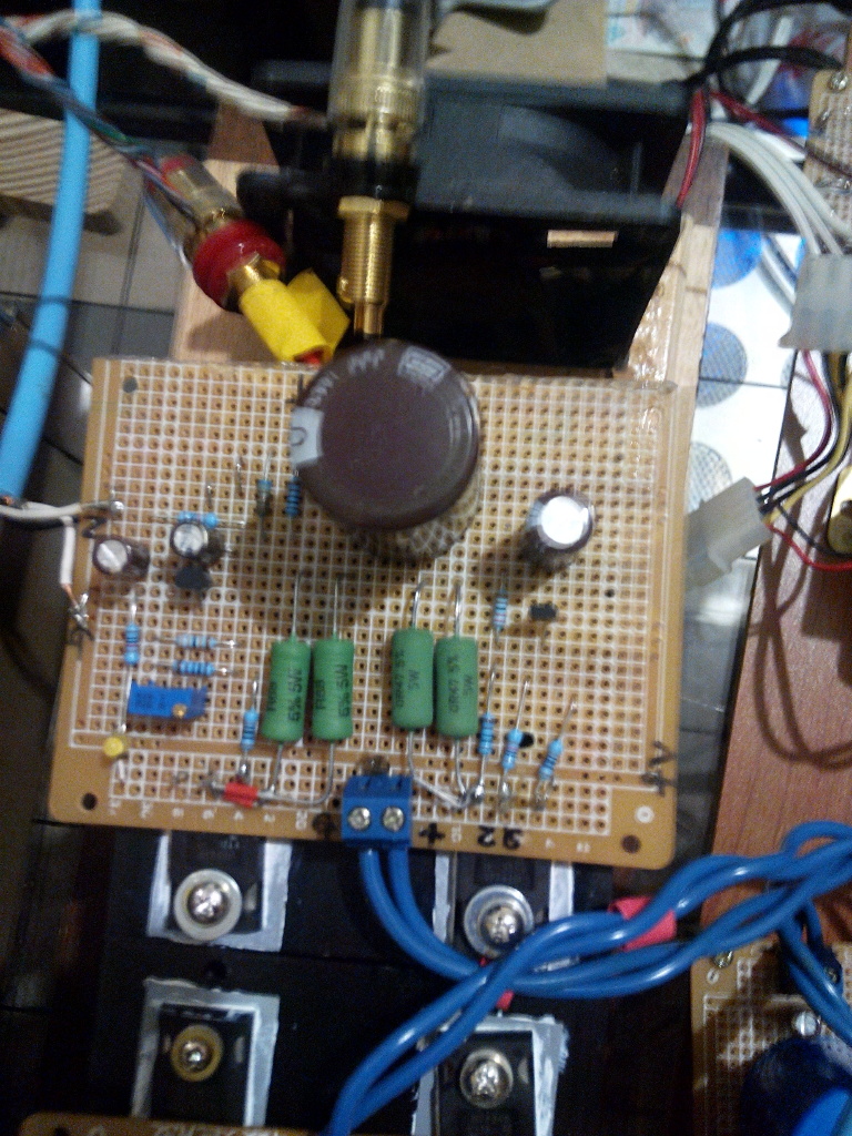

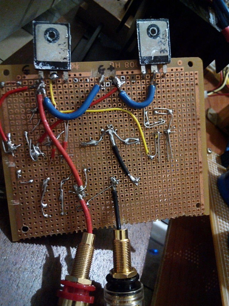

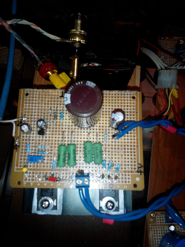

Here is pictures.
The fan is between two heat sink (tunnel inside).
Sorry, I'm in busy.
Here is pictures.
put fat wire bridge between two pcbs , connecting their gnd points
though , final wiring layout tweaks must be made in case

I put a 2mn wire, ja, it is gone at silent night. This is drive my 86db speaker.
Will try to drive my 97db FR in the future.
Thanks to Mighty ZM.
