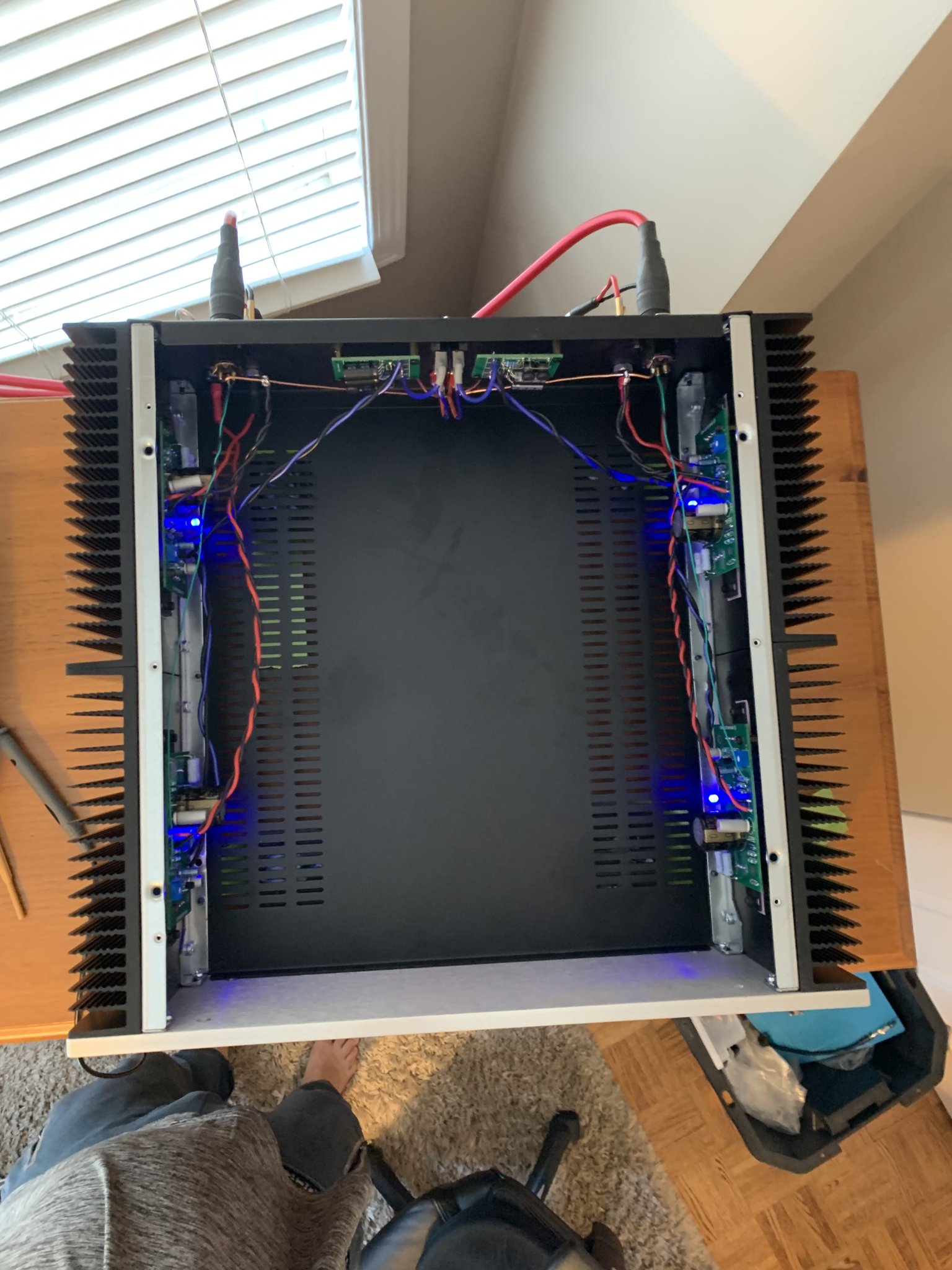

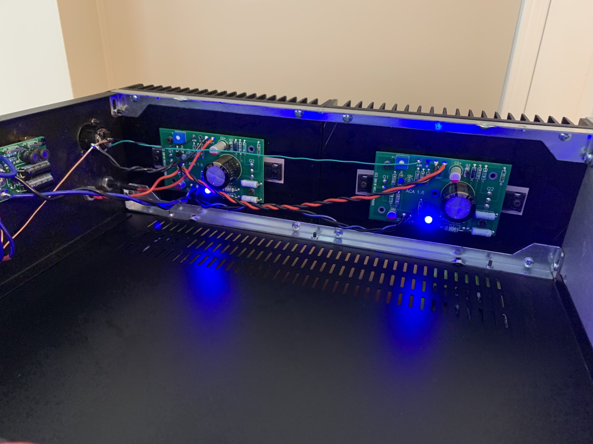

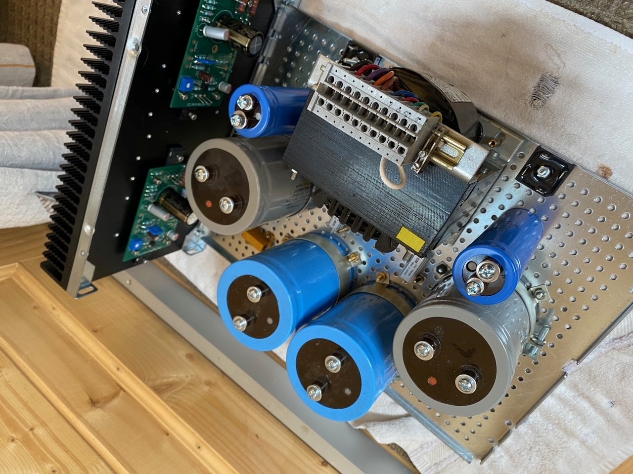

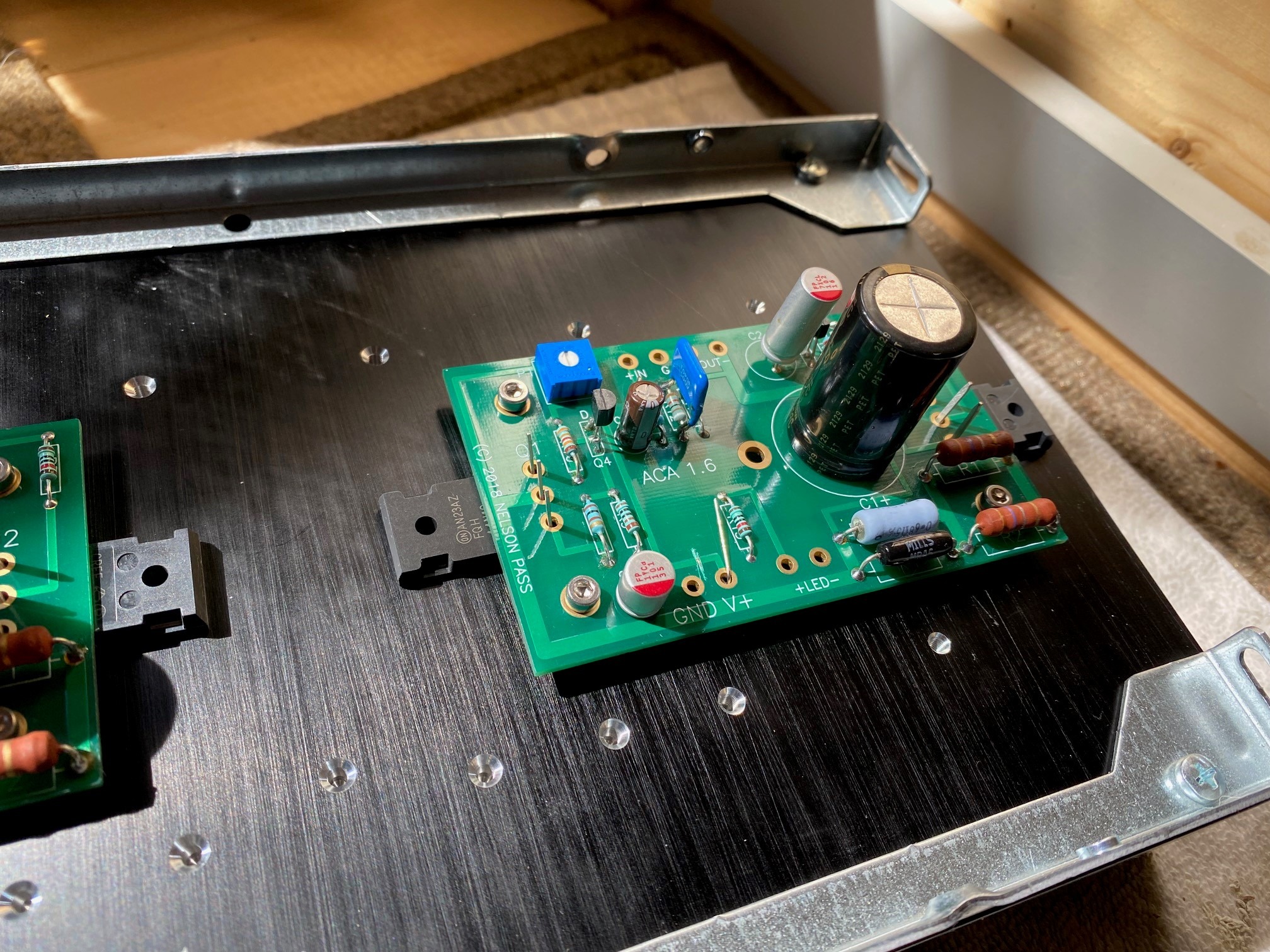

Dual parallel monoblock ACAs to reside in a single 4U full width chassis with substitute UMS heatsinks. Discovered the factory mounting drill / tap layout does not accommodate direct screw in installation of ACA PCBs. Boards mount from supplied standoffs with their corner eyelets (not the center eyelet as in the stock ACA chassis). I need to drill and tap 8 mount holes for the MOSFETS. M3x0.5.
I'm really interested to hear about the differences that you hear when you move to a LPS, I have my ACA running at 36v with dual mono SMPS, way too hot for the original chassis so would really love to move to a larger chassis, and build a power supply. Excited to see how yours turns out!

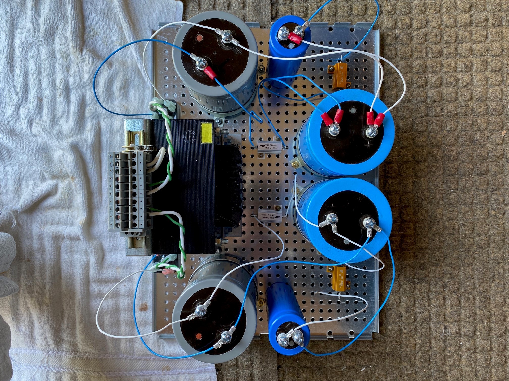

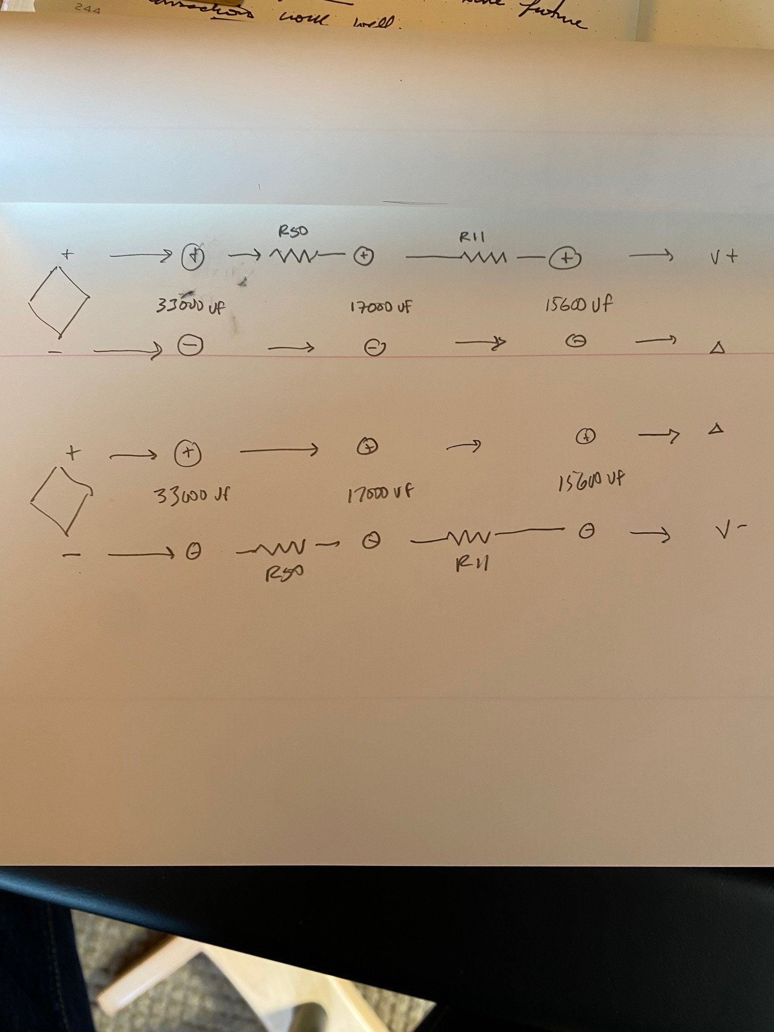

@Zamjazz27 - understand your concern, my stereo ACA at dual 24v SMPS runs hot, so yours hotter I get that. This morning Keratherms arrived from the DIY store so the PCBs are mounted to the sinks. Now I need confirmation my LPS schematic is correct, then finish wiring bring the amp(s) up and report back to you
It looks like the basic schematic and layout should work.
I probably would have chosen different capacitors for the final bank, but if old computer grade caps are what you have, they are worth a try.
My preferred caps are Kemet ALS series screw terminal for wiring point to point.

Thanks Tungsten. Solid copy on your advice. Accordingly I've changed around the order of caps, placed the computer grade adjacent to the bridge, and the Nippon Chemi Con will be last in the chain feeding the PCBs.It looks like the basic schematic and layout should work.
