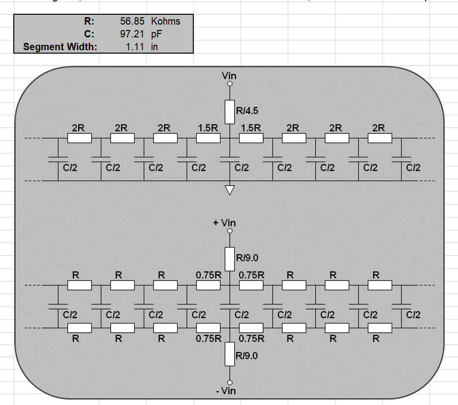

According to bolsert's spreadsheet for my panels I need approx 50k ohms of resistance per segment. I'm not terrible concerned about the precise ohms I need since I will be crossing above the LF dip. A little more resistance is preferable to a little less.
Right now trying to figure out what the minimum number of resistors I need in the segments for power dissipation. I am trying to conserve how "wide" the resistor array is given my panel width constraints.
I think I can get away with 5 in the "1st" and 4 in the second etc... down to 2 in the outer segments with 2W resistors.

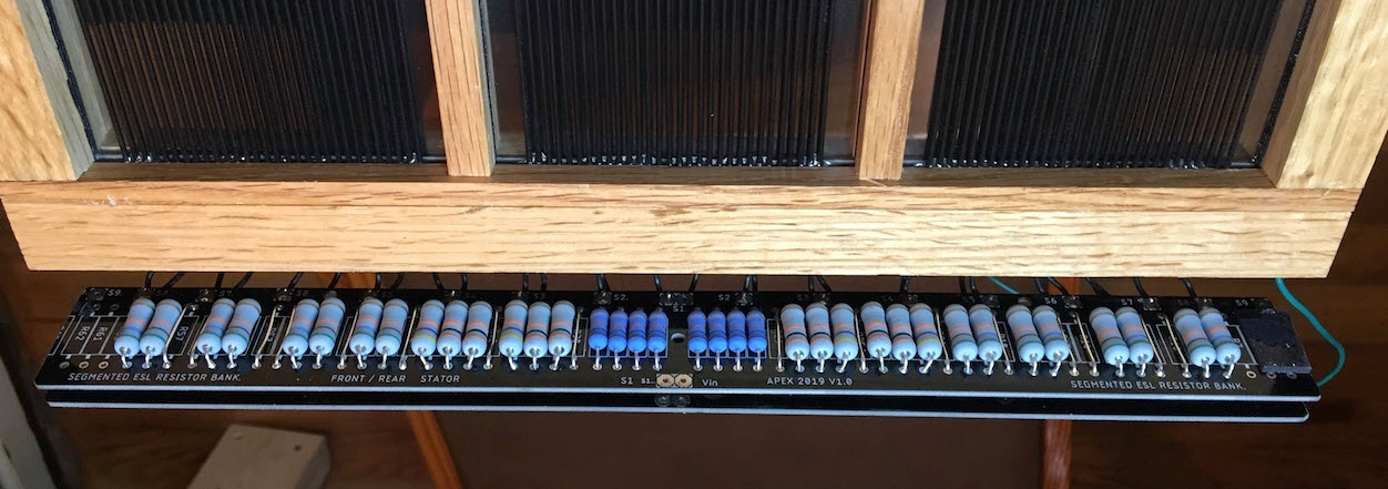

On my latest speakers I also used 2W resistors: (4) then (3), (3), (2), (2), (2) & (2), as shown in the photo below. No doubt I could have gotten by with just one resistor on the final three segments.
I'm bi-amping my speakers with a pair of stereo 225W/channel power amps, playing them at ridiculous volume and it's not a problem.

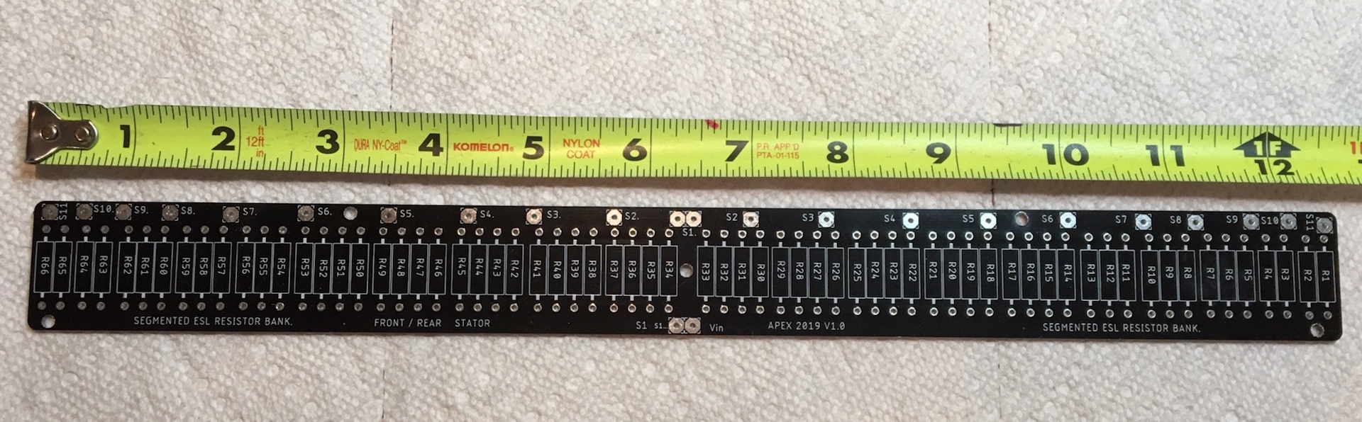

How wide is that resistor PCB? And any chance I can get my hands on one or the design drawings?
I'm working in fritzing now to draw up one and be nice to A) not go thru it or B) tweak an existing one to my needs 🙂
Check your PM box
I got those boards from a guy in Canada who built a pair of speakers from my drawings. His boards were setup to feed 11 segments and my new panels had only eight so I cut some off each end to fit.

Trying to figure out what the hell I was thinking given that I need somewhere around 50 kohms and no 2 of the resistors I have will come even close to that.
Seems they are exactly half of what I need. I think I'm reading the spreadsheet/schematics right. ~50kohms in "front" of a segment and ~50 kohms "behind" a segment.
Of course, center segment gets no resistance, ~1ohm on the primary of the stepups.

Appreciate a gut check on my resistor bank.
So reading over everything carefully again, I remember I had my panel resonance at around 124hz (after some heat treatment). This is why I can't even conceive of crossover over below 300hz (even that's pushing my luck). Thus is also why I came up with resistor segment value of ~50 kOhm.
So I decided to shoot for 54 kOhm.
Note for my 2nd segment I am look at .75R of ~40kOhm. I may adjust that a big if they are too bright.
My resistors are 2W. Only concern here is do I have enough resistors in the segments to dissipate the heat.
I plan to use the number resistors as laid out below. It's a 10 segment panel:
(none/1ohm Pri),(4),(4),(4),(3),(3),(3),(2),(2),(2)
Does this look good?

My resistors are 2W. Only concern here is do I have enough resistors in the segments to dissipate the heat. I plan to use the number resistors as laid out below. It's a 10 segment panel: (none/1ohm Pri),(4),(4),(4),(3),(3),(3),(2),(2),(2)
Yes, that should be plenty of heat dissipation capability.
Thanks for double checking that. As usual, much appreciated.
