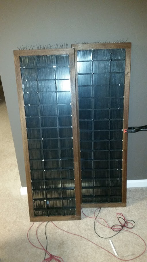

I'm back again for an update on my insanely long ESL project.... it sucks in that literally every weekend for the past 6+ months I've been busy with other projects....
At any rate.... onward.... so I managed get the diaphram on my second panel; after *several* attempts at stretching.... I did it the same way as my last one.
My excited resonance frequency was about 132hz right off the stretching jig (well, I did let it sit overnight). I applied a few rounds of heat treatment and got it down to about 124hz. I stopped as I was getting uncomfortable how long I was having to go over it with my heat gun on full blast.... I didn't want another hole.
So I have one at 114hz (as of my measurement a few months back) and one at 124hz... close enough I guess.
Also noteworthy, is I do have other modes of excitement under 124... like a big one (smaller than 124 though) around 65hz.... about an octave so kind of makes sense.
I have become a fan of heat treating after stretching. The one thing I cannot get a good picture of is the diffraction you see when you look at fluorescent light at a "glancing" angle across the diaphragm.
Before I heat treat, the rainbow patterns (for lack of a better word) are twisted, clumped etc... all across the membrane surface, after heat treatment they are pretty much straight up and down. I could be wrong, but this is telling me the tension of the diaphragm becomes more uniform after treatment. I have no idea if this has any impact sonically.
Next is coating.... electronics, then some more woodworking.

Got the coatings sprayed on... though I think I went a little overboard with the spray.
I tested both panels for resonance and they both come in right around 124hz after the coatings. Not sure why my older panel increased in resonance or if my testing method is sound but at least they are consistent between the 2.
Some largeish dust particles settled into the coating, should I remove them (if even possible)?
I think the bigger particles will vibrate off during use and the smaller ones won't be enough to affect their sound or performance..
Someone else more knowledgable than I will probably chime in though, I'm guessing..
How much coating is leftover in the can? I used just under half a can for my 15"x60" curved panels, that's probably overkill too, but I wanted to make sure they had full coverage. (plus a bunch wound up on a foam brush I used to spread it out)
Congrats on getting getting closer to completion, any pics you could post up?
Maybe a pic of the dust too, so someone could form a better opinion?
Cheers
-Steve

So finally got the panels together... Put the charging ring on and stuck them together.
It's worth noting that I used conductive adhesive copper tape and stuck the tape directly to the diaphragm coating (which does not go all the way to the edge).
Definitely not built to the tolerances/quality I would like them to be but hopefully they will sound good. I am concerned how accurate/consistent the d/s spacing is across the diaphragm given that hundredths of an inch matter 🙂.
I have not measured the resonance with a microphone setup. I kind of figured I've done all I can do with it anyways other than try to go lower and redo the diaphragm. I think in the long run, I will be better off with a bit higher tension/resonance anyways.
Here is a pic of the current state. Have some touch ups to do on the grid, though I may not bother as I plan to cover them with silk screen for damping.
