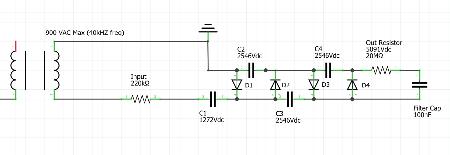

Attached is a rough schematic where I landed on my bias supply. All caps are 3900 pF with 4000V diodes. There is a variable supply input not shown so 900VAC is the theoretical max coming out.
If I've calculated this all correctly, it gives me a max of ~5000Vdc (noted on the schematic). I thought about adding another stage but don't think I'll need to go higher than that.
I read some stuff in the forums about whether to positive or negative charge the diaphragm, is there any consensus on which is better? All I can find is dust concerns... which I have an electrostatic air filter for my house so even more likely dust will be negatively charged, so better to negative charge the diaphragm.
You don't typically see final filter caps across the output of ESL bias supplies, as the multiplier should be filtering reasonably well to produce DC. If you want one, placing it before the 20 megohm resistor seems like a better spot.
I have a cheap pro-sound analog crossover I use early in designs to get things up and running. I like to know how things play together before committing to build specific new stuff. Being able to dial in whatever frequency you want with a knob is a lot faster than dealing with most digital interfaces also.
You are correct on the filter cap.. I made a mistake which I quickly realized when I was bread boarding it last night.
I just ended up deleting the filter cap. I used my oscilloscope to measure the output (at a much lower voltage obviously) and I couldn't see a hint of ripple.

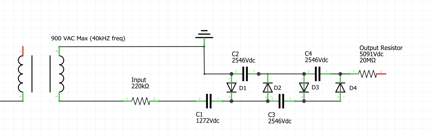

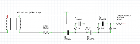

(updated schematic attached)
The output is on the other end of the 20Mohm resistor to "ground". I get pretty good arcing between ground and the input side of the 20M resistor so I'll take that as a sign the voltage multiplier is doing its job. I get no arcing on the output side of the resistor (I kind of expect that) but I can hear that is wants to 🙂. Hopefully, I don't have too much diaphragm leakage.
I originally was going to put a neon lamp on the output, I actually have a couple of them. I seem to remember it had more of a purpose than merely showing the supply is running.

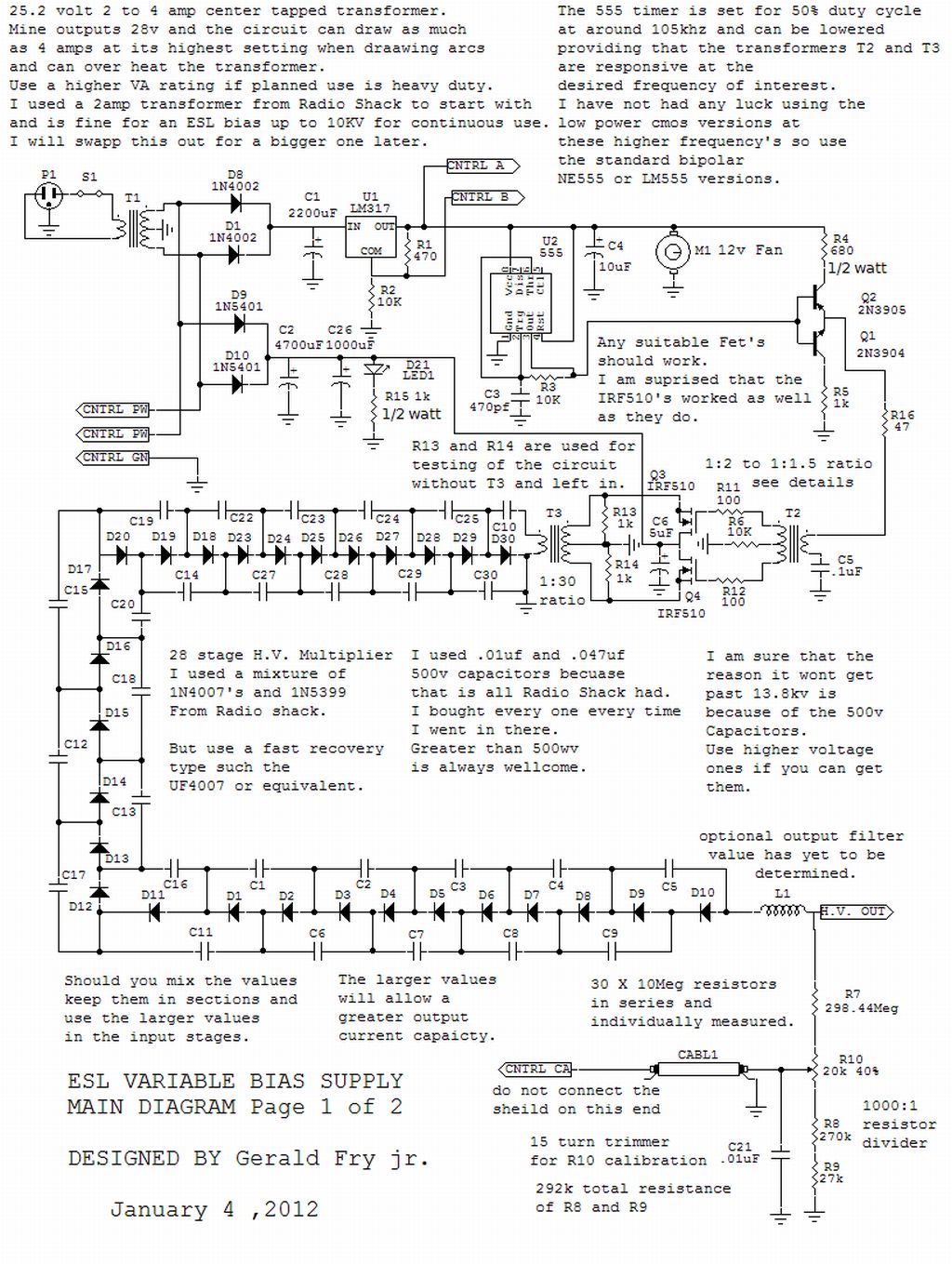

The last thing here is how the FET's are configured...........
It is just a basic classic ole Class B Linear Amplifier stage getting its full power directly off of the Filter Cap as shown on Page 1 at the top.
At the time I was truly inspired by Susan Parker amplifier design found here,
Zero Feedback Impedance Amplifiers
It made a lot of sense to me, so I used it, I would like to try this design as an ESL amp as well !! 😉
It amplifies the signal coming from the 555 and its two transistor driver whose level is adjusted as previously mentioned by the LM317.

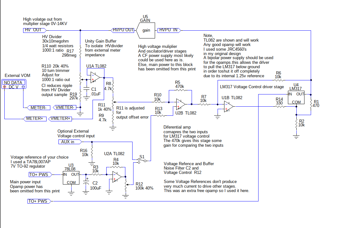

Next will be the Nitty Gritty, The operation and use of the opamp's in the feedback loop to control it.
Cheers !!
jer 🙂
Okay now that I have gone over the basic concept and the history of why this circuit came about I will walk you through the stages of the thing as too how this thing works as a whole.
But First, let's take a look at the data sheet of the opamp I used, the TL082, as we are at the mercy of what the opamp can produce overall.
There are better opamps to use but at the time the TL082 was all I had to work with.
Its data sheet is found here,
https://www.ti.com/lit/ds/symlink/t...rl=https%3A%2F%2Fwww.ti.com%2Fproduct%2FTL082
In future builds I plan on using ones from LT, I have been looking at some Rail to Rail types and possibly maybe using a chopper based stabilized device for even better accuracy.
But any good decent opamp will suffice here.
The TL082 has a typical voltage rating to be used at +/- 15V but it does have a maximum rating of +/-18V and on page 10 of the data sheet the graphs there show exactly how much voltage swing you can get out of the device.
In my case the results about 13.8- 14.2v peak with a 16V supply and corresponds to my maximum output setting at 13.8KV at 1V of control voltage to 1000V of DC output.
To get any more than this I would have to increase the number of multiplier stages and increase the loop gain to something like .5v in per 1000v out because the opamp simply cannot produce any more voltage than this.
So in order to get this high of a swing I had to set the power supply rails as close to max as possible that I could get it and to do this I choose not to use any regulators as commonly used in such circuits.
I didn't have any LDO types in that voltage range on hand and it would have added even more cost to the design as well if I would have had to get some, in fact they hardly even existed at the time and were just coming about.
So the next best thing was to use two diodes in series off of the main power rails at 17.82V, this gave me the needed 1-1.5v drop that I needed to be Just Below the 18v maximum rating of the TL082 to about 16V.
IIRCC earlier datasheets stated that 16V was the maximum but it is 18V I guess and supply headroom was the reason for concern, in fact I have blown up a number of the cmos type TLC082's before I had realized that there absolute maximum is at 16v and no more !! .... so stay away from those for this type of circuit unless you take its absolute maximum ratings into account.
This also gave me enough headroom from any line fluctuations from taking out the opamp due to overvoltages spikes.
I probably could have gotten away with a more conventional design using a common DC source but I built it in stages so I kept it the way it is.
I also felt that it gave me a little more protection for some reason by keeping the sections isolated from one another as well, thus the reason for so many diodes in the power supply section of this device.
Especially for the opamp's since they weren't regulated.
Now on with the gain structure. 🙂

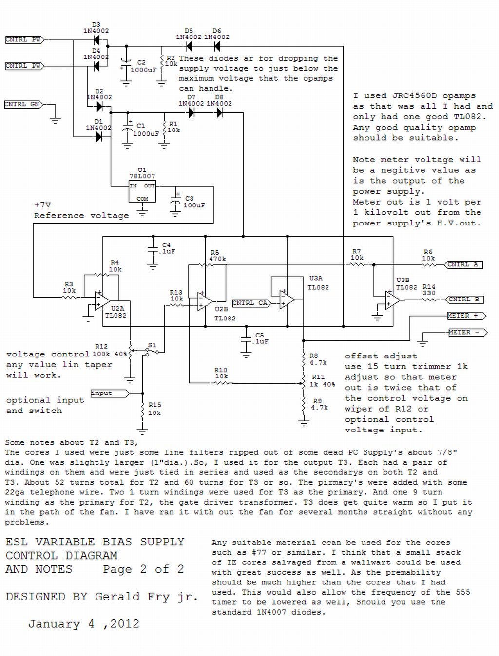

Starting at the top of page one you see two points " cntrl A & cntrl B" at the lM317 this is where feedback loop is inserted the magic begins !! 😉
"cntrl A" is the output sense line of the LM317 and "cntrlB" is the control input to the LM317, all else is the same for any LM317 setup and is set at its highest possible voltage output.
Now down at the bottom of page 1 we'll look at the resistor divider stack.
This calculator came in extremely handy at this point,
Voltage Divider
In the earlier stages of design I was using about 100 megohms on the stack.
Even though this worked fine I found that it was producing more of an unnecessary load in the supply than I had liked, so I upped it to 300megohms.
Also with the smaller number of resistors in the string I was exceeding their voltage coefficient rating as well.
What this means is as you raise the voltage across the resistor its resistance at that voltage changes by X%.
I didn't take the time to measure this but I almost did since all of my resistors were from Radio shack and I could not find any data on them at all.
So I did the next best thing and searched out all of the resistors I could find and found them all to be in a range of 200v-350v for the 1/4 watt types and even found some as high as the 500v per resistor.
I choose 250V at my starting point and this put me well below that a 166.6V across each resistor at 5 KV and 300v at 10 kv and a max of 500v at 15Kv of voltage across the stack with 30x10megohm resistor stack.
As far as Power Dissipation loading of the stack it comes to 15KV^2/ 300,000,000 ohms at .75 watts for the whole thing !!
10 times under the rated 7.5 watts of 30 1/4 watt resistors in series and with only .5ma of current draw from the supply at 15KV !! 😀
Now after all these decisions about voltages ranges and such, 15 & 14 were the magic numbers and by chance I had just happened to have an odd ball 7 volt regulator in my parts bin so I used that as my reference voltage to keep things simple, else I would have used a 5V regulator just the same.
Next finally the whole feedback thingy !! 🙂
jer 🙂
Okay here it is !! 😀
I have redrawn the control section of this Power Supply design and I have included the original print as well for those of whom want to follow and compare.
I have omitted the opamp and driver power supplies from the print for easier reading.
It is pretty straightforward and the descriptions of the stages are on the print.
I plan on finishing this drawing to see if I can get Circuitmaker 2000 to simulate it for ease of future development as I have lost the original files.
If anyone would like to have a copy of the .ckt file I will post it in zip as it is not a supported file for some reason. 🙁 :headbash:
I do know that some people like myself still use this old software and it can be found on the web if you search for it.
Else, one of these days I will reproduce it in LTspice as well since it is more common to use these days, not to mention more accurate for the most part.
I use it because I have had it for like forever since the 90's when I bought the original program for about a $1k that includes updates up until CM2000 was released, at which later I had found the key to unlock it after it was sold to Altera.
So, It is out there if one wanted to search for it.
I like LTspice but I find its editing features to be a bit cumbersome compared to CM2000 but it is more refined than CM2000.
Not to mention CM has its own PCB tools called Traxmaker and I use it a lot still, I used it to create the boards for this project as well and that is why I still keep it around.
CM2000 uses spice as well but sadly the program has been defunct since Altera bought it.
I don't know if it could be imported into the new Web version of Circuitmaker or not, I have not used the new version yet to find out as I don't much care for web based systems anyhow. 🙂
Cheers !!
Jer 🙂
P.S. I can't think of anything I have missed but if you have any questions, Please Do Ask !! 😉
