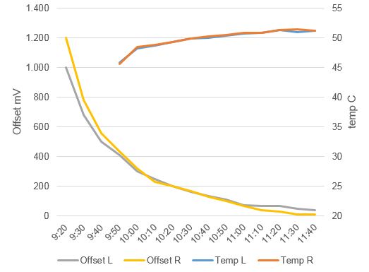

530mV is more than close enough ....... it's anyway arbitrary value ...... meaning - illustrating range , not exact figure
30mV of DC offset is more than good , if in temp. equilibrium , which also means - with top lid on
anything bellow 100mV is acceptable , less of course better

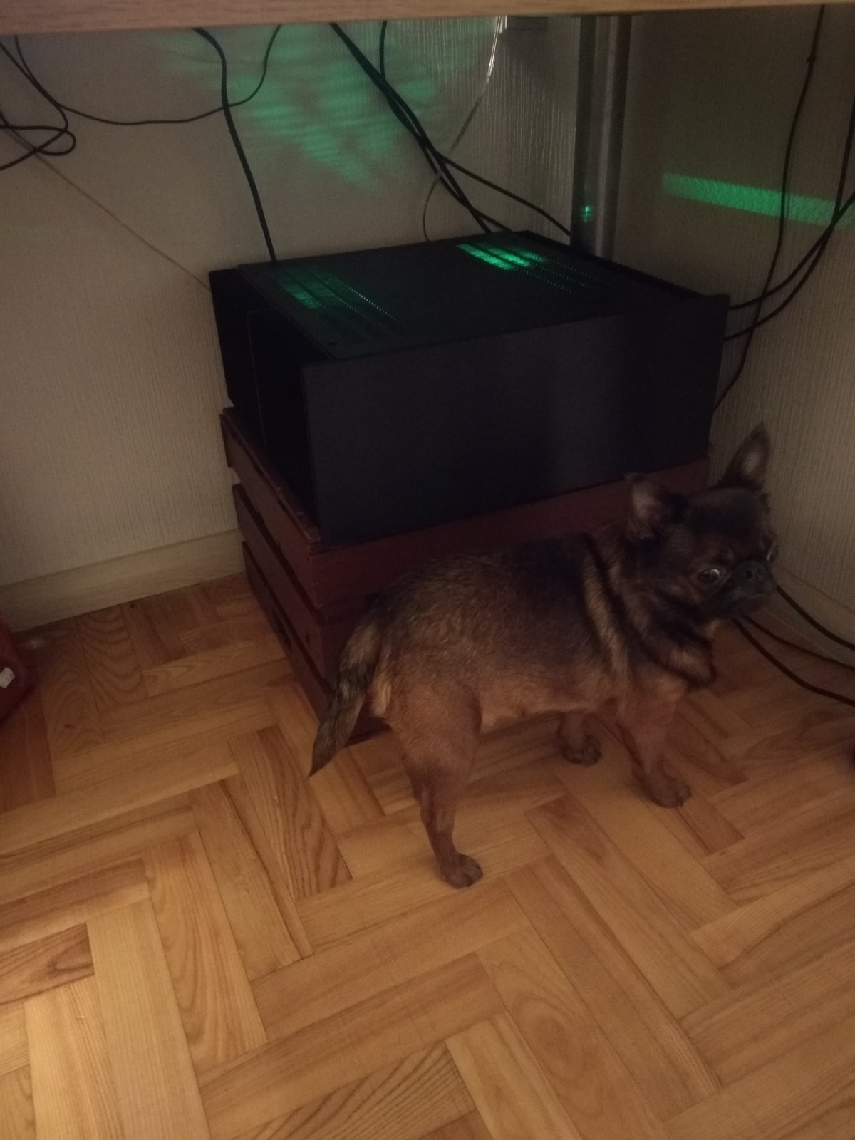

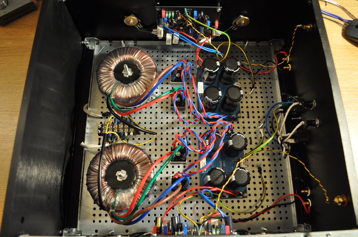

So I've been playing babelfish for a few evenings already. Haven't tested it yet with pair of Monitor Audio bookshelves, rather connected it to DIY full-range Alpair speakers. Before I had these speakers connected to class T tripath chinese amp so obviously the first impression was "whoa! where all these sounds come from" 😀 Bass is so much more tighter, more pronounced. I can hear every single recorded detail. It brought Alpairs to next level, though I think the bottleneck switched to speakers now 🙂)
Attaching few photos.. Still planning to get the front plate Babelfish J logo made, I think I seen it attached in this thread somewhere. Also need to allocate some proper space for the amp, otherwise it is serving now as good heater for the doggo.. 😀
Thanks ZM again for help! With the amount of information around it is quite a good project for the beginners.

Dear all,
I had nothing to do this morning, so I checked the dc-offset of my Babelfish j, that I built about two years ago. That time the dc-Offset started at 800mV and sank to about 0 really slow.
Now it starts at 1,2 V and sinks as slowly as earlier to zero, as you can see in the diagram.
Will 1,2 V destroy the loudspeakers? What should I do to lower the initial offset?
Best regards, axel
