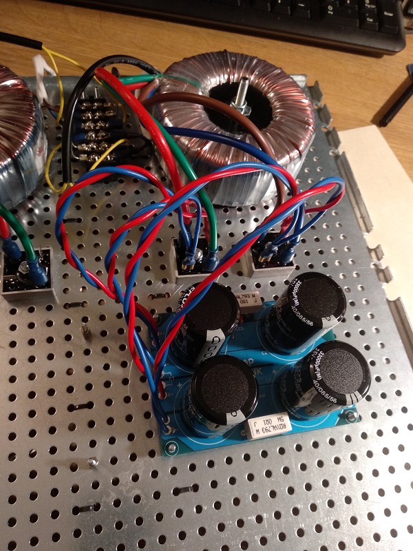

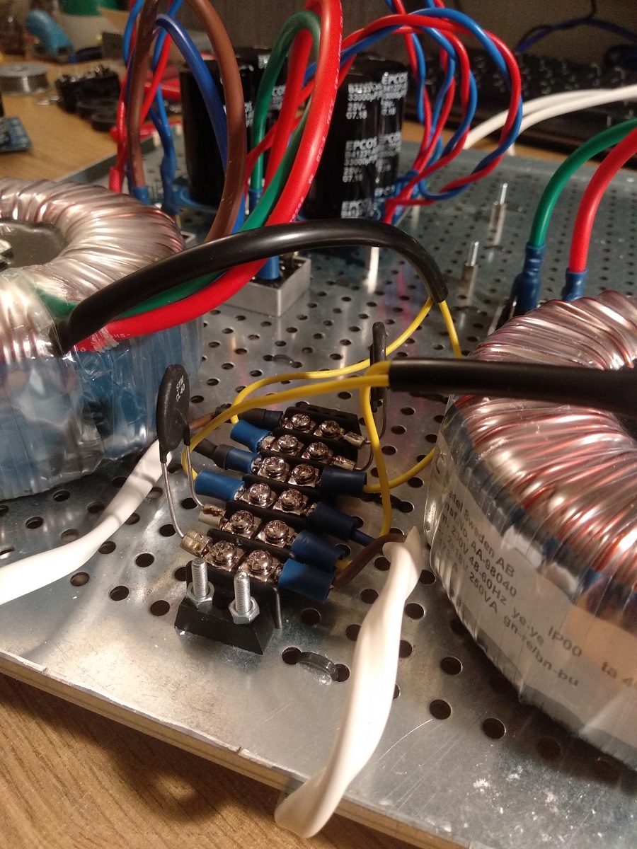

Got slightly distracted from the project for a while
Anyways, started wiring the whole thing, wanted to check if I'm on the right track... any suggestions would be highly appreciated
White double flat wires - mains coming from power inlet module
Yellow wires - mains input to transformer
Added 2 CL60 via terminal block - hate the wire mess there :/
Blue/brown and red/green pairs - secondaries into bridge rectifier
Doubled DC wires from bridge rectifier.. red-positive, blue-negative
Haven't done cuts yet to back plate, but was planning to have IEC, switch and fuse in single module. If fuse have to go per transformer I'll switch to separate IEC, switch and two fuse holders.. I am planning on going with slow blow fuse ~3A, does that sound right?IEC , switch and fuse holders (one per Donut) ?
made bulb tester yet?
Not yet, but I will definitely have one knowing that something might go wrong Assuming you're talking about one on mains.

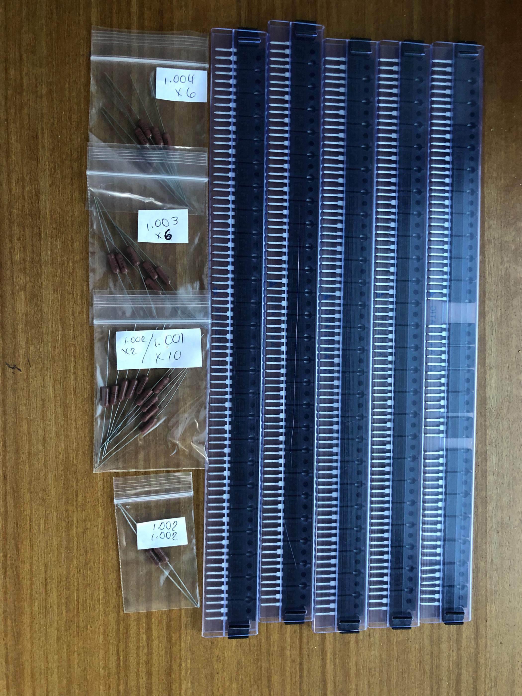

For some reason I didn’t pick up that the mosfets had to be matched, my bad! I did use all from one sleeve so maybe not too far off.
I ordered another 150 pcs (IRFP240) to match up and ordered matched source resistors too.

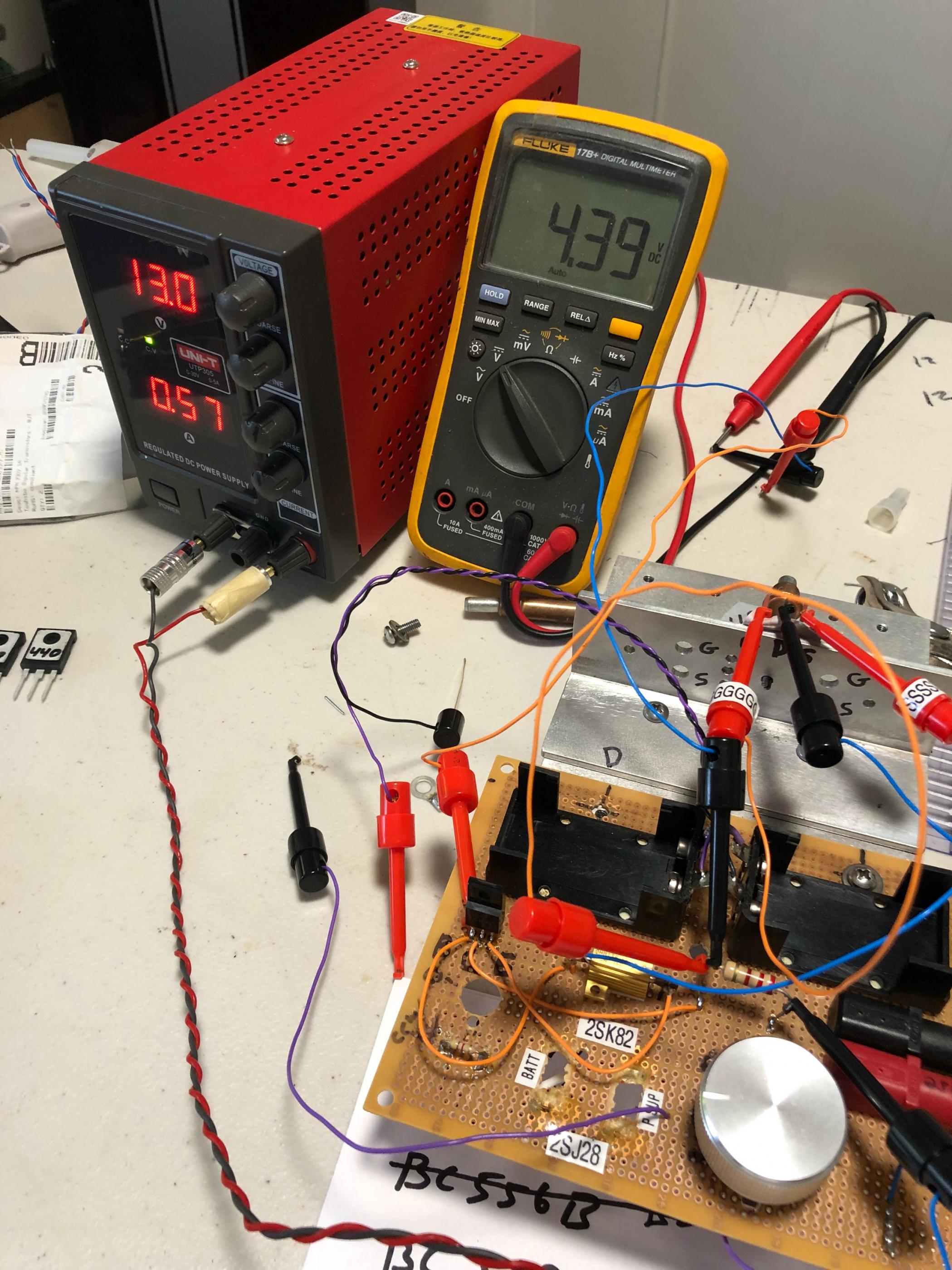

My question is what voltage and what size resistor should I use for my build? In Nelson Pass’s 1993 article about matching (http://www.firstwatt.com/pdf/art_matching.pdf) he uses 15v with a 560 ohm resistor for VGS in the 4-4.6v range.
I set up a little test rig and using those voltages, resistor, and 20mA current I am getting results in the 2.7-2.9 range on the first few I tested this way.
For final testing I am planning on heating them up to operating temperature too.
Can you comment? Thanks

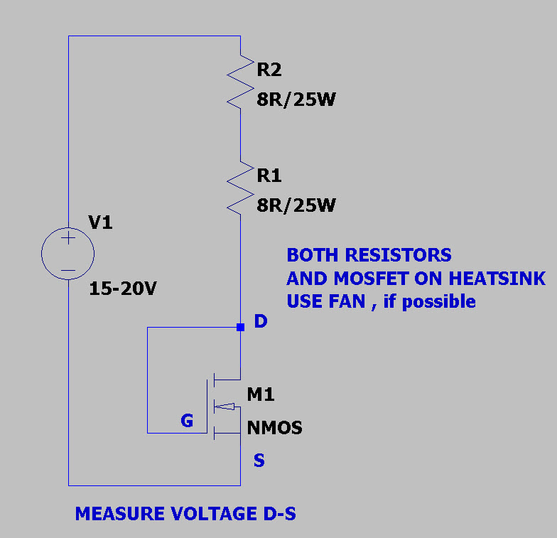

Yes to both power supply and I have both 4 and 8 ohm load resistorshave PSU able to deliver 1A or more , from 15V to , say 25V ?
have some power resistors , those golden ones , 25 to 50W ....... 4R or 8R ?

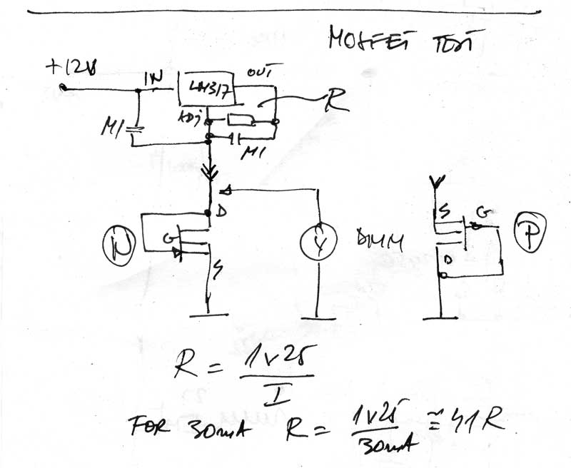

started drawing something in spice , then remembered that I must have something from before
anyway
anyway
Thanks for the reply and drawing!
My power supply can go to 30v and 5amps.
The resistors I have are 120w. Put into series for a 16ohm load. Bolted to a heatsink, no added heat.
I just tested one at 20v, this setup drew .53amps, and VGS was 11.48, and slowly dropping.
Is this a good process, except maybe to heat them up to operating temperature first?

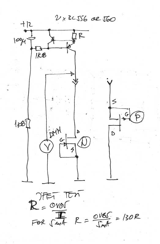

here's fishing apparatus for ya:
http://www.firstwatt.com/pdf/art_mos_test.pdf
and few older back o' napkins

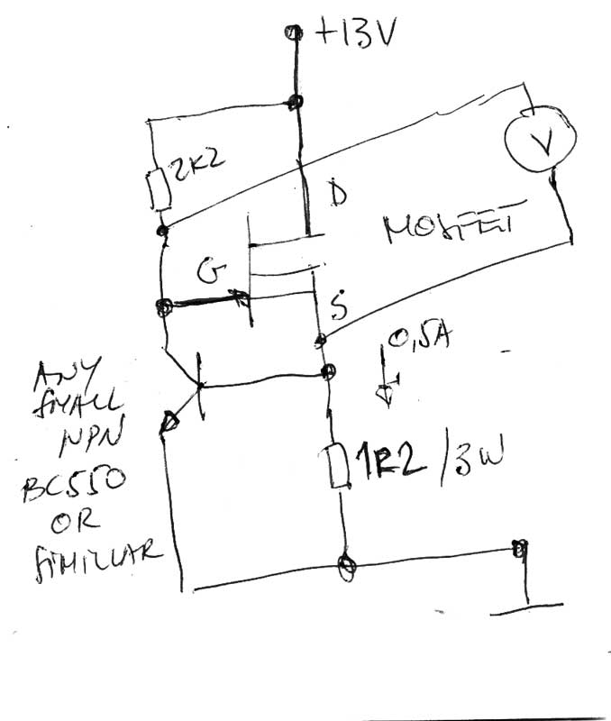

I think your playing with me, you know this is over my head!
But I tried to follow this;
With the exception for the BC 550 (BJT, NPN) I only had a C4793. And for the 1R2/3W I used a 1R/5W.
Don’t laugh at my test bed, but here you can see the volts, amp draw, and VGS.
I tested 3 at room temp, volts and amp draw stayed consistent, VGS was 4.29 and 4.40 on the other two.
Work? Thanks in advance.
