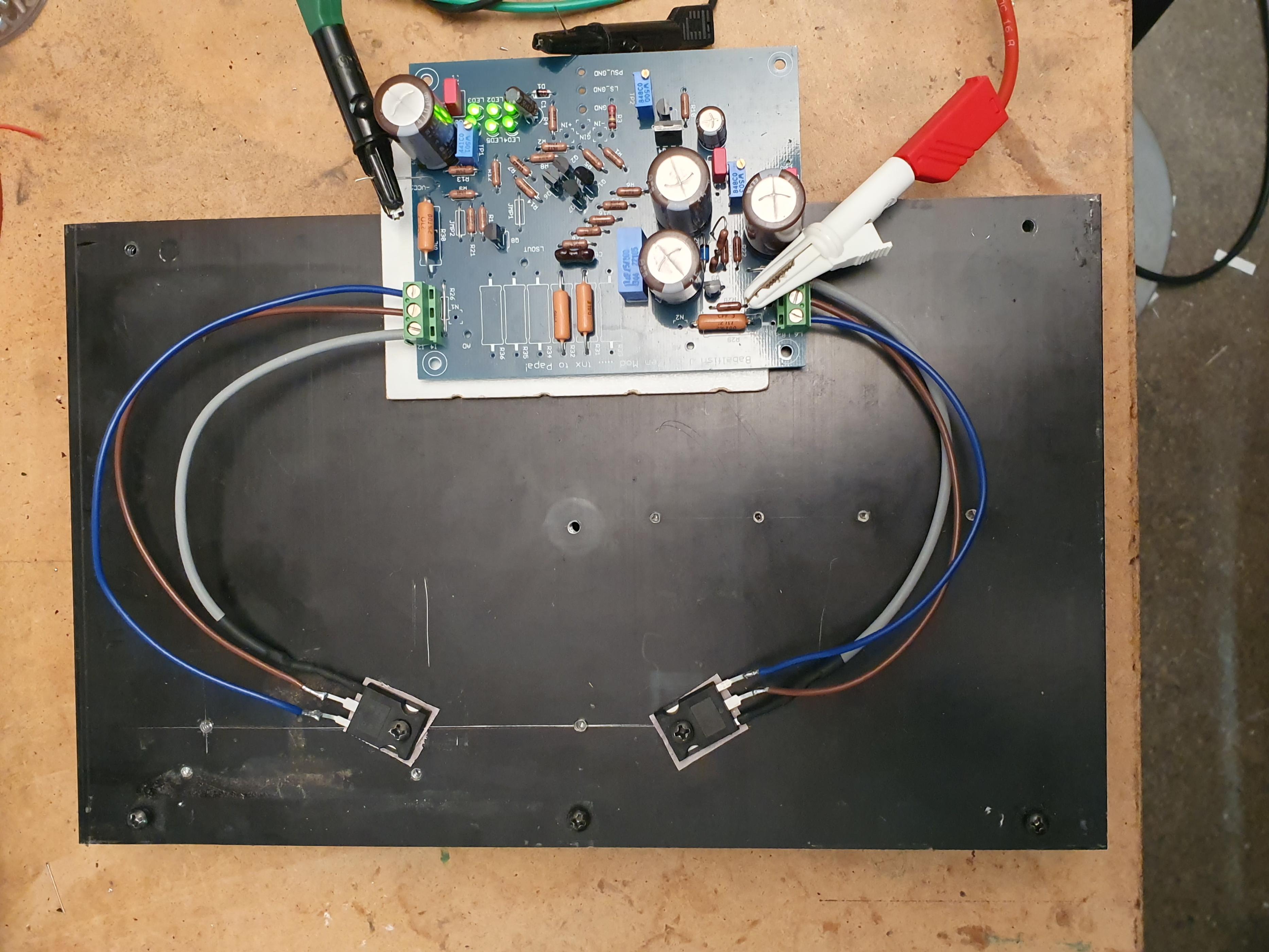

I finished the first board and fired it up. I used a lab / bench PSU set to -20V/0V/+20V, with current limit set to 2A. See photo in the attachment.
The good news is that there was no bang, no magic smoke, and no funny smells; and the green LEDs light up nicely. The bad news is that the speaker out sits at -20V.

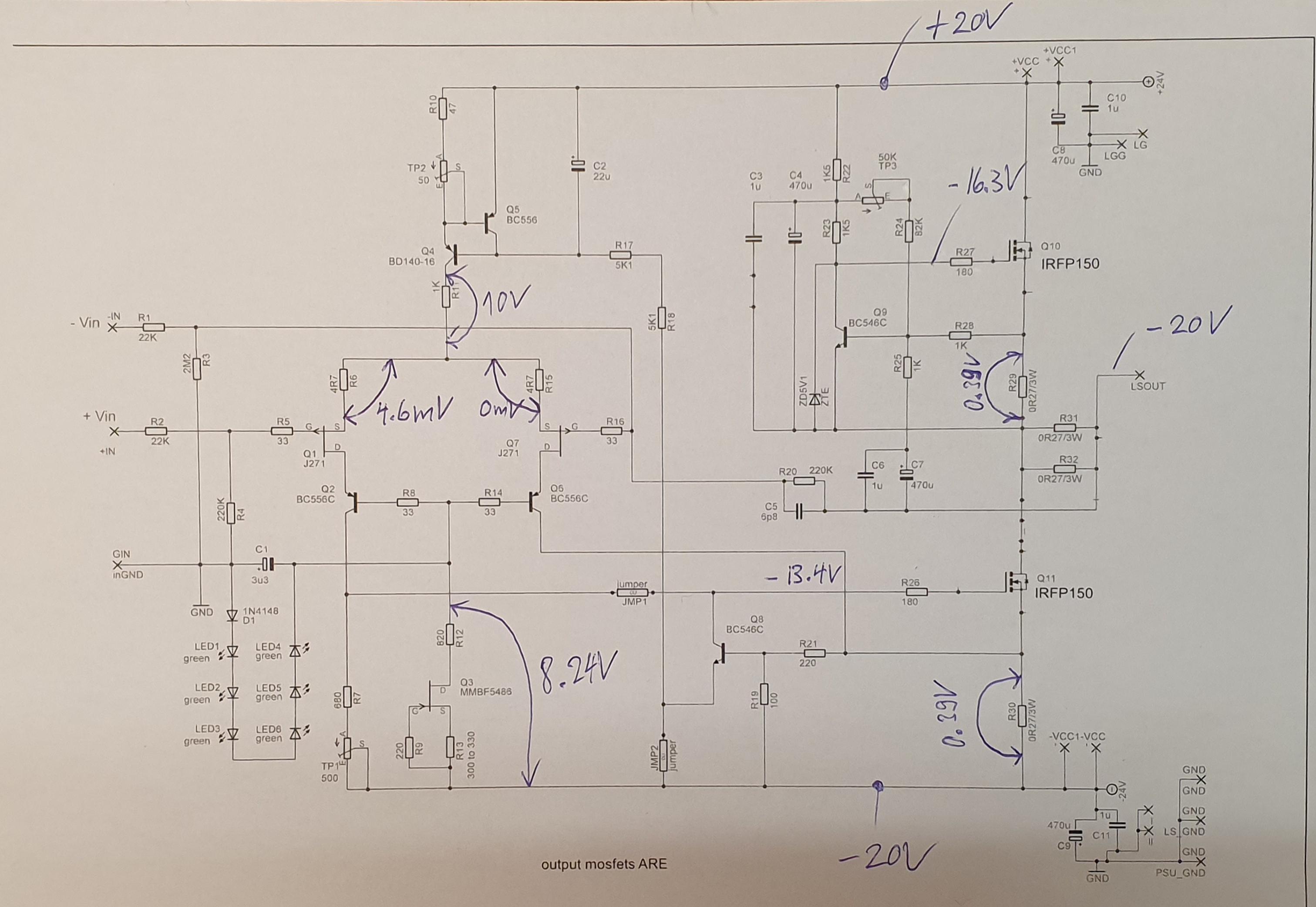

To isolate the problem I took a few voltage readings and noted them in the schematic (attached). As far as I can tell, there is no current flowing though R15, Q7 and Q6.
Any ideas why this would be the case?
Is there a way to check if Q6 or Q7 are okay without taking them out of the PCB?
Any hints and suggestions would be great!
first thing I'm seeing on pic - never squeeze mosfet with bolt without using proper big washer , plus spring washer ; ceramic case is prone to break if bolted like you did
negative offset means your lower mosfet is having too low impedance - meaning it is too much open
If you don't have any other mistake - check value of R7 and if needed change it to lower value ..... even if I can't fathom how that could be needed - prescribed 5mA per LTP side through 680R ( which is minimal value of R7+TP1 string ) is hardly enough to open lower mosfet to desired value ....... which is approx 4V+ voltage sag across 0R27, ref. to lower rail
ground inputs , both of them , while setting
TP2 is there to be set just once - to have 10V across R11
no easy way of checking Q6 and Q7 without desoldering - but once you did it - bjt is easily check either with diode test or Hfe test in DMM , while JFet is most easily checked with simple JFet matching jig
though , I see no reason that something is gone Puff! , myriad of channels were made , with same equal values and same parts

Ok, here are few more test results:
For some reason Q7 and Q6 don't want to pass current. Both parts are from ZMs bag that came with his PCBs.
Does this ring a bell? Any ideas?

- I changed R7 from 680 Ohm to about 400 Ohm. This did the right thing, in the sense that the lower MosFET was now more "closed" than before. I was able to adjust the speaker output to -2V...2V or so, but there was a lot of drift.
- I found that with the lower R7 value the voltage across R15 was still 0 mV, so there was still no current going through Q7 and Q6. I restored R7 to 680 Ohm and then put a jumper across Q6 (collector to emitter), and voila: current was flowing through R15, and adjusting speaker ouput to 0.0 V was possible, with MUCH less drift.
- I desoldered Q6 from the PCB (and damaged the eyelets for Q6 on the PCB in the process). I tested Q6 with the diode tester on my DVM, and it seems fine.
- I found a BC556B in my junk box, so I installed it in the position of Q6 (which should be a BC556C). The amp behaves as with the original BC556C: speaker output sits at -20V, and voltage across R15 is zero.

Q6 from bag of my parts is OK with Hfe test , and behaves in circuit same as Q6 from your bag
confirm that you have same voltage at bases of LTP cascodes - Q2 and Q6 , ref to GND
idea is to have them at 6 x LED voltage + PN (1N4148) voltage , which is 6 x 1V93+0V65= -12V2 ( minus means negative , under GND), so emiters are at 0V65 less (-11V55) , and that you need to see at their emiters , thus JFet drains

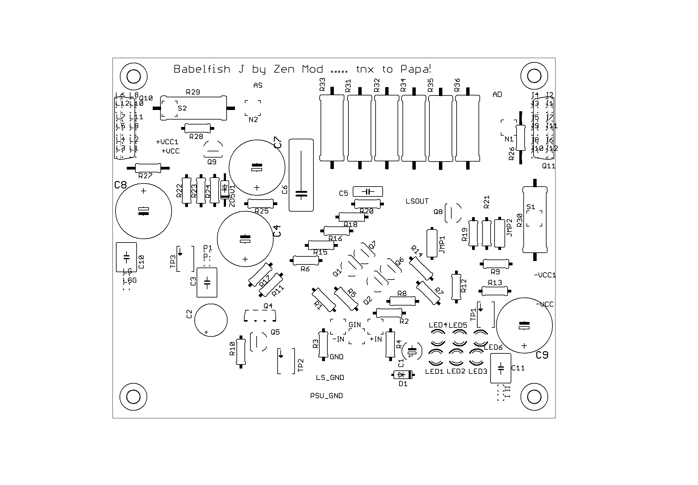

edit: find parts placement pic enclosed , it's handy

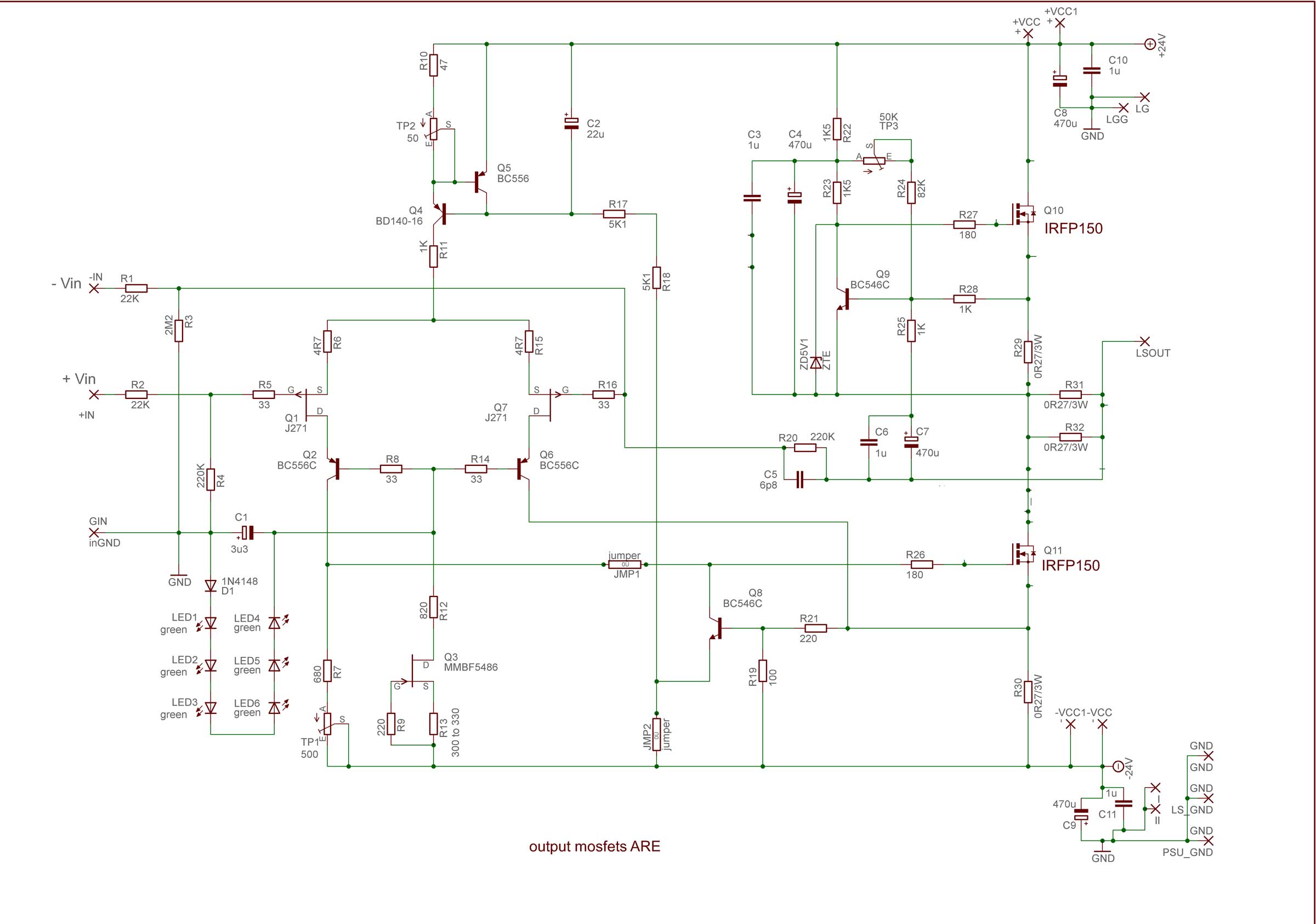

And then there is another thing: during my debugging work I found that the labels of R19 and R21 on the PCB are not consistent with the circuit diagram:
ZM, can you please check this?
Does it make sense to swap the resistors R19 and R21 on the PCB?
- On the circuit diagram, R19 connects to the negative rail voltage and R21 connects to the source of Q11.
- On the PCB, R19 connects to the source of Q11 and R21 connects to the negative rail voltage.
In other words, which configuration is correct:
- 100 Ohm from Q8 to negative rail and 220 Ohm from Q8 to Q11
- 220 Ohm from Q8 to negative rail and 100 Ohm from Q8 to Q11
just remove R19, R21 and Q8
those are parts for Sissies , needing some current limit down
Ok, now I finally understand what these parts are supposed to do. Why would anyone want to limit the current? Current is good! [emoji6]
ref. to enclosed sch. just value of R7 , decreasing or shortie
