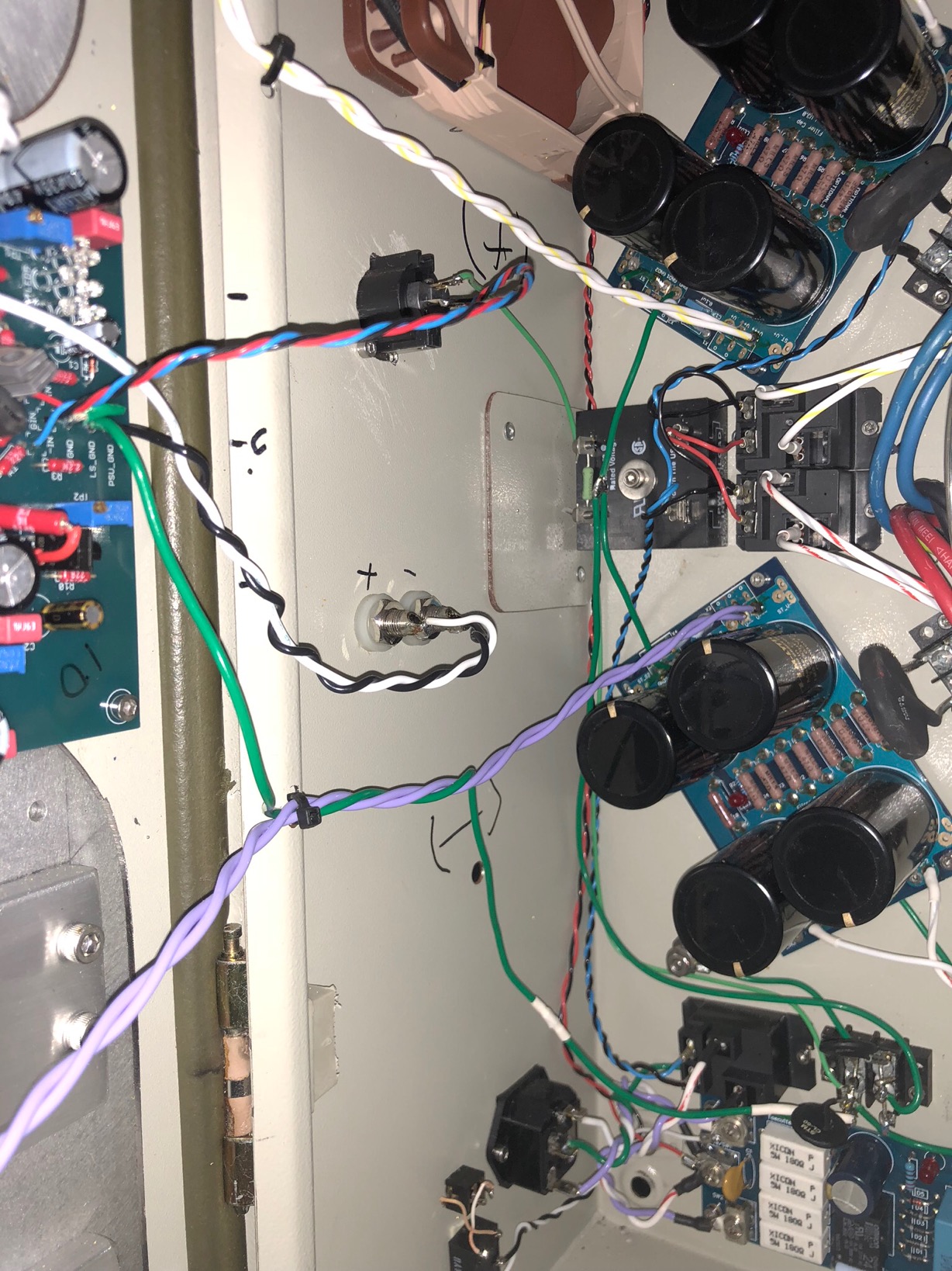

Yes, first try was shorting the input, still had a hum. Then with clippy leads grounded the tab on the XLR body, that made the biggest single improvement. Then separated the power supply grounds from the FE board grounds and with clippy leads tried every option of terminating (including markup in pic). Connecting both the PS and the FE board directly to one side of one cl60 (with the connection point of the ground wire to the center between PS, should have made a better drawing) was the lowest amount of hum, almost good enough, had to literally put your ear to the driver to hear it. Then for fun, since I don’t know any better, added the second cl60 just for the FE board.
as I see it , you have non-symmetric line between two PSU pcbs
that's dirty gnd ....... and that's why I drew that little sketch
not saying that's only problem in your grounding scheme , but certainly is first

Here is a pic of the final ground wiring, no hum at all.

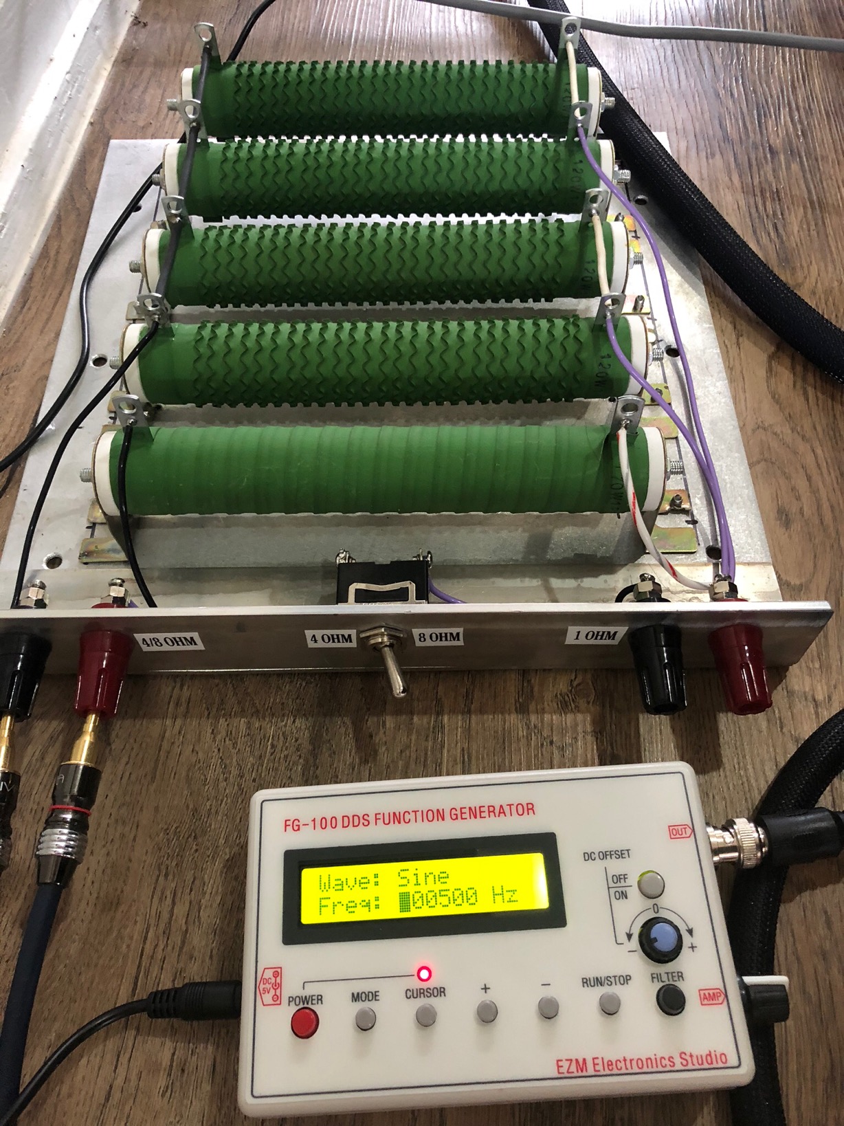

Been bust with car stuff, but took some time today to follow your instructions to test Aleph AC gain.
Since I don’t really know what I’m doing, or if I did it correct, here is a list of the steps I took.
I connected the “Function Generator” to the amp with a couple adapters to XLR, settings to Sine Wave, 500 Hz, and adjusted the units “amp” setting to 1VAC output, measured both settings with my Fluke and confirmed at XLR input-jack of amp.
Then connected the adjustable “load” that I built and selected 8 Ohm.
Turned on the amp, and started hooking up the clippy leads from the Fluke to the source resistors. Then panicked because I smelled something burning, but was only the “load” resistors.
So I measured across all the (+) side and (-) side source resistors. All read 0.001 VAC.
Does this seem right?
Thanks.
that seems right , for , let's call it , 50% of Aleph AC gain
meaning - Aleph CCS is contributing 50% of output swing
so , you're good

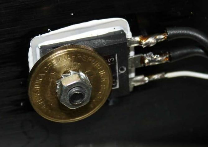

sort of game/joke , although absolutely functional
even if some are saying that using coins in destructive way is criminal act ....... I'm having difficulties to see it as destructive
