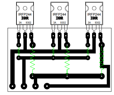

Can you mark those resistors which have to be more than 1/2Watt type
(not writing about the 5W types)
Thank you :)
already done - that one above JFet sources - 1W
either two 2K (or even 2K2) regular metalfilms in parallel (common ones are 600mW) , or one metal oxide of 1K/1W ; these ones are same size as 600mW metalfilms , just having rougher surface , so easy to distinguish

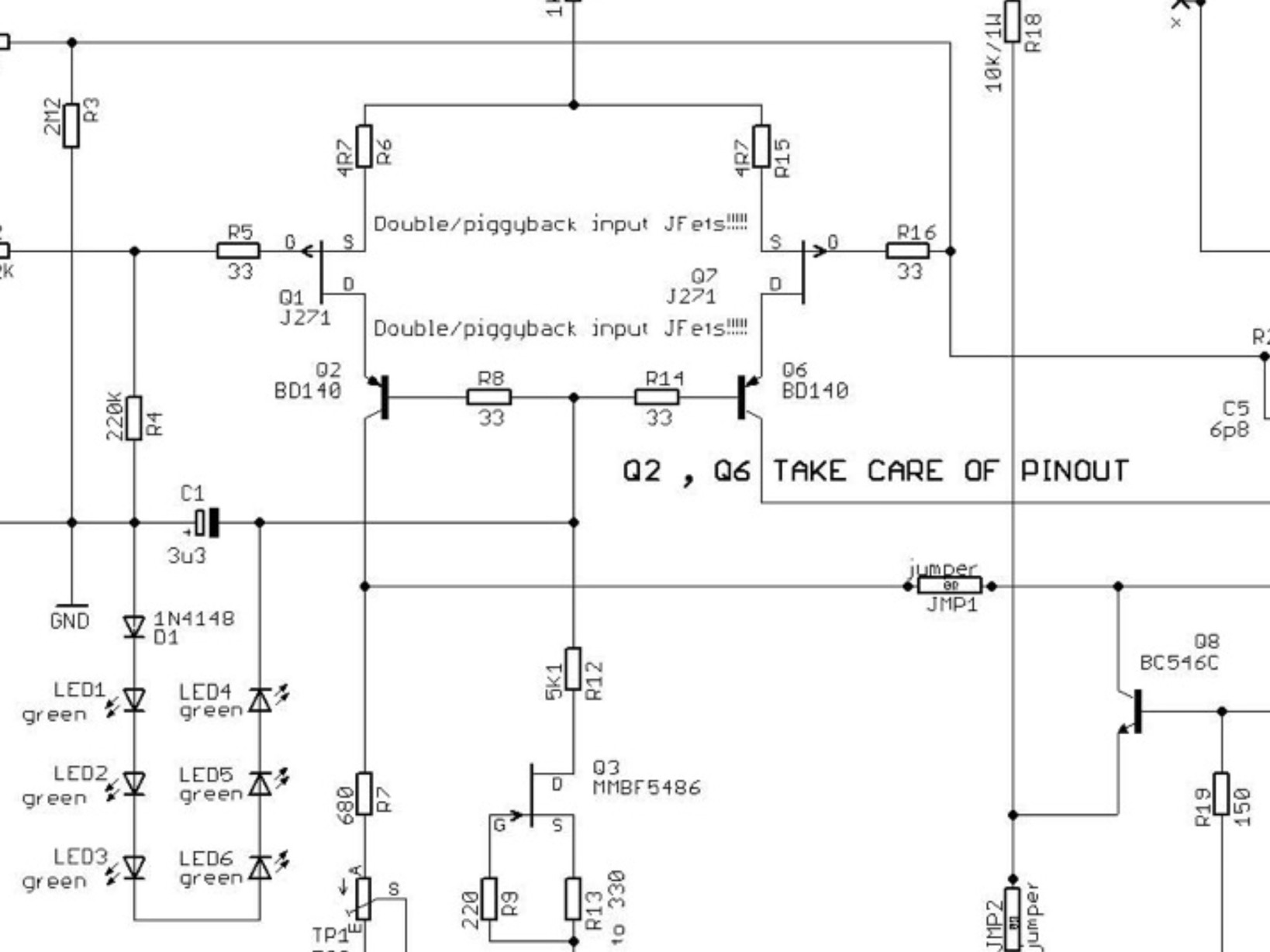

there is no way that something goes wrong with LED supply , there being JFet and substantial series resistor

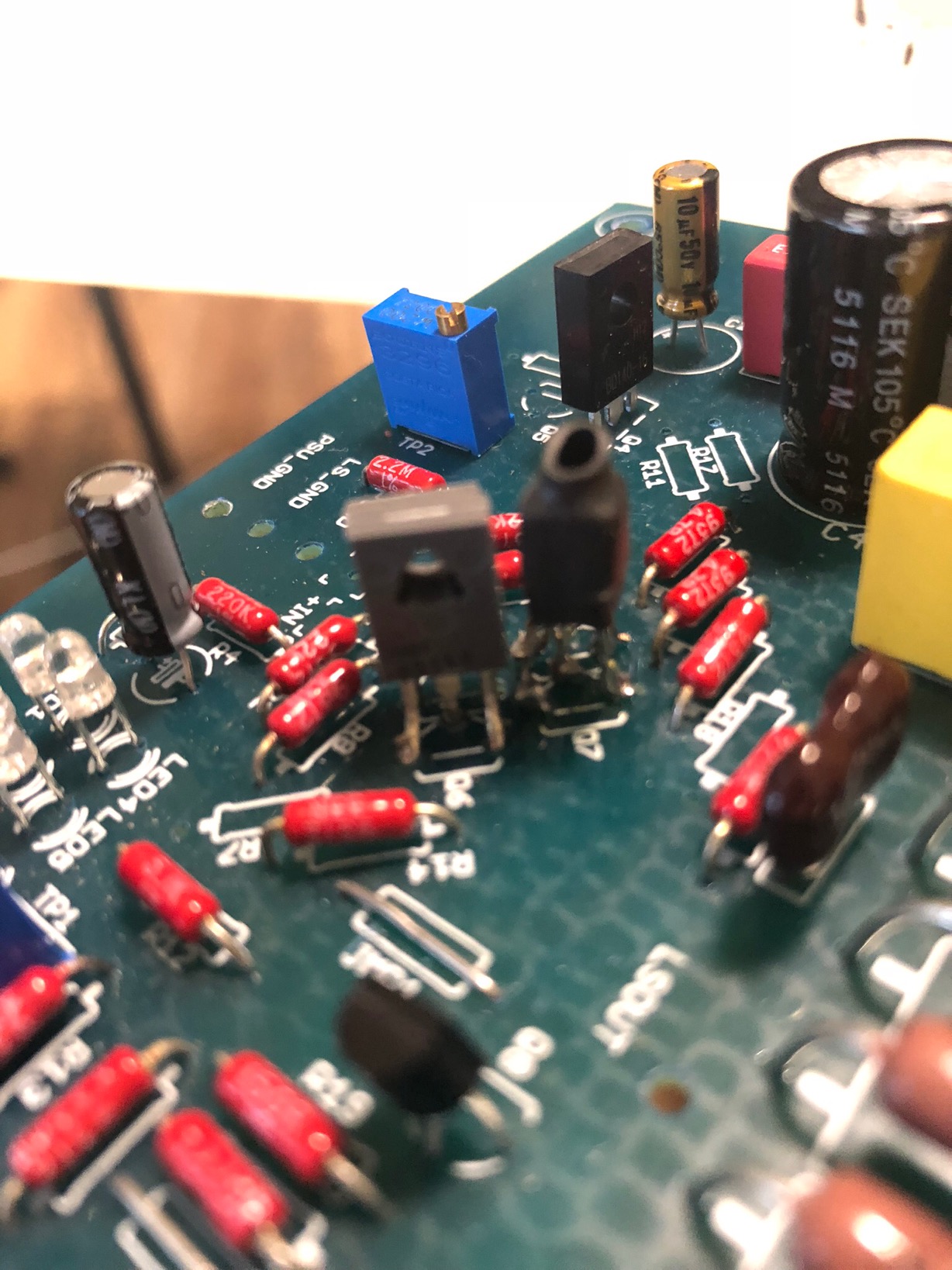

sure that you got BD140s pinout properly ?
Thanks for the quick response!
This is a pic of the other board in progress, but oriented same way. Both BD140’s facing same direction.

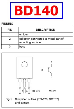

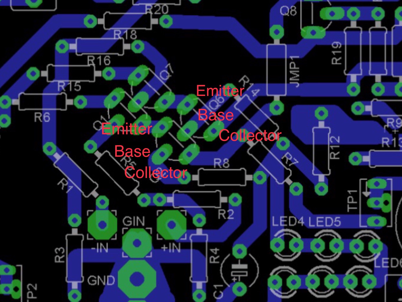

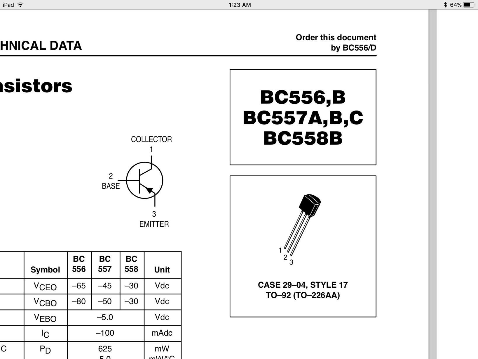

please - attach here pictures for each :
- BC556 pinout
-BD140 pinout
then write here - how you are going to solve orientation of |BD
besides writing few types in correspondence and/or in thread , even on schematic is written "TAKE CARE OF PINOUT!"
now , you must check input JFets at least with diode test (if not desoldering them and check in matching jig) , while BDs are out
check them too with diode test or Hfe or whatever , then solder them back in proper orientation

Seriously, I don’t know what I was thinking. I actually looked up the pinout, made some notes and then I dont know what I did, no excuses, I @#%4^up!

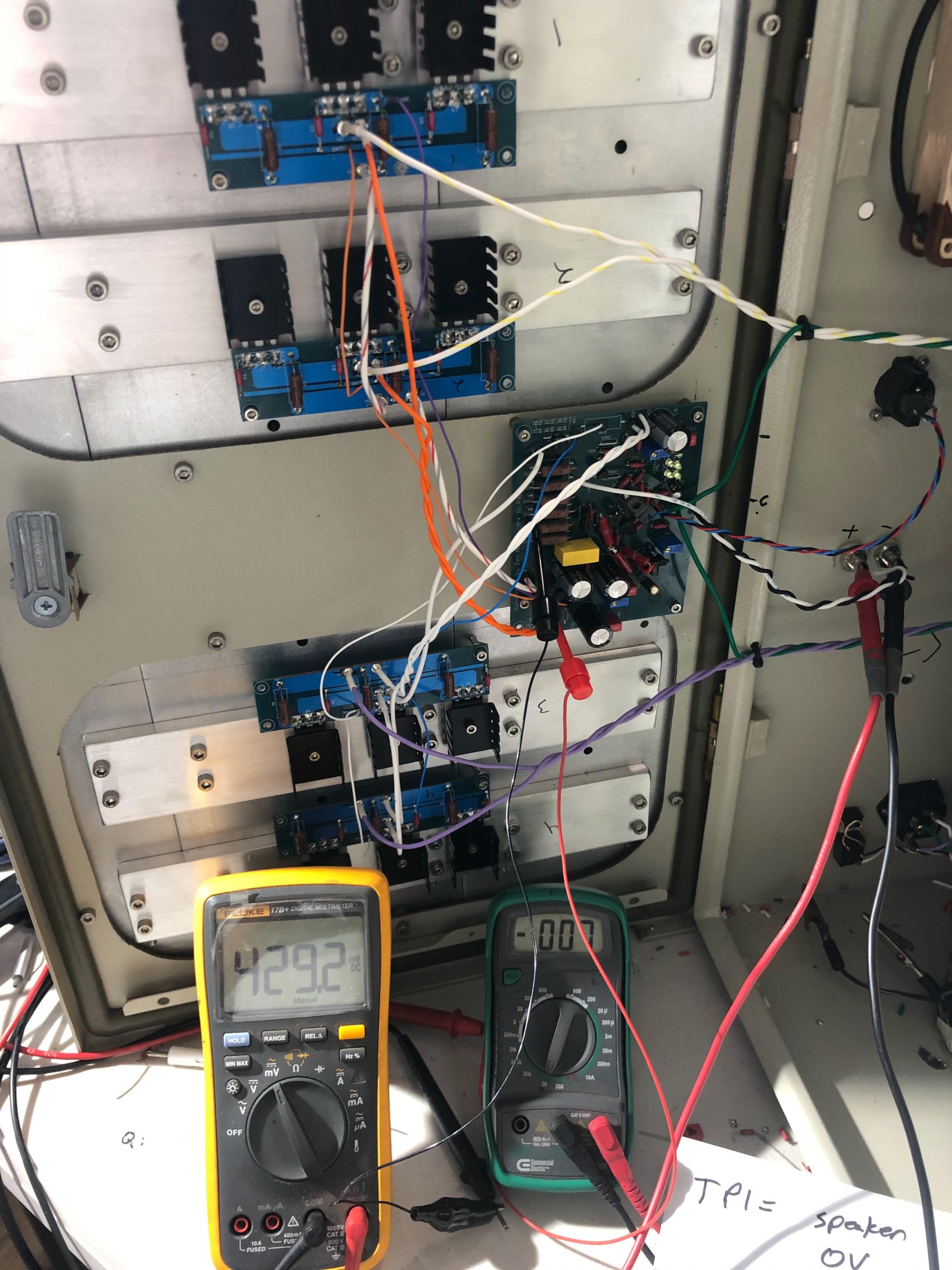

Only issue is I’m only getting about 420mV across R29 adjusting TP3 to max
Output is zero’d out with TP1
I’ve got 20v across R11
44.6v coming into FE board

I let it run a good 15-20 minutes, heatsinks were warming up nicely.
Adjusting TP1 and TP3 were only slightly dependent on each other as compared to adjusting my F5 v3 Turbo that was a big dance.
I performed the checks mentioned, did not find any parts fried. Compared everything to the parts on the other board that hasn’t been installed yet. Replaced C11 as it seems it smelled, and as mentioned, the one LED that looked bad.
Contorting the legs on the BD140’s was a little challenging with the previously installed shorter legs. Used a little heat shrink on the middle leg where the side leg is doing a backward flip, to be safe. BTW, how is it possible to not have had one leg in the right place? That takes talent!�� I’m going back to sniffing glue!

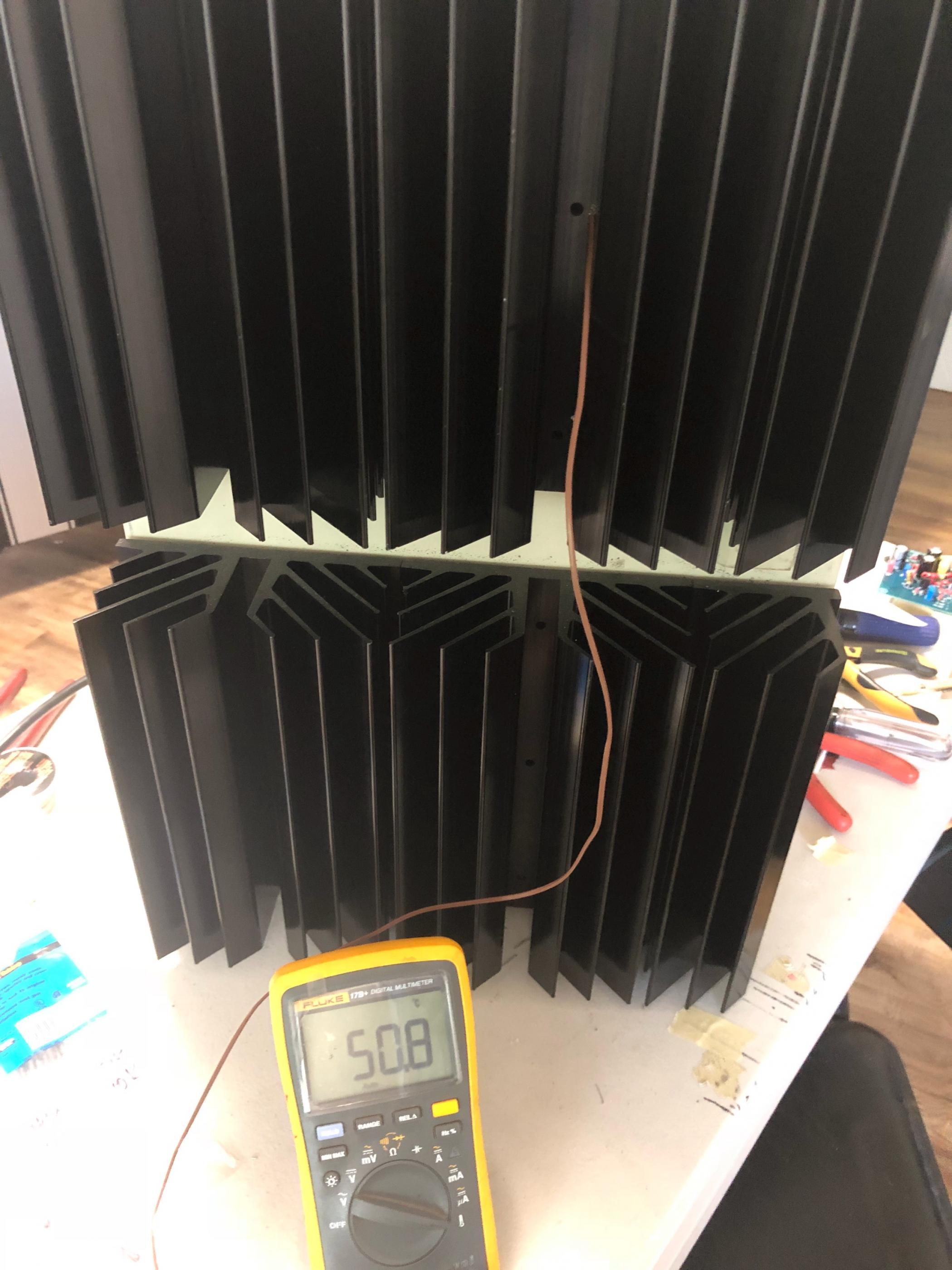

So before I took the amp off my work table I thought I would see what the temp would get too in its current state. After a little over an hour it’s just a smidge over 50 degrees centigrade. As measured with my probe in a hole in the back of the heatsink. I have an internal fan, but for testing I left it off.
Being in Hawaii I sometimes forget it’s cold in a large part of the world right now. We have the windows open, a light breeze, and it’s 72 degrees (22 celsius) in the House, for reference on temp rise.
So, I don’t know, maybe this might be the right place to leave it?
Feeling good about the whole project, and since I have a small table and needed to get this amp off and complete the twin, I carried it into the living room and hooked it up. Been playing this channel for a half hour or so. Sounding good so far. But seems like I have to run the pre higher for same volume? But nothing on other channel so might be that.
