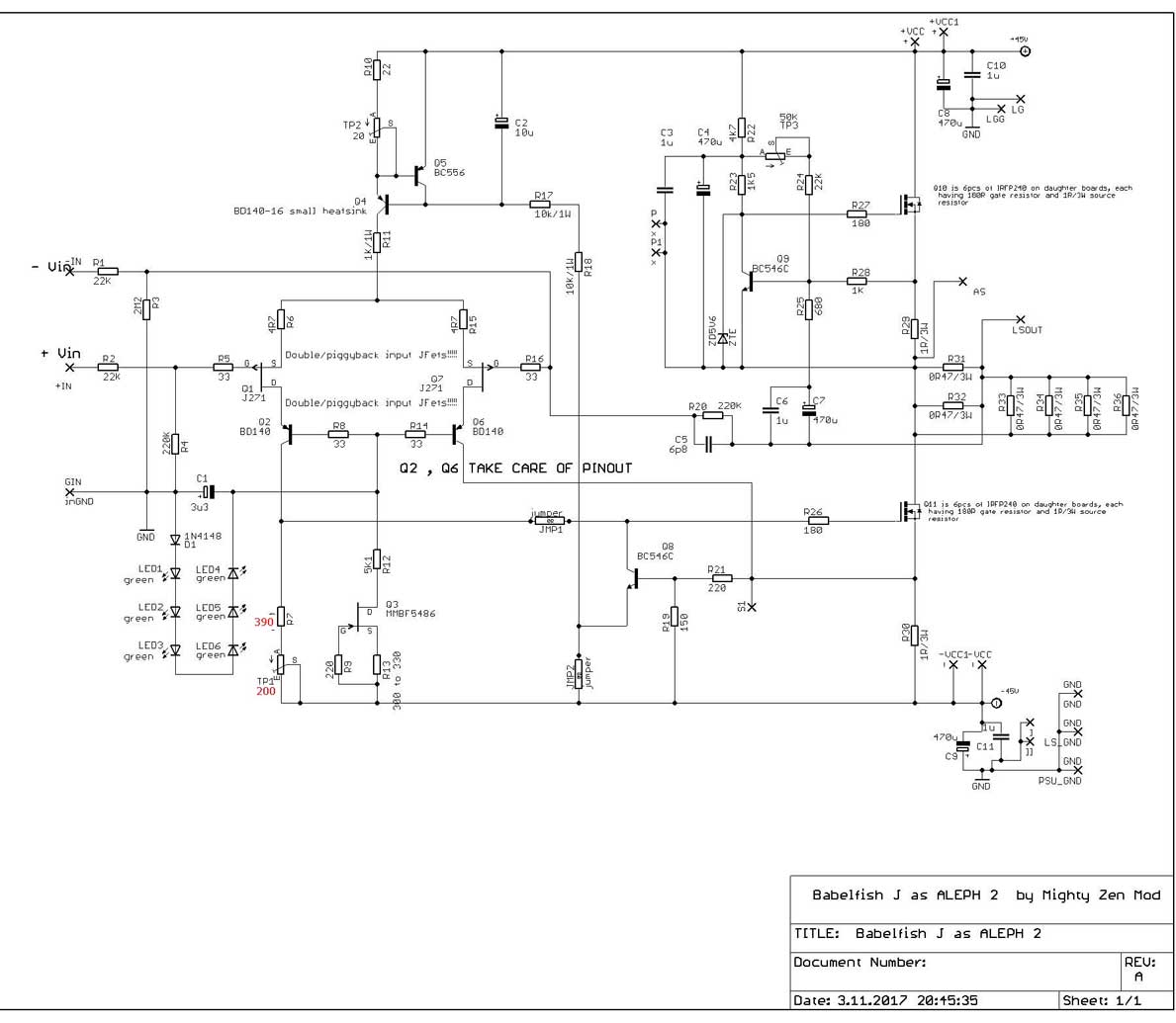

Below is a marked up schematic of what is soldered in now. Can you take a look and let me know what needs changed? Looks like I’ve taken some values from two different schematics.

here it is , finally ;
look at attached schm , I believe I edited everything ;
note - input JFets doubled , doubled current through them (LTP) , BD140 cascodes instead of eeenyweeeny BC critters
few resistors marked as 1W - you can easily buy metal oxide ones , tiny as regular 600mW metal-films ; up them smidge above pcb

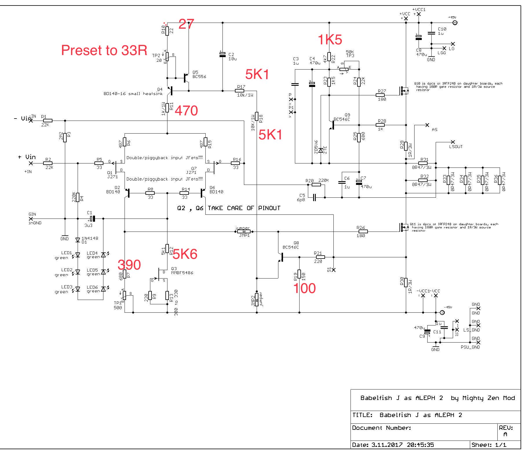

I’m not sure how I got sideways/confused, so best to go back to the beginning.
I received the balance of resistors I needed and swapped everything to exactly match this originally provided schematic to match my original power supply.

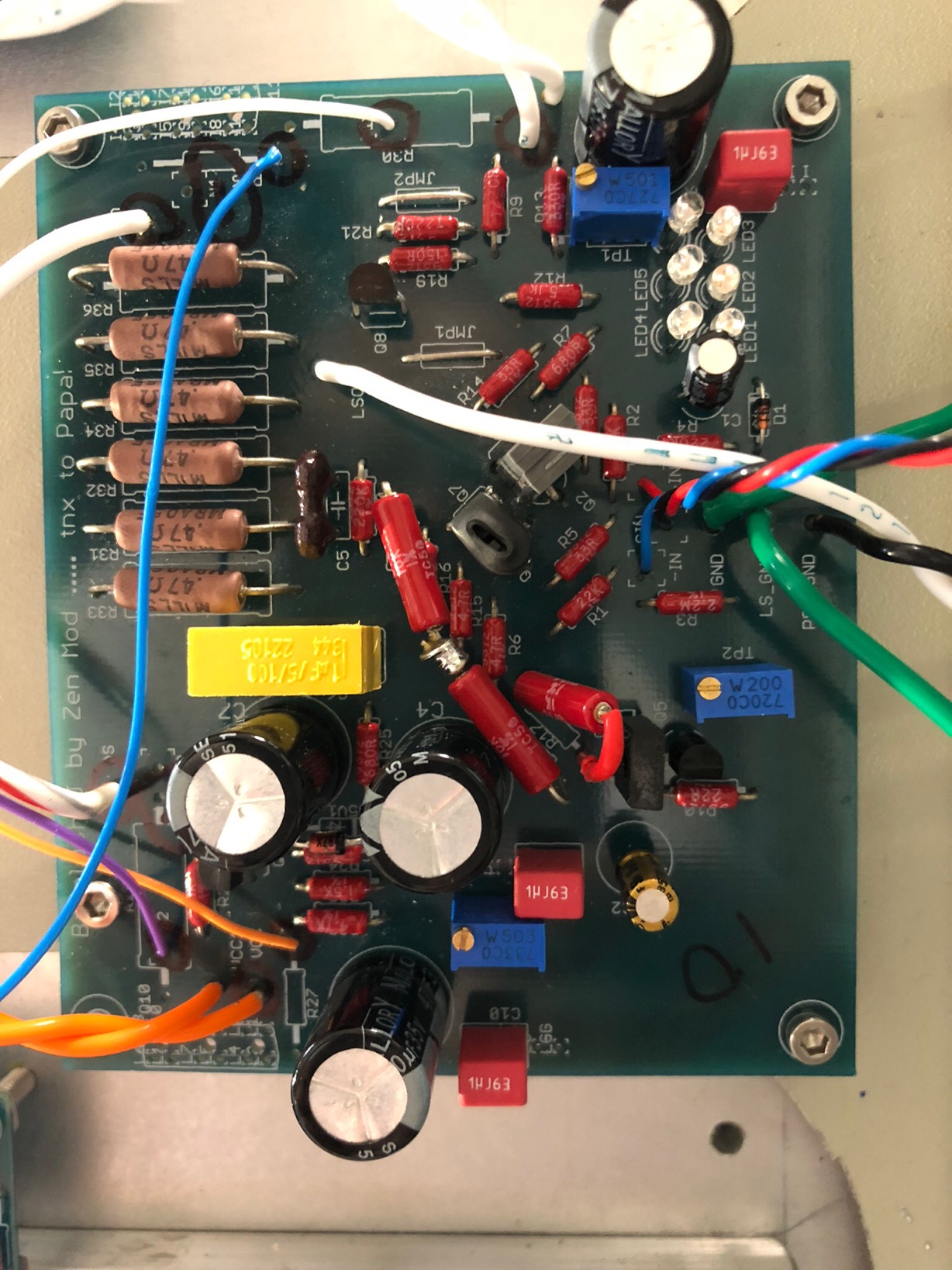

Here is a pic of the completed board. In wanting to stay with all PRP resistors I had to get a little creative with the 3ea 1W ones.
Going to put some power to it later today when I get back home and see what happens!

see enclosed (repeated) schematic
looking at it , I can see that I didn't made (miracle!) any serious mistake ...... but looking at pic of your pcb , I see that YOU made few ....
most important thing(s):
-source resistors for 6 pairs of outoput mosfets , as I marked them , are 1R ..... and you change them to 0R47 ; OK with me ......
-now , BIG BUT! : according to source resistors of 1R , 6 of them in each half , demands that in SENSE group ( resistors in series with output) we have 6pcs of 0R47 , or 12pcs of 1R ........ practically half value of all source resistors (in one half) paralleled ........ and that is your mistake , as far I can see from pics..... you have too few of 0R47s in SENSE group
-Conclusion - if you have 6 mosfet vertical pairs ,each mosfet having 0R47 source resistor , in SENSE group you need to have either 12 paralleled 0R47 , or 6 paralleled 0R22
had few mishaps with values of trimpot and resistor in input JFet drain , corrected , red marked
rest is OK

Lazy ZM
rest is OK
Fantastic! We are getting close. Thanks for looking this over and being patient with me.
Please indulge me a couple more questions.
So I need to swap out TP1, 20 Ohm trimpot with a 200 Ohm trimpot, and change R7 to 390 Ohm.
On the daughter boards I have 1 Ohm/3W resistors and a 180 Ohm resistors for each mosfet.
On the front end board I have OR47’s for positions R31-R36. So I need to swap these out for 1 Ohm?

TP1 was marked as 500R , now going to 200 ..... though - you can leave 500 in , just having less turns to fiddle with
having 1R on daughterboards (that's my bad , I understood that you have them ALL 0R47) , leave those 0R47s on main board and do not touch source & sense resistors at all
remember ........ as I wrote in previous post - if you have 6 of 1R under mosfets , you need half of that in SENSE group ....... and that's exactly 6 paralleled 0R47s
so , to repeat - now I have necessary info that I can say that source and sense resistors are good
