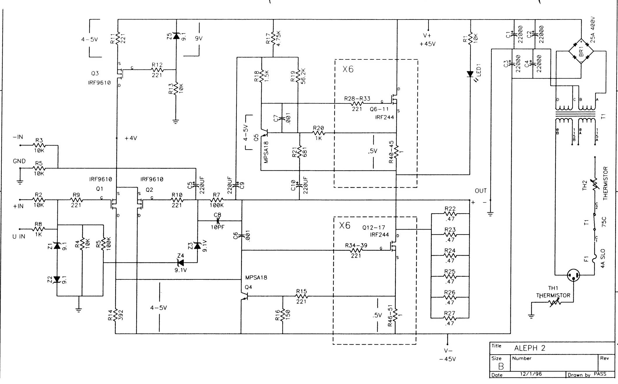

well ...... for J-Babelfishing Aleph 2 , we don't need brain , Papa already did everything ...... and all we need is just to take what's important from recipe :
- rails
-number of outputs
-Iq
-important value of Aleph CCS gain
so everything refers to this :
(now I'm going to kill some pancakes and to play with calculator and Eagle schm editor ; will post results when done)
- rails
-number of outputs
-Iq

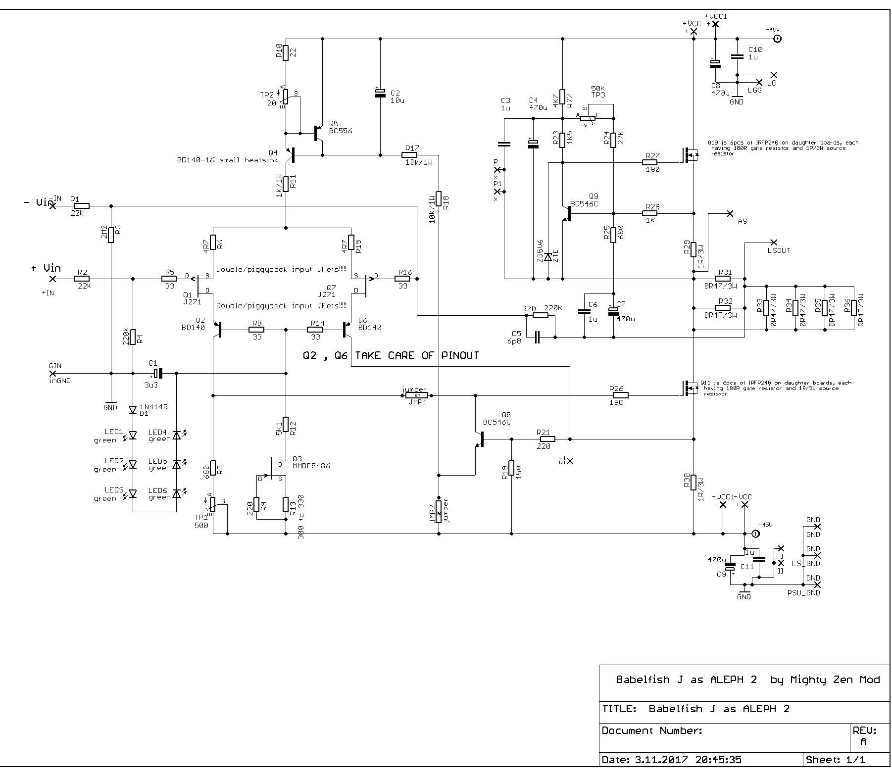

BABELFISH J AS ALEPH 2
here it is , finally ;
look at attached schm , I believe I edited everything ;
note - input JFets doubled , doubled current through them (LTP) , BD140 cascodes instead of eeenyweeeny BC critters
few resistors marked as 1W - you can easily buy metal oxide ones , tiny as regular 600mW metal-films ; up them smidge above pcb
for more necessary info about general approach (how to connect Daughter boards , recipe for eternal life and no need for Viagra ....) read these posts:
#21 (important Snake Oil notes)
#80 (how to actually do it ; imagine 2 daughter boards per side , paralleled)
Greedy Boy Coasttocoast asked for something with 38Vac rails ........ that would be aroundish 47-48Vdc
same applicable
Boyz - you're nutz ........ who need that sort of power ?
same applicable
I looked at the schematic, it also have those "mysterious" P-devices in the IPS, can someone clarify why we would like to choose a P-ch IPS instead of N-ch?
J271 or 2SJ74BL
entire construction is ........ Papa's ;
ask him why he chose this polarity instead of other one
Hi ZM,
in preparation ... I read the whole thread and copy me some parts from here in a doc for my build but now I have some questions ..
So, i didn't understand what the LEDs do, you wrote here (have read the Aleph CCs mod PDF but my English is not so good ...) :-(
"LED string thingy is fed with anything between 3-5mA ; it can be resistor or MMBF JFet , but I like 3mm greenies combined with JFet CCS sponginess "
=>found which one from Kingbright with 2.8V/20mA and 2.2V/2mA which should it be or misunderstood something?
And for Q4 (BD140-16) found I two different types: hfe 100 or 40@150mA/2V
=> which would be fit best?
Thanks for your hints!
Berlin is greeting ....Carsten
there is small constant current source made of MMBF JFet , pushing current through LEDs+1N4148 string ; theyre having pretty nice and constant voltage drop , used here to form voltage level/reference for cascodes ;
I like common/peasant/bauer diodes , green , 3mm ones ; they're having nice drop of 1V93 ..... with currents from 2 to 5mA
regarding BD - whichever you find in drawer , or those easier to buy/get

back to topic ...C5 could be also a 6pF?
but the avatar is a multi pic ... little bigger (lost the original pic), car is a original historical racing car "Gruppe 2".
Ok,

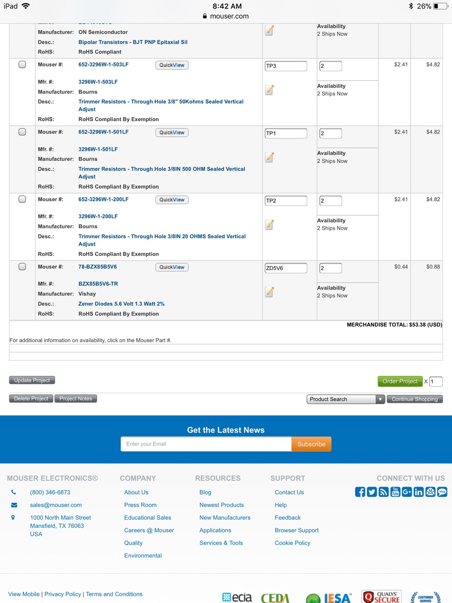

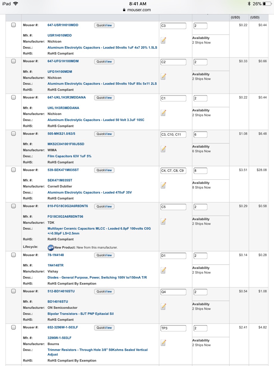

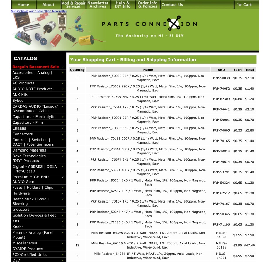

I’ve spent a few hours putting an order together for “Babelfish J as Aleph2”.
I’m pretty good at hands on construction and following instructions, but understanding and picking electric components is a stretch for me.
So by scaling the pic of the board posted for measuring, research of similar BOM’s and pics posted on this thread here is what I have ordered today.
I welcome all comments to where I have gone astray.
Carsten.witt, awesome car!
Zen Mod, thanks for supporting our off topic interests!
