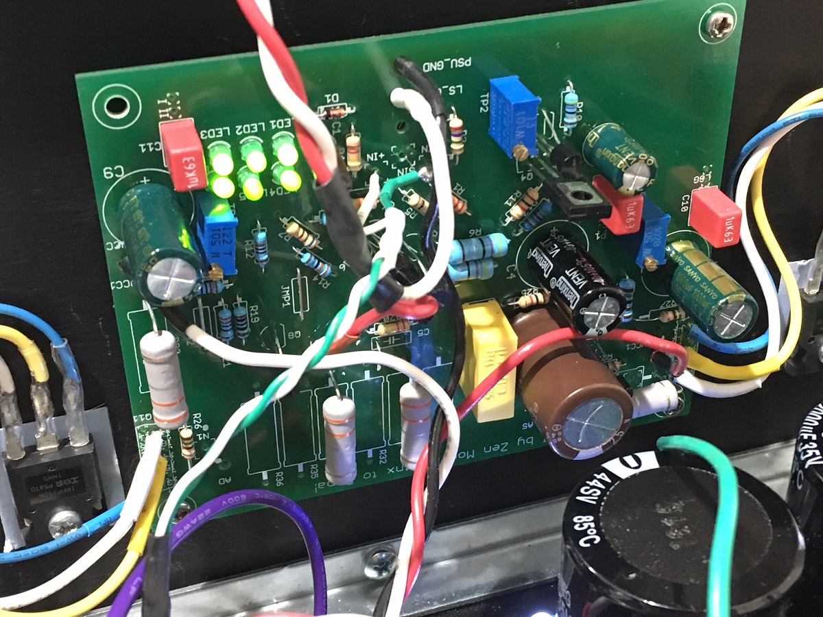

I'm using 0.47R source resistors, 1 MOSFET pair, genuine Vishay IRFP240/9240 (from Mouser), 1.20 amps bias.
My smallish 100w (per channel) trafos are sagging to about 20v rails under load. That's probably the biggest deviation, but I figure that's probably good for 16w max and I am far from pushing the amp hard.

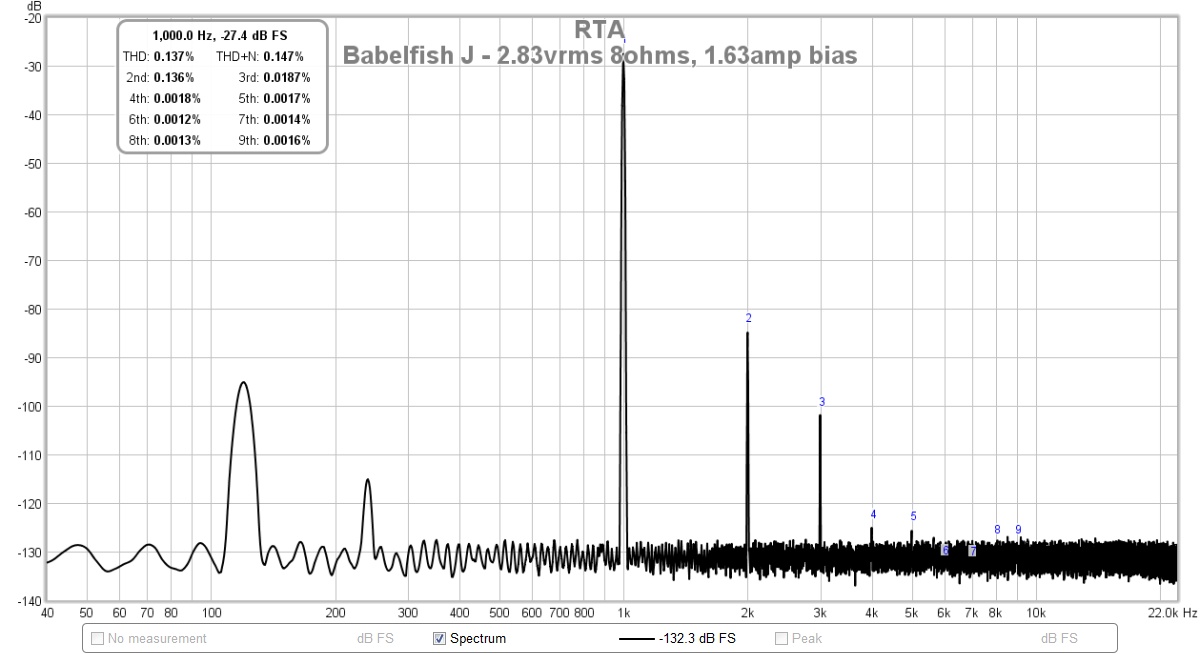

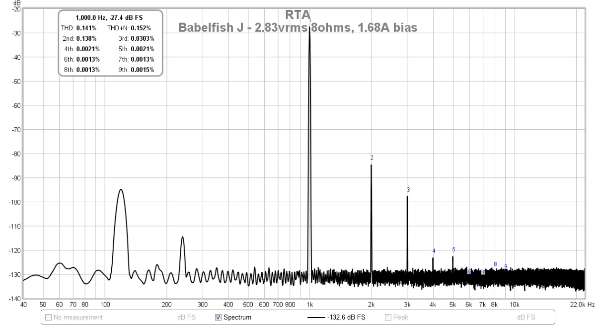

I changed the source resistors to 0.33R 3W carbon composition (vs Panasonic metal thin film), and the bias is now about 1.63 to 1.68amps (the bias pot seems to have little to no effect (7 to 8 turns no effect) on actually changing the bias, only changing Source resistors did anything, is this normal?) The distortion went dow to 0.14% to 0.15% THD and the profile is predominant H2 and H3 about -15dB lower and nothing else - so this is good. Should sound very lush and vivid. Still well above what I think it should be at (circa 0.04% or less?). Should I just leave it alone now or pursue trying to see if it can go lower in THD?
Zen Mod: what did the Spice simulations predict for the THD and the spectrum?
I am taking the data in a different location so the mains peaks and harmonics a little different.
Left Channel:
Right Channel:
Left Channel:
Right Channel:
TP3+R24 combined value is what's influencing Iq , besides voltage across R29
so - lesser ohms of TP3+R24 ,Iq lower ..... more ohms there , R29 is dominating
regarding THD ........ I would say that's good enough , not taking in account methodology of measurements ........ what's most important is that you confirmed K3 15db down vs. K2
Spice is ( as we know always enthusiastic) predicting something as 0.015% , 8Vpp@8R , with 0R33 biggies and app. 1A6 Iq
more oomph and THD goes even lower , but who cares
