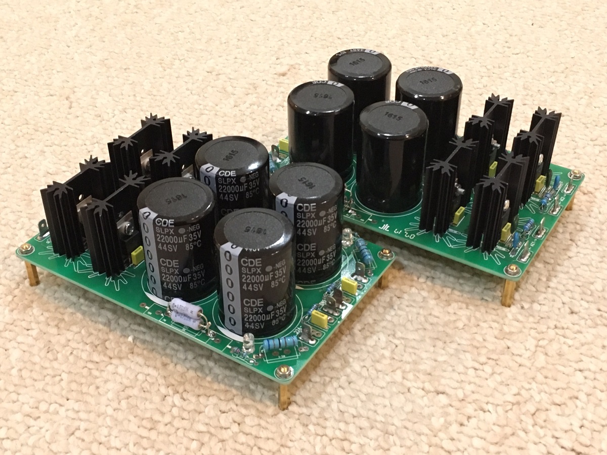

I have a 400va 18vac toroidal trafo feeding parallel connected CRC PSU's at the AC input to the diode bridges. The CRC PSU is the one from here:
CRC Power Supply (Class A amplifier)
635473d1505455815-crc-power-supply-class-amplifier-crc-class-psu-build-jpg
The ground after the second capacitor bank is connected to the clean side of a GLB (8R, 2 diodes, 100nF). The dirty side of GLB is connected to chassis and earth ground.
Each PSU has +/-24v and GND (to the common clean GND pin) to the amp modules.

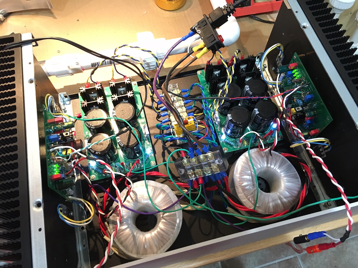

My dual Antek AS1218 toroidal trafo's arrived yesterday. Finally had a chance to install them into a dual PSU monoblock setup with the CRC's. The only common ground point between the two amps is now a ground from the second C in the CRC (where the amp power cables are connected) to a single "clean" ground point on the ground loop breaker (GLB). The other side of the GLB (a 8R resistor with two 10A10 diodes and a 100nF 250v film cap all in parallel), connects to chassis ground and earth ground. Running at 1.20amp bias and dc offset is about 10mV, still stabilizing. The output noise with inputs shorted is now 0.9mVac (not 0.1mVac as before), but this figure does not change when I plug the input into a DAC. Music is playing now and first few tracks on my XKi speaker fitted with a Tang Band W5-2143 sounds really good. Nice bass, articulate and clear while deep. Mids and highs sound very clear and fluid. Will listen more now. Here is a photo of the temp setup before I drill holes and hard mount stuff. It all fits nicely.

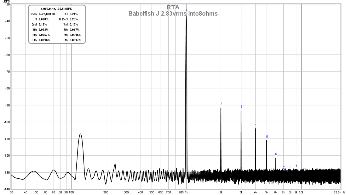

I just put the Babelfish J amp up to my measurement rig (8ohm 25w resistor and Focusrite 2i4) and am getting a rather high 0.21% THD at 2.83vrms into 8ohms. Is this normal - and predicted by simulation, or perhaps I have something off in my amp? One thing that is nice to see is that my linear PSU appears to be working very well now with no more "forest of noise" like I had before when running the single trafo on the M2. Here is the FFT for left and right channels driving 2.83v rms into 8ohm resistive load. Voltage on load read-out with 2k/22k voltage divider.
Left Ch:

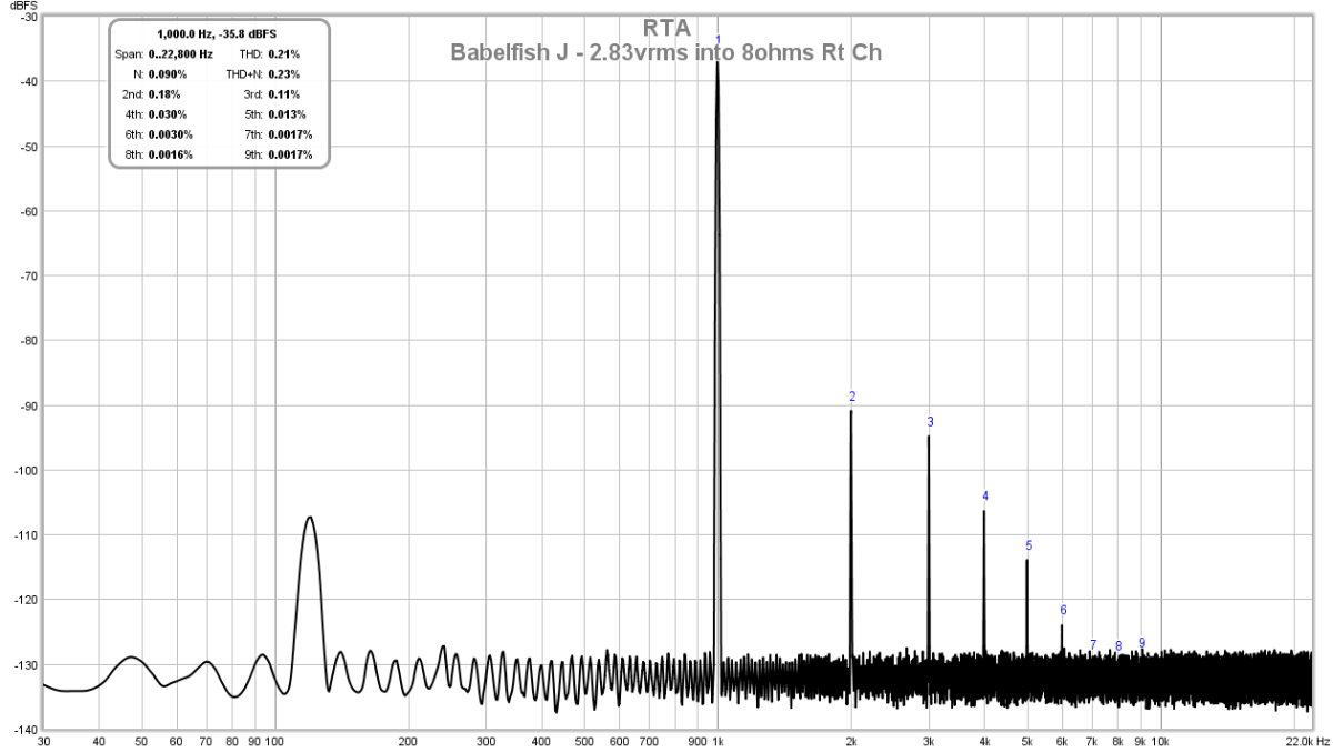

Rt Ch:
