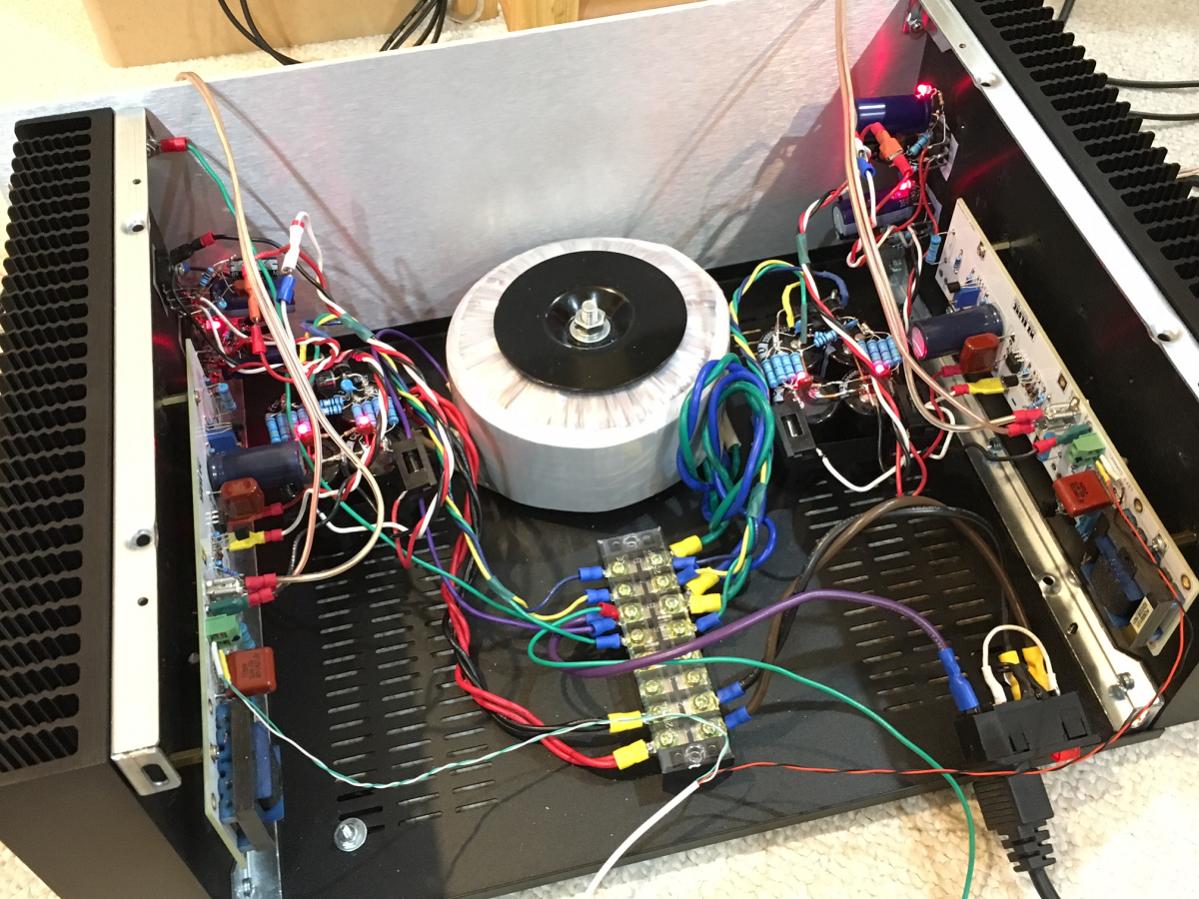

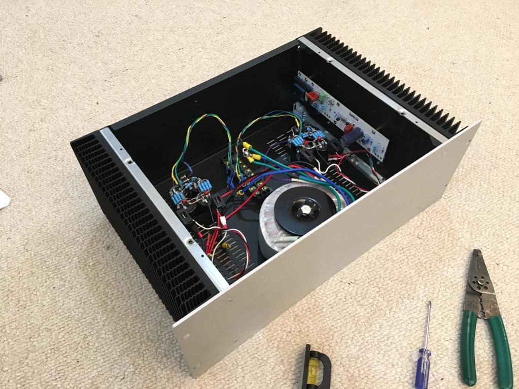

Dissipante 4U case with UMS heatsinks arrived. Nicely made. Looks like it will work well. I even found two pre-tapped holes for the MOSFETs.
no porn , no believing
I love this case. I am going to give it a test drive with my Teabag M2 as that has UMS spacing as well. While I was at it, I replace a crap 10uF X7R MLCC on C2 with an Elna Silmic 4.7uF x 2 to see if the sound improves. There is a 1uF 450v MKT film bypass there. The M2 redux will get all the bugs worked out as far as PSU, IEC, RCA, Banana outs, etc. Then stuff Babelfish J and swap out the amp boards. Easy Peasy.
Here is some amp porn for Greedy Boyz.

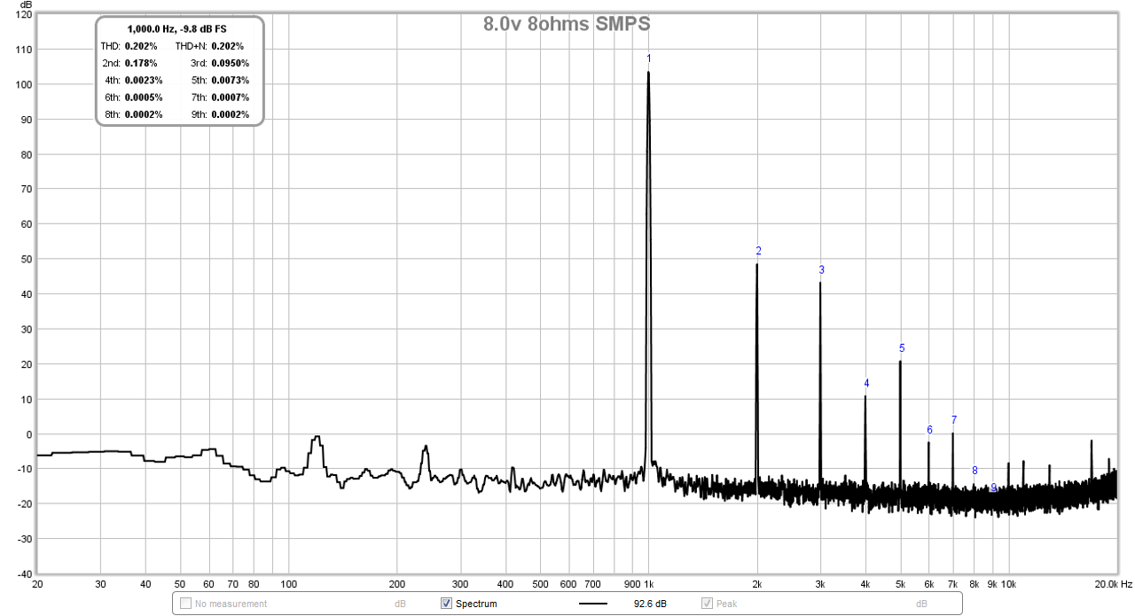

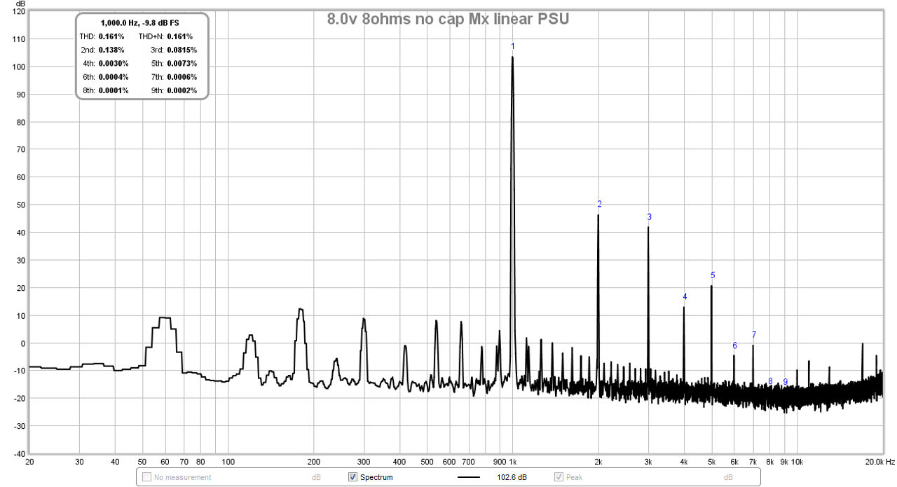

Sort of off topic - but paving the ground for my Babelfish as the M2 in this case and PSU is the trial case. I'm not sure what's going on with my linear power supplies but now that I have a way to look at my FFT's - I see a forest of hash at harmonics of line frequency going up and up. It's low level so mostly inaudible. I am using a bridge and CRC very much standard: 400VA 18vac toroidal and bridge followed by 33mF // 4x0.47R(2W) // 33mF. I have 0.1uF 100v bypass caps on output. 330pF and 100R snubber on input to first cap to ground. Here's what I get from the M2 with my linear supply. Is there an obvious usual suspect that causes this? When I swapped to two SMPS bricks the hash disappeared - sort of makes we wonder why we deal with big heavy trafos.
Linear supply with trafo:
Two 24v 5amp SMPS bricks feeding same diode bridge and CRC filter as above:
The SMPS supply is dead silent - no hum or hiss. I hear some hum with linear.

Maybe I need to use Mark Johnson's Quasimodo bell ringer to optimize the snubber. It is trafo-cap LC ringing. Or put a pot where snubber resistor is and adjust to get rid of hash?
Dirty mains would show up on other things too - I just noticed it with linear trafo and bridge and CRC.
Would fast recovery MUR diodes each bypassed with 0.22uF help here?
One more suspect is EMI pickup from mains to input leads? Will investigate because since I installed the trafo already I want to use it despite the two SMPS bricks working like a champ. Works on ACA why not use on all 24v 1.25amp Pass designs?

most probably highly subjective , but I'm avoiding switching supplies

could this be the toroid magnetically spewing into the Edcor?
Do you have scope traces of the output in the two configurations?

I'll just say a Firstwatt F5 suffers from the same symptoms.
If you look at my F6, the Firstwatt F5 is worse, but I'm using 4 times the capacitance of a firstwatt product.
I might switch out the bridge rectifiers and install some hexfred ultra soft recovery diodes. If these show an improvement I'll post results.
