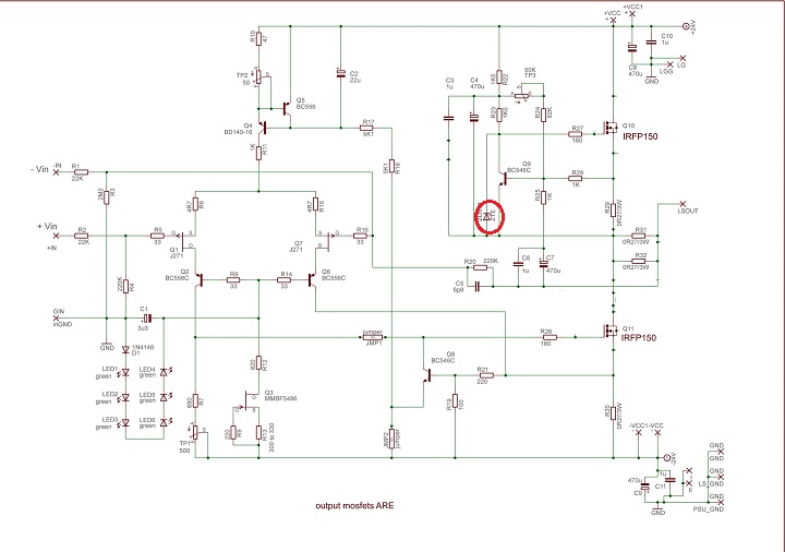

I´ve finished my Babelfish J with 20V-transformers, three IRFP240, 0,47R (R2…R6).
When setting the offset, I get the following results:
Directly after turn on, the offset is about - 700 mV (520 mV over R2 … R6),
half an hour later there is - 200 mV (495 mv over R2),
after one hour I have about - 100 mV,
after two hours - 40 mV with 490 mV over R2 (the heatsinks have a temperature of 53 degrees).
Is this a normal behavior? With that high starting offset can I connect the amp to the loudspeakers?
Best regards, Axel

everything as normal , be sure to set both Iq and DC offset at temp equilibrium
initial offset will be lower with load connected , nothing to worry about , even if you use Lowthers

Hi Zen mod!
how about active current when circuit add 01 Zen 5V1 ?

yes , I test it
it doesn't prevent functioning of Aleph CCS , working as Mr. Newby analyzed
Did you try modify control by slip current source? it will no have this trouble with clip.
naah , not worthy of hassle
addition of (5V1 or 5V6 ) zenner is good enough and , besides that , I'm not so interested in using any amp while clipping
so , no reason to improve it further

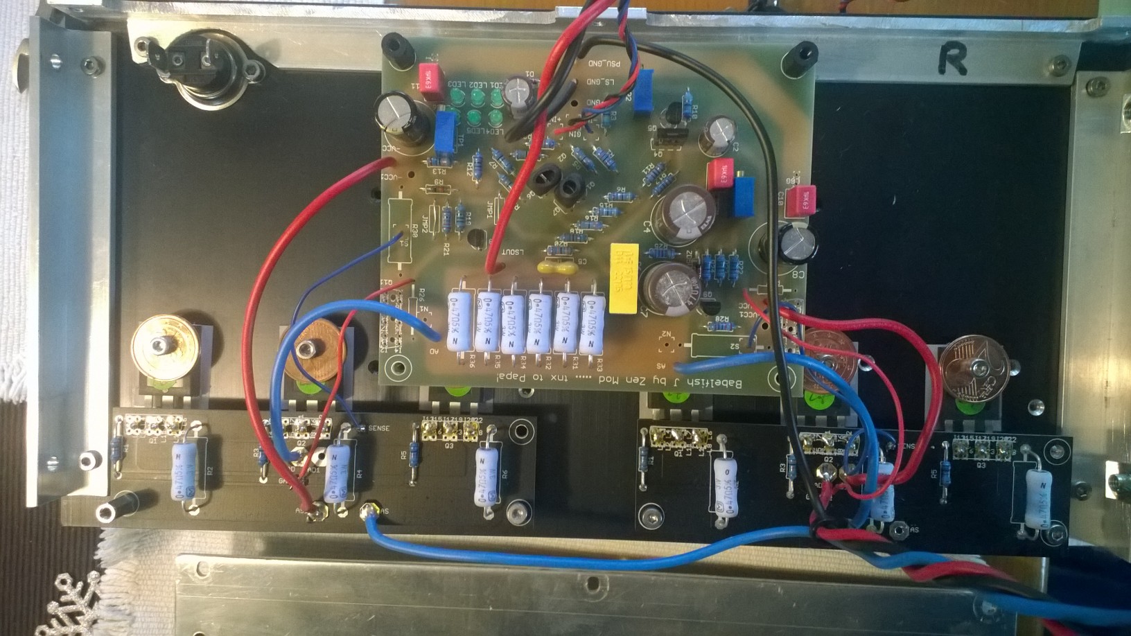

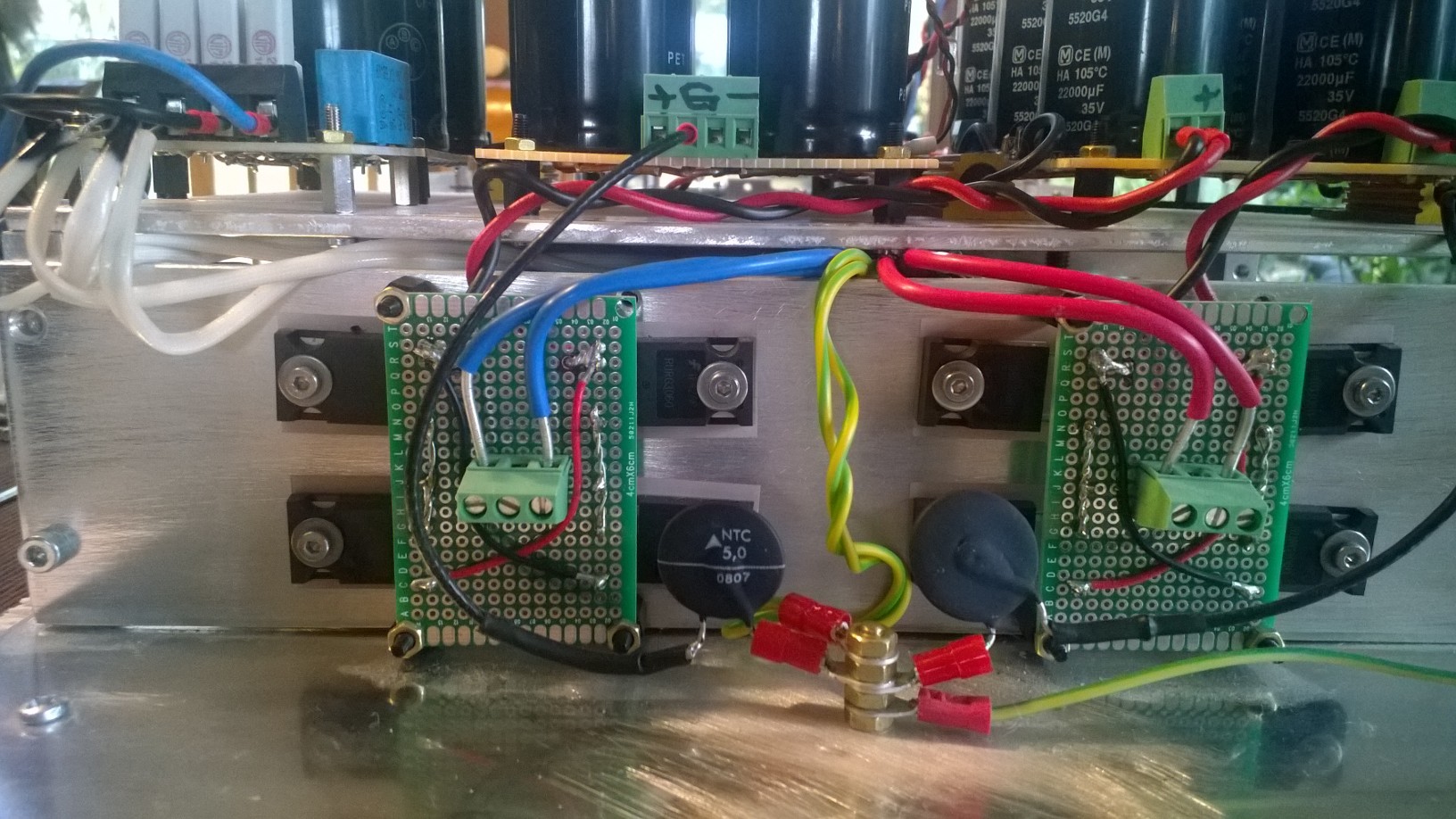

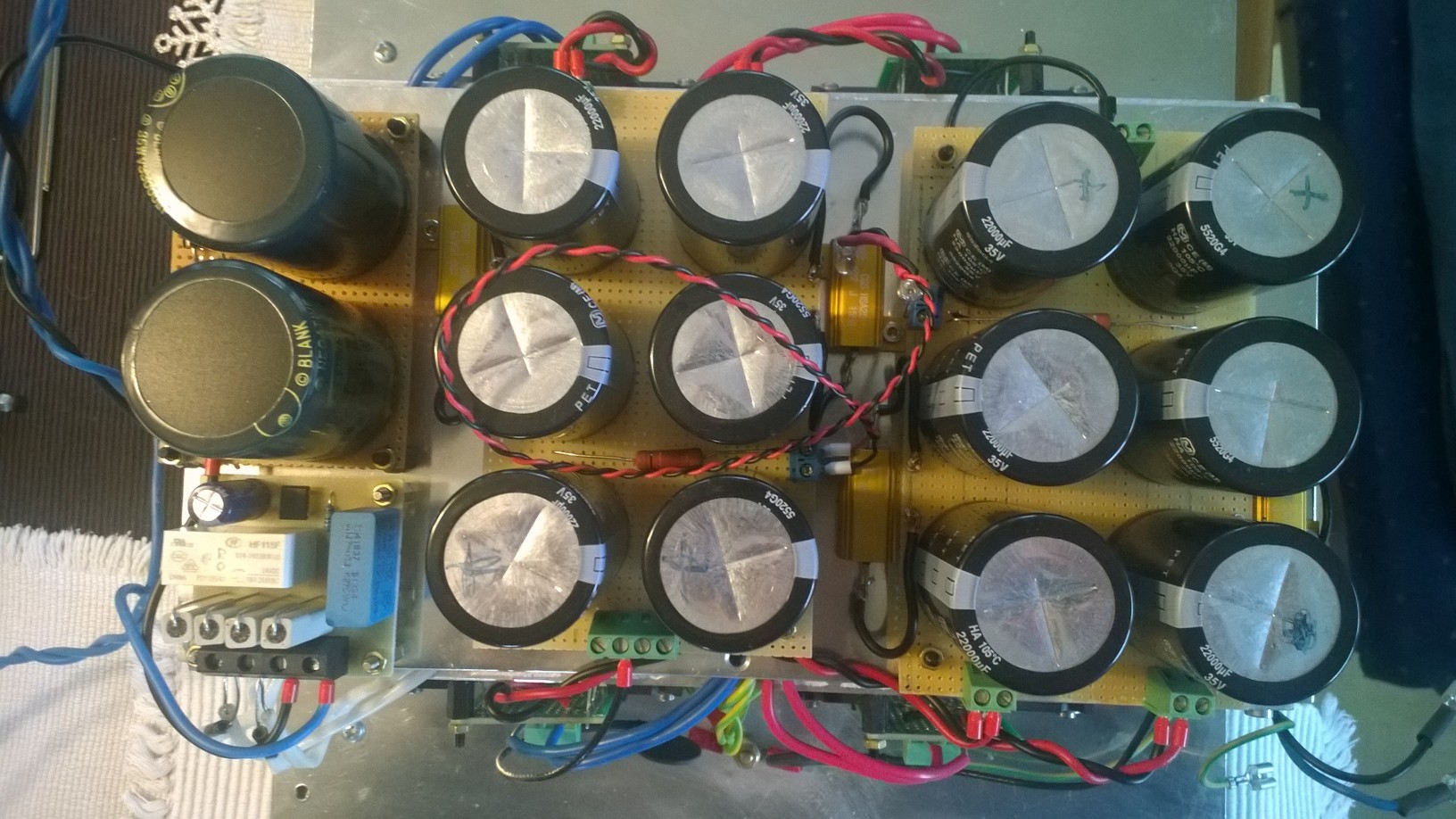

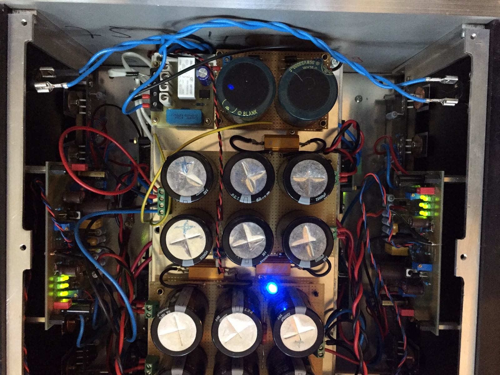

Hi Zen Mod,
thanks for your question. Yes, it´s singing, very dynamic and colorful sound, much better than my old aleph 4 monos. Now I don´t use my rel stadium subwoofer!
Your question led me to do some cable dressing, to reduce the small hum I heard in front of my speakers - the pictures are "before". And after carefull tightening the screws which hold the two transformers they became quiet too ;-).
Thanks again for your help and the babelfish j.
Hope I get the mobile phone pictures uploaded.
