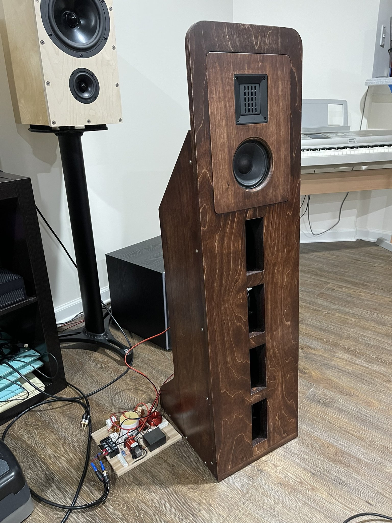

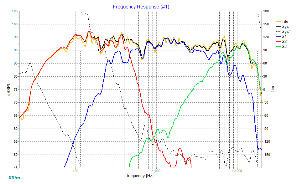

which 3 way speaker are you talking about? is it documented somewhere?
Yes, the XSD described here and here.
