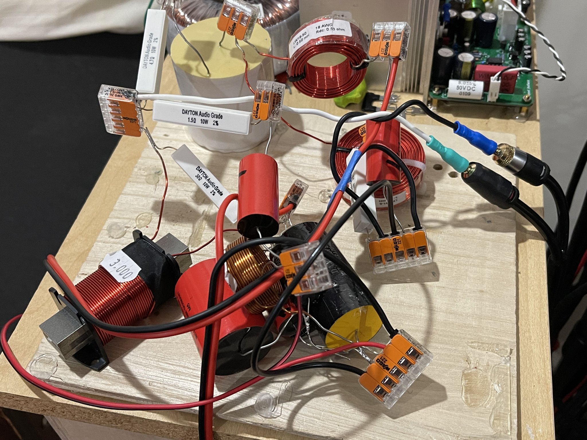

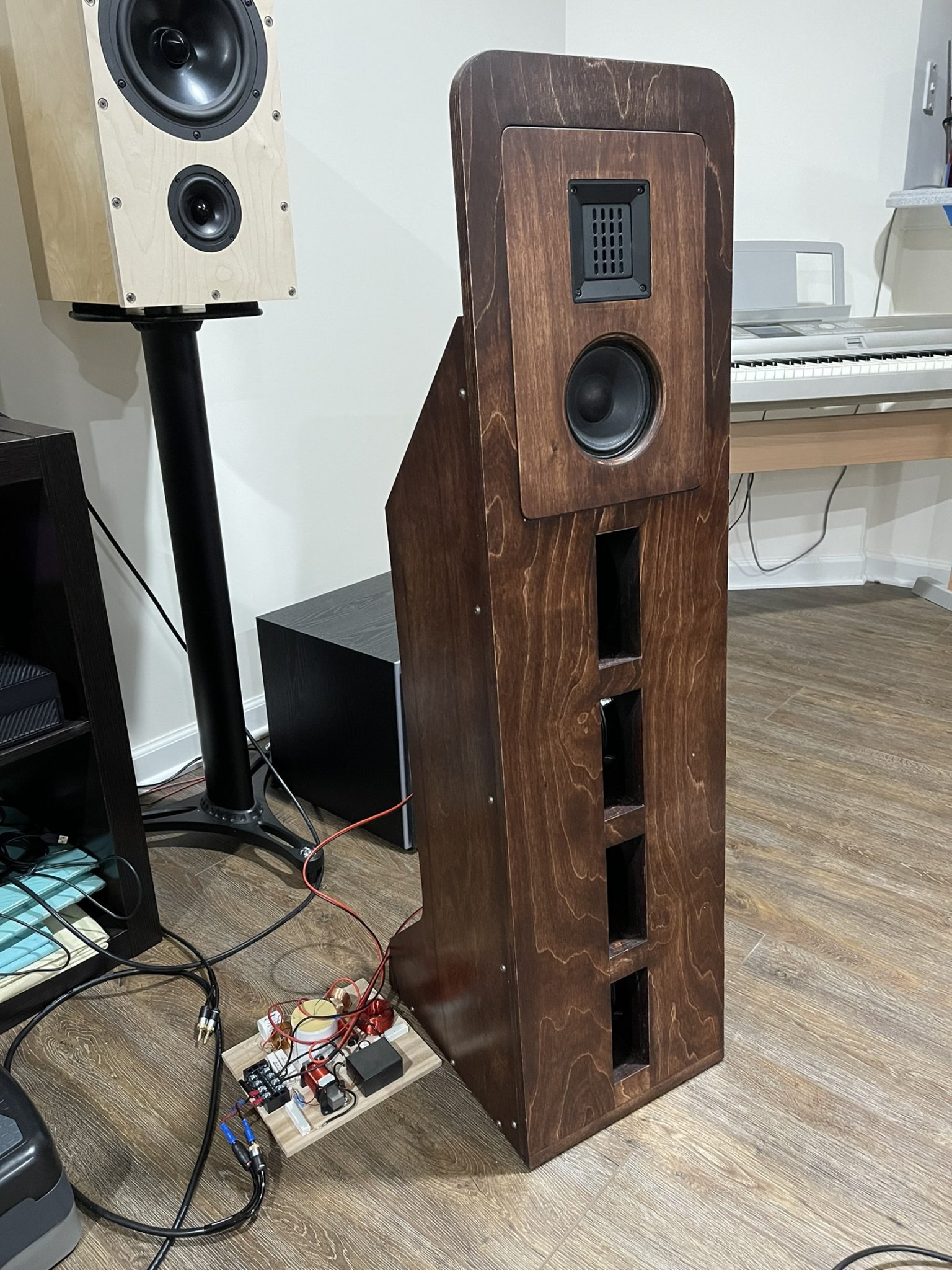

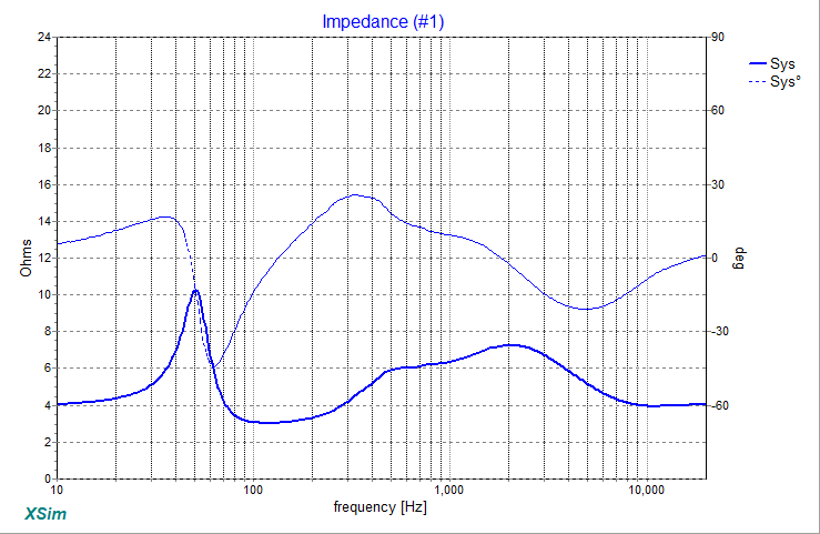

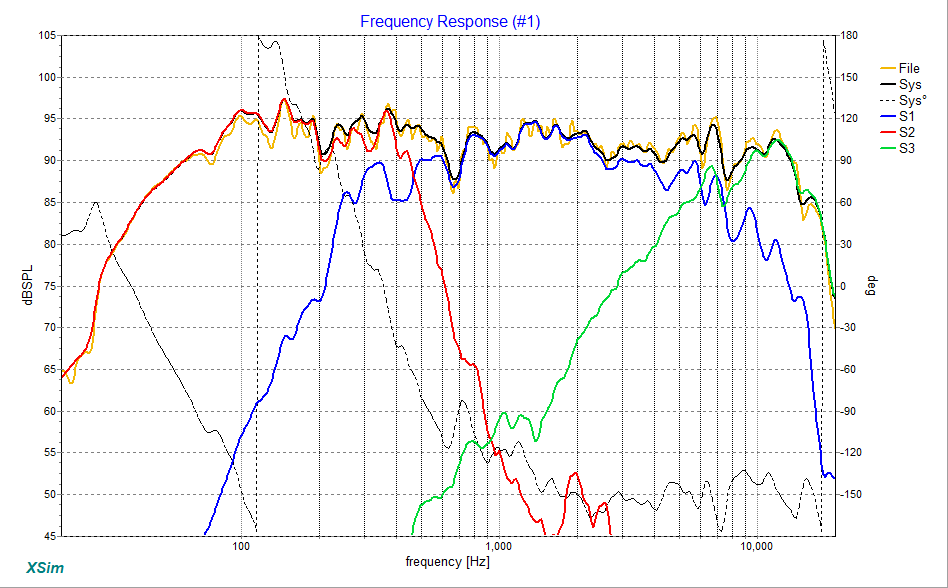

My speakers are WO24P, Em1308 dome mid and ET448 tweeters, currently crossed over around 750hz and 4khz, this keeps all drivers in their low distortion zones and the crossovers out of the hearing sensitivity frequencies.
This is not the only solution but works for me but it depends on how high the woofer can go before break up and how low the mid can go before distortion rises. The WO24P has been used successfully at 600Hz by Troels (SBA941 three way) and 1200hz by Jeff Bagby (Helios with waveguide Be tweeter) so seems to be very flexible.

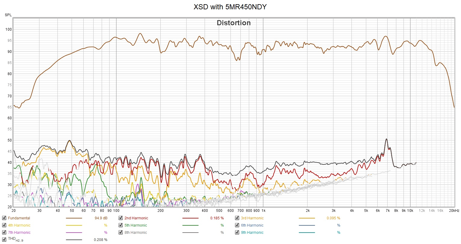

I wonder how much of that is the mic input overloading from near-field recording. SCM-2 was rated 123 dB SPL peak (<1% THD) and its max 134dB. But the measured peak is closer to 1400 Hz, with recorded SPL around 130 dB.AudioXpress review is good but did you see the big amount of harmonic H3 peak around 900 hz !
On the low end, one of the main things to look at is volume displacement, since it limits the SPL that can be achieved for a given frequency.

My last 3 way used a pro-audio midrange with very wide bandwidth (PRV 5MR450NDY-8) and a planar in a waveguide. The woofer was an 8 driver bass array in a slot loaded open baffle. Crossover points were about 470Hz and 5000Hz. Black curve is predicted and yellow curve is actual measured.
Measured distortion at 2vrms and 0.5m:
Predicted impedance:
I did this with 4 inductors, 5 caps, and 4 resistors:
Speaker looks like this:
I think it sounds pretty great. The bass chest punch is fantastic because the woofers are allowed to cover the 120Hz to 300Hz region. The imaging sounds like a fullrange speaker because a full decade is used by the mid. The highs sparkle and full of air and light without fatigue with the planar. And because it is a dipole, the ambience is very natural. Have a listen here.
