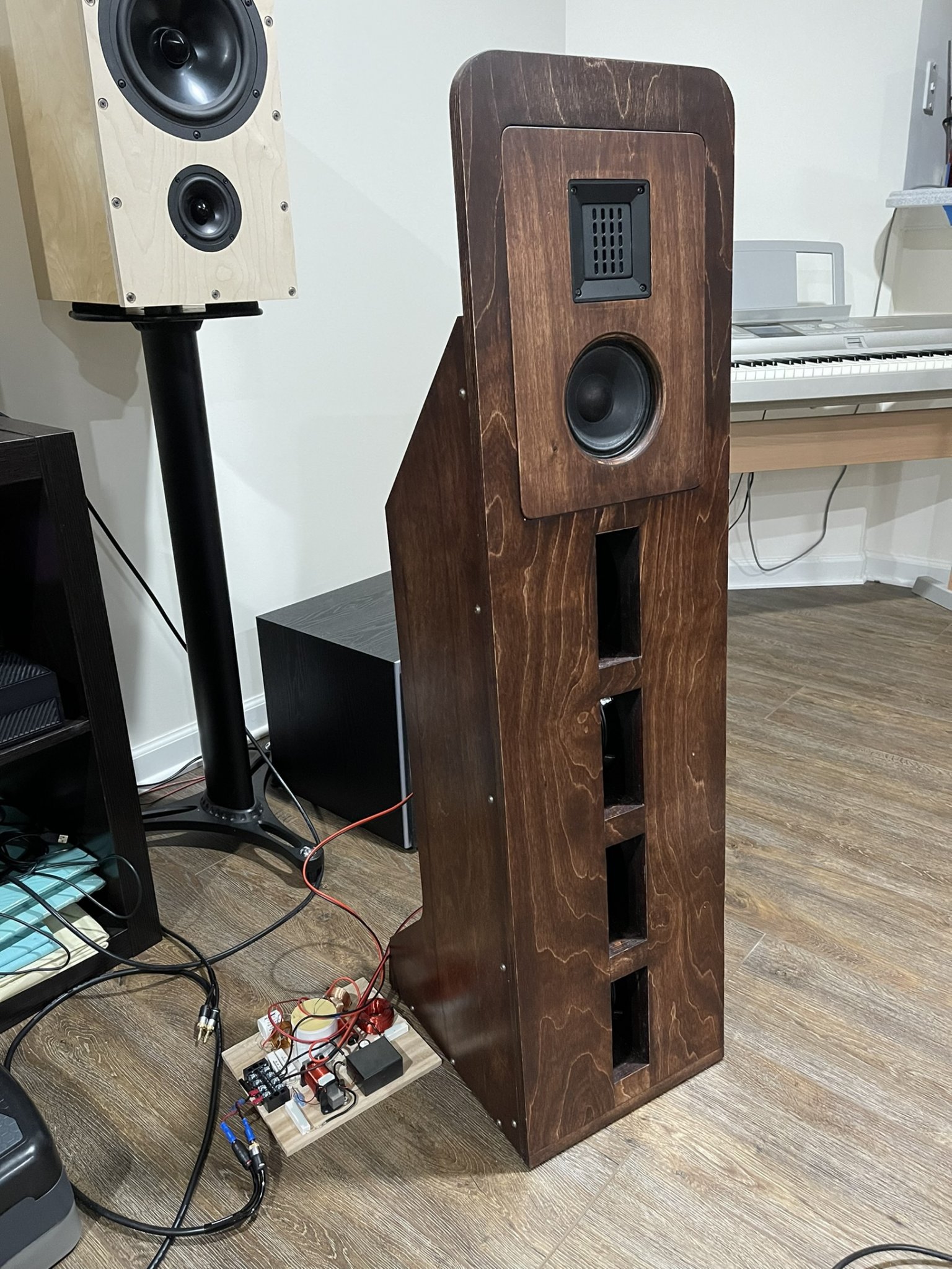

wow ... this is very very beautiful I would only separate the mid high section baffle from the woofer baffle ... to decouple the bass box from the mid highs..... Speaker looks like this: ....
I think it sounds pretty great. The bass chest punch is fantastic because the woofers are allowed to cover the 120Hz to 300Hz region. The imaging sounds like a fullrange speaker because a full decade is used by the mid. The highs sparkle and full of air and light without fatigue with the planar. And because it is a dipole, the ambience is very natural. Have a listen here.
Imho the satellite plus sub can provide interesting benefits A great bass speaker is a very challenging design ... for both driver and cabinet
Once the 200 Hz part is done right the remaining part is less difficult ... i am quite sure of this And for this i am looking more to cone midranges
I would dedicate to the woofer only the very bass
Very nice speaker indeed Very nice
