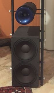

Thanks a lot. This is indeed my idea ... i start to think that i have a PA mind ... to be eccentric i could put the HF driver above the bass cab and not in the bass cab Do i have to look at PA design ? the only way to have an accepatable range coverage with a 2 wayYep, you must decide what drivers.

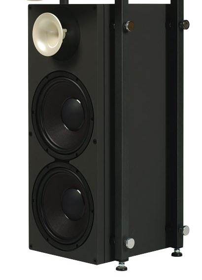

Gino, there is a good quality Scan Speak 2.5 way high end project Ophelia consisting of 2x18W 8531 G00 and D2908 / 714000 per cabinet designed by Klang+Ton tech staff. Filter network is fairly simple (7 parts only) and the drivers well behaved, FR and distortion measurements presented with schematic in magazine Klang+Ton, April/May 2014. Sensitivity 89dB, rated impedance 4 ohms, F3 about 35Hz.
A couple of nice 15" or 18" subs can be made quite cheap, it is very nice in stereo especially on some older recordings a single mono sub is simply not good enough, if you use some decent 2 way speakers for the rest you should be golden.I lived with small 2 way speakers ... i have been missing to much of the lower spectrum Unacceptable limitation Usually no serious bass below 100Hz

PA doesnt mean bad sound imoThanks a lot. This is indeed my idea ... i start to think that i have a PA mind ... to be eccentric i could put the HF driver above the bass cab and not in the bass cab Do i have to look at PA design ? the only way to have an accepatable range coverage with a 2 way

I think that going with a big woofer is a great choice. just like you, i was never satisfied with bass output from small drivers.
my system is a perfect example of what sort of BIG 3 ways you can build on the cheap with excellent SQ.
Hi thanks a lot and i am sure of their quality However i should have said this at the beginning ... i spend my life looking for so called giants killer i.s. units that provide performance well above their cost More simply units with a high Q/P ration The drivers you mention are very very expensive And the sum will be very high for a 1st project I have to start lower because the result could be very poorGino, there is a good quality Scan Speak 2.5 way high end project Ophelia consisting of 2x18W 8531 G00 and D2908 / 714000 per cabinet designed by Klang+Ton tech staff. Filter network is fairly simple (7 parts only) and the drivers well behaved, FR and distortion measurements presented with schematic in magazine Klang+Ton, April/May 2014. Sensitivity 89dB, rated impedance 4 ohms, F3 about 35Hz.
However i am noticing that many commercial speakers come with the mid high section looking very similar to a center speaker channel ... MTM arrangement
With the addition of a bass box it could be quite full range The only thing of which i am completely sure is that the woofers will have their own cabinet
But again MTM can be done with dome Ms or cone Ms ... sorry to sound like a broken record
I had in the past a Tannoy 611 that i guess should be like that ? i did not like them I liked more the 609 of which i still have the drivers and xoversI was just thinking that a 2.5 way would be an excellent project for Gino...
Exactly my feeling The bass is like a fundation of the sound ... the corner stone A good 8" is a minimum for a decent bass And the bigger the betterPA doesnt mean bad sound imo
