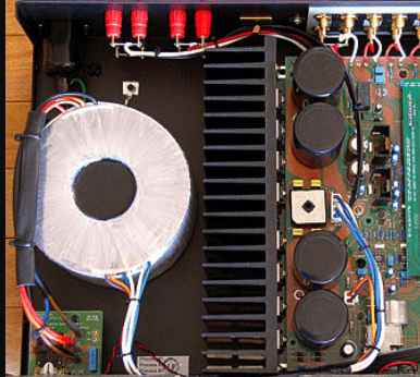

Peeping inside amps i see how amps should be layed out Big fast caps close to the outputs The pic below would be my reference as best implementation at least for a 50Watter

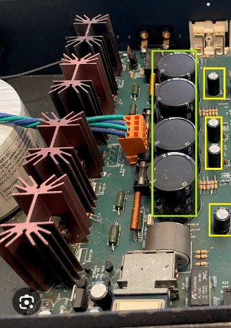

or this one as well
however it could be that some additional uF (i cannot do the calculation but i could measure at a bench if i had it) soldered directly on output device pins could limit the sagging
I really do not know how much Maybe 3300-4700uF ? one for each output device Maybe the offsett will vary
this could be done quite easily in some cases where there is space
