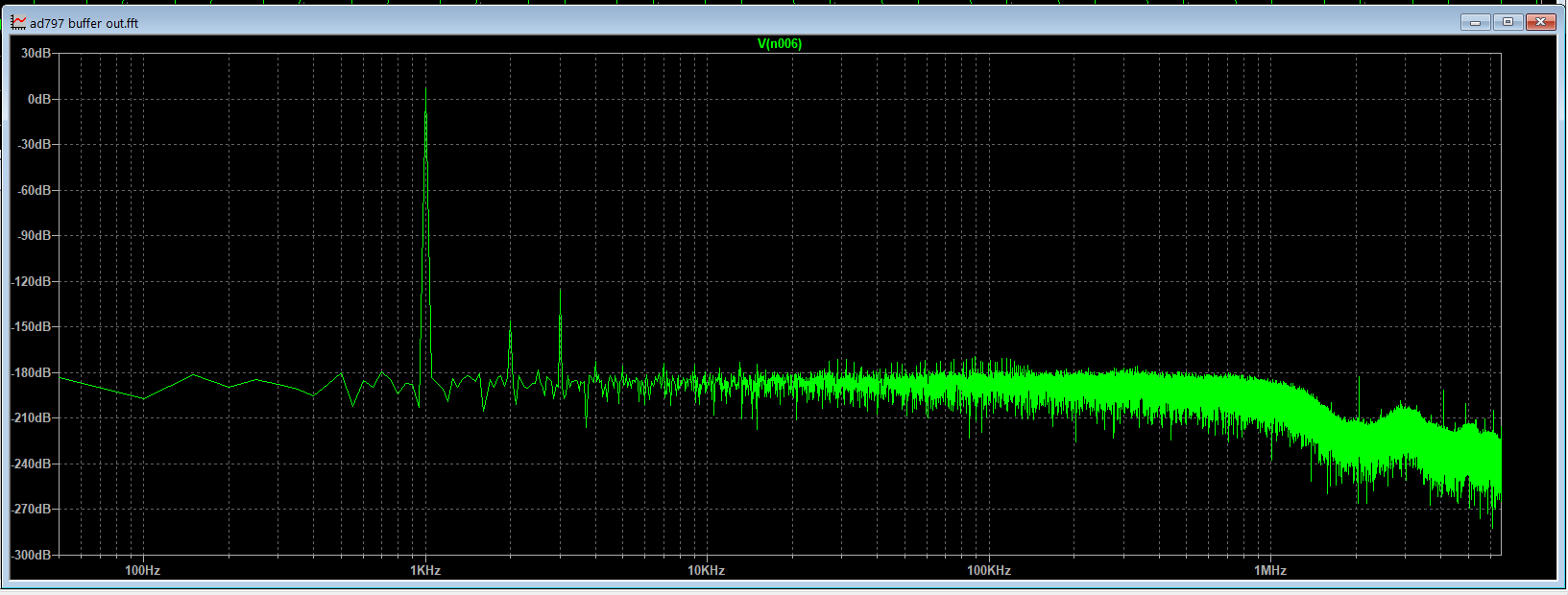

@ginetto61 : What you have to keep in mind here, when you compare your first prototype to this simulation, is that it uses an ideal voltage source as power supply and also an ideal current sink. The load is idealized as well and there are no parasitics included.
I see I have a question Is it possible that a circuit in real conditions will outperform the same circuit in ideal conditions i.e. in simulation ?
After getting usable settings just out of curiosity i simulated some preamp circuits of which i read good things They were not particularly great at sim
Good but not excellent I was quite surprised because considering as you say that in simulation there are some ideal conditions i would have expected better performance To be fair i did not use the exact transistors but similar I have also learned that topology seems more important than the actual bjts used
If the topology is wrong no bjt can make it work If the topology is right even common parts could provide interesing results

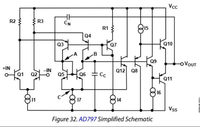

Thanks again I am doing a infantile thing ... i am looking at the simplified schematic of some op amps trying to mimic their output buffer stages topology
I know that the great performance comes from all the stages together and after application of global feedback but this is what i have obtained just for fun
strangely some circuits proposed as game ending i have not been able to sim And some others already simulated i cant check for lack of models
But i am sure that the default models in LTSpice are already way much more than what a basic user could ever need
The word "outperform" on it's own doesn't mean anything. Which factors of the device made it so people spoke well of it? In what context? Can that be attached to measured aspects? Which ones are these? And what is their measured value to be in order to make people speak well of the device?

The problem with models is that they are models. They are simplified "models" that will show most of the predictable behavior of the real thing. They won't predict what will happen at the parts per million level. They help a lot in predicting voltages and currents. They will not reliably predict the -120 dB distortion of real world parts in real circuits. Thats a different problem best addressed with real implementations (and at some point no longer the most important thing to pursue).
Hi i see your points Yes i tend to trust too much the simulation However for me it is already a big step ahead really let me explain why
I was following another thread about a minimalist buffer circuit and a member shows what he says is an innovative circuit saying that it took like 50 years for the basic circuit to finally be improved
One expert comments that simply by looking at the circuit you can see that it cannot possibly work
I try to simulate it and it actually doesn't work
Well, being ignorant, I wouldn't have immediately understood how the expert did it, which absolutely couldn't have worked
For example, I look at a current mirror and I don't understand how it can be used inside a buffer.
I'm at these low levels
An educated person looking at a schematic like the one below understands immediately the functions of the various part of the circuit
I can only spot the output buffer stage
