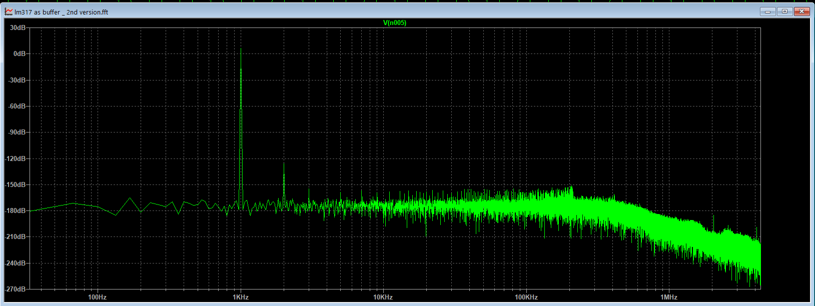

Hi and good morning to Everyone Just the last rambling and then i will stop on this subject Promised
Let's take a simple circuit that i like aestethically The one attached
Let's say that the goal would be to reach the lowest THD possible for a 3Vout on a 5kohm load (the settings i normally use for sim of buffers)
There are different parameters to "play" with ... npn type, currents, resistor, Vsupply
The possible combinations would be almost infinite
Why almost nobody is interested to assess how this simple circuit could provide in the best conditions i.e. to check its limits ?
Almost everyone would answer ... this simple circuit is clearly limited by its nature
ok but are you really sure of which these limits are ?
I mean before passing to a much more complex design why not investigate the ultimate performance of a simple circuit ?
Lets say that this will provide at max -90dB HD at 2kHz ... then if i want -100db i will pass happily to other designs but with not regrets
Maybe it is my impression but very few designers are stimulated by this challenge ... i.e. to extract the most from the least

The circuit is intriguing. Driving the emitter in this circuit essentially get you some power gain and no voltage gain. The emitter is both the lowest impedance and most nonlinear load option for a transistor. It would make sense if you are trying to maximize bandwidth (i.e. 300 MHz) but no benefit for audio. And driving the least linear point means you have distortion before you start amplifing.
I work backwards from the load requirements to optimize a circuit. And there are issues to consider that add complications. Short circuit protection, overload recovery etc. And then I look at bandwidth, Selling time slew symmetry etc.
And harmonic distortion is not a cause, its a symptiom of nonlinearity. That same nonlinearity will cause IM when more than one tone is present. Personally I think distortion below -100 dBC is enough to move the focus to bandwidth and transient responce stuff. However these all seem to work in concert each facilitating improvement in the other.
Hi ! thank you for the very valuable advice
I cannot get a 2nd harmonic distortion lower than -90dB with 1kHz signal 3V/5kohm from the circuit attached above
I tried hard because i love its simplicity but failed This means to me that topologies have indeed intrinsic limits ?
To be fair i have to say that i am using also low Voltages and common parts
Maybe raising up voltage supply and selecting boutique parts will increase performance I do not know
Since now the best performance i got is from a component similar to the LM317 I do not have the LM317 model unfortunately

Hi ! wow this is a lot better indeed !!! thank you very much for the very kind and valuable support
I understand well that one thing is the result at sim and another the performance of a physical prototype But i have also understood that a good result at sim is a good start Like instead a very bad result at sim should mean that the circuit need a rework
I am planning to try to build a prototype The nice thing is that the needed parts are quite cheap and common
If the prototype will reflect the sim i wonder how much is needed for a buffer seriously
The test load is already low being 5kohm ... almost no power amp has a Z input lower than this (maybe i should add some nF to the resistance ?)
And in the case of very sensitive power amp than can deliver max power with jut 1Vin or even less the THD will be even lower ... practically zero
To conclude my approach would be to stretch a minimalist circuit to its limits
So when I move on to a more complex circuit I feel more at ease with my conscience
There is an old saying by Albert Einstein: “Make things as simple as possible, but no simpler.”
I ask myself ... simpler of what ?
While I experiment the fact (also because I am verifying it with the simulations) that a typology has an intrinsic underlying limit
My doubt, as I said in the initial post, is what this ultimate limit is
Even a very simple circuit has several variables starting from better active components, supply voltages, choice of working points, etc.
When I see a complex circuit I am on one side admired and on the other shocked. It's an upsetting feeling
Thank you very much again for your precious help
Have a good day and best regards, Gino
