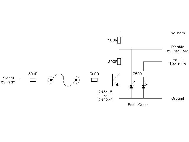

I like ufokillerz would like to know how to connect a power LED to the ALC0180-2300 abletec board.

I have working Arduino / PGA2320 / DRV134 Preamp and two ALC0300-1300 amps.
Here is my standby circuit. Used common cathode Bi-colour LEDs though diffused are probably a better bet than the "superbright" that I used - they illuminate the corners of my room. No mistaking when the units are powered.
The small current drain eliminates the "standby whistle" noted by many.
Adjust resistor values to suit your LEDs.
5v trigger from preamp - I used 2mm banana plug for signal.

Apologies for dodgy standby schematic. I couldn't read my own scribbles.
Here is corrected version.
Omholt, whistle on standby? It has already been mentioned. A small load (milliamps) on the standby will fix. The standby schematic fixes it.

when you put multiple d-class modules in one case and one is oscilating at 400 khz and another at 416 khz then you have a frequency difference of 16 khz that is sometimes audible. Mayby is that the reason why you hear a hf tone.
Remedy: put the different modules as far as possible from each other in the case. Use the same oscillator for all your modules (i don't know if the abletech modules have a master and slave function for the oscillator)
sonomanie:
It doesn't help to put far from each other. It also there when only one is in use. What's almost funny is that the high tone is also present for a while when the amp has been totally disconnected. It stills "sings".
What russc made be aware of was that it's only there in standby. Hopefully his suggestion will take care of it. I'll report back. Thanks guys.
