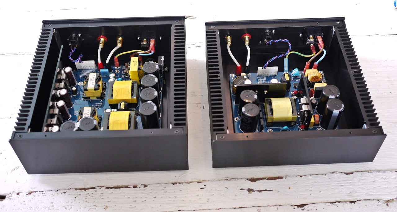

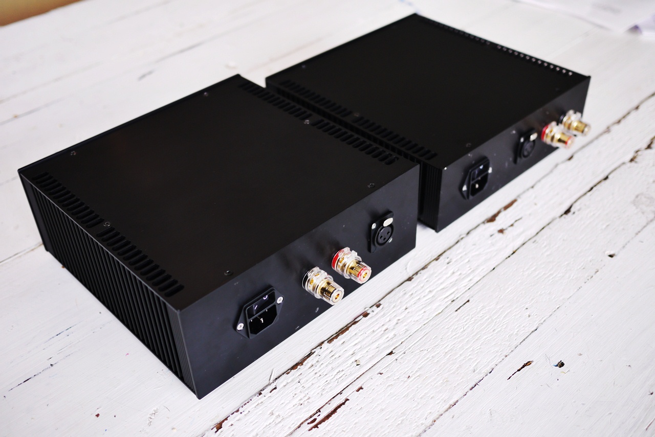

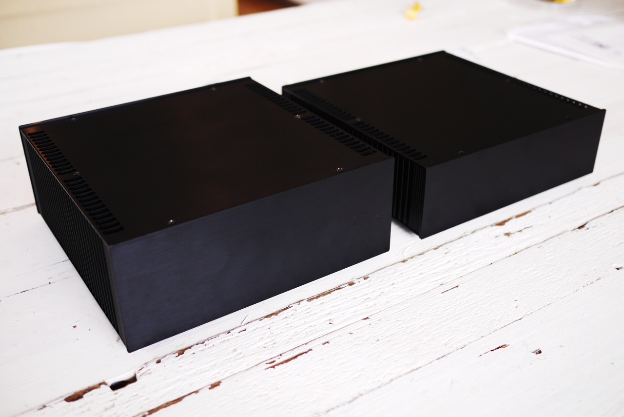

Hi, I went for it and just completed building 2 ALC1000 and 2 ALC0300 amps.
Have only been able to test on old passive speakers, so difficult to say too much about SQ, but it seems promising so far.
My plan is to go active and build some new speakers for this project. But it may take a while.....
Regarding pops and clicks:
Power on: The amplifier itself only give you a relay click after a couple of seconds not audible in the speakers.
Power off: A slight click in the speakers, but IMO it should not be loud enough too damage any connected speakers.
And here some pictures for anyone interested:
First time attaching pictures, so hope this works....
- Svein

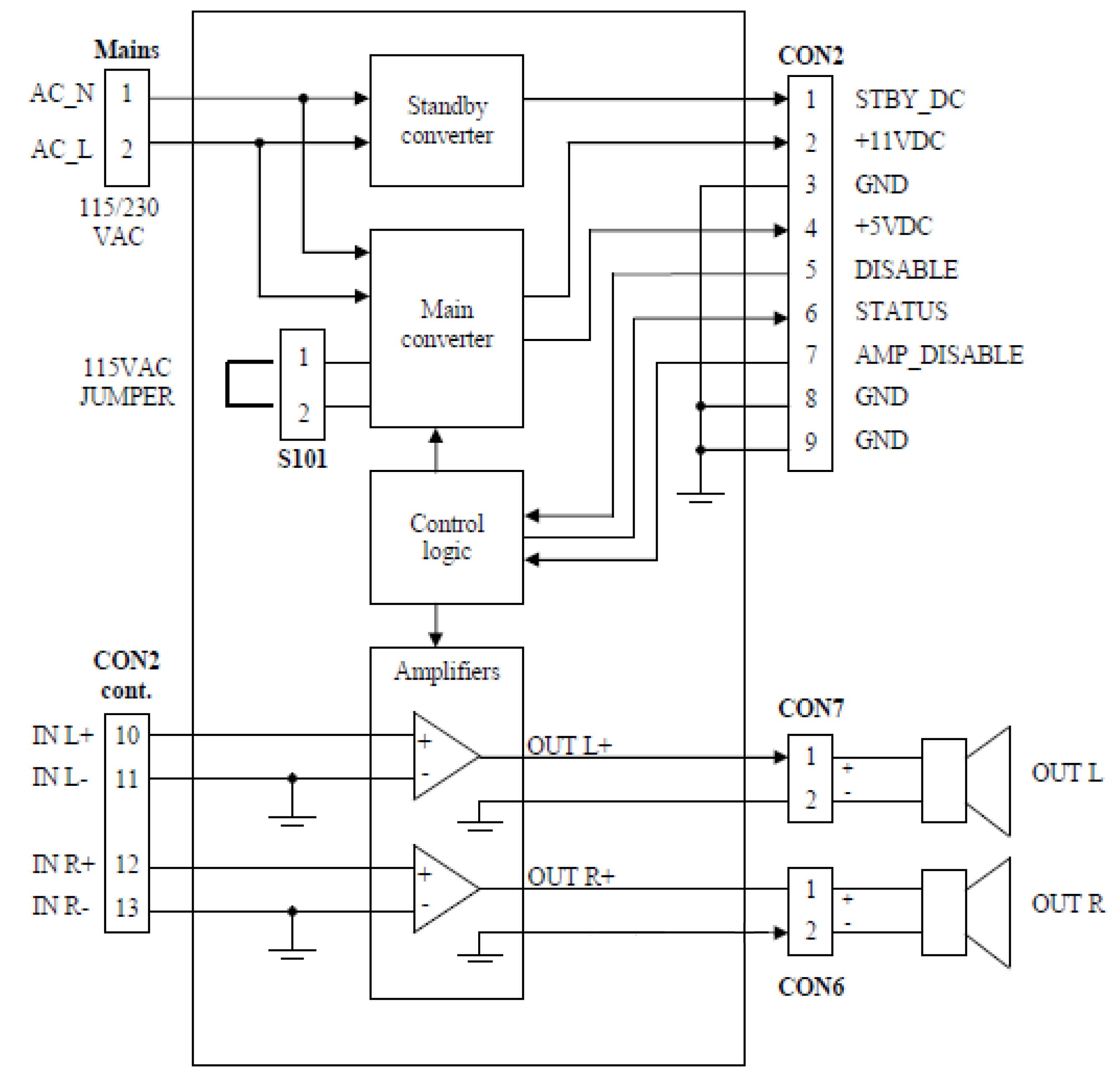

Connecting unbalanced outputs to balanced inputs on ALC0180 modules
The ALC0180-2300 modules are Class II double insulated and thus there is no earth (ground) via the mains cable.
I need to connect long coax, unbalanced preamp output cables to the ALC0180 balanced inputs.
I could simply connect the central coax signal wire to the + terminal and the shield to the - terminal. However, I suspect I will have a hum problem with this and potentially an Electrostatic Discharge risk to my inputs.
Am I right in thinking that I do need a mains earth for the ALC0180 which I link to the - inputs and hence the preamp cable shield?
This should remove the hum and ESD risk.
Do I also need to connect the ground to the ALC0180 pcb ground also or can I just leave it floating?
Any guidance much appreciated.
Andy

Here’s my experience with the Abletec ALC0240-2300 module.
This device is marketed as a “plug and play” two channel power amplifier complete with power supply, and it should be a simple matter for the end user to connect up the mains power, input connectors and speaker connectors and start using the amp.
Unfortunately, due to (amongst other things) the deficient instructions provided by Abletec, end users who configure the amp in single-ended mode in accordance with the published Abletec “block diagram” and connect it to unbalanced sources will end up with severe hum in both channels.
The reason for this is that Abletec’s block diagram for single-ended operation with unbalanced sources depicts the + and – inputs of both channels without any ground connections.
In order to prevent or minimise hum, it is necessary to either ground the – input of each channel to a ground pin on the amp (or to the star earth point if the amp is grounded to the chassis), or use shielded two core cable with only the shield grounded at both the preamplifier and the amp.
Sadly, none of this information can be found in any of the documents published by Abletec, and it seems that Abletec just assumes that the end user will know these things. As many hobbyists have only limited technical literacy, Abletec should provide that information, together with clear and unambiguous connection diagrams.
Which raises the next issue I have with Abletec. It is not clear from the Abletec block diagram whether the ground symbols on the block diagram depict internal grounds on the amp PCB or ground connections which need to be made by the end user. For example, Pins 3, 8 and 9 are internally connected on the PCB and it is necessary to make a physical ground connection only if you want to ground the amp to the chassis. All internal PCB grounds should be marked as such in the Abletec block diagram, and external ground connections clearly identified.
Finally, there is the curious absence in Abletec’s specifications for the amp of its input impedance.
In order to avoid pumping of the power supply rails, Abletec has the left channel of the amp connected in non-inverting mode and the right channel in inverting mode.
I measured the input impedance of each channel of the amp (with 8 ohm loads) when configured in single-ended mode in accordance with the Abletec block diagram, with the following results:

There is a marked asymmetry between the input impedances of the two channels, with an unusually low input impedance in the right channel. When the amp is used with a typical vacuum tube preamplifier with capacitor-coupled output, the result will be audible channel imbalance, premature LF roll-off in the right channel and increased distortion (particularly if the preamp does not use a cathode-follower output).
When auditioned in such circumstances, a negative perception of the performance of the Abletec amp will be the likely result.
Abletec should have disclosed the input impedance characteristics of the amp, as this is essential information for the end user.
There are, however, two cures for this problem.
The simplest is to discard the “anti-rail pumping” setup and wire the amp for unbalanced sources as shown in the attached image. Note that this only works with preamps that are compatible with 10k loads. If hum continues to be a problem, just use shielded two-core cable.
The other, more complex, alternative is a construct a high quality two channel unity gain buffer and interpose it between the input sockets and the input pins of the amp. This method permits the “anti-rail pumping” setup to be used without disadvantage.
I opted for the “simplest” cure and found that the amp performs very well indeed when connected to my home-built vacuum tube preamp (which uses 6DJ8 cathode-followers with both sections of each output tube connected in parallel).

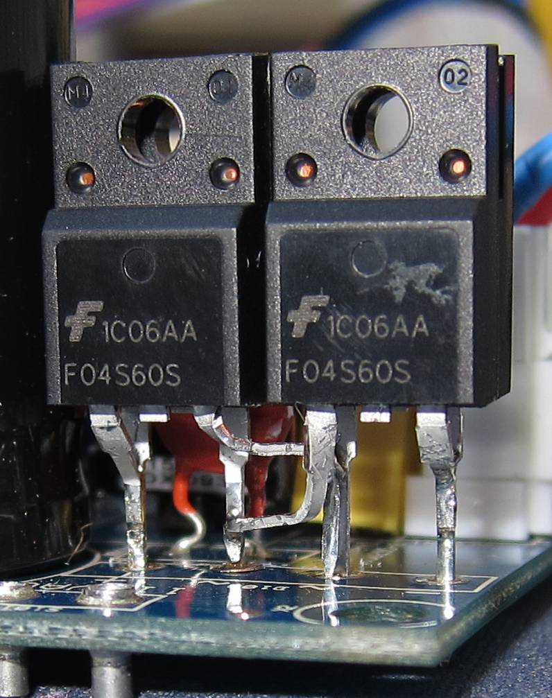

I have two ALC0180-2300s of which I'm making changes to one so I can compare it with the other. Eventually these will be a pair of bridges for the final amp but I'm using them singly while experimenting.
I've ordered a set of OPA2604s as Wim suggests; however, before inserting those, I have a mod which I always find worthwhile before any signal component changes - namely the mains cable to oxygen free copper and the replacement of the cheap rectifiers with Schottky devices.
The idea is to avoid introducing RF noise at the mains input due to the reversing voltage switch-off spikes in the rectifiers. Schottky rectifiers are fine for simple transformer/rectifier/capacitor supplies as the reverse voltage is usually not too high for them. When it comes to switch-mode supplies, there is a little more to it.
The ALC0180s have four secondary diode rectifiers type ES3B with a fast 20nsec recovery time. Added to this, there is a RC snubber across each one. Clearly the designer was considering RF interference from these. However, other than cost, what I can't understand is why the mains input voltage rectifier is a 'Bog-Standard' GBL06 bridge type with no snubbers.
The GBL06 has no figures specified for its switch off time and can thus be assumed to not have that parameter optimised for low RF emission.
Mains voltage (230v in the UK) is far too much for a Schottky rectifier so I've searched out a fast, soft recovery type to use - namely Fairchild's FFPF04S60STU (Farnell 188-5724). Of course 4 of these TO-220F packaged devices are needed to be squeezed in where the bridge was but it is possible with care.
The result: The original was good, clear and revealing but slightly shouty and up front. The modified version sounds more relaxed and analogue-like.
Give it a try and post your impressions of the mod. (And don't touch anything with a mains voltage on it!).

ALC1000
Mains connector
Pin 1= AC_N (Neutral)
Pin2= AC_L (Live)
Pin3= PE (protective Earth same as earth. Not needed).
Be careful pressing the contact.
PCB has contacts on the backside as well....
If you wish to connect balanced (with XLR) then Input+ to pin9 (IN+) at CON1 and signal- to pin10 (IN-) at CON1 and finally the signal to signal GND to pin8 (GND) at CON1. If you do single ended connect signal to pin9 and gnd to pin10+pin8.
ALC0300
Mains connectors
CON2= AC_L (Live)
CON3= AC_N (Neutral)
(No earth)
Balanced signal (with XLR) to input skal connect your signal+ to pin9 (IN+) at CON1 and signal- to pin10 (IN-) at CON1 and finally your signal GND to pin8 (GND) at CON1. If you do single ended connect signal to pin9 and gnd to pin10+pin8.
Hope this helps.
I did get better documentation by contacting Abletec directly, but can unforunately not find it at the moment.
Svein
