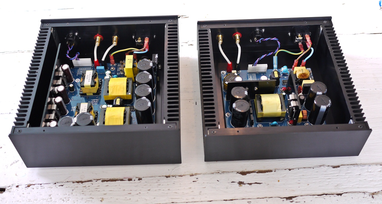

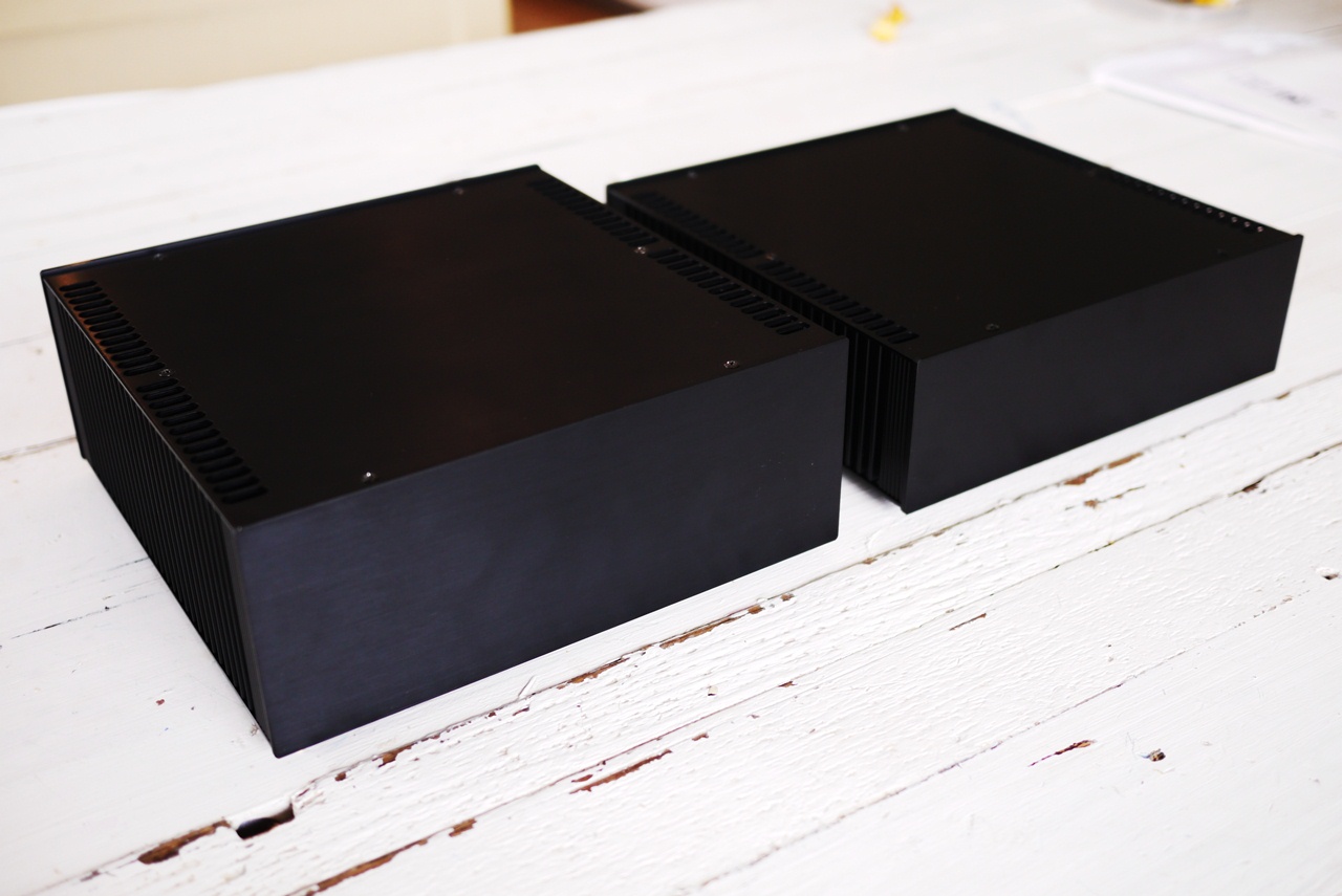

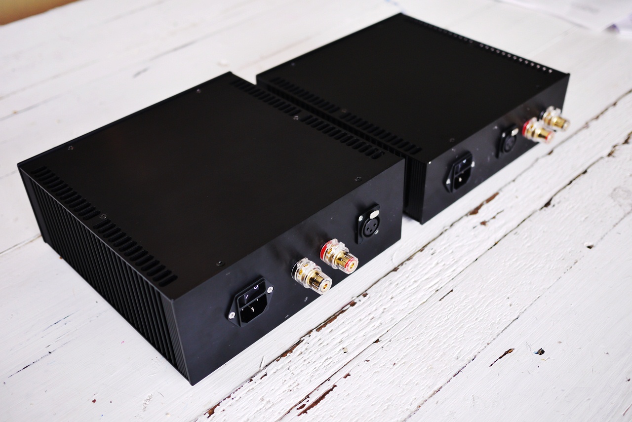

Where did you buy these cases? They look good and have solid cooling ribs.
I've looked for cases at Modushop and the only one that fits ALC1000 well is GALAXY Maggiorato, but it probably can't take much heat.
modushop.biz
hi i have mine built in the Galaxy Maggiorato, and after 5-6 hrs, they are very cool to touch.
Those cases are from TAKACHI ELECTRONICS ENCLOSURE CO., LTD.
the cases that he used from takachi were the HY88-23-23BB
http://www.takachi-enclosure.com/data/c1213/c_en_p151-152_155-156.pdf
and current price, i inquired a week or so ago is $100.39 USD per case

mine were the 230x230mm, you can see the picture i posted above, that is the alc1000 inside the galaxy maggiorato 230x230
i applied thermal paste on all outside surfaces of the alc1000, and it touches my case on all sides.

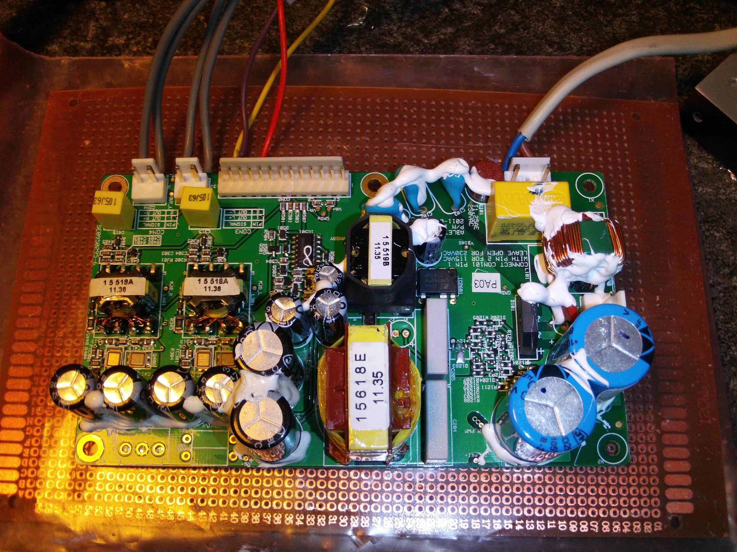

So i bought one of the ALC0100-2300 modules, first impression are really good, dead silent with no signal and no noises what so ever from the onboard power supply.
Also shipping was lightning fast, bought it like last weekend and it arrived today.
