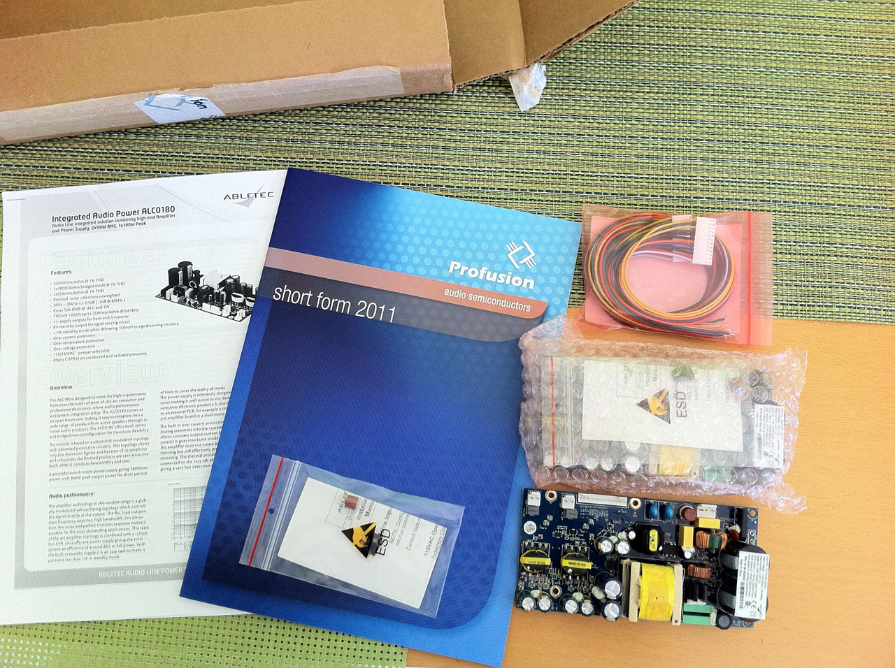

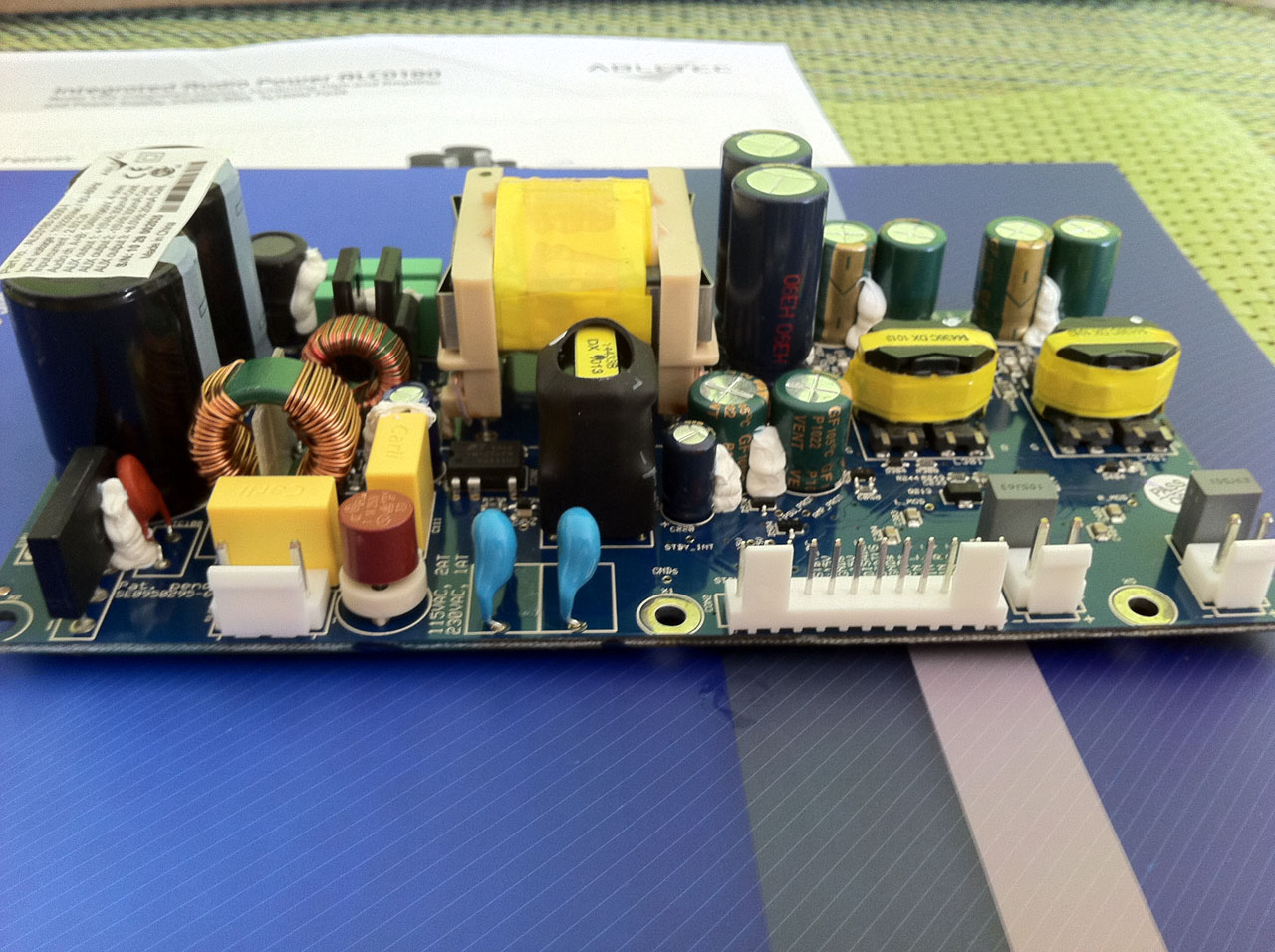

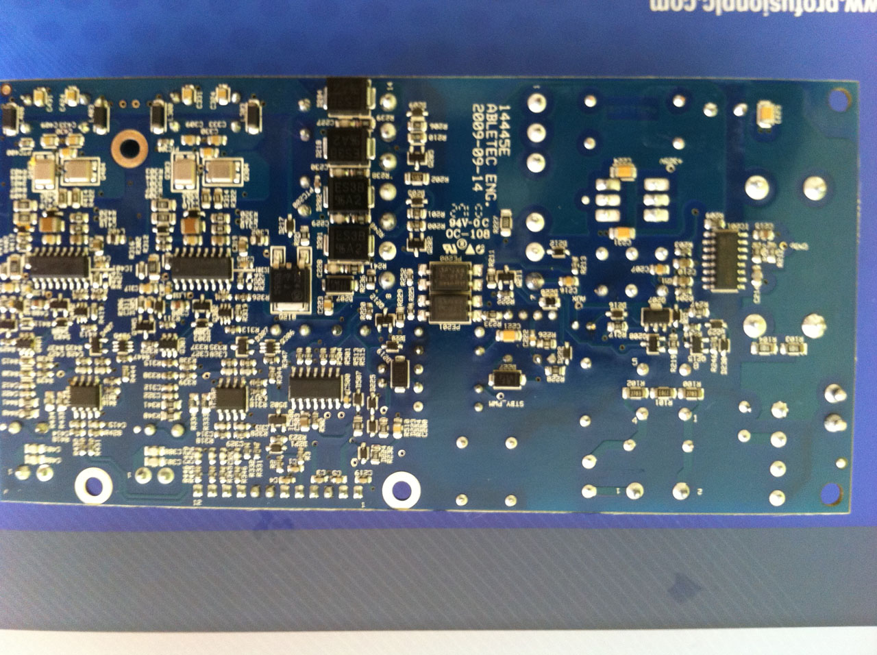

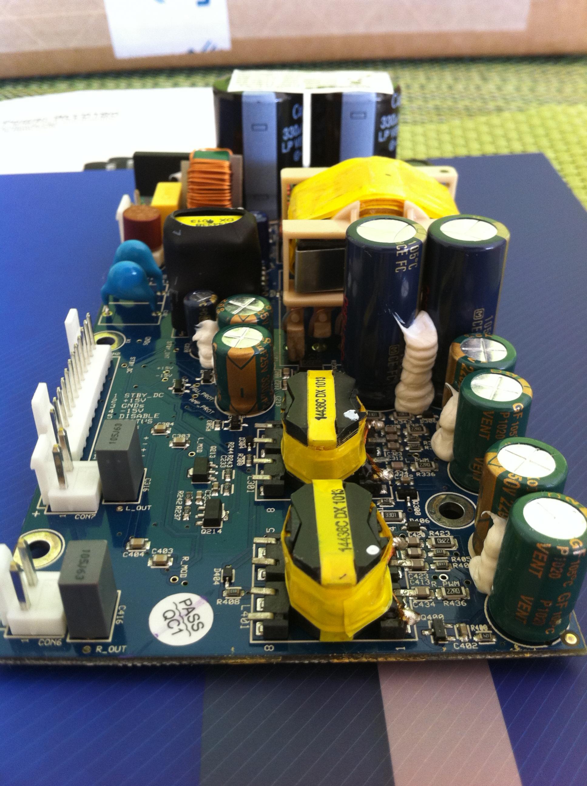

The Abletec modules had been recommended in another thread, where I had been asking for proposals for a 3-way system.
The ALC0180 seemed to be such a good deal to me (less then 100 EUR for a stereo board, PSU included) that i decided to order two of them at profusionplc.com.
The parcel arrived today, about two weeks after ordering. Hopefully I'll find some time for testing them this weekend.
Meanwhile some pictures:

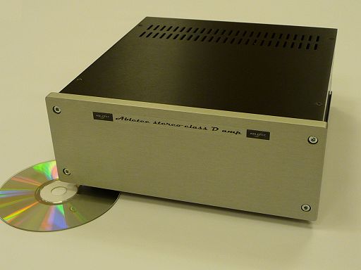

Enclosed 2 photos of my Abletec amplifier.
Wim

Pictures of the Abletec amp look great. Did the connectors come with the module?

Hi Svein,
the connectors shown on my pictures have to be ordered additionally.
You find them at the bottom of the ALC0180 product detail page under "Related parts and parts bought in addition to this item":
ALC-MP133-1.
1.79 EUR per piece 🙂

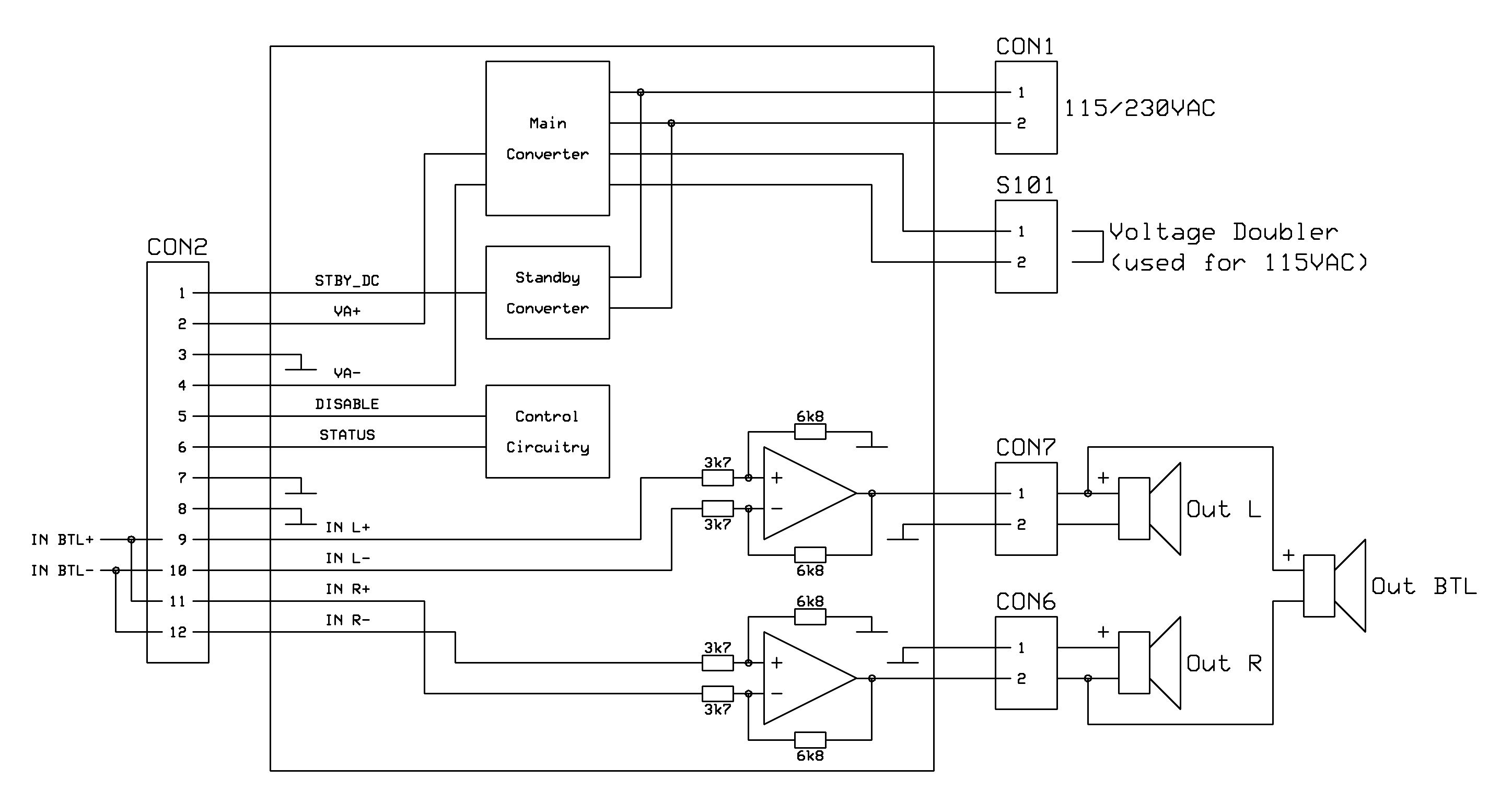

Hi Wim,
du you have any information about how to configure the ALC0180 for bridged mono?
I send an email to Abletec with this question two days ago, but did'nt receive any answer 🙁
Regards
Matthias
Regards
Matthias
Hi Matthias,
I have an idea how, but just to make things sure I did email the Abletec/Anaview company and they wrote that they will take care to upload a connection diagram in this thread.
Do notice: the bridge configuration is only to be used with 8 ohm load. Accordng to the Abletec infosheet the output power will be 180W into 8 ohm.
Wim
Just post a message regarding the bridge mode config and just a few minutes later I received a mail from Abletec/Anaview with the connection diagram.
Enclosed you can find the connection diagram they send, this to connect the ALC0180 in the correct way for bridge mode use.
Wim
Wim
The bass drivers I want to use with them are 13 ohm. So should be no problem.
