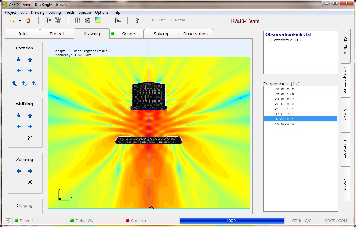

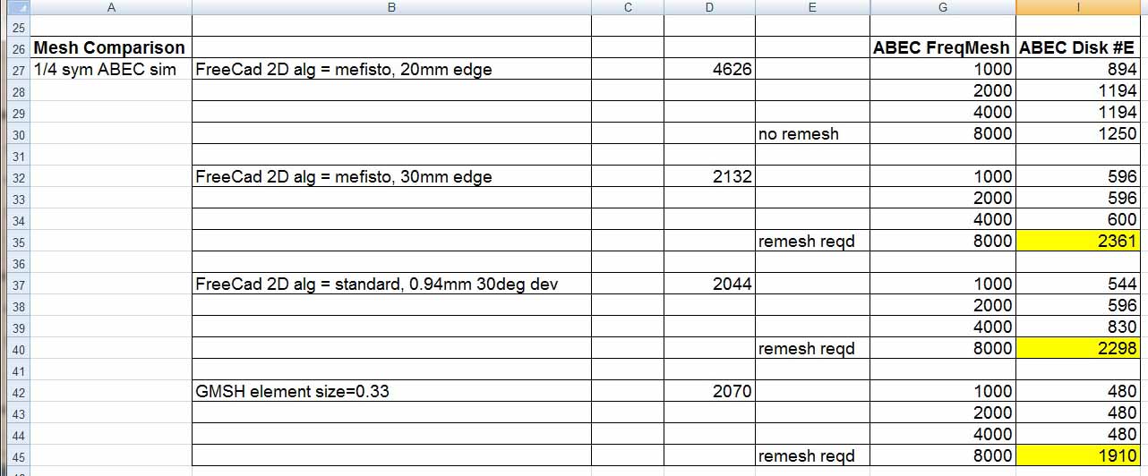

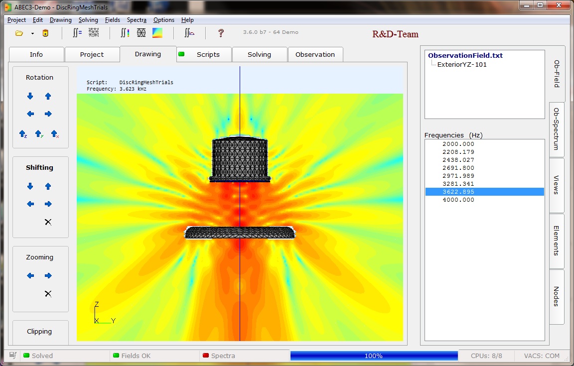

Back in post #118 where this all started, there was as interest in comparing design flows to get a mesh into ABEC3. A simpler way.
I've changed the options a little after playing with the tools. There is no benefit to bringing stl into GMSH because its a mesh-mesh conversion.
a) use Freecad Std mesh stl to ABEC and remesh if required
b) use Freecad Mefisto mesh stl to ABEC and remesh if required
b) use Freecad stp to GMSH msh then to ABEC and remesh if required
There was also the issue of specifying ABEC3 "MeshFrequency" or "EdgeLength" as required in the control solver. It's related to the quality of the simulation's upper freq and can result in an ABEC remesh if it's insufficient. In the ABEC3 help document, the relationship is specified as "EdgeLength=0.5*c/MeshFrequency" where c~344m/s. The FreeCad mefisto stl algorithm can specify edge length, so 20mm edge -> 8600Hz and 30mm edge -> 5733Hz before triggering ABEC remeshing.
I set the mesh parameters to provide approx 2000 element meshes to allow a fair comparison between the algorithms. What is interesting, in the table below, is the dramatic jump in #elements when the imported mesh is too coarse for the specified MeshFrequency and a remesh is triggered. The HAT is aimed at the test disc and the diffraction patterns should be very similar if the mesh surfaces are adequate. My preferred design path will be FreeCad stl direct to ABEC as I can get as good results (as GMSH) with fewer steps. I will also correct a statement I made earlier in post #102, you actually do need to create the 1/4 symmetry mesh before importing into ABEC.
The pictures are :
1) freecad mefisto stl 20mm edge ABEC meshfreq 8Khz and obs 3.6Khz
2) freecad mefisto stl 30mm edge ABEC meshfreq 4Khz and obs 3.6Khz
3) freecad std stl 0.94mm and 30deg dev ABEC meshfreq 4Khz and obs 3.6Khz
4) freecad stp GMSH delaunay 0.33 size ABEC meshfreq 4Khz and obs 3.6Khz
5) mesh comparisons
Hi Don,
Thanks a lot! Very interesting. I'll link your extremely valuable contributions to the ABEC-Thread in the German DIY-Forum.

You should never remesh in ABEC if you have curved surfaces such as a waveguide because the new vertices will lie on the old big flat triangle and not the curved surface of the waveguide. Only consider remeshing in ABEC if all the surfaces are flat.
An STL mesh that is being produced for 3d printing will have the largest triangles possible on flat surfaces because these are exact if all you are interested in resolving is the geometry. This is not the case when solving for a sound field which may vary strongly over geometrically flat surfaces. Your STL meshes shown earlier suffered from this problem.
Required mesh resolution is conventionally given by a number of elements per wavelength. 0.5*c/f is 2 elements per wavelength and only full spectral methods will produce accurate results with this level of resolution. I think ABEC uses zero order triangles which is the least accurate element and so will need significantly more elements per wavelength to give accurate results. It is easy to test this by doubling the refinement and checking if the result is the same or different. If it is the same then the coarser level of refinement is adequate. If it is different then the finer level of refinement may or may not be adequate and you will need to test again with another twice as refined grid. This method to find what level of grid refinement is required for grid independent solutions will be performed by all competent engineers when faced with a new numerical solver and/or new test case.
The number of elements per wavelength is not the only criteria for refinement. How strongly a surface curves also needs to be considered or else a small rounded shape will become rectangular or even completely flat. An example of this is the tweeter surround. Most mesh generators will have something to control this, often a maximum angle, but I am unfamiliar with freecad and gmsh. Is this present?

FreeCad's "standard" stl can produce large triangles on flat surfaces. However the "mefisto" stl produces elements constrained by the max edge length. The mefisto max length can be used to deterministicaly generate a mesh consistent with ABEC3 MeshFrequency. Post #134 shows the mesh outputs of FreeCad's various stl export settings.
The mesh vs frequency relationship is consistent with ABEC3 docs. You can certainly use mesh iterations to find an adequate result, but why not start by directly specifying the resolution you need. ? I also don't know enough of ABEC's internal working to be confident in tricking it by specifying a low MeshFrequency to avoid remesh. I check the solve report and I know in <10sec if the mesh if too coarse from seeing the jump in the #elements as I increase MeshFrequency.
I also think there are limited areas like waveguide throats and membranes where you may need an excessively high resolution to maintain a smooth surface to get a good results. I just don't have enough expertise to be intuitive about it.

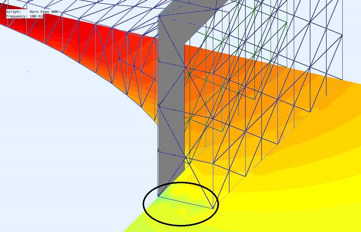

I am familiar with BEM but not ABEC. According to the presentation this example seeks to incorporate an infinite baffle into the boundary conditions which is a nice feature for modelling speakers. Unlike the symmetry boundary condition this boundary condition is almost certainly not exact (note to self: find out a bit more about ABEC) and so will likely produce artifacts like that shown.Here is a clip from the ABEC examples, the Expo 400 horn.
After it is solved there is small but noticeable artifact at the boundary, circled in the picture.
How do we eliminate or minimize this?
If you add another row to the infinite baffle grid I would expect this artifact to reduce in strength 1) because the field is weaker and 2) possibly because the approximation of the infinite baffle is improved but I don't know and would like to. If you do add another row to test can you please post the result.
