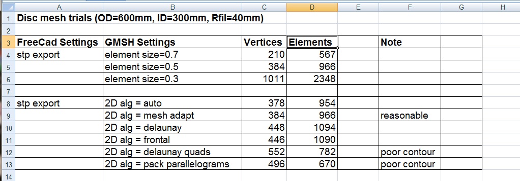

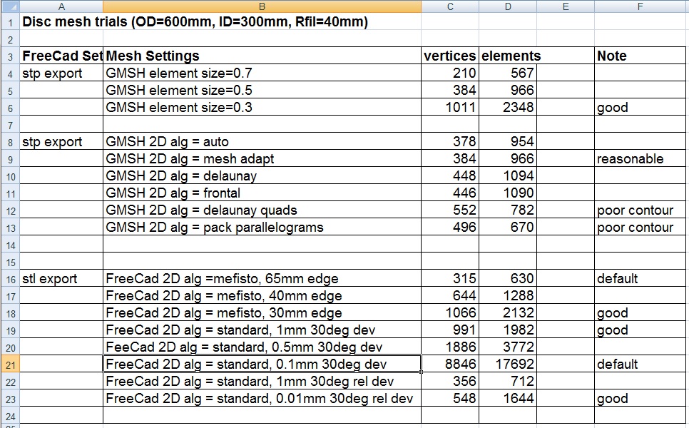

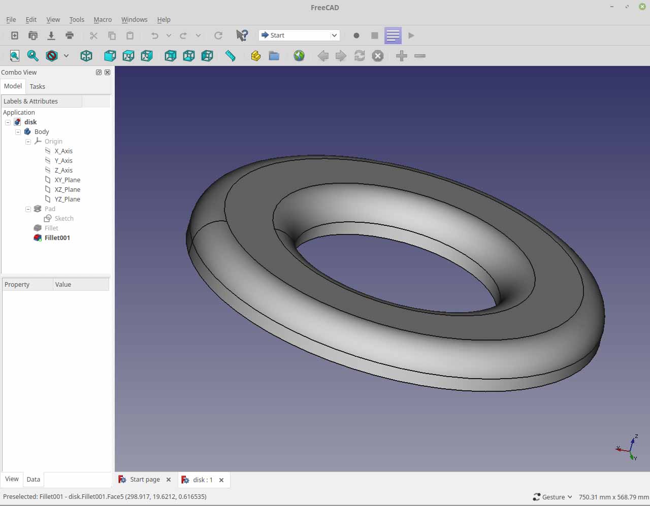

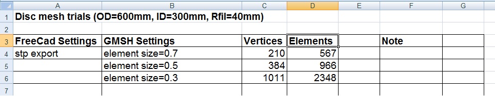

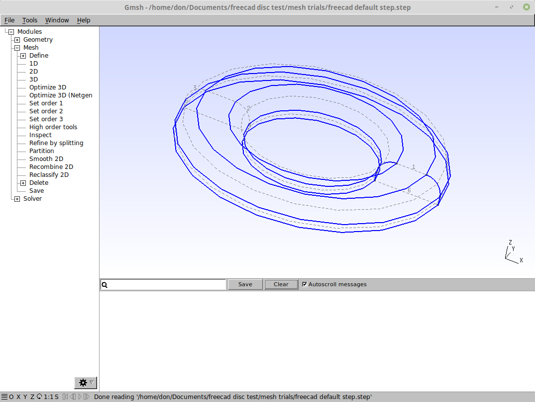

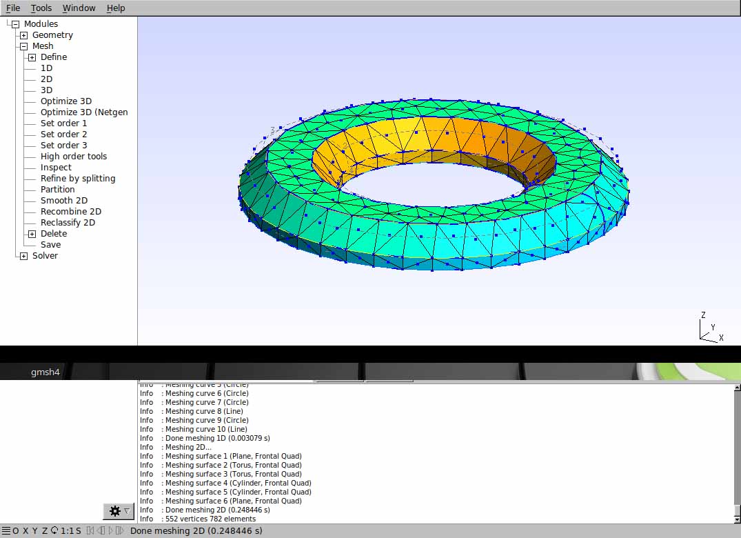

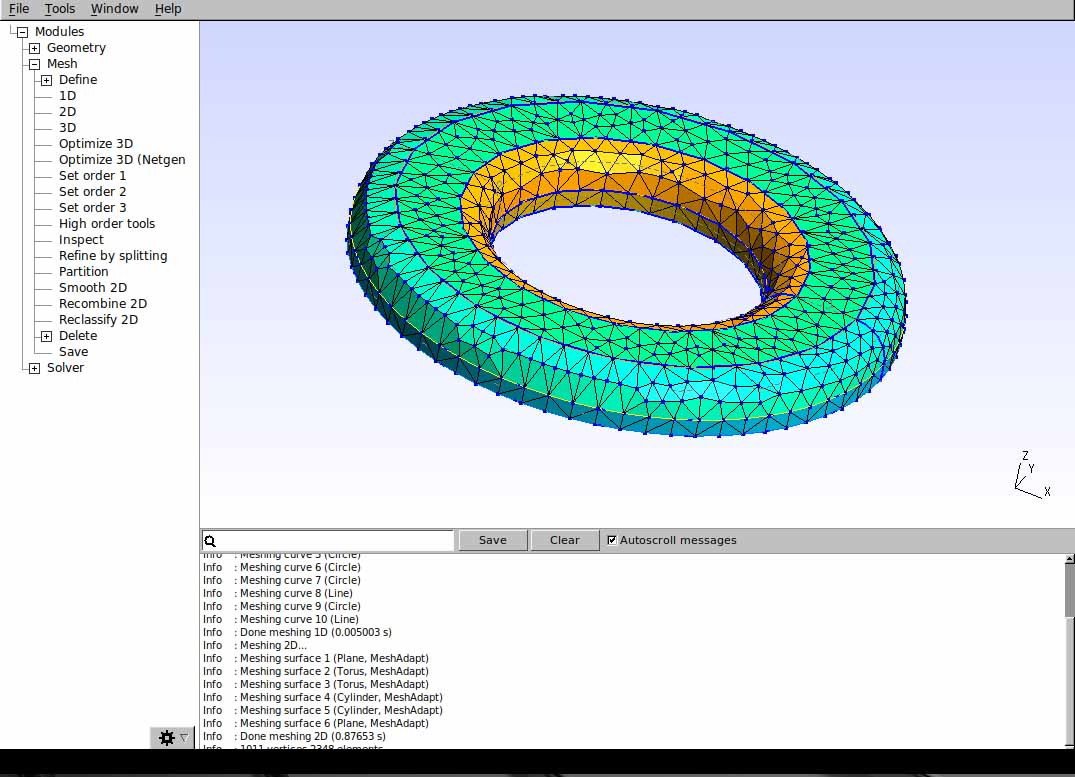

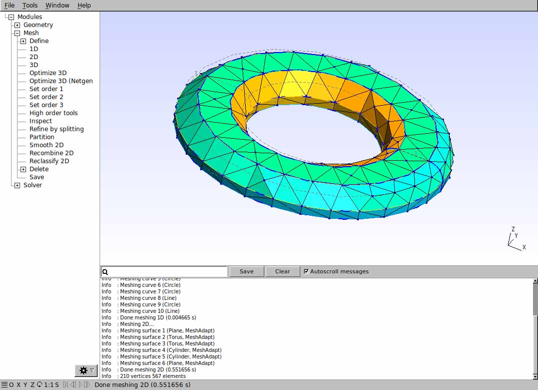

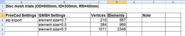

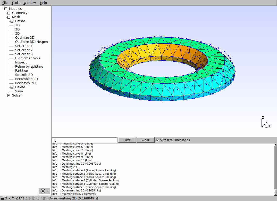

Mesh 1 - GMSH element size
Back to mesh comparisons.
I'm using a large disk [ OD=600mm, ID=300mm, R=40mm ] to create a curvy surface with some flat sides. It should exaggerate issues with meshing and has polar symmetry to (hopefully) make spotting defects easier.
The first comparison is FreeCad stp to GMSH to try a few GMSH settings to see how it affects the mesh quality and size. The starting point are Gaga's previous settings (element size =0.5) as they seem very good. Freecad does not have any adjustment parameters for the stp export. The GMSH meshes use element size [0.7, 0.5, 0.3], and the result is very sensitive to this parameter. I like Gags's suggestion to try 3 sizes and pick one that's suitable. The results are in the table.

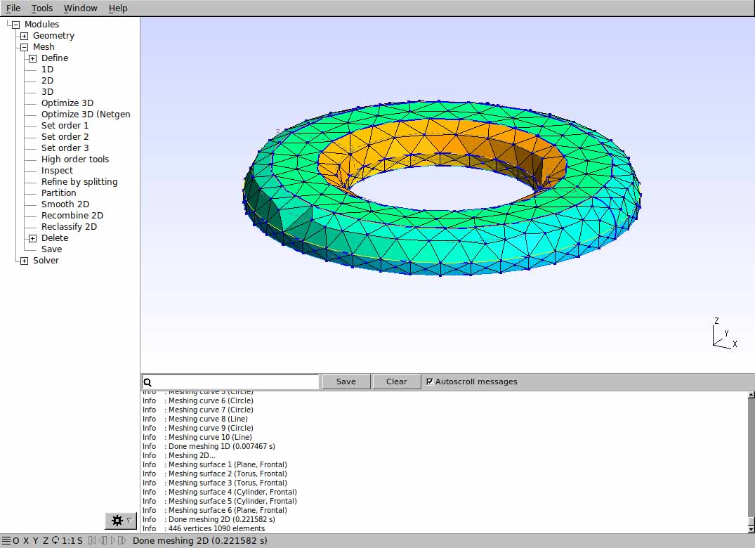

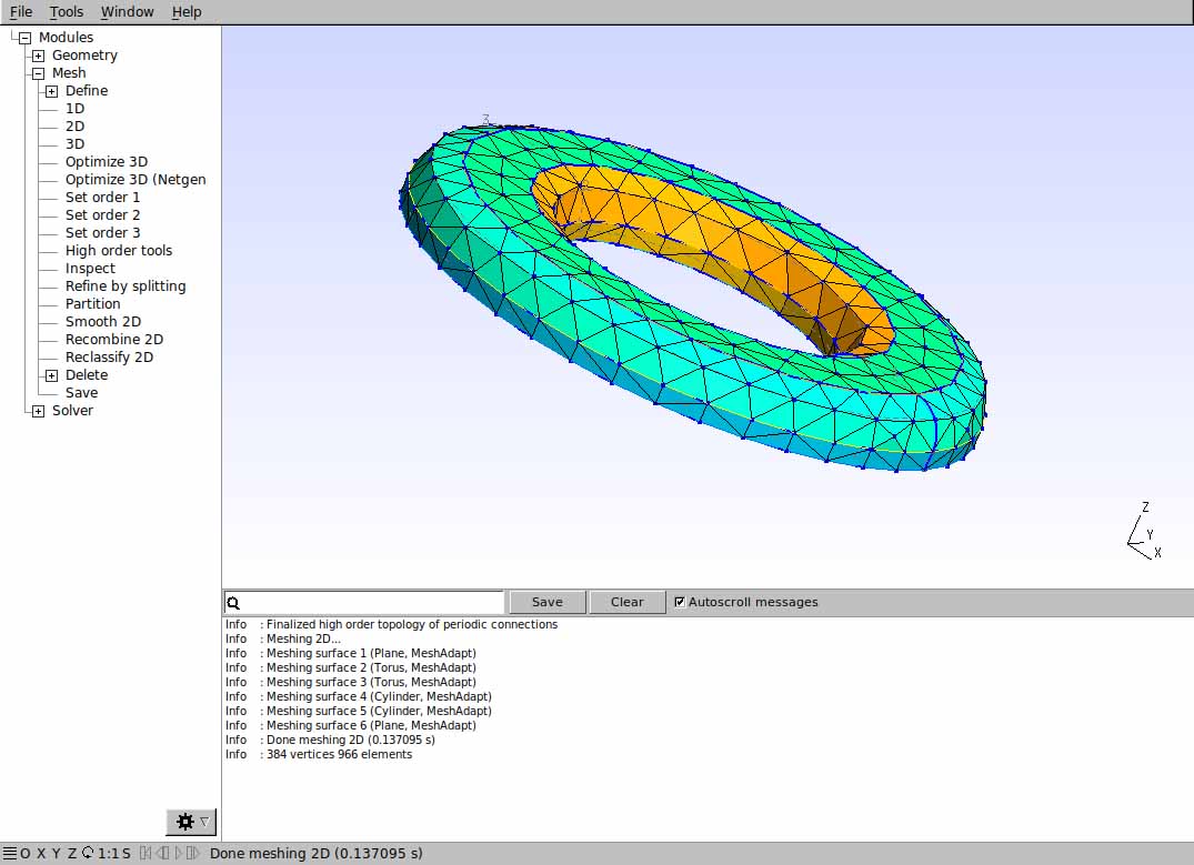

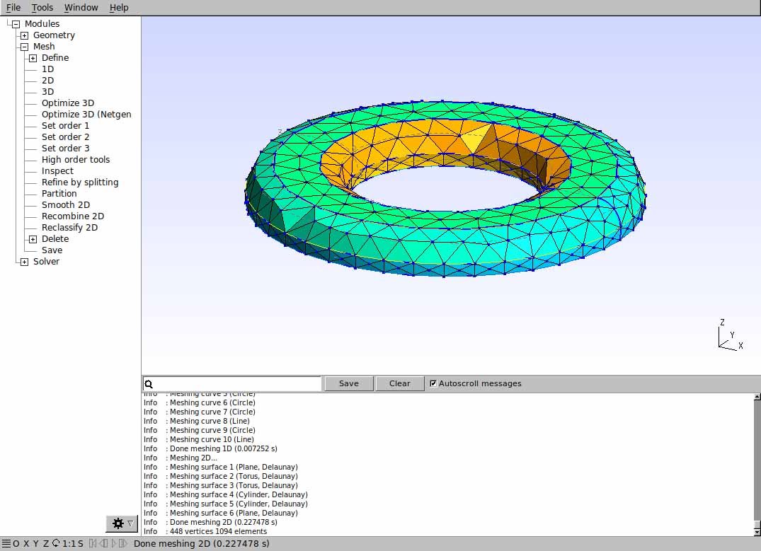

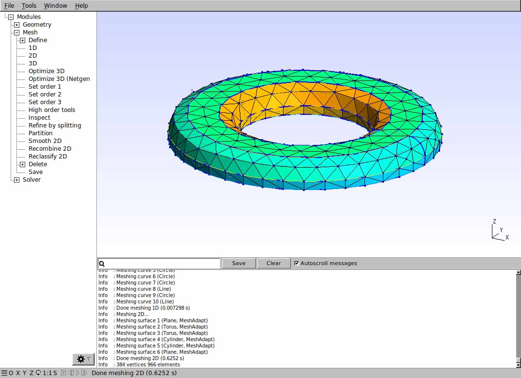

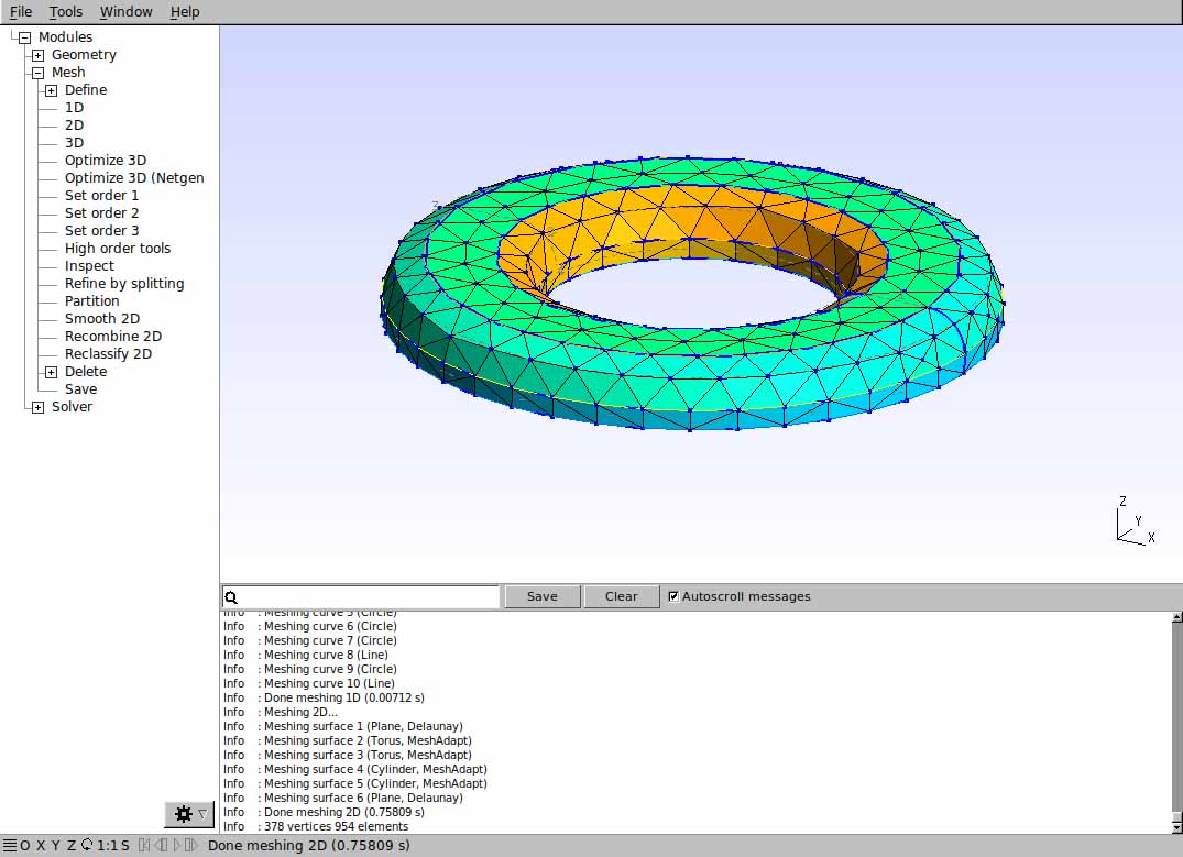

Mesh 2 - mesh algorithm
The element size = 0.5 is constant while the algorithms were changed to check sensitivity.
The pics (left to right) are [ Auto, MeshAdapt, Delaunay, DelaunayQuad, Frontal, Parallelogram]. Gaga's preference [MeshAdapt] seems to be good. The table lists the comparison, and there is moderate #element size variation and the quality does vary.
Good to see the mesh study and to add a few comments:
- Quadrilateral elements are almost always preferable to triangular in terms of accuracy but the strength of the preference will depend on the type of element being used.
- The shape of the elements affects the accuracy but again the amount will depend on the type of element being used. In regions where quadrilaterals are strongly non-rectangular they lose accuracy and a mesh of fairly uniform triangles may be preferable. Thin triangles and particularly slivers are poor and can cause some codes problems.
- The variation in size affects the accuracy although this is trumped by strong variations in the solved quantities. That is, it is almost always more important to have small element edges to resolve strong gradients in the solved quantities than it is to keep the element sizes uniform.
- Almost all engineering mesh generators will inspect a mesh and write out a range of metrics describing the quality, for example. This is particularly useful for locating regions of poor elements and then changing the meshing parameters to improve things.
- Something to be aware of is that numerical edges and physical edges are the same thing to a solver. They can also show up in 3D prints of STL files if the triangles are not fine enough and particularly if the mesh generator aligns the triangles to bring out coherent edges. For a waveguide this means the edges of the triangles lining up to create circular/elliptical edges where the curvature is steepest. It might look nice and neat but randomising the errors so they add and subtract rather than all sum in the same way is preferable. The Delaunay algorithm should avoid this but I would suggest checking the other algorithms.
- Enlarging the curved section on the test case might be helpful in order to be more representative of the large curved section of a waveguide.
A delayed start, as life gets in the way. 🙂
Good to keep in mind. What I'm seeing is flat surfaces getting large elements because there is little surface deviation. The meshing algorithm would need to have a max edge length to breakup large flat surfaces.
Thanks for the link, I'll have a look. Valid point that aligned edges could create a bias compared to a random (assumed) unbiased alignments. My first inclination would have been to align everything and make it symmetrical.

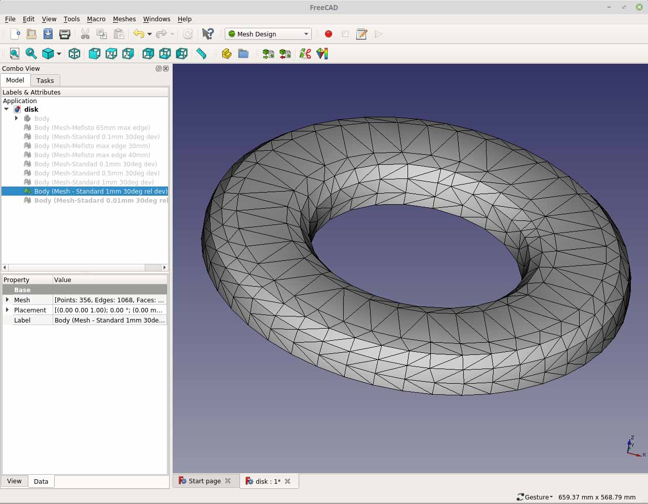

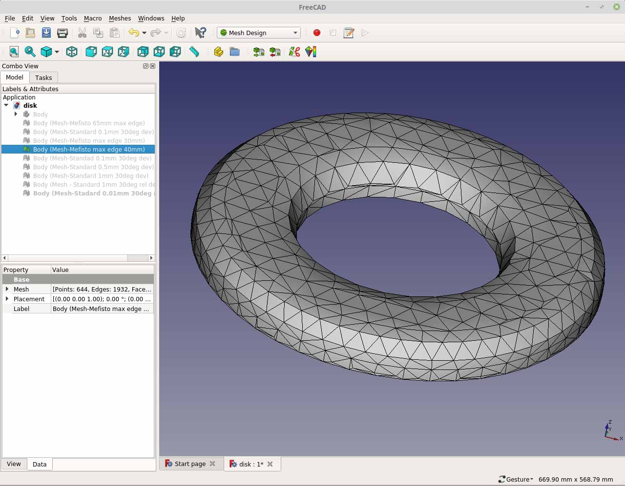

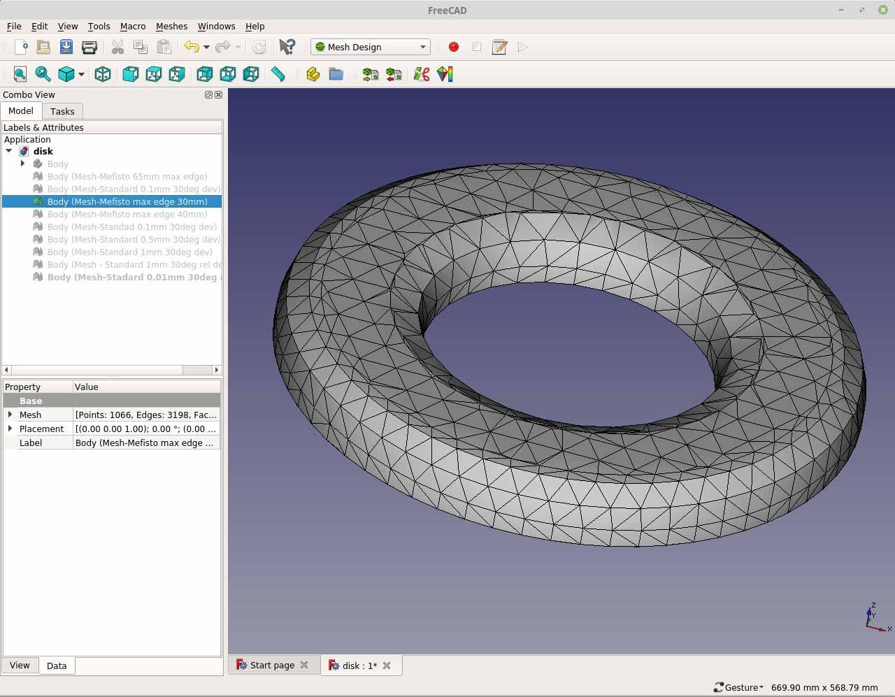

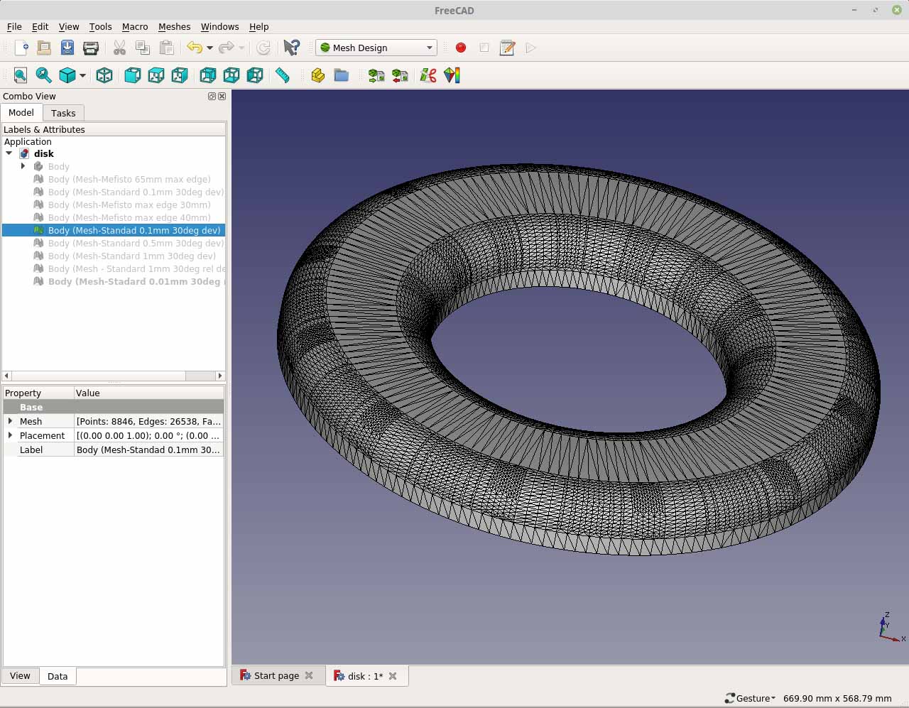

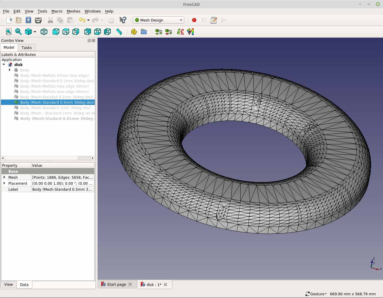

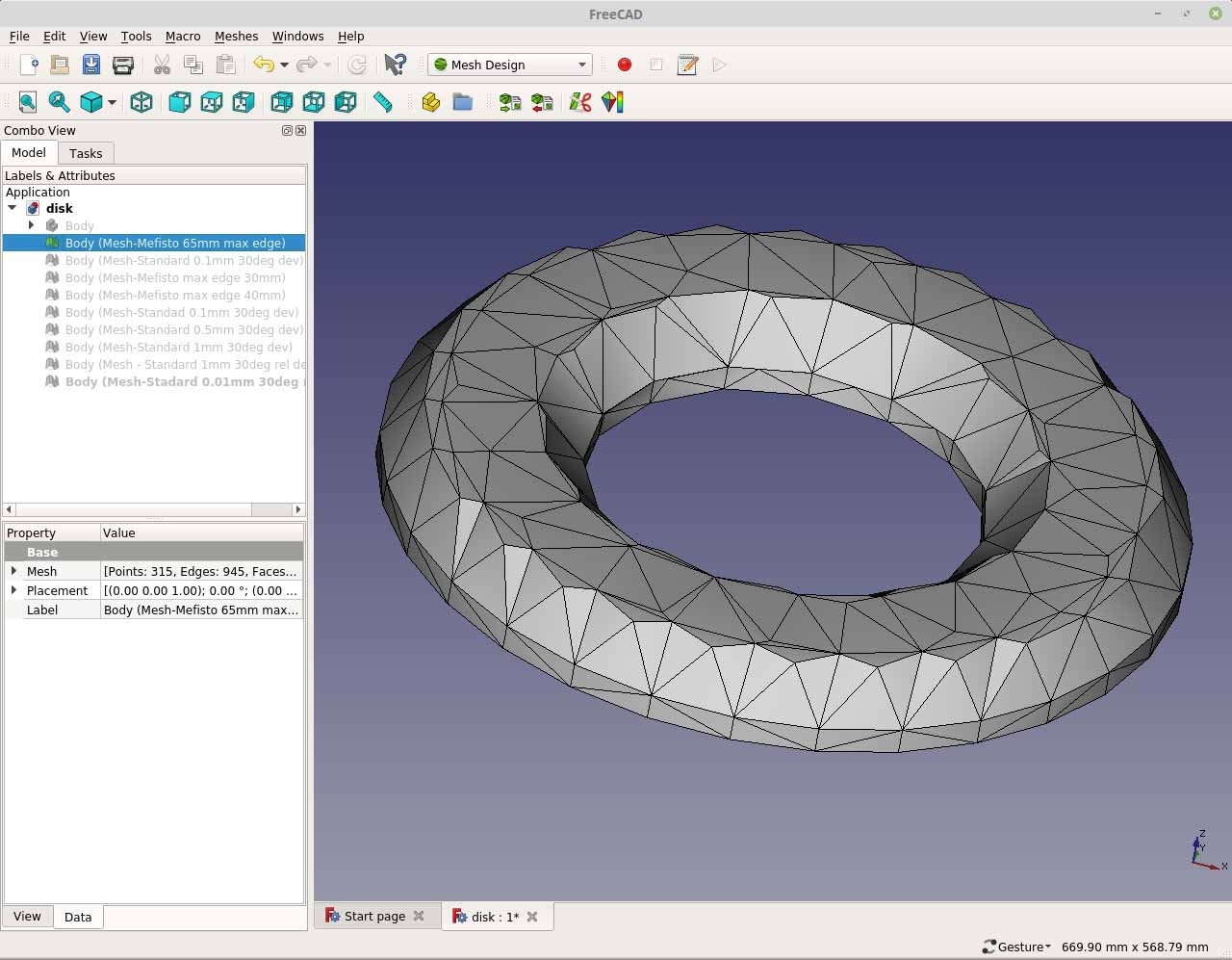

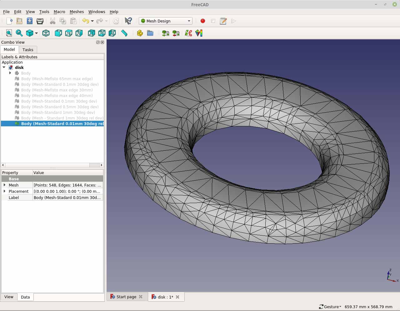

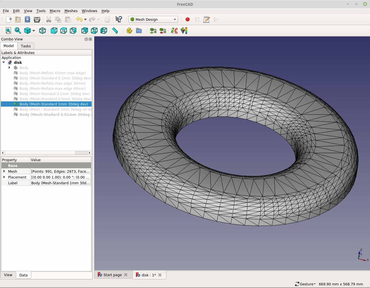

Mesh 3 - FreeCad stl
FreeCad also exports stl and has a few control parameters. We can compare this design path to the previous mesh posts (#129, #130) using stp export and GMSH. The comparison should be between meshes of similar #elements as this determines ABEC solve time.
I'm using FreeCad 0.17 and it has 2D algorithms [Standard, Mefisto] and [MaxEdge, Abs, Rel] surface deviation. It looks like NetGen is also planned however its greyed out (unavailable) on v0.17. The default settings in FreeCad mesh do not provide good results for my disk (ring). The default Standard has too many elements, and the default Mefisto is too coarse with too few elements. I've listed the summary and some screen shots of the results.
Approx 2000 elements provides a good surface for both the mesh generators. This would allow a fair comparison when they are imported into ABEC for trials. It's also a good reference point when we try to shrink them down and maintain a good surface representation.
