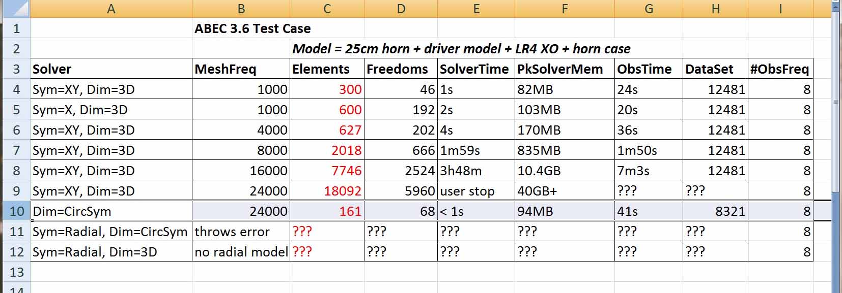

I also played with symmetry models...[no sym = 8000, 1/2 sym =4000, 1/4 sym=2000, polar sym =?] elements. Not a surprise, as its what you'd expect.

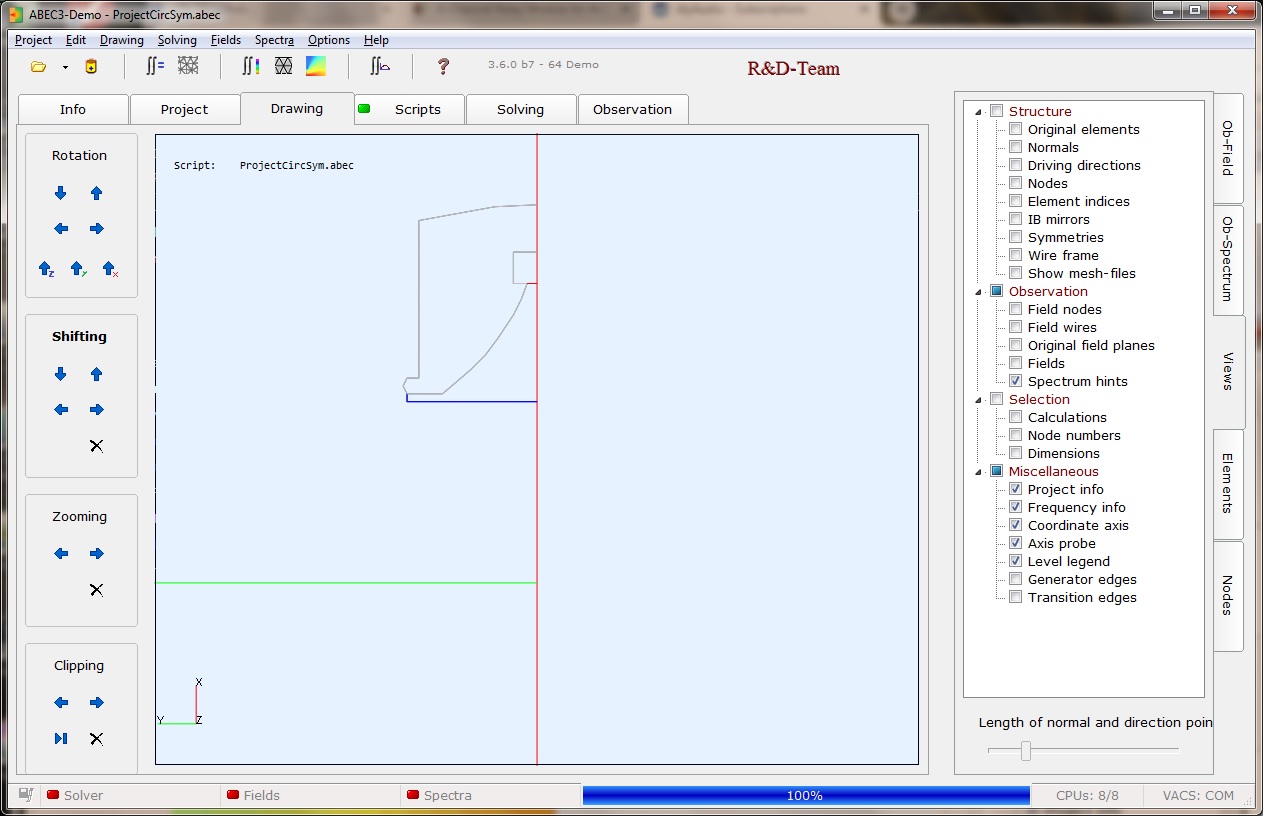

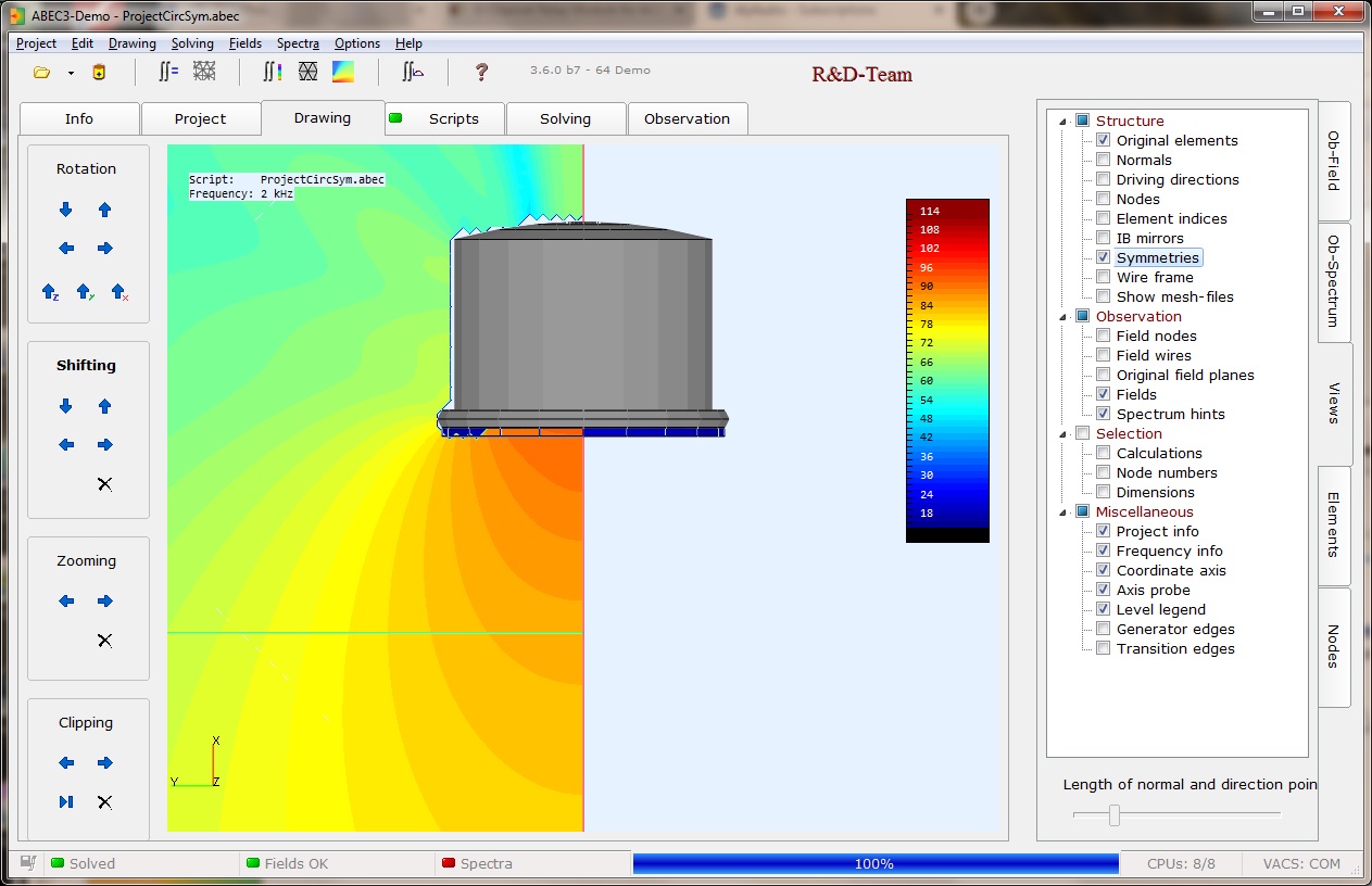

Symmetry 2
Had a chance to run a circular (polar) symmetry model using the same hat as the previous tests. The circular symmetry results are added to the updated table below with the 1/4 (XY) and 1/2 (X) symmetry models.
It's astonishing how much faster the model runs with circular symmetry. I only included the 24K mesh frequency because even that was fast. A "line" is required to describe the horn contour, and that could be done in a spreadsheet. The only oddity is the model's polar axis is the "X-axis" whereas the 1/n symmetry uses the "Z-axis". There are just minor output differences between symmetry models.
I don't have a radial symmetric model and don't intend on making one as I don't see the benefit at this point. There doesn't seem to be a way to describe the radial symmetry (#occurances/360, or angle, etc). I also think it would be a problem to create a radial model.
