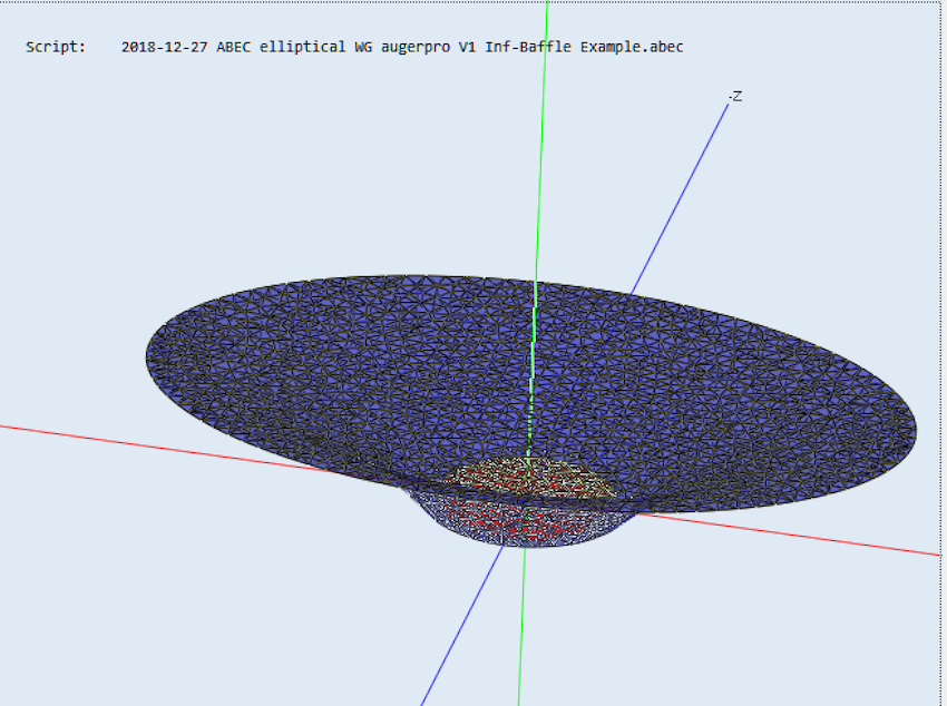

Thanks a lot for your comments, David.
The image showing import of mesh in ABEC got lost somehow during writing. Here it is:

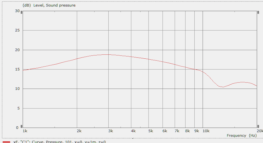

Now that we defined the nodes, we tell ABEC to display an SPL curve in 1000mm distance on 👍-axis as an example:
In VACS this will look like this later (after you let ABEC calculate the spectra):

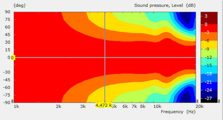

As a second example, we define to depict the horizontal directivity:
How does this look like in VACS?
Please note that you have to do some adjustments in VACS (e.g. frequency range etc) to get exactly this image. Would be an extra post to describe this in detail.

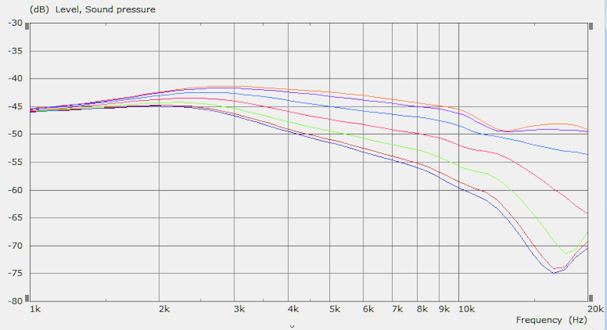

...or single curves under different angles can be depicted (here 0° to +90° in 15°-steps):
Note that the line '101' refers to node '1000' defined above in nodes 'Spectrum'.BE_Spectrum
PlotType=Curves
RefNodes="Spectrum"
GraphHeader="SPL Box 1m"
BodeType=LeveldB
Range=50dB
101 1000 ID=101 // On-axis
Very briefly: With polar range angles (-90° to +90°) and number of simulated angles within this range (13) are defined. The base plane has been defined in Nodes 'Spectrum', other definitions are probably self-explanatory - or explained in the help file.BE_Spectrum
PlotType=Polar
GraphHeader="Polar horiz 1m"
BodeType=LeveldB
Range=30dB
PolarRange=-90, 90, 13
BasePlane=2001 2002 2003 RefNodes="Spectrum"
Distance=1000
101 Inclination=0.0 ID=2101

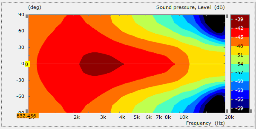

Just as a hint: You can extract quite some additional diagrams/forms of presentation from the data, e.g. the directivity plot can be normalized:

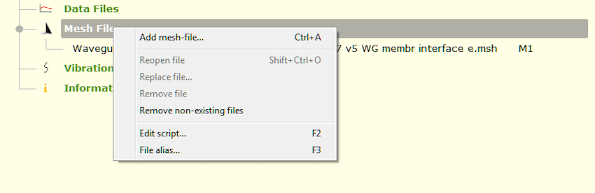

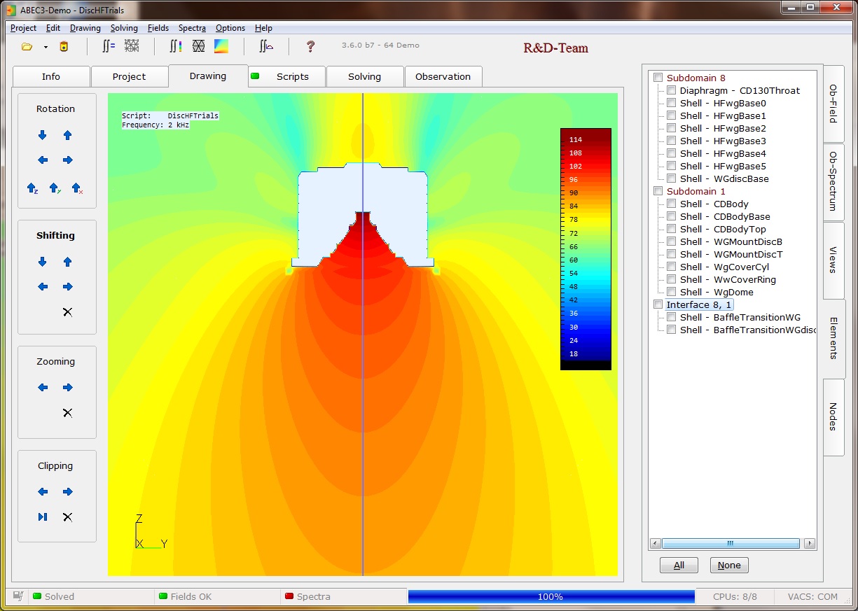

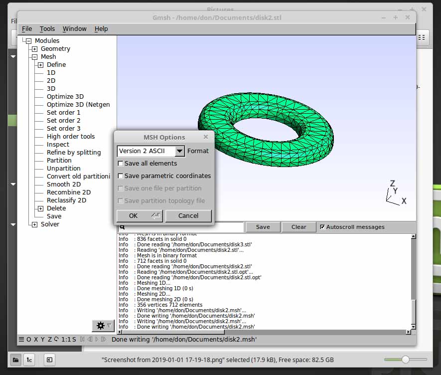

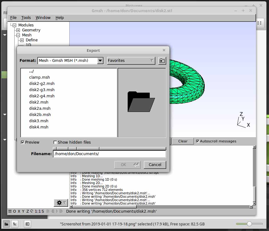

Gmsh V4.0
An addition to @Gaga's tutorial on creating meshes for ABEC.
In Gmsh V2 and V3 the [File]->[Save] saves in mesh file format v2.2 which ABEC V3.5 will read properly. The file format version is the first 2 lines of the mesh file.
The latest Gmsh V4 saves in file format v4 which is not recognized by ABEC. The newer v4 format contains new tags and elements. If you import there is no object shown and no errors indicated.
However there is a way to export file format 2.2. You need to select [File]->[Export]->[filename : save as]->[format : ascii 2.2]. You don't get to see the file format options until the last step. Some screen shots below.

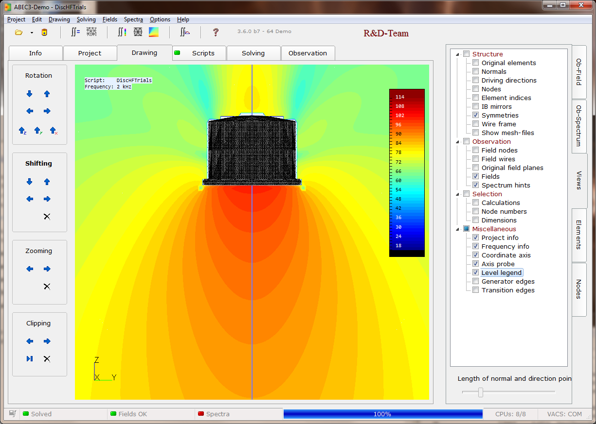

Whatsoever, last step is how to display the simulation results..
Thanks once more, and another question.
Patrick posted this is another thread
I asked him about the "jaggies" in the colored plane plots, they look like an artifact of some kind because they are not consistent with the mesh of the horn.
He has not responded, so my question is if you have seen such behavior?
Is this a mesh problem or a VACS/display issue?
Hi all,
those jaggies/steps or missing field areas do come from mesh and calaculation issues. The solver is trying to solve the pressure/phase whatever in all the triangles in the mesh. When a triangle is touching or even going through the waveguide/wall then we come to this issue: The solver can't solve it, because there is no valid solution for pressure/phase whatever in the wall/waveguide thus it can't display anything and those areas are left empty. Due to rounding errors this might even happen if the mesh is only close but not really touching the wall.
By the way, this issue also leads to long calculation time for the fields.
The solution is paying more attention to the field area/mesh. The mesh should not touch walls or different entities and should left some space between the field and the walls/waveguide.
An easier but not so good solution would be just to increase the mesh resolution, then the steps become smaller - but this will lead to even longer calculation time.

ABEC test case : memory vs elements vs solve time
I was curious about the relationship between the model's #elements and the memory and time required to solve it. The solutions are 3D, so as the #elements increases, the time and memory should increase at a cubic rate.
I used a shell model and increased the mesh frequency to force an increase in the #elements. I think the #elements is a good indicator for whether you should go any further, waiting for a potentially long solve time, or pick a new strategy. I used Windows "Task Manager" to check the memory usage over time, and the ABEC reports for the #elements and solve times.
The model is for a 25cm horn, it's compression driver, LR4 XO, and the enclosure. It was just an easy extraction from another project. Its running on a i7-2700K@3.5Ghz with 16GB RAM.
The first 2 pics are the observation fields with and without enclosure+horn+driver shown. The next table has the test results and the last pic is Task Manager. I aborted when ABEC was up to 40GB+ requested, and I have 16GB physical, so the rest was virtual mem (ie. my SSD). It is possible to use up all virtual memory then ABEC will abort with "Out of Memory" error. I don't think I could wait that long for it to solve, so I'll probably keep under 4000 elements.

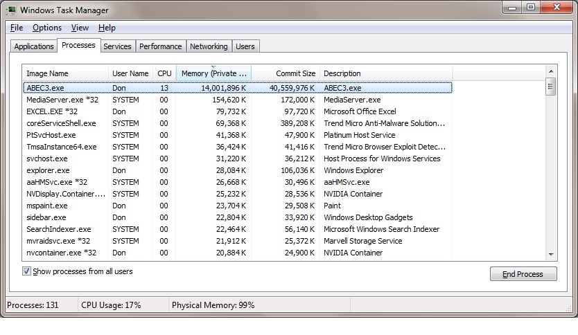

Because memory is so darn expensive lately, I was toying with the idea of installing one of those M2 drives to see if that could be (somewhat) competitive with actual RAM.
My laptop, like most, has an M2 slot that's just sitting there empty. So the idea would be to have two tiers of SSD in the laptop, put the operating system and "Program Files" on the Optane, and everything else on an SSD. In Benchmarks, the Optane is well over twice as fast as "top tier" SSDs:
Intel SSD 660p Series Review | StorageReview.com - Storage Reviews
Price is around $100:
Amazon.com: Intel Optane SSD 800P Series (58GB, M.2 80mm PCIe 3.0, 3D XPoint): Computers & Accessories
It's not a huge drive by any means, but my laptop maxes out at 32gb of RAM.

What do you use with ABEC, Gmsh?
And for the CAD?
To avoid wasted time I want to learn what software works harmoniously, several people in this thread have already identified poorly compatible products.
Very interested in the experience of someone who uses ABEC professionally.
Even if you had enough RAM, as soon as the model get a large #elements the solver time is too long to be practical (for me). I'm not even sure if the solver could be partitioned to use GPU(s) which would be ideal.
