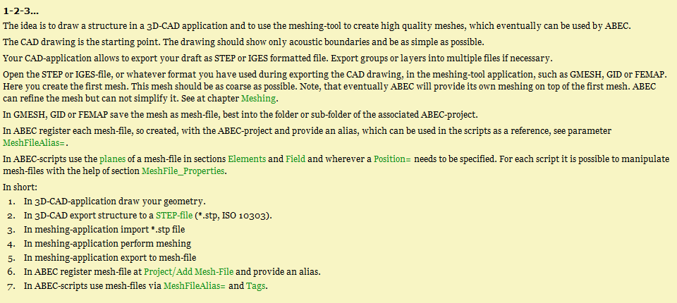

OK, I managed to solve this one (literally.)
If anyone else is losing their minds with ABEC, here's some stuff that helped me:
1) I wound up drawing my waveguide on a piece of graph paper. I gave up on making it in 123D and importing a mesh. I basically made something on graph paper that looks like an Akabak waveguide, but this time in three dimensions, not one.
Why not use ABEC shells for a preliminary design concept? Everything is native ABEC. I found this helpful in trying to drive.
2) My big 'Eureka' moment was when I looked at the performance of my laptop: ABEC was using up all my memory then hitting a wall. So that's why my sims were 'stuck' at 32%. The program isn't smart enough to know that it's run out of RAM.
This sounds strange. If you needed more RAM the OS would page swap using your HD so everything just slows down. My desktop used to have 8GB and I ran all the demo models and my own Omni model with 2K elements without issues. I upgraded to 16GB RAM and it made no difference.
3) To fix the RAM issue, I dropped my maximum frequency from 15khz to 5khz, and then I inched it up until it stopped working. (I think I settled at 7khz.) My laptop only has 8gb of RAM, so you should be fine if you have 16-32gb of ram. As I understand it, ABEC uses the maximum frequency to determine the size of the mesh. IE, if you have a maximum frequency of 10khz you're going to need way way more RAM than if the max was 5khz.

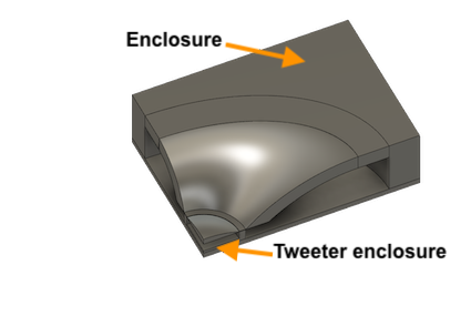

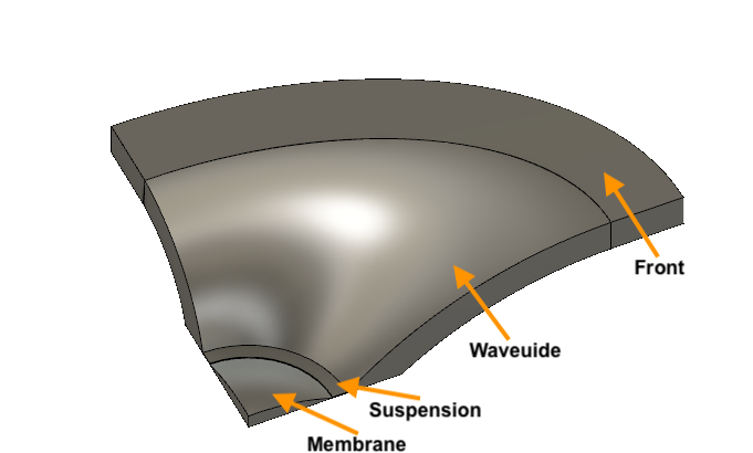

I am finding that I must change how I do my 3D models. For instance, when I build waveguides, I generally use circles and lines.
Like this:
From here: 3D Modeling Tips and Tricks
I am finding that this method doesn't work so hot with ABEC. Here's why:
We make the model in something like Fusion or Sketchup or 123D. And then we convert that model to a solid in FreeCad. The problem is that you wind up with way, WAY too many faces. You can reduce the number of faces in meshlab, but easily 80% of the time I wind up with a broken model, even with a modest reduction in the face count.
I tried about a million different solutions, but the one that seems to work is to just use polygons instead of circles. For instance, if I use a sixteen sided polygon as the basis for my waveguides, the number of polygons in the final solid is way lower.
I'm not familiar with Sketchup, but why would you convert a Fusion model to FreeCad? From Fusion you can export a model as STEP-file (*:stp), which can be opened in GMSH.
This is something I experienced with FreeCad as well, but not with Fusion.
Same with me, when starting over with too many faces for meshing (I usually use GMSH).
This issue was the reason for me to switch from FreeCad to Fusion and simply export *stp from there. No issues with circles or elliptical surfaces resulting in too many surfaces so far.

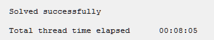

Success! I finally managed to get an ABEC sim to work, using a model that I designed myself, with a CAD program.
This is a first. A few years back I managed to get ABEC to work using a modified version of the included sims (1) and earlier this month I managed to get ABEC working using a model that I designed on graph paper(2).
But this is the first time it's worked with a 3D model, made in CAD.
So, in case anyone else has struggled with ABEC, here's what worked for me:
1) I've found that Autodesk's "MeshMixer" is a million times better at reducing the polygon count of a model. I don't think I could've achieved usable results with Meshlab, I was constantly seeing issues where the model would have holes in it.
2) If ABEC gets 'stuck', consider reducing the upper limit of your sim. I have a quad core Ryzen and 8gigs of ram, I wasn't able to do sims above 5khz. Symmetry can allow you to increase that further, but I'm not using symmetry.
3) This one was huge, and I imagine that 99% of the people reading this won't run into this. But in case you do... I am making models in 123D, then I'm transmogrifying them in Meshmixer, then turning them into a solid in FreeCAD, then turning them into a mesh in GMSH. As described here. Here's the problem: when you import that mesh into ABEC, there's absolutely zero scale information. IE, ABEC has no idea if your model is ten inches in diameter or ten miles in diameter. This problem was KILLING me, for days. I found that I could import a mesh into ABEC, I could manipulate a mesh, but I couldn't SOLVE anything. The issue was the lack of scale. ABEC would happily let me examine my model, because the coordinates were perfectly valid, but with no information to describe the scale of the model, simulation was absolutely impossible. I went in circles with this one for DAYS, because I thought the issue was that my model wasn't airtight, or that I was using a demo version of ABEC, or that there was a syntax error in one of my scripts. But it wasn't any of that. The problem was that I was missing one line in my "solving.txt" script, which would describe the scale of my mesh. It should look like this:

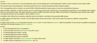

Here and here are descriptions on how to convert a *.stl file to a *.stp file for import in GMSH.
However, note that *.stl files are already 'meshes' and not the best format for simulations with ABEC. With the conversion to *.stp you have to calculate back to a solid form. Better approach would be to start over with a *.stp file directly from the 3D-model for simulations and derive the *stl file later for printing.
I assume 123D can't do this and just exports *stl (?). However, other 3D-CAD software like FreeCAD or Fusion 360 can. This will ease up ABEC simulations quite a bit.
This procedure is as well suggested by the ABEC help:

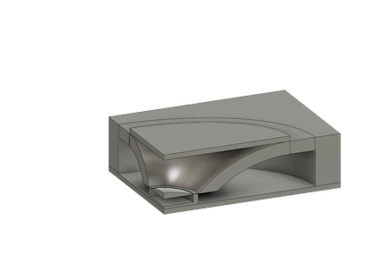

Step 1 - the CAD model
Starting from one of Brandons WGs, I converted the *.stl file to a *.stp file - please check Patricks description how to do this.
I then built my own 3D-model around the respective WG contour. Some hints and images to illustrate.
attachment.php
To get to this point,
- you have to build a body from the WG contour,
- you need at least a membrane and the waveguide,
- I added a suspension (depends on if you like to include the tweeter membrane and suspension to the simulation later) and a WG-surface (depends if you just want to simulate in an infinite baffle or in an enclosure later).
I then added...
attachment.php
...an enclosure. Or rather two enclosures, a back-enclosure for the tweeter and an enclosure for the entire WG. May be needed later, depending on what you intend to simulate.
Finally...
attachment.php
...I added an interface in front or the WG mouth. The interface sits between the inside of the WG and the 'outside'. This helps with the ABEC simulation later.
I already showed a quarter model her. Actually, the 3D-model was built up as a full 360° model first and the finally divided into quarters.
It's extremely helpful to do this in order to achieve reasonable calculation times in ABEC later. ABEC can use symmetries - use symmetries wherever possible...
Check, if your model has been set up in the 3D-CAD programm using inch or mm or cm - you have to know this when it comes to ABEC later.
How to go on with this? If you have your 3D-model, it has to be exported as *.stp file.
Next post will show how the stp-file shown above looks like after import to GMSH and how meshing is done.
Christoph

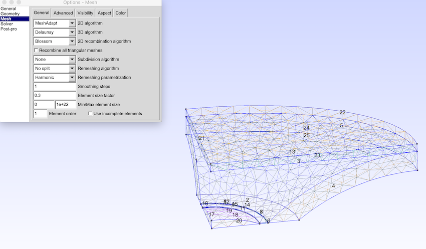

2. GMSH: *stp file import and meshing
Next step is to import the *.stp-file (exported from the CAD-programm) into GMSH.

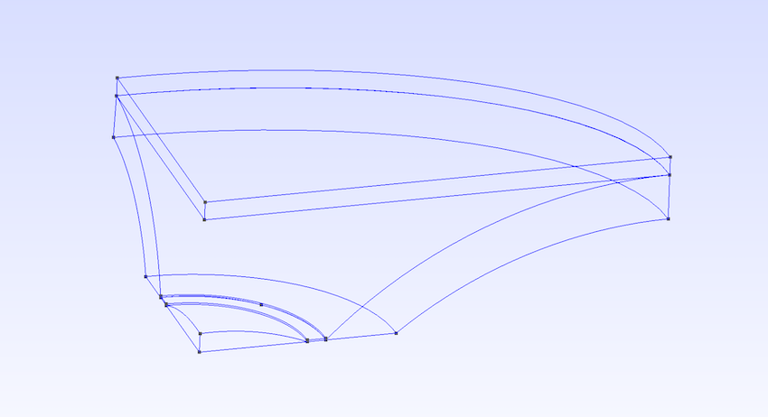

To keep it simple, here the minimal *.stp-file consiting only of membrane, suspension (or tweeter front), waveguide and interface.
In GMSH the stp-file looks like this after import:
attachment.php

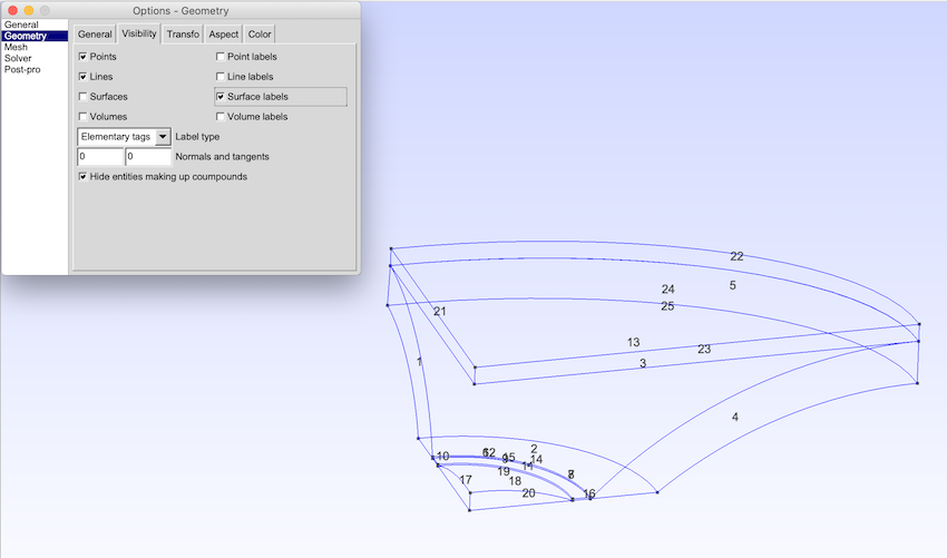

Addition of surface labels shows the total number of surfaces and their assignment to the respective surface.
attachment.php
Please refer to post #18 to see how this is done. You'll need these numbers for the ABEC script later to choose the right surfaces needed for your simulation.

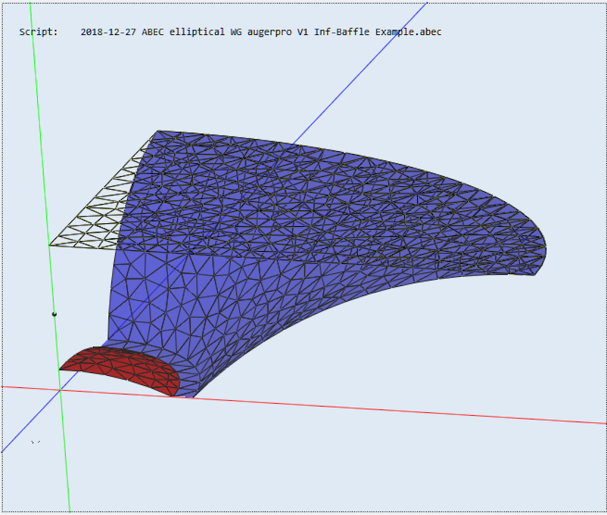

After meshing, the waveguide looks like this:
attachment.php
Please note that the resolution of the mesh is determined by the 'Element size number'. I recommend to experiment a bit here. The finer the mesh, the higher in frequency simulations can be performed later - but the longer the calculation time will be to solve the respective file. The size of the mesh-file is a good measure, if the mesh will work fine later. Here, sizes around 100kB to 250kB worked fine for me.
Choose 'export mesh' in order to get your mesh-file for import in ABEC.
I used a mesh-file of 144kB for import into ABEC for the following simulations. Let's see, how this works out...
Any questions so far?

Same system for all elements. Assign the correct subdomain for the element, if you like a color, the respective mesh file you refer to, shift coud be used to shift the element in ABEC (not needed here), Rotate is used to rotate the elements, just to bring the waveguide mouth in y-axis direction (can be done as you like, however, has to be aligned with the Observation scripts). Mesh include is important, here you list the number of the surfaces as defined in GMSH. For example, the waveguide contour is surface 13 (see GMSH image).
What's missing? You have to 'drive' the membrane. One possibility is to use the 'Driving' command:
Driving
RefElements="HT Front"
DrvGroup=2001
Direction=y
It is referred to the 'HT Front' element, i.e. the HT diaphragm. Driving direction is y, i.e. the 'direction' of the waveguide which has been defined by the 'Rotate' command.
How does this look like in ABEC?
attachment.php
You see the membrane (red) and the waveguide inside and tweeter front (blue) and the interface (no color, as you are looking on top of it, would be yellow from the WG inside).
The 'normals' of surfaces appear to be colored, if you look at them - and transparent, if you look at their back. It is important, that 'normals' of surfaces are facing the right direction (e.g. the waveguide contour or membrane should 'look' to the inside of the waveguide). The interface has to 'look' into the waveguide - again, all this is defined and described in the help file....
Everything ready for solving. Time for solving using this mesh/example (and take advantage of symmetry!) was...
attachment.php
Next post will give the Observation script and finally the simulation results in VACS.
