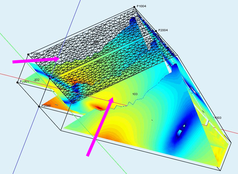

Problem solved - I had a wrong direction of one plane normal, pointing outside instead of inside, if anybody interested ;-)

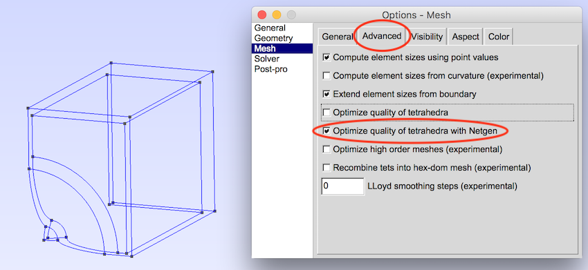

I then apply following settings choosing 'Tools' and 'Options'.
Options 1

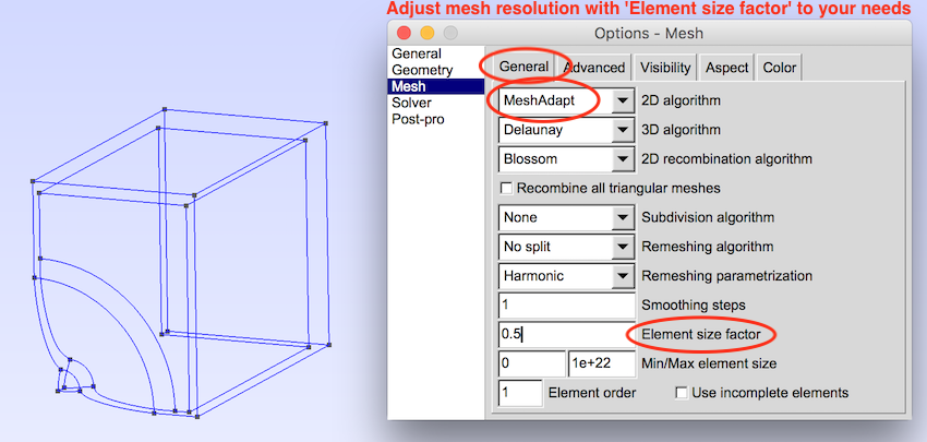

Within the 'Options' Window I choose 'Mesh' - 'General' and
- 'MeshAdapt' as 2D algorithm:
Moreover I define the mesh-resolution here by giving a number for the 'Element size factor'. The lower the number, the higher the resolution of the mesh.
Options 2
Before meshing, I select 'Optimize quality of tetrahedra with Netgen' under 'Tools' - 'Options' - 'Mesh' - 'Advanced':

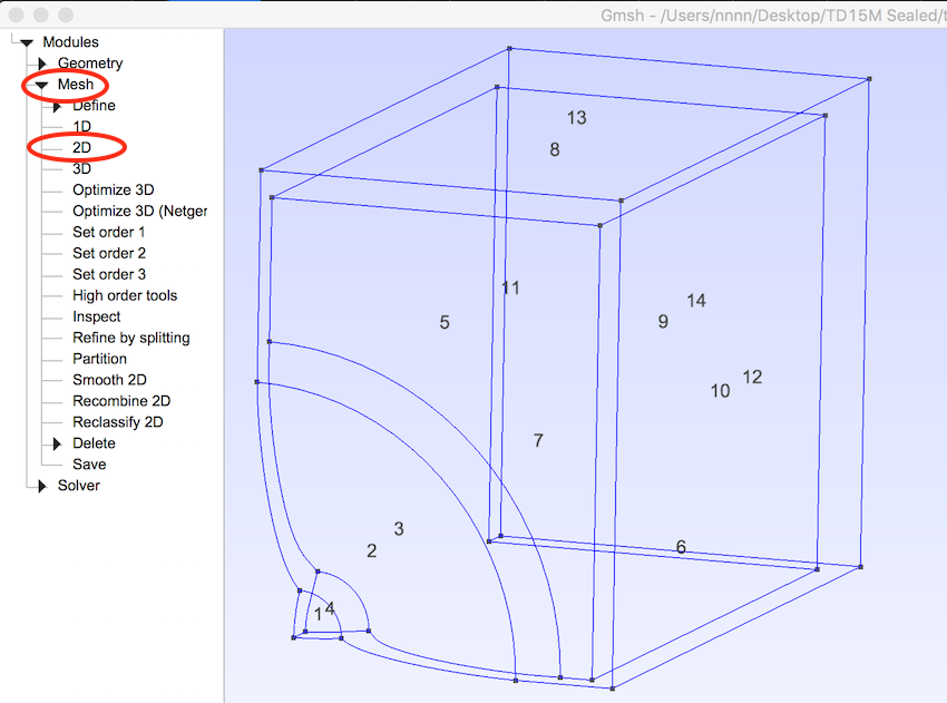

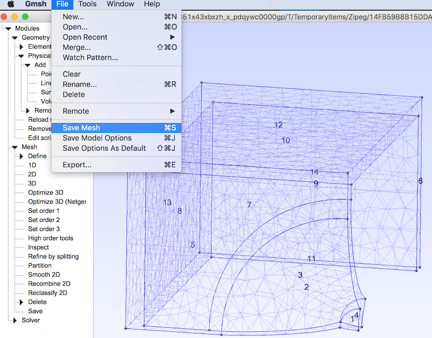

Mesh
I do meshing via 'Mesh' - '2D'

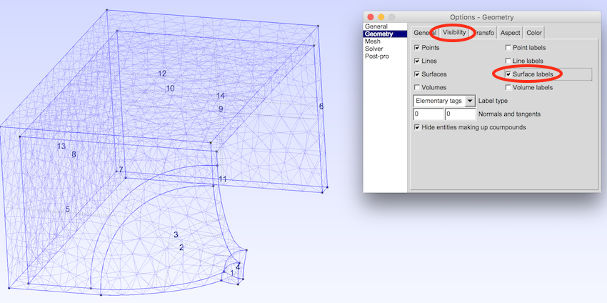

Surface numbers
Surfaces labels can be seen choosing 'Surface labels' under 'Options' - 'Geometry' - 'Visibility'
You'll need these numbers in the 'Elements' Script in ABEC in order to reference the respective surfaces.
Save mesh:
Not much to comment here. The mesh file can then be imported to ABEC. The size of the 'XY.mesh' file gives a good indication on how long your computer will need to solve the file in ABEC.
Hope this helps.
Christoph

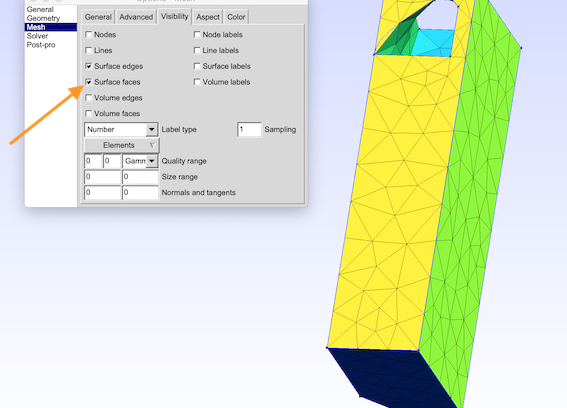

Yeah that's what I was looking for: the ability to see the surfaces of the model in color.
I thought there was something wrong with my model, but it looks like I just needed to enable "surface faces" visibility.
Those colors that you show in your screenshot, are you doing that in GMSH? Or something else?
It seems like the numbering on the mesh is important, because ABEC needs that information to describe the model.
Yes, these colors are done in GMSH. You can actually choose your colors of choice with 'options' - 'mesh' -'color' and the scoll down in the 'sub-window' giving a color scheme for surfaces nunber 1, 2, 3....
And yes, numbering of the surfaces in gmsh is important. These numbers are referring to the respective surfaces in your ABEC script then. You essentially need them.
