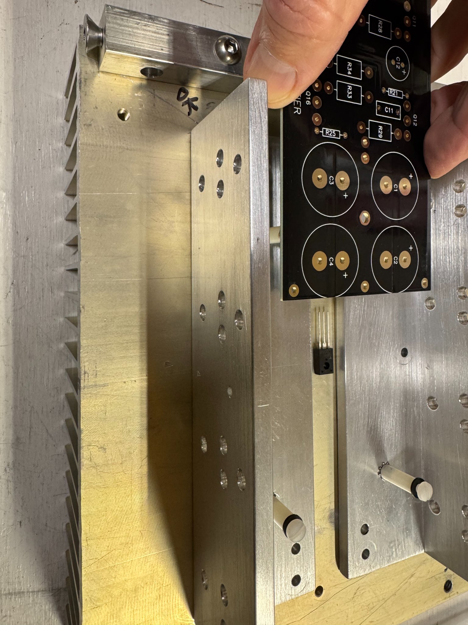

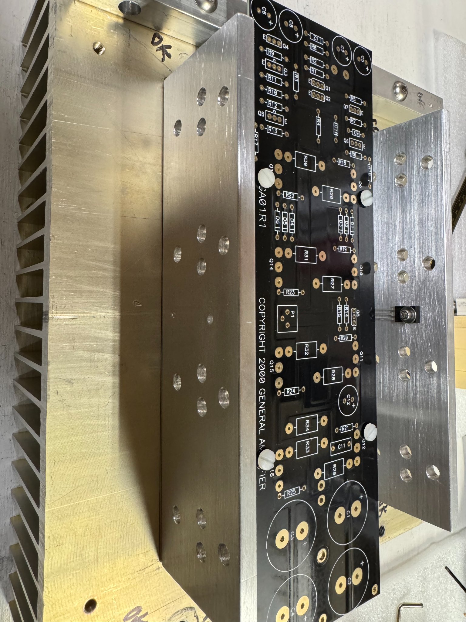

With reference to my post #1,530 last week, I'm beginning to wonder if it is foolish of me to worry about whether or not thermal feedback with bias transistor Q8 is bettered by placement midway between the NPN and PNP output device rows. Looking at a couple of photos of successful implementations of this amp (for example, one using a HiFiOcean board) , I see the Q8 device mounted smack in the middle of the row of NPN output Qs at the top of the circuit board---a half inch from these, and not at all close to the complementary row of PNP output Qs below the circuit board. Plus, when I look at the specification sheets for the MJ11016G (NPN) and Mj11015G (PNP) devices I plan to use, they appear to have the same thermal characteristics.
Given that placement of Q8 on the main heatsink between the two TO-3 device-holding brackets (see photo below), is not terribly close to any output Qs, and is harder to mechanically assemble, maybe I should just locate Q8 on one of these brackets (see other photo below) and assume temperatures at that point are a good proxy for the whole output stage.
Does anyone care to offer an opinion? Or even better--has anyone taken any temperature measurements on a functioning AB100 that might inform the decision. (Mine is a ways from completion).
I believe the closer you are to the transistor, the better Q8 can respond. I haven't seen how anyone else using TO-3 devices solved this issue. My Q8 is mounted right between the two rows, but I'm not using TO-3's. Someone further back in the thread used TO-3's, you might find that and ask him.
Thanks for the feedback, RickRay ! I suspect you are right about closeness to the output transistor resulting in better response from Q8. It stands to reason that heat takes a while to travel through the metal.
Osscar used TO-3 devices in his AB100, but in photos it appears that he had the Q8 mounted very close to a pair of them (I think a complementary pair,, although it's not clear from the photos) which he was able to do by using relatively long wires to connect these output devices to his custom-designed boards.

yes I mounted next to one pair, but there was a reason for that - because there was already a hole in the heatsink 😀
But overall I think it doesn't matter that much - especially considering that the quiescent current of individual MJ TO3 darlington transistors is quite accurate when measured in Re, so they will heat up similarly.
Also, the thermal mass of the radiator must be taken into account and bias should be adjusted slowly - because radiators heat very little and slowly.

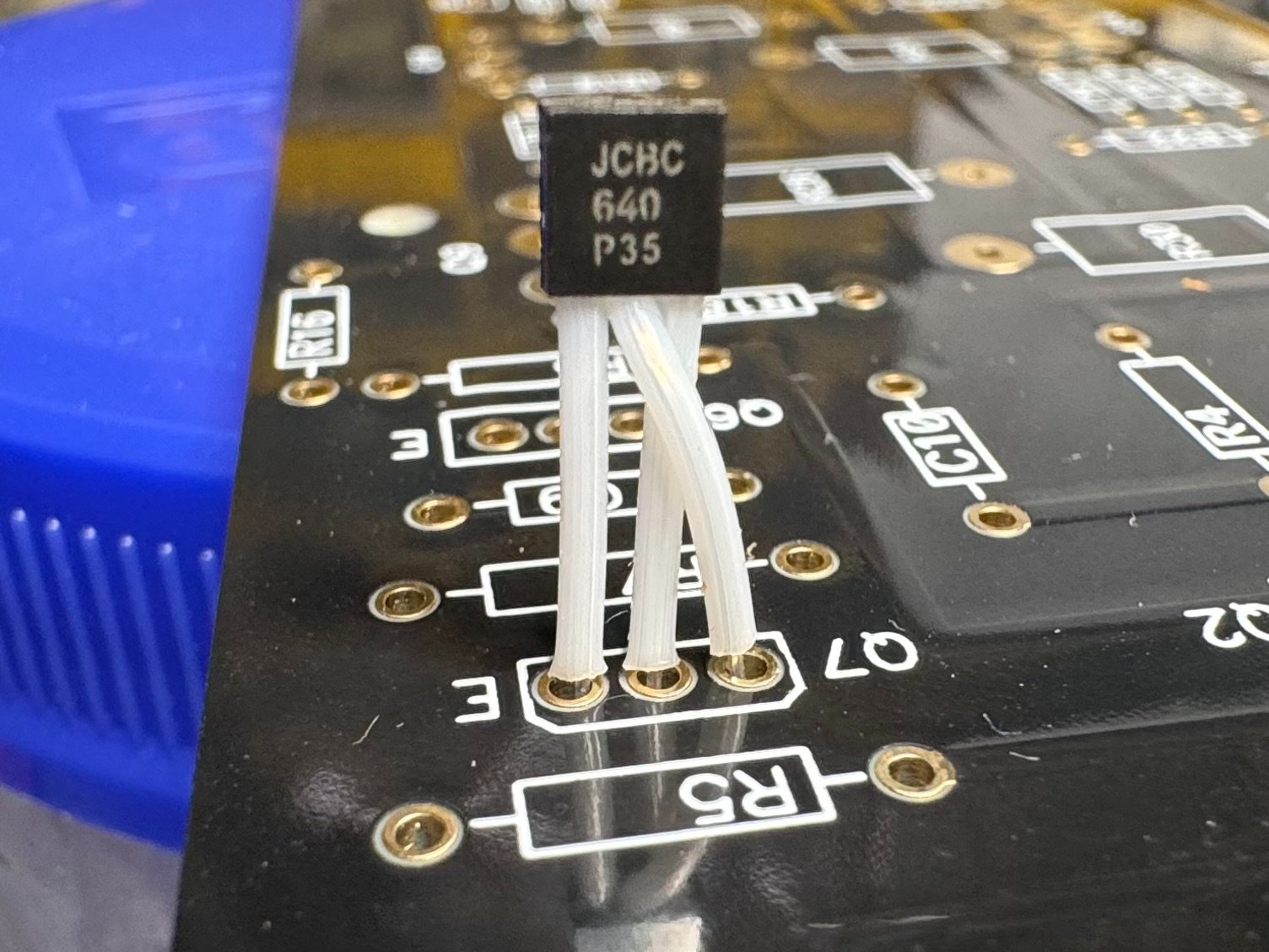

I've been distracted from working on my AB100 for more than a month, but I'm back on the job. I decided to use newer transistors for Q1, Q2, and Q4 (NPN), and Q7 (PNP) that differ from the original devices specified in the Pass design. This decision has necessitated a slight workaround.
The original Qs called for in the Pass design were ZTX 450 (for the NPN devices), and ZTX 550 (for the PNP device). (Nelson's Q8 was also a ZTX 450, but I'm using a TTC004B there for the bias adjustment circuitry).
I'm replacing the (NPN) ZTX 450 devices with Onsemi BC63916 devices (easily available and higher voltage rating); and replacing the (PNP) ZTX550 device with Onsemi BC640TA (for the same reasons).

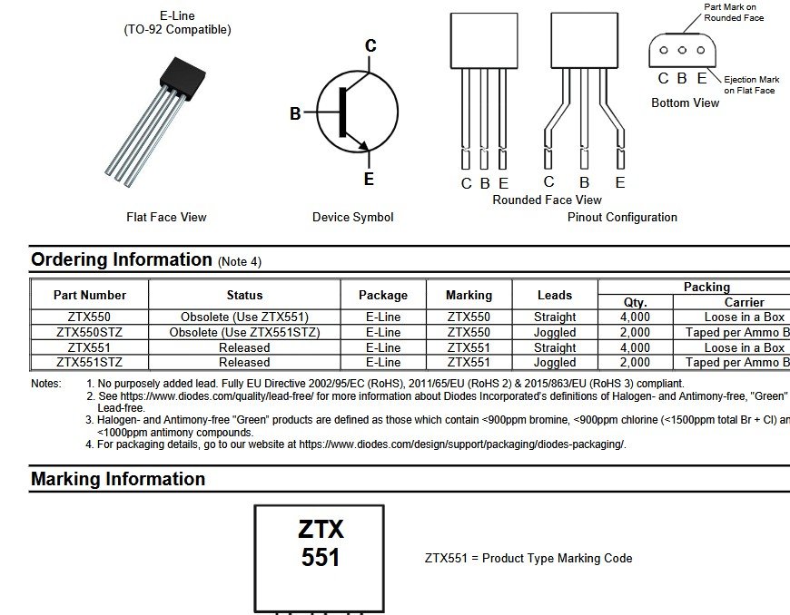

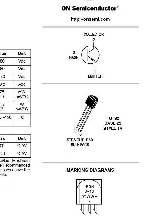

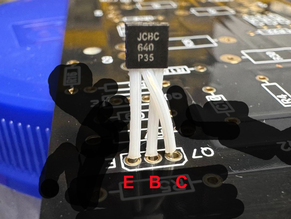

When I double-checked the pinout for all of these Qs, however, I discovered a problem . Facing the flat side of both the ZTX 450 and the ZTX 550, the pinout shown on those devices' datasheets is: (left to right) Pin 1-Emitter; Pin 2-Base, Pin-3-Collector. However, the data sheets for both the BC639 and the BC640 replacement devices, reveal that these devices, again facing the flat side, have a pinout of: (left to right) Pin 1-Emitter, Pin-2 Collector, Pin 3-Base. In short, the Base and Collector leads are reversed in the newer devices.
In order to use the newer devices, I twisted the Base and Collector leads, as shown in the attached photograph of a BC640 in the Q7 spot. And then inserted the transistors so that the Emitter lead position agrees with the Pass board silkscreen "E" marking. I checked these revised lead positions against the original Pass schematic, and against the visible PC board tracks, and it seemed like the BC640 would make the right connections with this change. I made the same changes for the BC639 devices for Q1,Q2, and Q4. I have not soldered anything into place yet.
I hope this makes sense and is all correct. I would be interested to know how any other forum members using the BC 639 and BC 640 devices dealt with this problem. I believe member jwjarch included these newer substitute devices in his BOM (attached to post #748), but I don't know any implementation details for his amp.
To prevent shorts resulting from the twisted Q leads, I used some Teflon insulation pulled off of 22 gauge solid-conductor hook-up wire I use for point-to-point perf board. It's thin walled, and not as stiff or bulky as shrink tubing.

They are, as far as i can see i your screen shots.No twisty legs are required.
Ztx: CBE (center base)
Bc: ECB (center collector)
