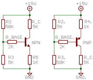

Please post the measuring circuit
A draft circuit by hand is more than enough.😉
I usually use the attached sketch (which I would like to properly cite but I cannot find out anymore where it came from) for BJT characterization. Of course this schematics is optimized for milliamperes and normal gains, rather than Amperes and Darlingtons.
So in case of the higher current OS Darlingtons, I removed the Rc and Re resistors; used a voltage source with an 0.5A current compliance; applied a Vce voltage which brought the Ic current to this compliance regime; used R_base = 1k; found a combination of R2 and R3 values (few k and few 10k, I think) such that the resulting voltage divider supplies around 0.7 - 1V to R_base. Then I measured the voltage drop on R_base and calculated Ib. Since the Darlingtons are not that much different, I settled to the some resistor values after a short experimenting, which I of course kept the same for testing all devices. Don't forget to mount the Darlington on a massive HS and allow it to thermailze under constant 0.5A.
I arrived at this approach (constant Ic and measured Ib) because withuot supplying a constant Ic, the latter was rather unstable in the 0.1 -1 A regime. I focused on this relatively high current regime because of two reasons: (1) the Darlington gain is very high and for the sake of more precise measurements, I preferred to deal with 100-ish microamps for Ib rather than something much smaller; (2) I assumed that equal current sharing in the OS is more critical at higher currents than around the few 10 mA constant bias current.
Please note that this was just my naive approach. If it is very wrong somewhere, I hope that a more educated / experienced fellow will speak up.

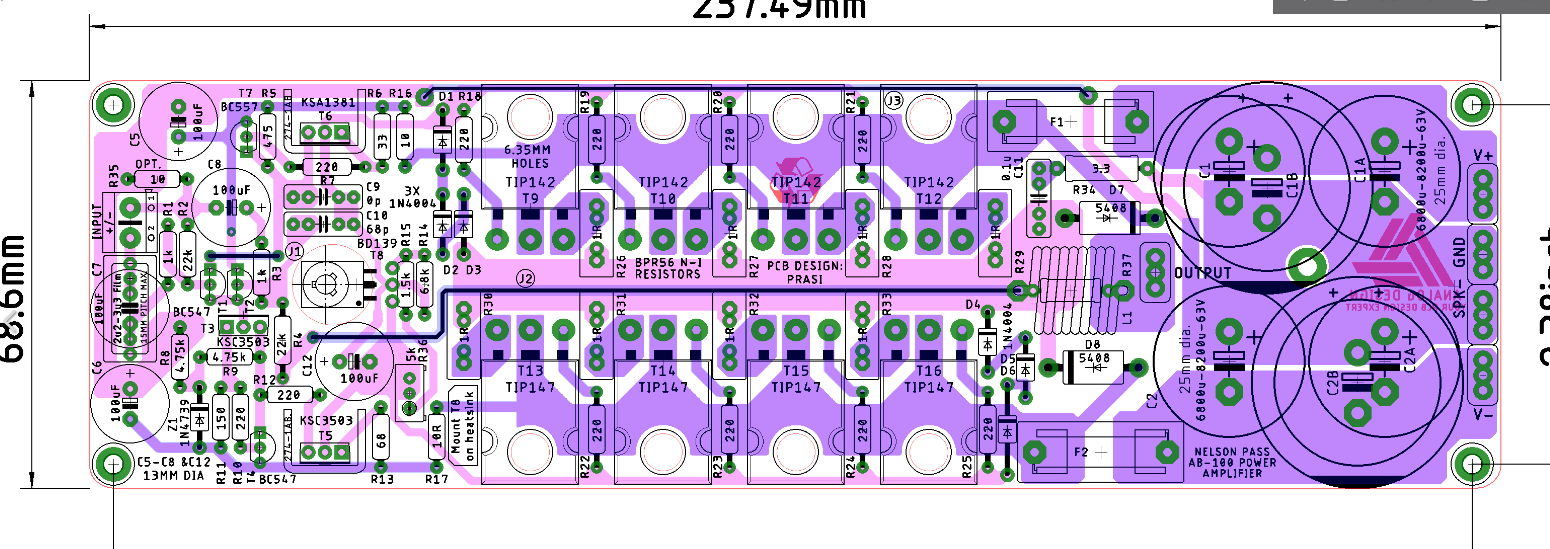

No confirmed they are in backwards on both channels. Does it make sense that amp would still function at least w/o problems that I can tell. Anyway assuming that I should fix that. I do see how the Emitter marking is opposite of the other transistor outlines. Would like feedback on this please.
Follow the data sheet for ZETEX transistors. They are different, the small side is the front. I'm betting you have them installed correctly.
