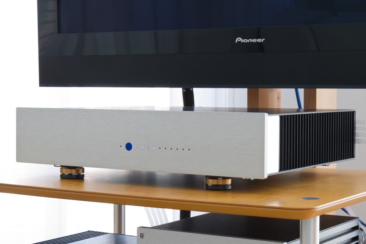

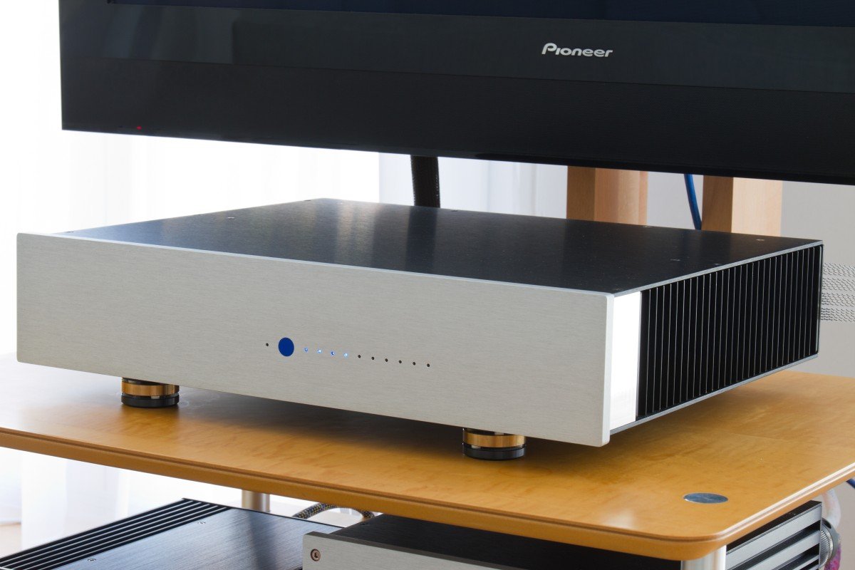

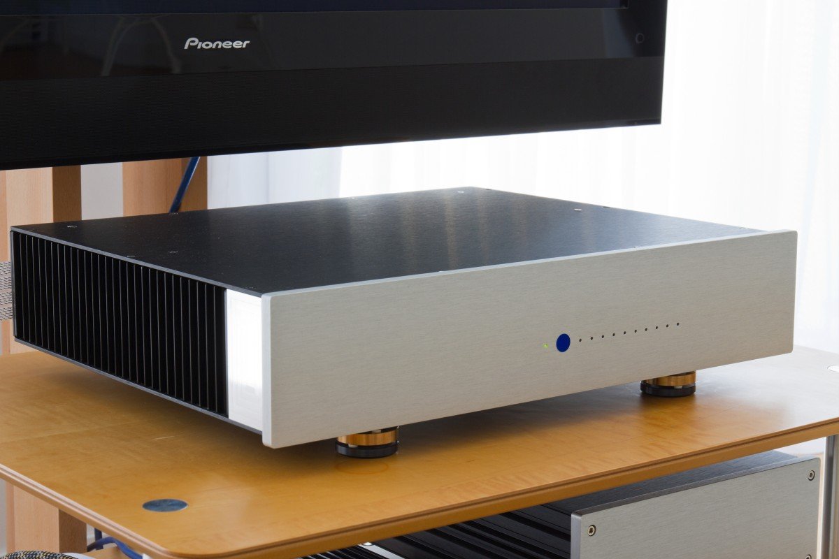

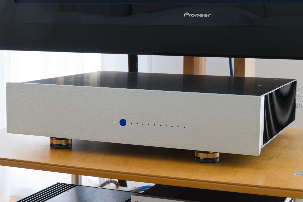

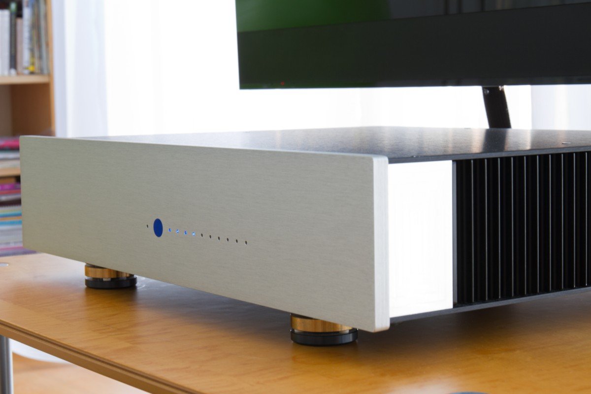

Now as the amp has been on duty for a couple of weeks (and has totally spoiled me) I took a few more snapshots, which I would like to I share with you as a teaser. The chassis is based on a 350 mm deep Slimline 2U from Gianluca but I added the 300 x 80 x 40 heat sinks and the CNC-made raw aluminum insert behind the face plate. Before you ask, I am afraid that the local manufacturer of the ceramic ball coupled feet has - most unfortunately - closed the shop during Covid.
