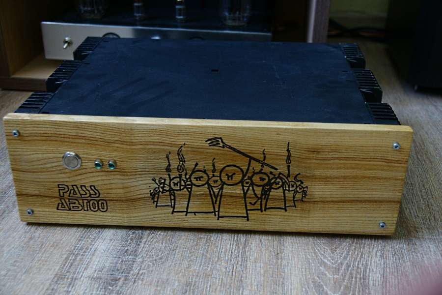

Front panel finished - it still needed few varnish layers and some polishing - work with a maple tree is not easy - I prefer soldering and PCB etching 🙂

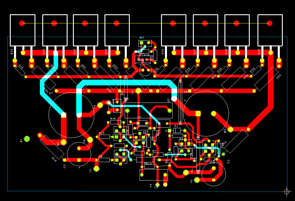

I messed, and heres's what I've come up with - no longer an AB100, as it has single-ended diff pair input, but symmetric drive. Traces will be beefed up, and maybe some boards will be made. Any other info will go in a new thread.

Sakis,
I agree 100% with your points in #252, particularly long wires to output devices and changing the emitter resistors. I'd add that base/gate stoppers are often essential to stability, because output device commutate, and this brings on a base region of negative impedance, which leads to oscillation. I'd add that a mosfet is far more reliabile with a snubber, a small resistor in series and a small cap strung between gate and drain.
